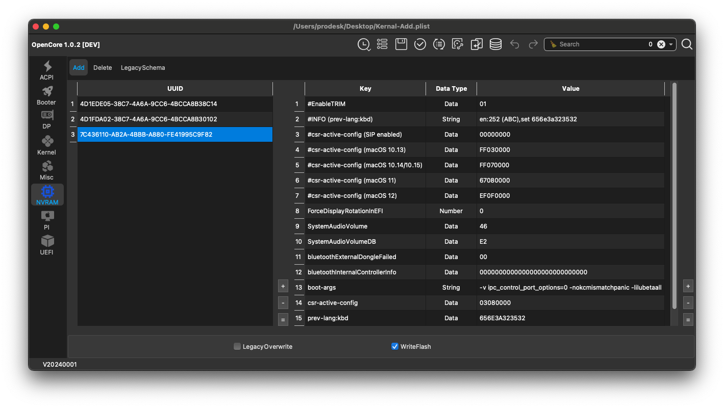

23 hours ago, datafeedexpert said:

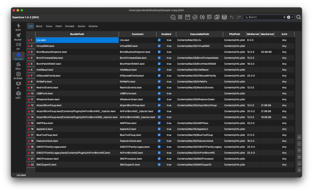

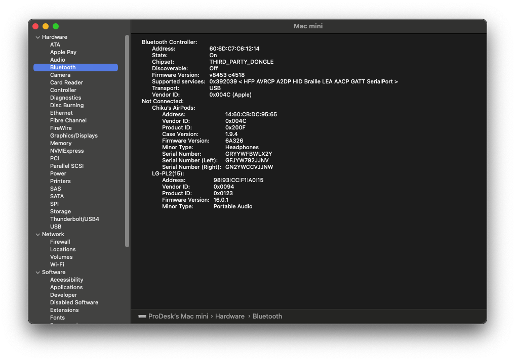

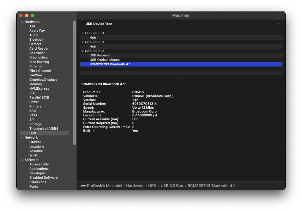

@HyperX7 i am using the same DW1820A Card & my Bluetooth works great, You have to add below 2 entries
1. NVRAM (7C436110-AB2A-4BBB-A880-FE41995C9F82)
    boot-args -lilubetaall
2. NVRAM (7C436110-AB2A-4BBB-A880-FE41995C9F82)
      bluetoothExternalDongleFailed - Data - 00
      bluetoothInternalControllerInfo - Data - 00000000 00000000 00000000 0000
     After changing these value don't forget to Reset Nvram From Opencore Boot Picker
  Reveal hidden contents
image.thumb.png.c9d5c70016c837c3c3403e62533342fb.pngimage.thumb.png.311cc5a26fb0b8556a85085c0a47ad4e.pngimage.thumb.png.c2b27a15d773a4bf74858202da9f3727.pngimage.png.d142bcfb8037694e960691e966a5ca07.pngimage.thumb.png.c7c7c870be17e902fd64aa4119af3379.pngimage.thumb.png.3daf9555bc818fd43f93ed1af639859b.pngimage.thumb.png.b6ea682a67b699a548d15a084fee85c8.png
@datafeedexpert thank you bro. These are work. Bluetooth came back!
Edited by HyperX7
syntax error

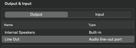

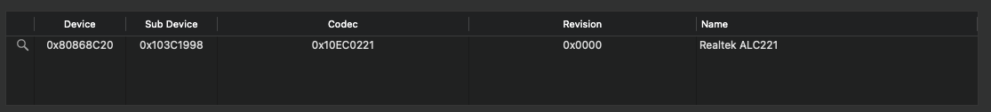

12 hours ago, robi62 said:
Hi does audio work with hdmi or dp?? Mine does not only with speakers
Hi,
Didn't check because I use only internal audio with Layout 11. DP monitor connection is in use only for screen. AppleALC works only in version 1.9.1, 1.9.2 has no audio at all, checked all layouts 11, 15 and 88.
Now I see that something however does not work... as iPhone Mirroring 😅
Edited by notobo

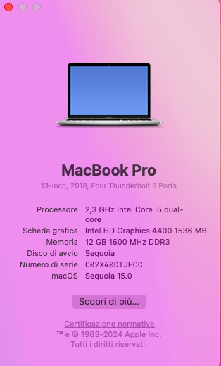

Hi,
here the same problem. GA-X48-DQ6 with a Q9550, GTX760 and Broadcom Wifi/BT. Sonoma 14.6.1 working without issues but afte the update to Sequoia I have a KP in rhe ACPI. Using bott arg CPUS=1 it boots well (after applying OCLP 2.0.1), with Wifi/BT enabled, but with only 1 core it's practically not usable.
I've seen that CpuTscSync.kext has been updated with commits adding sequoia, but the latest release is still 1.1.0. Could someone compile the latest code please? I'm not skilled on that.
Maybe that is the solution...
thx

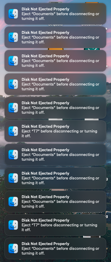

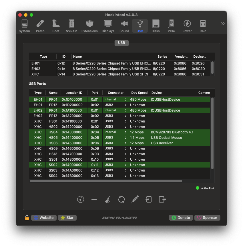

10 hours ago, Irish_Man said:
Anyone knows how to fix this? It happens after awake. Does it means that USB ports are out of power while in sleep mode?

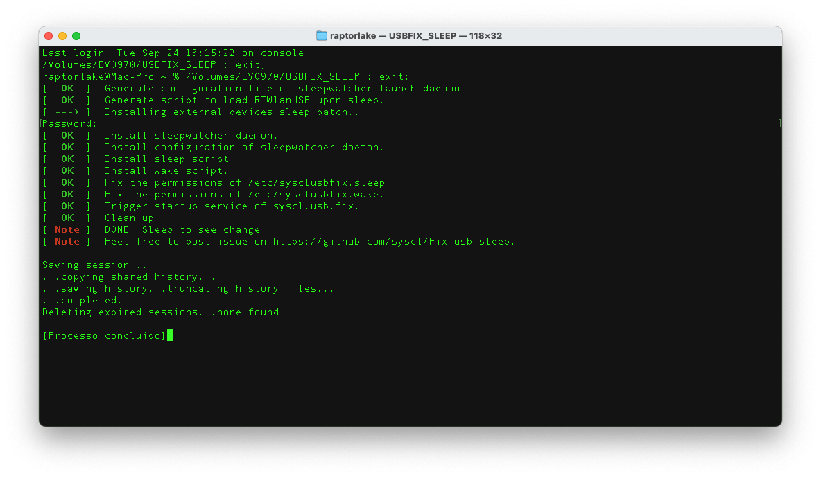

Hi @Irish_Man I almost sure that is your USB mapping, but can I suggest you run a little bit script ? Works to me in some cases, especially to make sleep perfect.
Here executable script:
Spoiler

USBFIX_SLEEP App for made more easily (double click and password)
USBFIX_SLEEP.zip
  • Like 4
  • Thanks 1

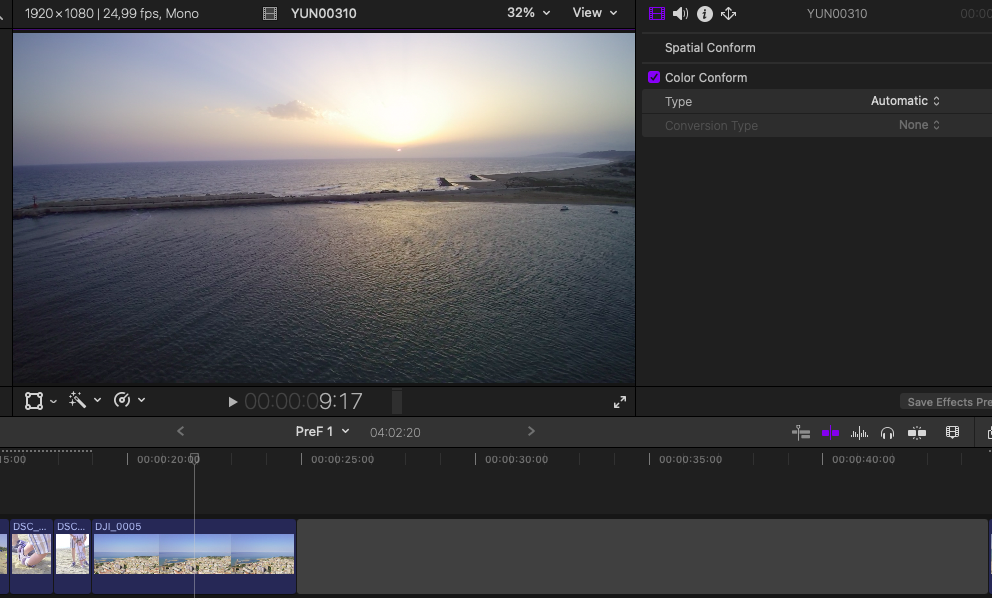

After I did the update to 15.0  I found that I had video tearing in DaVinci Resolve, along with random frame flashes. Never experienced it before with my RX 6900XT + RX 6800. I had to roll back to 14.7 for the time being. I was able to get bluetooth working via the suggested steps above. Hopefully an OC + Kext update helps with this video issue.
17 hours ago, Austere.J said:
@Max.1974 I usually make .aml for my ports but, tbh I forgot how to make one. It was a long time since I've done it. I'll double check my USBport.kext.
Even my sleep/awake is fine I did ran the script, thank you.

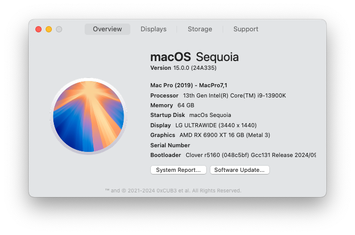

@Scipher I have been using AMD RX 6900 XT Aorus and until now its running fine with Clover, a feel days ago i proceed a firmware release update, and not get errors. Need use Windows and AMD oficial tools.
  • Like 3
I tried doing a Windows AMD update which was available. But it appears to be the boot arg -lilubetaall  that causes glitches and tearing with video in DaVinci Resolve with my RX 6900xt and 6800. I'l just have to wait until a new bluetoolfixup is available to avoid the -lilubetaall   argument.
Inspection of BluetoolFixup.cpp reveals boot-arg -btlfxbeta.  If the problem for you is -lilubetaall and you're using it only for BluetoolFixup.kext, maybe you can try boot-arg -btlfxbeta instead.
