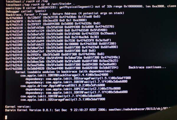

0xdeadbeef Posted June 11, 2007 Share Posted June 11, 2007 MCP55? Writing on SATA? Can you send to me your kext? Please... x.x It's the normal kext. I just installed it coz i didn't know any better. BTW I have no pata drives installed. Screenshot of the panic attached - first line is cropped should say "panic(cpu 0 caller 0x003A1CEB): getPhysicalSegment() out of 32b range 0x10000000, len 0xa3000, class IOGeneralMemoryDescriptor" Link to comment https://www.insanelymac.com/forum/topic/35985-darwin-nforce4-atasata-controller/page/30/#findComment-382179 Share on other sites More sharing options...

0xdeadbeef Posted June 14, 2007 Share Posted June 14, 2007 "panic(cpu 0 caller 0x003A1CEB): getPhysicalSegment() out of 32b range 0x10000000, len 0xa3000, class IOGeneralMemoryDescriptor" This panic can be worked around by setting "Kernel Parameters"<->"maxmem=2048" in com.apple.boot.plist It's a problem that only shows itself on machines with >2.5GB RAM when getPhysicalSegment() only will return a 32-bit address. solution is to use getPhysicalSegment64() or IODMACommand() instead. references: http://lists.apple.com/archives/darwin-dri...t/msg00006.html Example driver code (ADC): https://connect.apple.com/cgi-bin/WebObject...?bundleID=19672 Link to comment https://www.insanelymac.com/forum/topic/35985-darwin-nforce4-atasata-controller/page/30/#findComment-384876 Share on other sites More sharing options...
