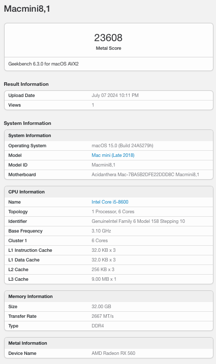

deeveedee Posted July 8, 2024 Author Share Posted July 8, 2024 (edited) I added two dGPU DeviceProperties to my OC config.plist in an attempt to squeeze more performance out of the RX560x. I don't know if either of these properties is applicable to our RX560x, but after adding the properties, I observed the highest GB6 Metal benchmark that I've seen on this hack so far: Spoiler This new GB6 score may be a slight improvement, but the change is too small to be conclusive. Maybe others can test. I ignored warnings that I read about enabling PP_DisablePowerContainment, so proceed with testing at your own risk. EDIT: I re-ran GFXMetal benchmark with the added DeviceProperties. Some benchmarks were better and some worse. Again, inconclusive. EDIT2: I re-ran GB6 benchmark after setting PP_WorkLoadPolicy_Mask = <20> instead of <40> (I misread this guide). No noticeable difference. Edited July 8, 2024 by deeveedee 1 Link to comment https://www.insanelymac.com/forum/topic/359277-hp-elitedesk-800-g4-g5-mini-with-rx560x-dgpu-hackintosh/page/5/#findComment-2822395 Share on other sites More sharing options...
ird Posted July 9, 2024 Share Posted July 9, 2024 On 7/7/2024 at 5:34 PM, deeveedee said: I added two dGPU DeviceProperties to my OC config.plist in an attempt to squeeze more performance out of the RX560x. I don't know if either of these properties is applicable to our RX560x, but after adding the properties, I observed the highest GB6 Metal benchmark that I've seen on this hack so far: Reveal hidden contents This new GB6 score may be a slight improvement, but the change is too small to be conclusive. Maybe others can test. I ignored warnings that I read about enabling PP_DisablePowerContainment, so proceed with testing at your own risk. EDIT: I re-ran GFXMetal benchmark with the added DeviceProperties. Some benchmarks were better and some worse. Again, inconclusive. EDIT2: I re-ran GB6 benchmark after setting PP_WorkLoadPolicy_Mask = <20> instead of <40> (I misread this guide). No noticeable difference. I'd doubt 0x20 vs 0x40 for WorkLoadPolicy_Mask would make a difference as both VR and Compute will likely put the GPU in "high perf" mode. You'd want to try 0x4 instead (Power saving). I used that and GB6 Metal score on Sonoma dropped to ~18K down from ~23K. However, after a few days for some strange reason it's back up to 23K. So, I myself, am confused if this is just snake oil... inconclusive so far. Re: my displayport issues and turning on of the dGPU connected monitor - I've made no meaningful progress so far in fixing it. I've been reading quite a bit about displayport though. It does seem that DP as a whole is quite finicky when it comes to synchronization and some combinations of GPU DP connectors and monitors might have an issue negotiating the sync. Need more debugging... Link to comment https://www.insanelymac.com/forum/topic/359277-hp-elitedesk-800-g4-g5-mini-with-rx560x-dgpu-hackintosh/page/5/#findComment-2822467 Share on other sites More sharing options...

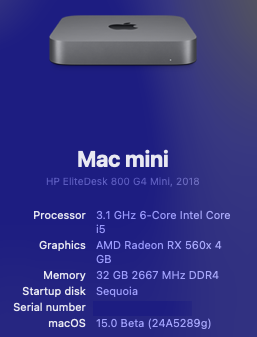

deeveedee Posted July 10, 2024 Author Share Posted July 10, 2024 (edited) Upgrade from Sequoia Beta 2 to Sequoia Beta 3 proceeded without issues. My baseline configuration remains SMBIOS macMini8,1 with both dGPU and iGPU ports fully enabled for multi-display operation. About This Hack: Sequoia Beta 3 Spoiler Important for this upgrade: Latest Acidanthera kexts from here or -lilubetaall boot arg RestrictEvents.kext 1.1.3 with -revbeta or -lilubetaall boot-arg and revpatch=sbvmm NVRAM property. Alternatively, use RestrictEvents.kext 1.1.4 from lorys89. RE and sbvmm not needed if using SMBIOS iMac19,x (which does not have T2 chip). Misc > Security > SecureBootModel = Disabled when applying upgrade. Can be enabled after upgrade is finished EDIT: The EFI attached to Post #1 satisfies the requirements for installing / upgrading Sequoia. If you used one of my iMac19,x sample EFIs, you may need to upgrade one or more kexts, since I did not focus on posting a final EFI version for iMac19,x. EDIT2: I re-ran GeekBench6 Metal benchmark after upgrading from Sequoia Beta 2 -> Beta 3. My Metal benchmark dropped to 18K (from 23K in Sequoia Beta 2). After a reboot and NVRAM Reset (not sure which did the trick), GB6 Metal benchmarks are consistently at 23K as expected. Edited July 11, 2024 by deeveedee Added RE sbvmm note for iMac19,x 3 Link to comment https://www.insanelymac.com/forum/topic/359277-hp-elitedesk-800-g4-g5-mini-with-rx560x-dgpu-hackintosh/page/5/#findComment-2822530 Share on other sites More sharing options...

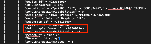

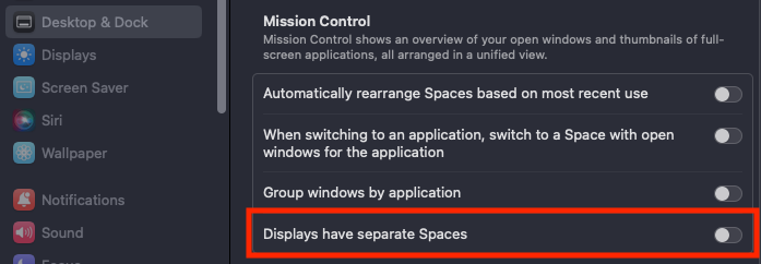

ird Posted July 12, 2024 Share Posted July 12, 2024 On 7/10/2024 at 4:11 AM, deeveedee said: Please describe your testing methodology so that I and others can attempt to duplicate. See EDIT3 and EDIT4 below. EDIT: I wasn't suggesting that you use iGPU ports - just configure them with "headed" frame buffer, but leave them unused to see if that affects the powered-off monitor behavior that you are observing with the dGPU-connected display. EDIT2: When you describe your testing methodology, include Apps (hopefully some that are free and easy to download) that you use to confirm that video encoding / decoding is being performed by AMD and not Intel iGPU Apps that you use to measure video encoder power consumption Techniques you used to try to force Intel encoding (e.g., defaults write com.apple.AppleGVA forceIntel -boolean yes) References that you might suggest to learn more about this (e.g., this, this, this). I'm not a Video encoder / decoder expert, so I'll be learning. Configuration for each test (SMBIOS, headed/headless iGPU frame buffer, BIOS settings for iGPU/dGPU), video-connected iGPU/dGPU ports, boot-args, DeviceProperties) Since this will potentially be a lot of info, you can create a post and then continue to add to / edit the original post as you have more info. EDIT3: @ird I re-tested with SMBIOS iMac19,2 and headless iGPU framebuffer. Sleep / Wake works perfectly with or without my DAGPM.kext. I have edited my Known Issues to remove the wake issue with iMac19,x / headless iGPU. EDIT4: @ird I tested my hack booting with SMBIOS iMac19,2 and headless iGPU frame buffer (0x3e920003). I am able to completely boot macOS Sequoia Beta 2 with the dGPU-connected monitor powered off. After waiting for macOS to boot, I can power-on the dGPU-connected display with no issues (no black screen). The login window appears normally on the display and I login. Please post your EFI if you want further help to diagnose this issue with your hack. Also, please post your EFI with each new request for help. Sorry for the delay. After much fighting with this issue, I was able get it resolved. Turns out it was an issue with my monitor firmware! I updated it and everything seems good now. Pro-tip: if you are having any such issues don't forget to get firmware updates for your monitor! I know most of us will seldom suspect this to be the culprit. 1 Link to comment https://www.insanelymac.com/forum/topic/359277-hp-elitedesk-800-g4-g5-mini-with-rx560x-dgpu-hackintosh/page/5/#findComment-2822641 Share on other sites More sharing options...
deeveedee Posted July 12, 2024 Author Share Posted July 12, 2024 (edited) @ird Glad that solved your display issues. I'd still like to know how to duplicate your observed iGPU/dGPU CODEC issues. If you want others to test, provide testing details and your current EFI as stated here. On a separate note, my multi-display experience with Sequoia Beta 3 is outstanding. For those who want multiple displays to behave as one large, continuous display (including allowing windows to span displays), you'll need to disable System Settings > Desktop & Dock > Mission Control > Displays have separate spaces. Spoiler EDIT: Note that if "Displays have separate Spaces" is disabled, the auto-hidden dock appears only on the main display. If you want the auto-hidden dock to appear on all displays, enable "Displays have separate Spaces." EDIT2: This "Displays have separate Spaces" setting (Enabled) is why I wasn't seeing the auto-hidden Dock on each display in Sonoma. Enabling "Displays have separate Spaces" in Sonoma also shows the auto-hidden Dock on each display. Edited July 12, 2024 by deeveedee 2 Link to comment https://www.insanelymac.com/forum/topic/359277-hp-elitedesk-800-g4-g5-mini-with-rx560x-dgpu-hackintosh/page/5/#findComment-2822665 Share on other sites More sharing options...

deeveedee Posted July 15, 2024 Author Share Posted July 15, 2024 @ird I will review your testing methodology and try to duplicate it over the next week. By the way, the reason that I chose headless framebuffer 0x3e920003 (and not Dortania's recommend 0x3e910003) is because 0x3e920003 is what is used in a real iMac19,x. Real iMac19 IOReg dump (from AppleLife): I don't think it should make a difference, but that might be something else you want to change and test. 2 Link to comment https://www.insanelymac.com/forum/topic/359277-hp-elitedesk-800-g4-g5-mini-with-rx560x-dgpu-hackintosh/page/5/#findComment-2822785 Share on other sites More sharing options...
