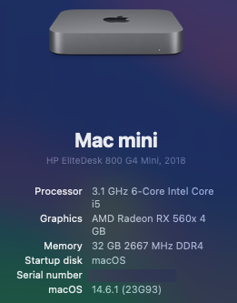

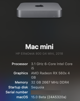

deeveedee Posted August 7, 2024 Author Share Posted August 7, 2024 Easy upgrade to Sonoma 14.6.1 with SecureBootModel=Disabled. Spoiler 1 Link to comment https://www.insanelymac.com/forum/topic/359277-hp-elitedesk-800-g4-g5-mini-with-rx560x-dgpu-hackintosh/page/8/#findComment-2823799 Share on other sites More sharing options...

ird Posted August 11, 2024 Share Posted August 11, 2024 On 8/7/2024 at 2:52 PM, deeveedee said: Easy upgrade to Sonoma 14.6.1 with SecureBootModel=Disabled. Reveal hidden contents Just curious if incremental updates work for you; they don't for me. After 2 tries, macOS downloads the full installer that installs fine. Link to comment https://www.insanelymac.com/forum/topic/359277-hp-elitedesk-800-g4-g5-mini-with-rx560x-dgpu-hackintosh/page/8/#findComment-2823951 Share on other sites More sharing options...
deeveedee Posted August 11, 2024 Author Share Posted August 11, 2024 @ird Yes - they work for Sonoma and Sequoia Beta - no issues. Please post your current EFI if you'd like help. Link to comment https://www.insanelymac.com/forum/topic/359277-hp-elitedesk-800-g4-g5-mini-with-rx560x-dgpu-hackintosh/page/8/#findComment-2823953 Share on other sites More sharing options...
ird Posted August 11, 2024 Share Posted August 11, 2024 24 minutes ago, deeveedee said: @ird Yes - they work for Sonoma and Sequoia Beta - no issues. Please post your current EFI if you'd like help. Interesting. They don't for me. My EFI is the same as posted above in this post. While I use RestrictedEvents.kext, the only explicit boot args I use is to block media process (revblock=media). I wonder if it has to do something with the revpatch=sbvmm key under NVRAM > 4D1FDA02-38C7-4A6A-9CC6-4BCCA8B30102. Link to comment https://www.insanelymac.com/forum/topic/359277-hp-elitedesk-800-g4-g5-mini-with-rx560x-dgpu-hackintosh/page/8/#findComment-2823954 Share on other sites More sharing options...

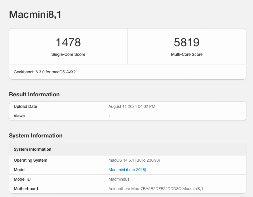

deeveedee Posted August 11, 2024 Author Share Posted August 11, 2024 I just ran GeekBench 6 CPU Benchmark after upgrading to Sonoma 14.6.1. The performance of the i5-8600 65W CPU with 230W power adapter and 32GB RAM is impressive. Not only does it score reasonably well in synthetic benchmarks, but this hack with RX 560x is extremely responsive. Spoiler 3 Link to comment https://www.insanelymac.com/forum/topic/359277-hp-elitedesk-800-g4-g5-mini-with-rx560x-dgpu-hackintosh/page/8/#findComment-2823975 Share on other sites More sharing options...
ird Posted August 11, 2024 Share Posted August 11, 2024 6 hours ago, deeveedee said: rev patch=sbvmm is necessary for MM8,1 hack to be notified about macOS updates in Sonoma and Sequoia. I don't know if you need it for iM19,2 (which does not have T2). I'm not sure. EDIT: I diff'd our config.plists, but there are too many cosmetic differences for comparison. IF you don't figure it out, see if you can start with my config.plist and make the minimal changes for easy comparison. EDIT2: I did notice that you use OpenHFsPlus.efi driver. I think you'll get better HFS performance with HfsPlus.efi. EDIT3: Does changing SecureBootModel->Disabled affect the OTA behavior for you? I don't think it should, since you're using iMac19,2, but you may want to test that. Yes, I'll try to experiment with a few options to see if it solves the issue. Also, thanks for the tip on HfsPlus.efi. I'll certainly switch. I need to have SecureBootModel set to Disabled to be able to successfully install OTA. That's something I do just before updating the machine but otherwise leave it enabled after installation all the time, so not much I can change to experiment there. Link to comment https://www.insanelymac.com/forum/topic/359277-hp-elitedesk-800-g4-g5-mini-with-rx560x-dgpu-hackintosh/page/8/#findComment-2823979 Share on other sites More sharing options...
ird Posted August 11, 2024 Share Posted August 11, 2024 1 hour ago, deeveedee said: I just ran GeekBench 6 CPU Benchmark after upgrading to Sonoma 14.6.1. The performance of the i5-8600 65W CPU with 230W power adapter and 32GB RAM is impressive. Not only does it score reasonably well in synthetic benchmarks, but this hack with RX 560x is extremely responsive. Reveal hidden contents I agree 100%. Here's my story: I'd been using an AMD hack for quite some time, but I needed something smaller and with moderate power consumption as I downsized my desk. I've been very happy with my Macbooks since over 2 decades, so a MacMini was an obvious choice for me. While there is no debate on the goodness of performance to power ratio of the M2/M2 Pro MacMini, except the base model I couldn't justify the price of upgrades esp. the storage and RAM both of which were non-negotiable for me. Considering that the current mini is almost 2 generations old with literally no meaningful price cuts, it's a hard pill to swallow. My next natural choice was a miniPC with moderate expansion capabilities that I could hack so I got the HP Elitedesk 800 G5 mini last year and while it offered the RAM and storage expansion options, its extremely weak UHD630 GPU struggled to drive a display anything above 1080p so I gave up on that. This G4 Mini with RX560X has been just the perfect machine for everything I do and Apple's own negligence and non-sensical price pushed me towards hack. I have no plans to upgrade until I can no longer use this current machine for my every tasks. 1 Link to comment https://www.insanelymac.com/forum/topic/359277-hp-elitedesk-800-g4-g5-mini-with-rx560x-dgpu-hackintosh/page/8/#findComment-2823981 Share on other sites More sharing options...

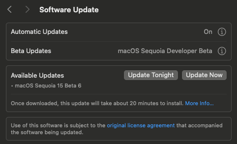

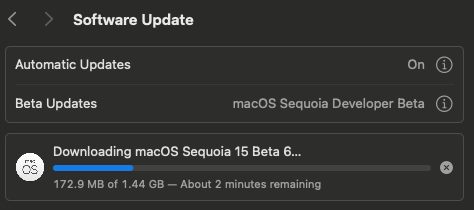

deeveedee Posted August 12, 2024 Author Share Posted August 12, 2024 (edited) I received notification of Sequoia Beta 6 update availability. Spoiler Note that the update is incremental (not the full installer). Spoiler EDIT: Very fast update from Sequoia Beta 5 -> Beta 6. No issues. Spoiler Note that after upgrading from Beta 5 -> Beta 6 (as with all Betas), I disable Apple Analytics reporting (System Settings > Privacy & Security > Analytics & Improvements) (move slider to off): Spoiler Edited August 12, 2024 by deeveedee 1 Link to comment https://www.insanelymac.com/forum/topic/359277-hp-elitedesk-800-g4-g5-mini-with-rx560x-dgpu-hackintosh/page/8/#findComment-2824011 Share on other sites More sharing options...
deeveedee Posted August 12, 2024 Author Share Posted August 12, 2024 After upgrading to Sequoia Beta 6, I am able to access the EFI with the normal 'sudo diskutil mount' (mkdir EFI and special msdos type not required). It's possible that Sequoia Beta 6 fixed a problem introduced with Beta 5. Continuing to monitor this before making a final conclusion. 2 Link to comment https://www.insanelymac.com/forum/topic/359277-hp-elitedesk-800-g4-g5-mini-with-rx560x-dgpu-hackintosh/page/8/#findComment-2824019 Share on other sites More sharing options...
ird Posted August 13, 2024 Share Posted August 13, 2024 7 hours ago, deeveedee said: I received notification of Sequoia Beta 6 update availability. Reveal hidden contents Note that the update is incremental (not the full installer). Reveal hidden contents EDIT: Very fast update from Sequoia Beta 5 -> Beta 6. No issues. Reveal hidden contents Note that after upgrading from Beta 5 -> Beta 6 (as with all Betas), I disable Apple Analytics reporting (System Settings > Privacy & Security > Analytics & Improvements) (move slider to off): Reveal hidden contents All the reading I've done so far seems to point to BlueToolFixup.kext as the culprit for incremental updates failing and forcing a full update (after of course, disabling SecureBootModel). Seems to be orthogonal to what SMBIOS one uses (so MacMini8,1 users should also see the same issue if they use BT). I will have to wait until Apple issues the next incremental update to confirm this theory. Link to comment https://www.insanelymac.com/forum/topic/359277-hp-elitedesk-800-g4-g5-mini-with-rx560x-dgpu-hackintosh/page/8/#findComment-2824032 Share on other sites More sharing options...

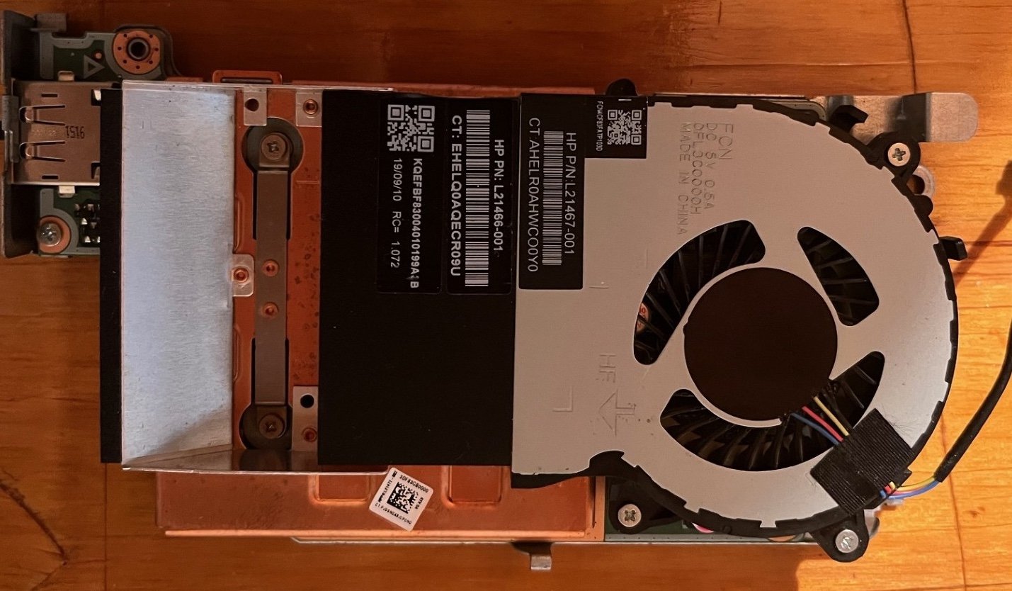

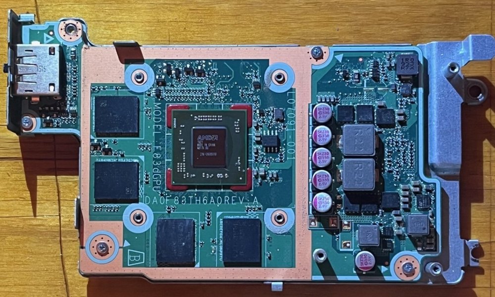

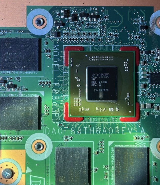

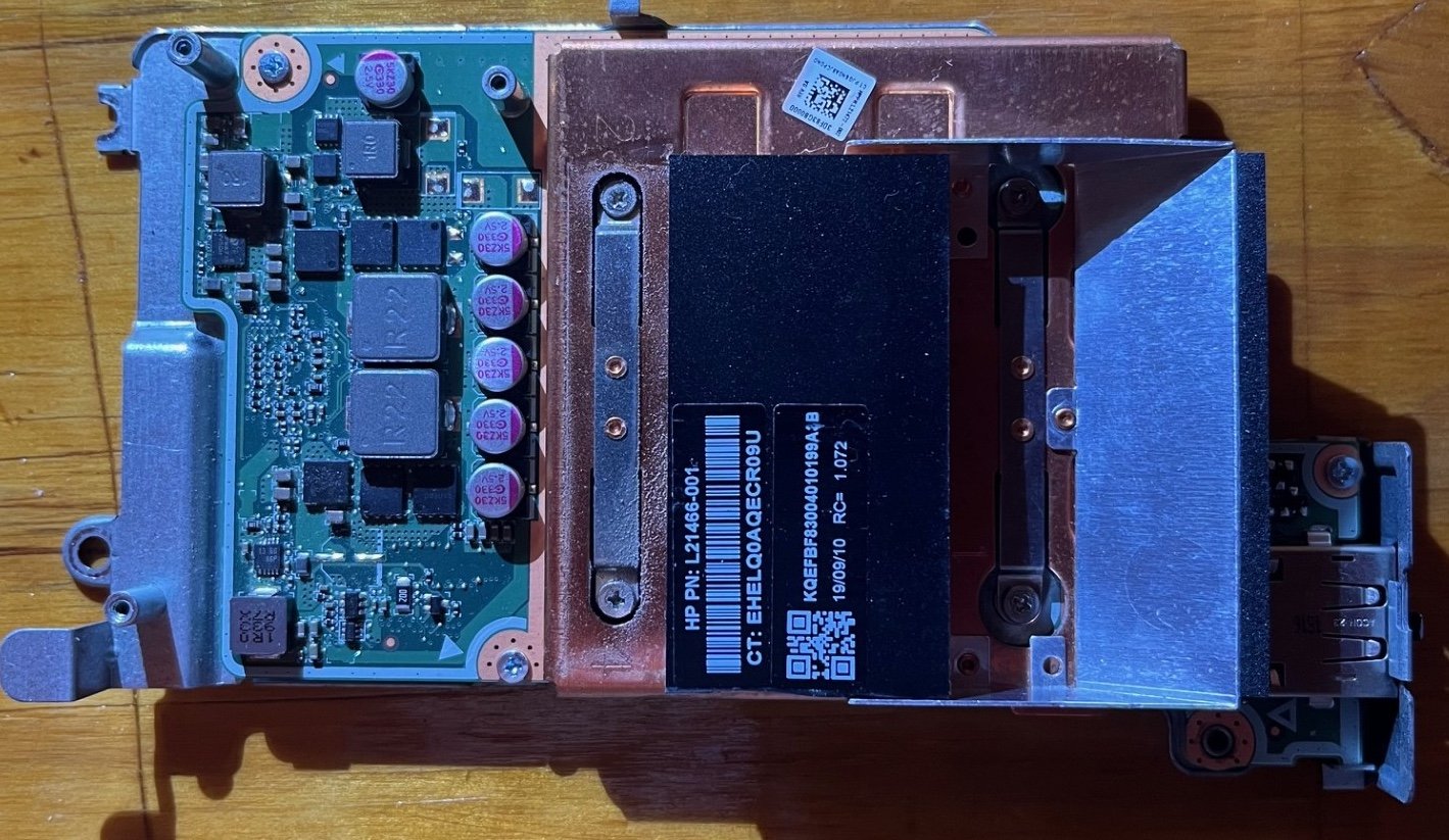

deeveedee Posted August 15, 2024 Author Share Posted August 15, 2024 I disassembled my RX560x card to capture the photos below (and to clean-off the dust and apply new thermal paste). The variant of the AMD chipset on this card (with AMD 216-0909018) is the "embedded" version that is also on the Lenovo Yoga All-In-One motherboard. Based on brief searching, it appears that our RX560x chipset is different from what would normally be on a discrete RX560 graphics card. I haven't searched extensively for chipset specs and am hoping that based on these photos, others might determine more about our RX560x. Spoiler Spoiler Spoiler Spoiler 2 Link to comment https://www.insanelymac.com/forum/topic/359277-hp-elitedesk-800-g4-g5-mini-with-rx560x-dgpu-hackintosh/page/8/#findComment-2824124 Share on other sites More sharing options...
