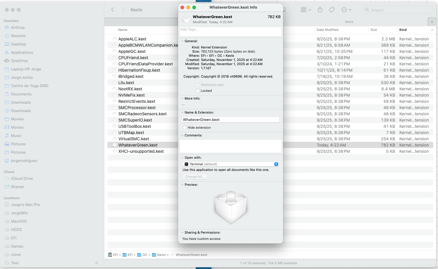

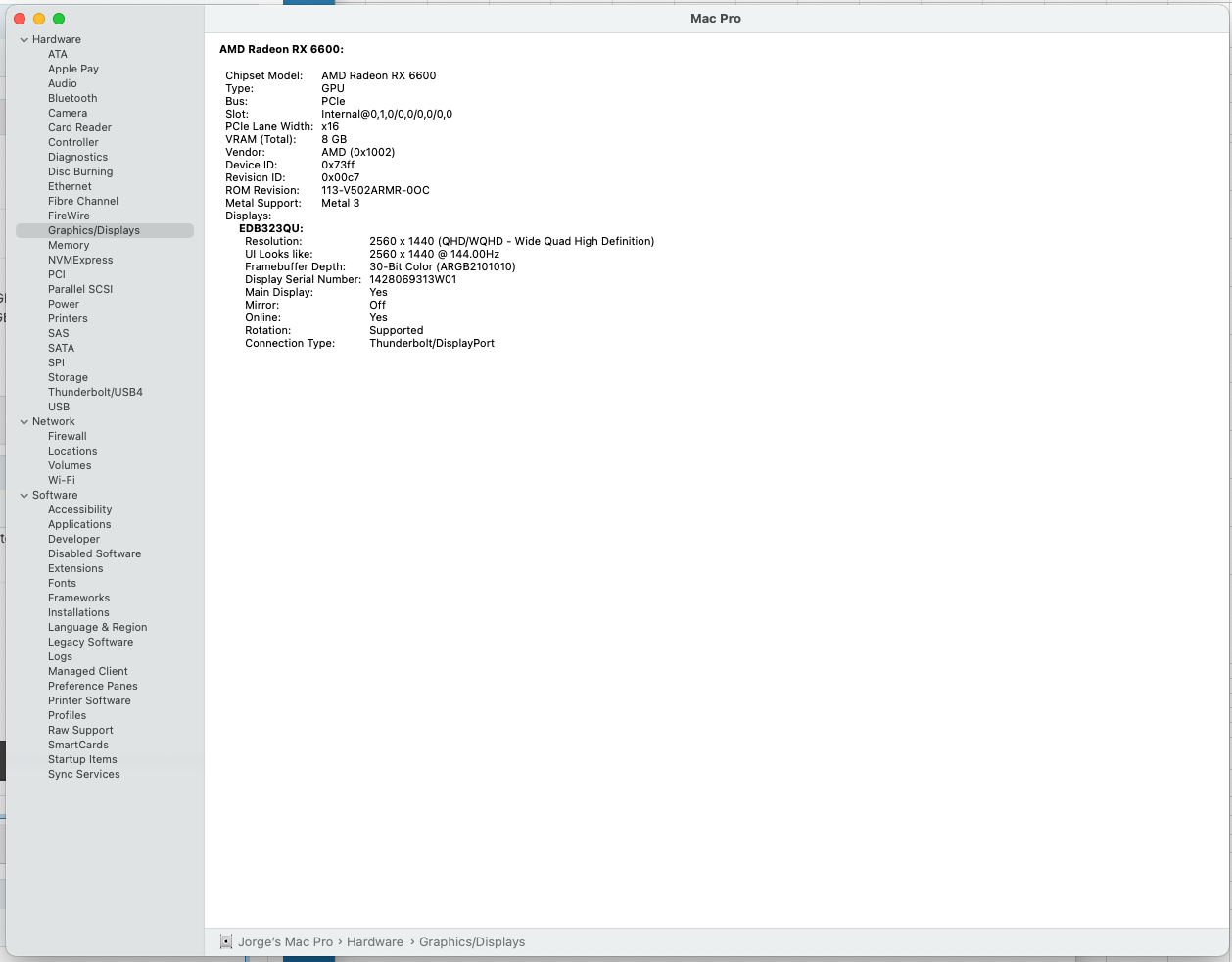

jlrycm Posted November 1, 2025 Share Posted November 1, 2025 (edited) 12 minutes ago, laobamac_yyds said: ok It seems like a new problem that has never been encountered before. Please provide me with your hardware information. Thank you for your testing. @laobamac_yyds As requested, MSI Z590-A Pro, i9-10900K, 64 GB RAM and below is the dGPU information and panic log. I disabled NootRX before I booted using WEG.Kernel-2025-11-01-123400.panic Spoiler Edited November 1, 2025 by jlrycm Link to comment https://www.insanelymac.com/forum/topic/361713-pre-release-macos-tahoe-261/page/9/#findComment-2843085 Share on other sites More sharing options...

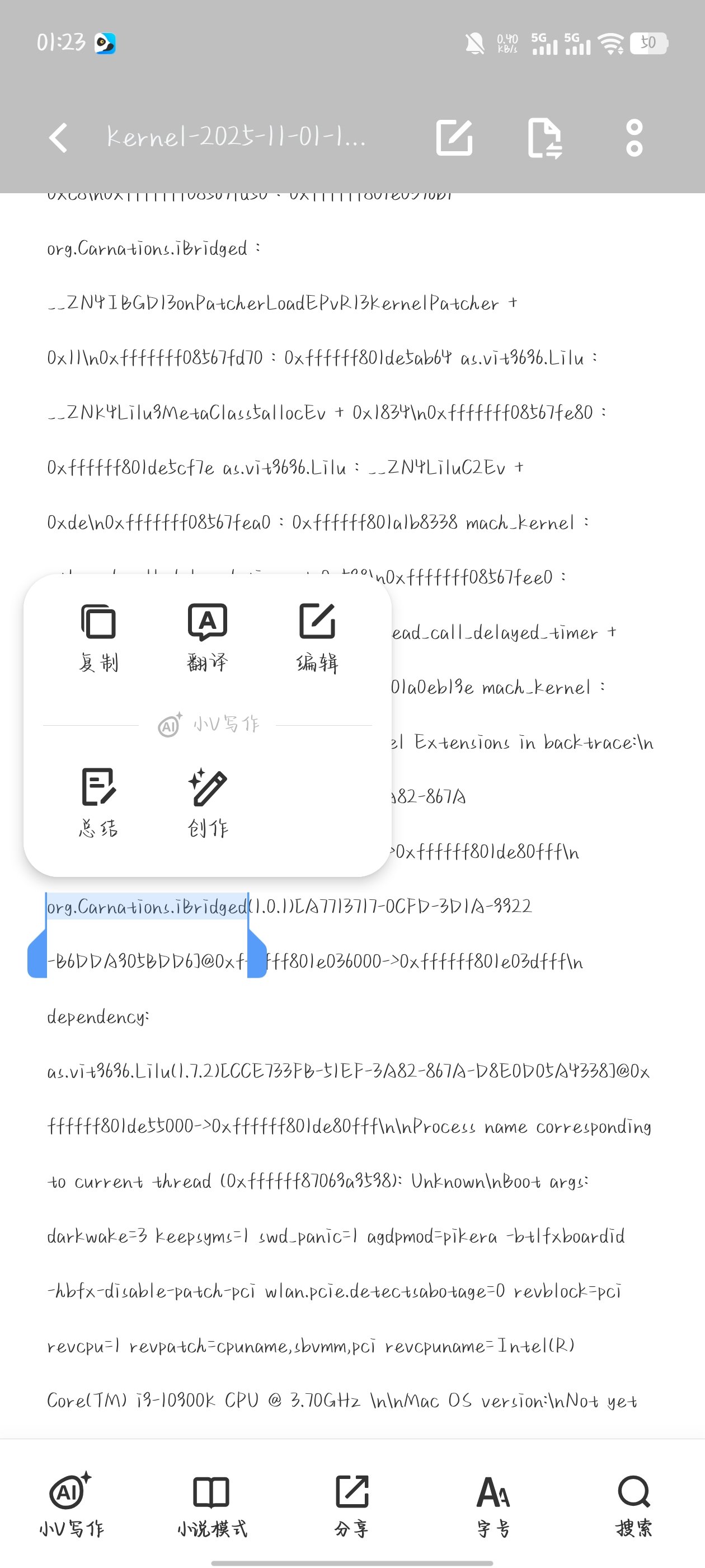

laobamac_yyds Posted November 1, 2025 Share Posted November 1, 2025 3 minutes ago, jlrycm said: I tried again, here is the panic log Kernel-2025-11-01-132807.panic It seems that there are still other things in the log that caused the crash, look at the selected content in my picture.What is this? Link to comment https://www.insanelymac.com/forum/topic/361713-pre-release-macos-tahoe-261/page/9/#findComment-2843088 Share on other sites More sharing options...
jlrycm Posted November 1, 2025 Share Posted November 1, 2025 3 minutes ago, laobamac_yyds said: It seems that there are still other things in the log that caused the crash, look at the selected content in my picture.What is this? I disabled the ibridged.kext and now macOS loaded without issues. Clearly the ibridged.kext and the WEG kext cannot co-exist. I enabled this ibridged.kext to test if it works and forgot it was still enabled. 2 Link to comment https://www.insanelymac.com/forum/topic/361713-pre-release-macos-tahoe-261/page/9/#findComment-2843089 Share on other sites More sharing options...
