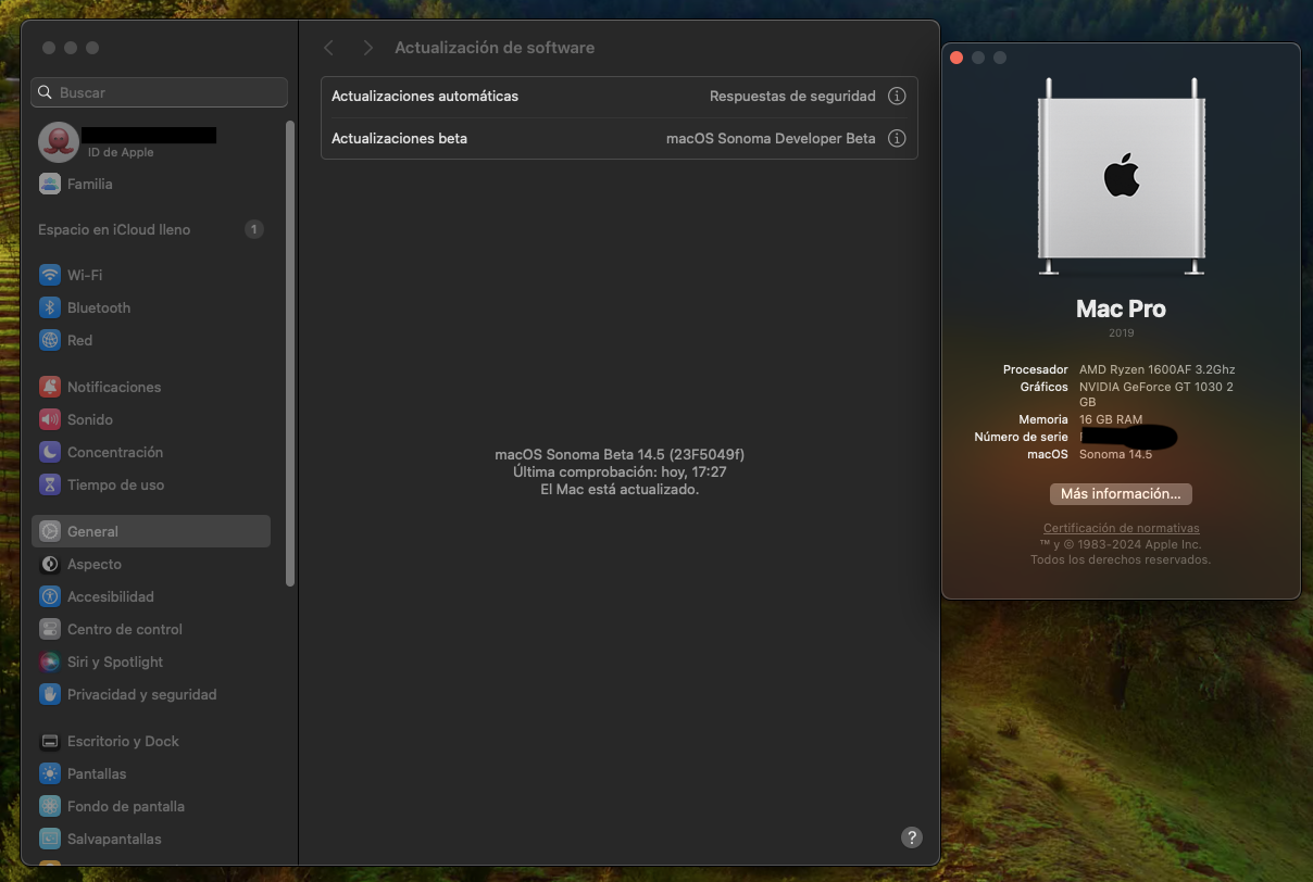

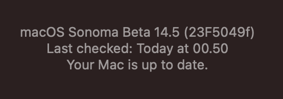

Today I was bored, and since I haven't played installing MacOS in a while, so as not to forget how to do it... I installed it on my NAS with UNRAID, transferring the GPU to MacOS and even though it is a GT1030 and patching the system with OCLP has been a great success... it works very well 😃
Capturadepantalla2024-04-15alas17_27_39.thumb.png.cabd3dbb9e86375924e51b6228dffa23.png

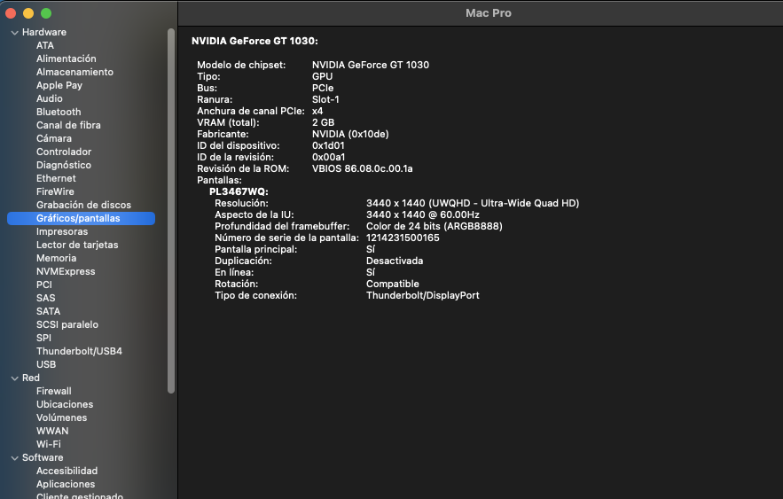

The only problem is that the GT1030 does not output audio through HDMI/DP with the patch... and it does not go above 60Hz when my monitor is 165Hz, but hey, to pass the time and test it is very good 👌
Greetings
OCLP injects High Sierra Nvidia web drivers to enable your GT1030 in Sonoma.  If you search for "AppleHDA HDMI Audio [Guide]" by Toleda (not in this forum), you may find a solution for audio.

I've already looked more or less at how I could solve it, but I don't see that it's an easy thing...
I have read some tutorial (quite old), and I see that they even use adapters?

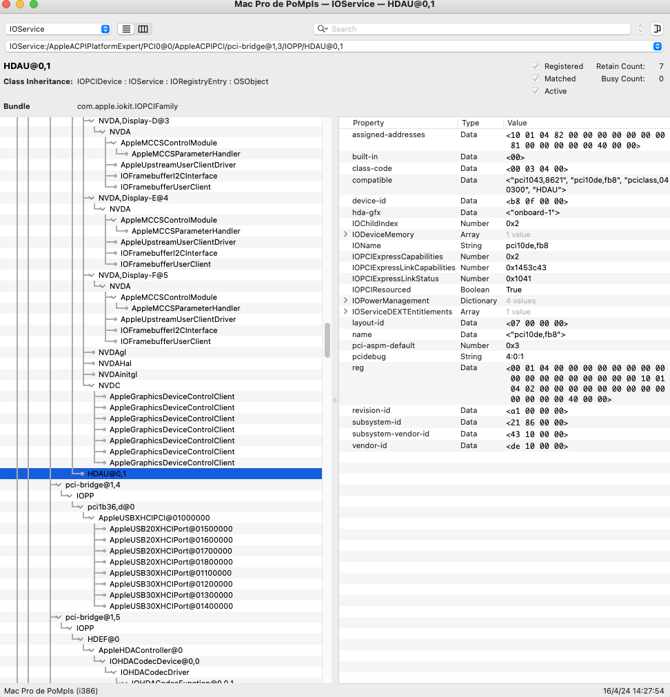

The audio device appears in IOReg:
Capturadepantalla2024-04-16alas14_28_00.thumb.png.0bbb94848bc7d0f890764d907e814ef4.png
Shouldn't at least Displayport audio work only with Nvidia drivers?
Someone who knows better can correct me if I'm wrong, but I don't think NVidia web drivers enable your hack's NVidia DP audio.  I think you'll need an independent audio solution (to enable your NVidia HDAU).
Edited by deeveedee
