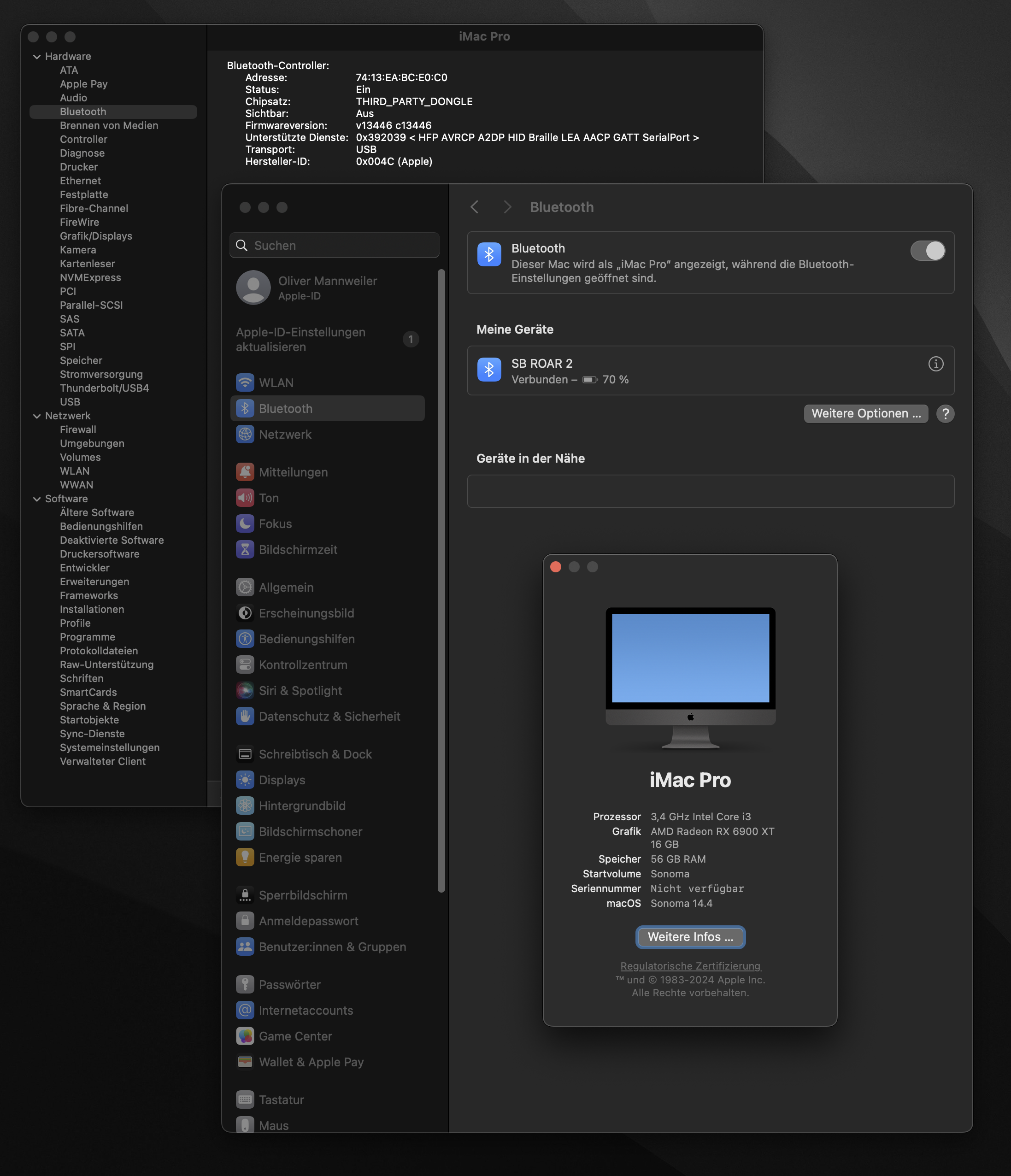

Max.1974 Posted March 22, 2024 Share Posted March 22, 2024 (edited) On 3/12/2024 at 3:05 PM, derpuma said: @Max.1974 Wow!!! I can not thank you enough. It indeed works now. Can you explain me what you exactly did? I saw that you put some new kext into the EFI. What do you mean is the change you did, that brought Bluetooth to life? Just for my understanding! I dropped you a PM... I am really happy now. I found two little Problems. One is, AppleALC is not working, so no onboard sound. Maybe something to to with the next error? Two errors in Validator: Kernel->Add[0]->BundlePath contains illegal character! Kernel->Add[3]->BundlePath contains illegal character! CheckKernel returns 2 errors! Completed validating /Volumes/EFI/EFI/OC/config.plist in 1 ms. Found 2 issues requiring attention. So the Problems are with AirPort Utility.kext and Bluetooth File Exchange.kext. Any Idea whats wrong there? I will look into that tomorrow... Hi @derpuma I talk with coder that create Kexts from Bluetooth and Airport to auxiliary and just rename free space from kexts and "error" from OCvalidate will fix that God bless you all Kexts names fixed in releases on GitHub https://github.com/hnanoto/Bluetooth-File-Exchange/releases/tag/1.0.1 And https://github.com/hnanoto/AirPort-Utility/releases/tag/1.0.1 Edited March 22, 2024 by Max.1974 2 Link to comment https://www.insanelymac.com/forum/topic/358024-sonoma-wi-fi-solutions-that-do-not-require-disabled-sip-eg-intel-ax210/page/7/#findComment-2818458 Share on other sites More sharing options...

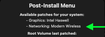

miliuco Posted June 10, 2024 Author Share Posted June 10, 2024 @Modmike Can you get the device-id? These are OCLP root patch compatible: Not needing AirportBrcmFixup: device-id 12e4,43ba >> BCM43602 device-id 12e4,43e3 >> BCM4350 device-id 12e4,43a0 >> BCM4360 (Fenvi cards) device-id 12e4,4331 >> BCM94331 device-id 12e4,4353 >> BCM943224. Needing AirportBrcmFixup: device-id 12e4,4357 >> BCM43225 device-id 12e4,43B1 >> BCM4352 device-id 12e4,43B2 >> BCM4352 (2.4 GHz). 2 Link to comment https://www.insanelymac.com/forum/topic/358024-sonoma-wi-fi-solutions-that-do-not-require-disabled-sip-eg-intel-ax210/page/7/#findComment-2820834 Share on other sites More sharing options...

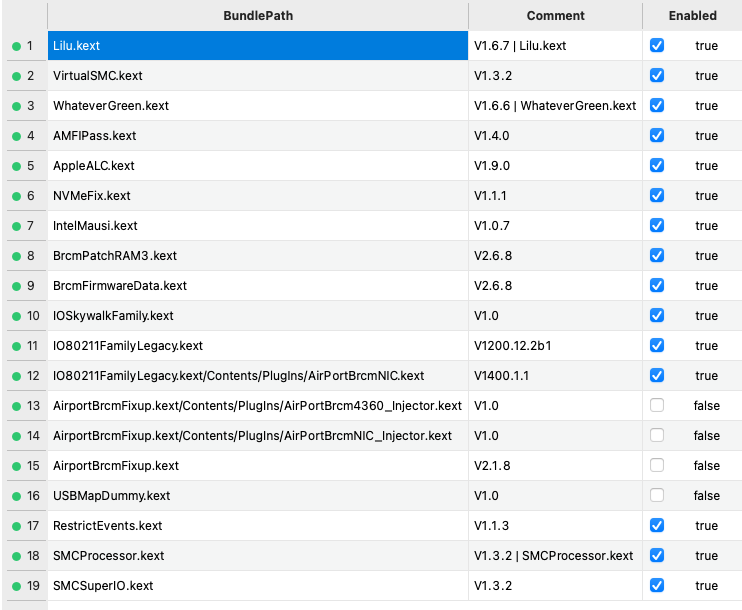

Modmike Posted June 11, 2024 Share Posted June 11, 2024 (edited) @miliuco Super frustrated, trying to get this to work for 1 week. Can you take a look at my kext list and let me know if they are in the right order and which ones I don't need? As mentioned before, my Broadcom is a BCM4352. I know some are disabled but I also tested enabled, neither way worked.. I suspect the airportbrcm are in the wrong order. I previously need the brcmpatchram3 so I left those in. Thanks! Edited June 11, 2024 by Modmike Link to comment https://www.insanelymac.com/forum/topic/358024-sonoma-wi-fi-solutions-that-do-not-require-disabled-sip-eg-intel-ax210/page/7/#findComment-2820924 Share on other sites More sharing options...
