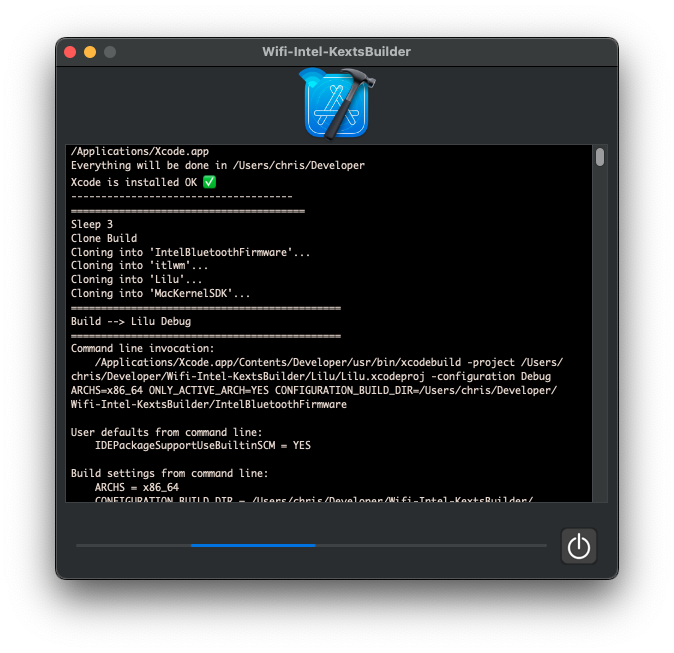

prcmelo Posted March 5, 2024 Share Posted March 5, 2024 On 2/29/2024 at 10:57 PM, Max.1974 said: Hi @prcmelo you can try use this program, works fine! https://github.com/Plutoberth/SonyHeadphonesClient/releases/tag/v1.3.2 @Max.1974 thank you, friend!!! I'm gonna have a look at this app! 👍🏻 1 Link to comment https://www.insanelymac.com/forum/topic/358024-sonoma-wi-fi-solutions-that-do-not-require-disabled-sip-eg-intel-ax210/page/4/#findComment-2817653 Share on other sites More sharing options...

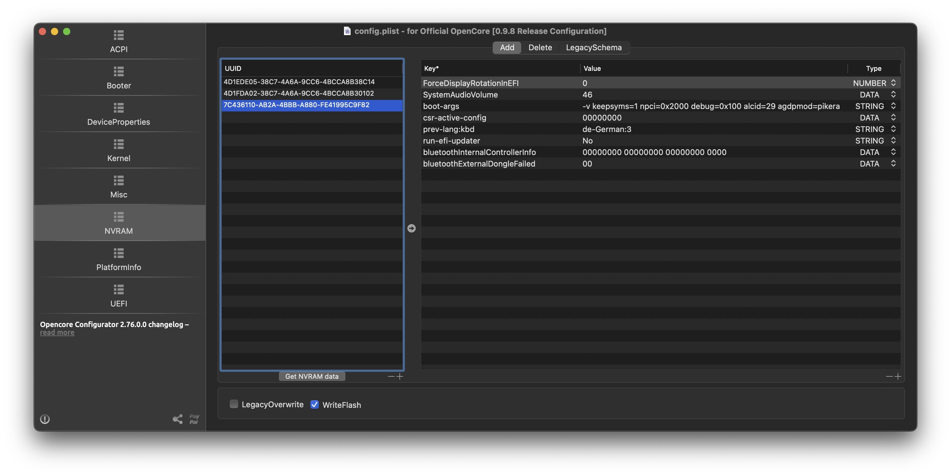

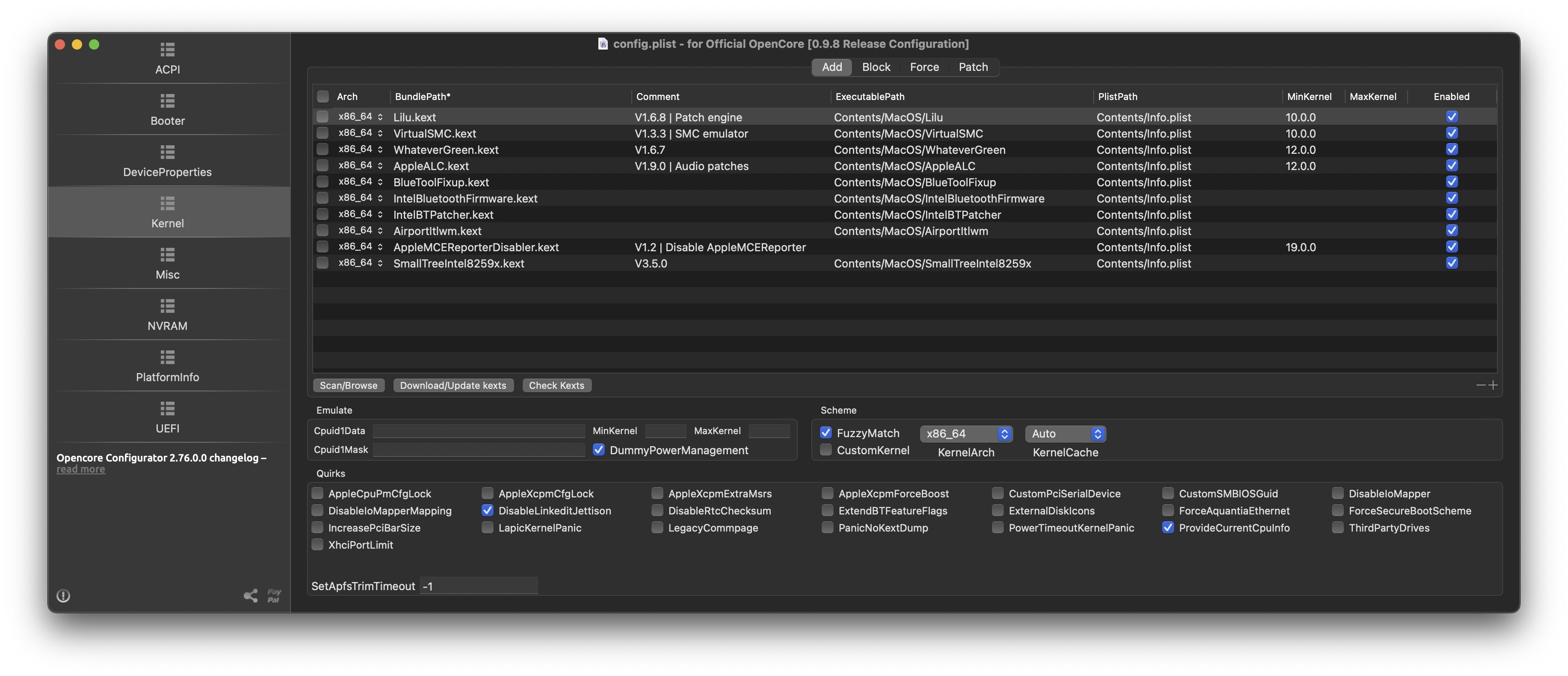

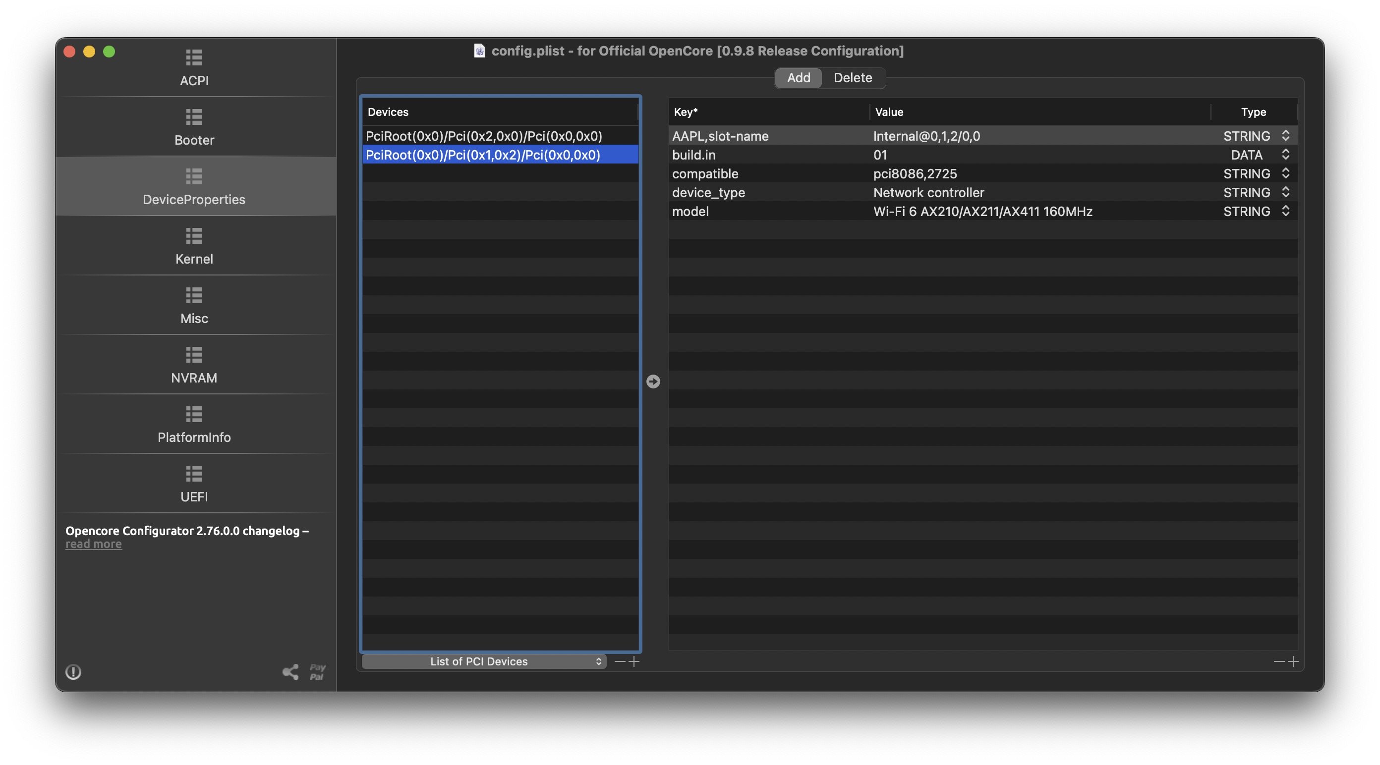

derpuma Posted March 5, 2024 Share Posted March 5, 2024 (edited) So my card arrived today. It is the Ziyituod AX210S. Wifi does work. Therefor I used the AirportItlwm.kext for Sonoma 14.3.x. I am on 14.3.1. Bluetooth does not work. I tried it with the OpenIntelWireless Kext 2.4.0 and 2.3.0. Any help with that? I attached my config.plist, if someone could look at it if something is wrong. Thx. config.plist Spoiler Edited March 5, 2024 by derpuma Link to comment https://www.insanelymac.com/forum/topic/358024-sonoma-wi-fi-solutions-that-do-not-require-disabled-sip-eg-intel-ax210/page/4/#findComment-2817657 Share on other sites More sharing options...

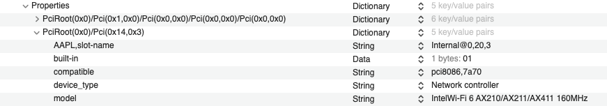

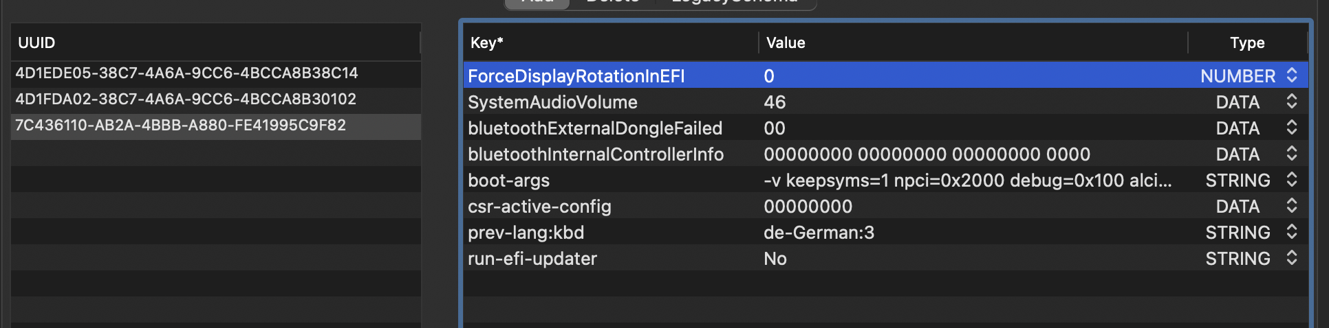

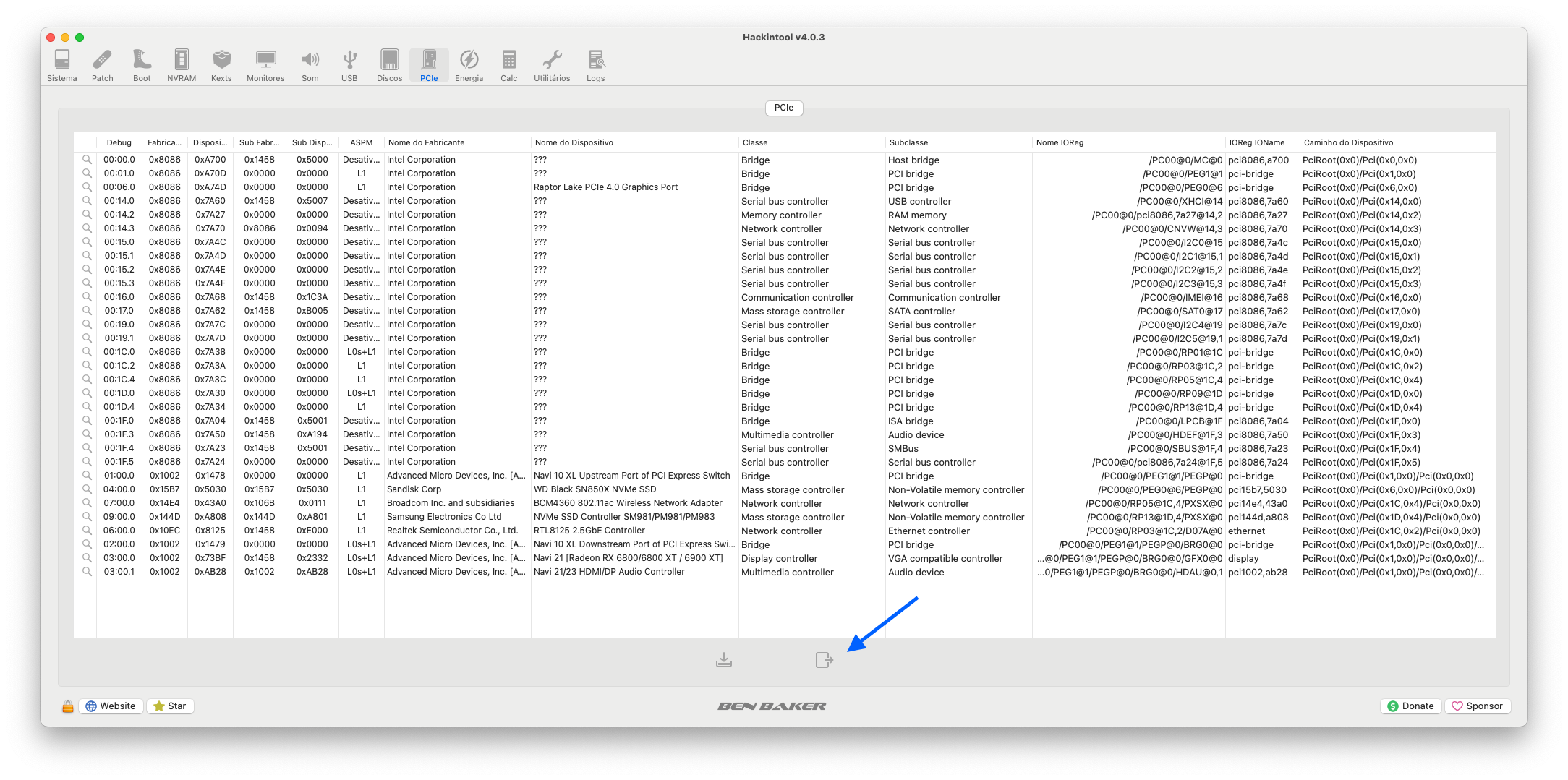

Max.1974 Posted March 5, 2024 Share Posted March 5, 2024 @derpuma Hi, are you try put in Device Properties the extraction from Hackintool about your Card? Check in Hackintool > PCie > and Export Button See: Spoiler After that take pcidevices.plist extracted and copy your Wireless Card to Devices on your EFI config.plist And if you want, test my useful kexts for Intel Bluetooth And check this program too created by @chris1111 https://github.com/chris1111/Wifi-Intel-KextsBuilder Intel Bluetooth Kexts.zip Link to comment https://www.insanelymac.com/forum/topic/358024-sonoma-wi-fi-solutions-that-do-not-require-disabled-sip-eg-intel-ax210/page/4/#findComment-2817659 Share on other sites More sharing options...

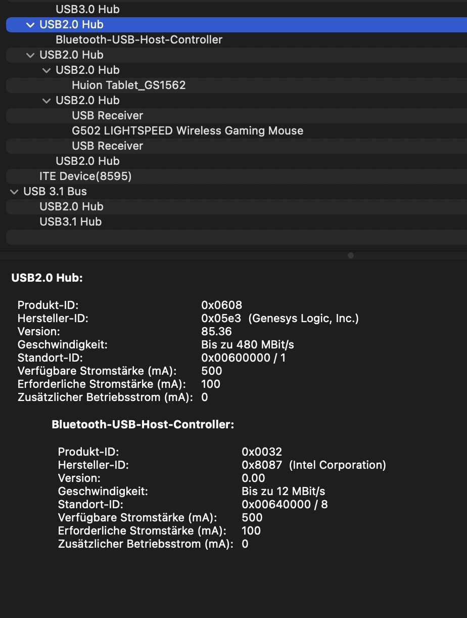

Anto65 Posted March 5, 2024 Share Posted March 5, 2024 I think I understand that the Wifi works Has the Bluetooth cable been connected to the USB header 😛 ? If so, has the port been mapped? (internal 0xFF) 1 Link to comment https://www.insanelymac.com/forum/topic/358024-sonoma-wi-fi-solutions-that-do-not-require-disabled-sip-eg-intel-ax210/page/4/#findComment-2817660 Share on other sites More sharing options...
Max.1974 Posted March 5, 2024 Share Posted March 5, 2024 2 minutes ago, Antonuccio said: I think I understand that the Wifi works Has the Bluetooth cable been connected to the USB header 😛 ? If so, has the port been mapped? (internal 0xFF) Yeah my Master @Antonuccio but im talk about compile Intel Bluetooth Kexts with program 😉 😆 Link to comment https://www.insanelymac.com/forum/topic/358024-sonoma-wi-fi-solutions-that-do-not-require-disabled-sip-eg-intel-ax210/page/4/#findComment-2817661 Share on other sites More sharing options...
Anto65 Posted March 5, 2024 Share Posted March 5, 2024 (edited) 😄 I understood , that it is of little use if the port is not connected or mapped 🙃 EDIT : ok I also saw what miliuco specified , i see the pic too Edited March 5, 2024 by Antonuccio 1 Link to comment https://www.insanelymac.com/forum/topic/358024-sonoma-wi-fi-solutions-that-do-not-require-disabled-sip-eg-intel-ax210/page/4/#findComment-2817662 Share on other sites More sharing options...

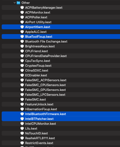

miliuco Posted March 5, 2024 Author Share Posted March 5, 2024 (edited) @derpuma Stupid question: have you plugged the tiny cable from the AX210 card to the USB 2 port on the motherboard? >> Forget this, I see in your pic that it's plugged . Config.plist is okey. These are the Bluetooth kexts I have on Sonoma, try it although I guess that this is not the issue. BT-sonoma.zip @Max.1974 How do you compile IntelBluetoothFirmware? Terminal or within Xcode? Edited March 5, 2024 by miliuco Link to comment https://www.insanelymac.com/forum/topic/358024-sonoma-wi-fi-solutions-that-do-not-require-disabled-sip-eg-intel-ax210/page/4/#findComment-2817663 Share on other sites More sharing options...

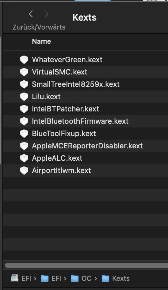

derpuma Posted March 5, 2024 Share Posted March 5, 2024 (edited) @miliuco @Max.1974 I used this three kext in EFI/OC/Kext: IntelBTPatcher.kext V2.4.0 IntelBluetoothFirmware.kext V2.4.0 BlueToolFixup.kext V2.6.9 And I deleted: BrcmBluetoothInjector.kext form EFI/OC/Kext. But BT does not work, does not find any pairing devices. II used a BCM43602 via PCI-e Adapter before, but I guess this has nothing to do with the old card? Do I need any other kext from BrcmPatchRAM-2.6.8-RELEASE, rathter then BlueToolFixup.kext? I had some BRCM Kext in my L/E Folder which I deleted: BrcmPatchRAM2.kext BrcmFirmwareRepo.kext Do I need newer Versions of this Kext in L/E? BrcmPatchRAM3.kext and BrcmFirmwareRepo.kext of Release 2.6.8? Here are my pci devices. pcidevices.plist Spoiler Edited March 5, 2024 by derpuma 1 Link to comment https://www.insanelymac.com/forum/topic/358024-sonoma-wi-fi-solutions-that-do-not-require-disabled-sip-eg-intel-ax210/page/4/#findComment-2817665 Share on other sites More sharing options...

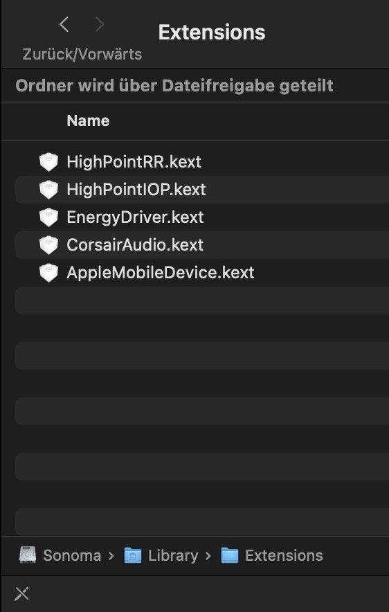

miliuco Posted March 5, 2024 Author Share Posted March 5, 2024 (edited) @derpuma Kexts are okey. I have the same card and don't need any other kext but the 3 basic. No BrcmPatchRAM3 nor BrcmFirmwareRepo. /Library/Extensions folder: remove all kexts (if any) but EnergyDriver.kext, HighPointIOP.kext, HighPointRR.kext and SoftRAID.kext Question: are you inside a virtualized Sonoma? QEMU and Virtio devices are usual in non virtualized systems ? Sorry but mi knowledge about virtualization with QEMU is almost zero. Edited March 5, 2024 by miliuco Link to comment https://www.insanelymac.com/forum/topic/358024-sonoma-wi-fi-solutions-that-do-not-require-disabled-sip-eg-intel-ax210/page/4/#findComment-2817666 Share on other sites More sharing options...

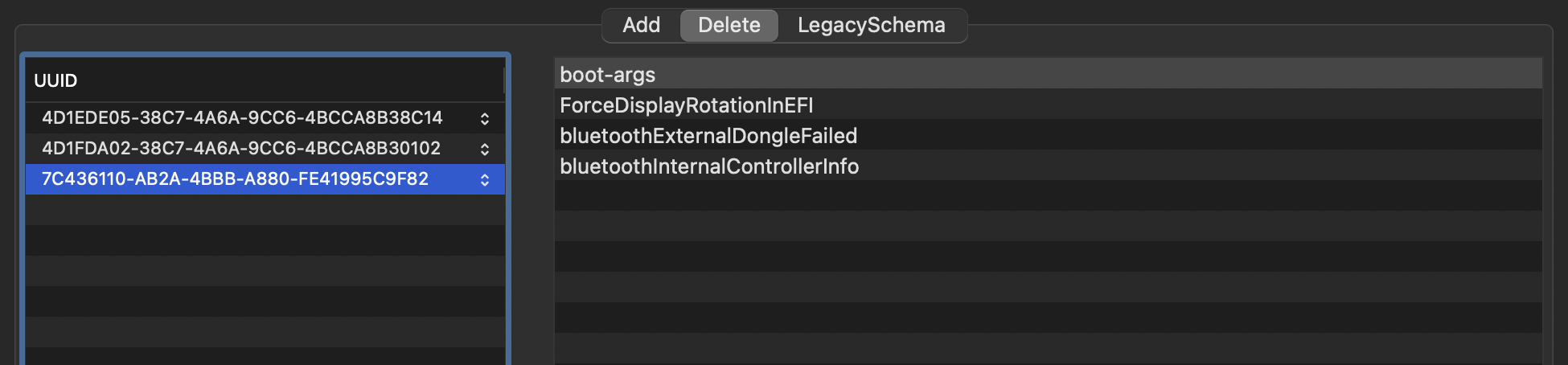

derpuma Posted March 5, 2024 Share Posted March 5, 2024 (edited) Yes, I am running my mac OS via Unraid VM. My PCIE devices are pass through! So they should work like on a regular hackintosh. At least my other BCM43602 Card worked normal with pcie pass through. I deleted all kext in /L/E which I don't need and try again. Spoiler Edited March 5, 2024 by derpuma 1 Link to comment https://www.insanelymac.com/forum/topic/358024-sonoma-wi-fi-solutions-that-do-not-require-disabled-sip-eg-intel-ax210/page/4/#findComment-2817673 Share on other sites More sharing options...

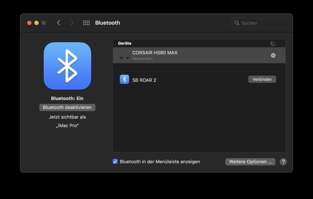

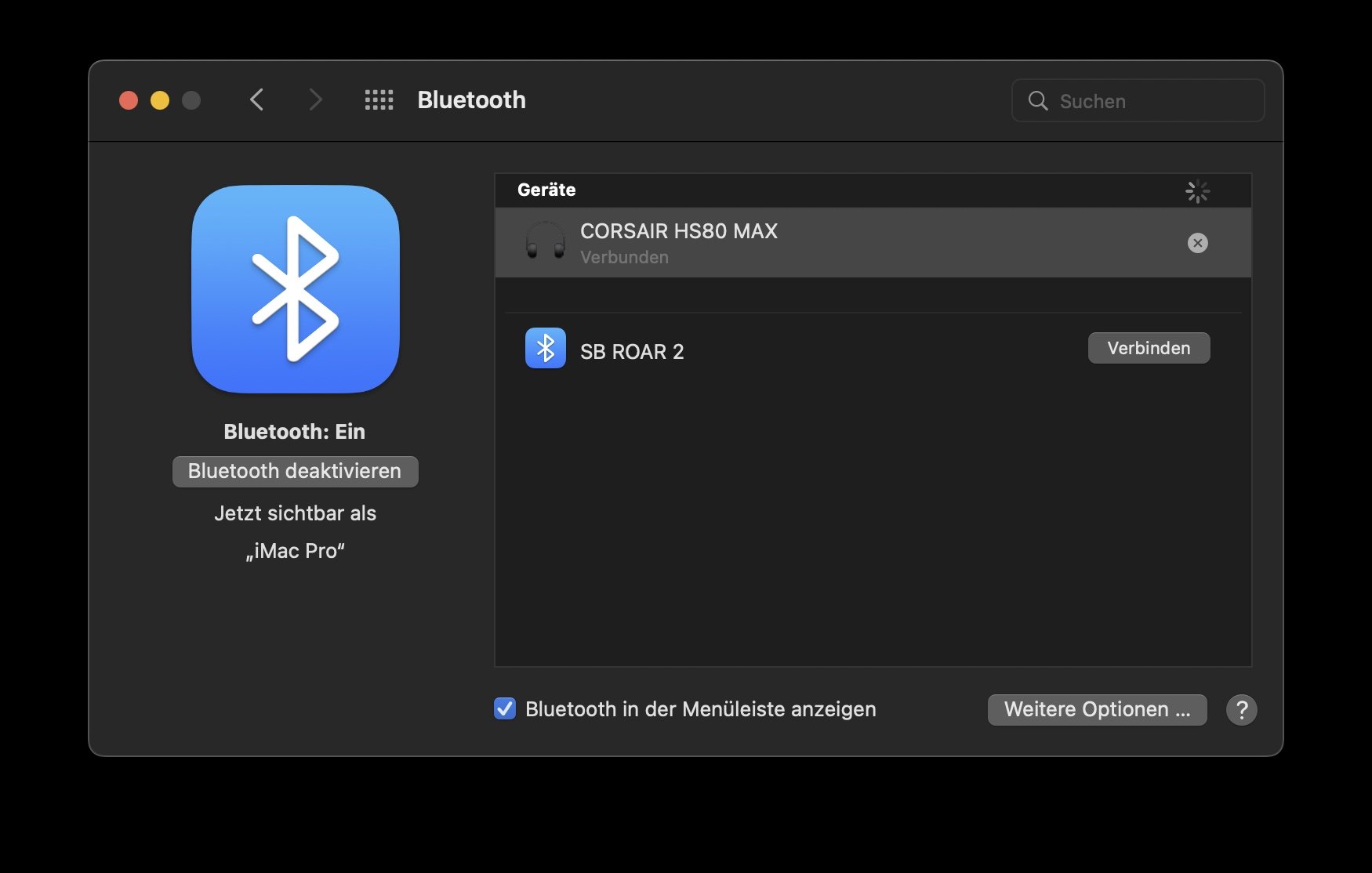

derpuma Posted March 5, 2024 Share Posted March 5, 2024 @miliuco I booted from my old monterey with the identical opencore bootloader I used with sonoma. And see there, BT is working on monterey, so I think it has something to do with the BT Kext. Which Version of Sonoma do you use? I am on 14.3.1. Maybe I need other BT kexts? Spoiler Link to comment https://www.insanelymac.com/forum/topic/358024-sonoma-wi-fi-solutions-that-do-not-require-disabled-sip-eg-intel-ax210/page/4/#findComment-2817678 Share on other sites More sharing options...

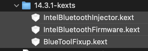

miliuco Posted March 5, 2024 Author Share Posted March 5, 2024 (edited) @derpuma I have 14.3.1 in the main disk and 14.4 beta in the test disk. I have sent to you the kexts I have in 14.4. They are from version 2.4.0. In 14.3.1 I have version 2.3.0. Try these that I attach and comment if there is any difference. EDIT: ZIP file replaced. 14.3.1-kexts.zip Edited March 6, 2024 by miliuco Link to comment https://www.insanelymac.com/forum/topic/358024-sonoma-wi-fi-solutions-that-do-not-require-disabled-sip-eg-intel-ax210/page/4/#findComment-2817690 Share on other sites More sharing options...
Max.1974 Posted March 6, 2024 Share Posted March 6, 2024 @derpuma sorry if you got mapping ports, but in this cases, if necessary use some tools like Usbports from CorpNewT from GitHub to mapping your internal devices, with 255 parameters If you not do it, it's more difficult to make works. It's necessary to get camera, usb bluetooth like internal devices. Link to comment https://www.insanelymac.com/forum/topic/358024-sonoma-wi-fi-solutions-that-do-not-require-disabled-sip-eg-intel-ax210/page/4/#findComment-2817699 Share on other sites More sharing options...
derpuma Posted March 6, 2024 Share Posted March 6, 2024 @Max.1974 Do you really thing it could be a port mapping issue? I mean Bluetooth works under Monterey with the same OpenCore Config. @miliuco Thanks, will try this kext this morning and report back. Link to comment https://www.insanelymac.com/forum/topic/358024-sonoma-wi-fi-solutions-that-do-not-require-disabled-sip-eg-intel-ax210/page/4/#findComment-2817702 Share on other sites More sharing options...
derpuma Posted March 6, 2024 Share Posted March 6, 2024 @miliuco You confused me with your 14.3.1 Folder. I guess you picked one wrong kext! Shouldn't be the IntelBTPatcherkext in it, instead of the IntelBluetoothInjector.kext. Link to comment https://www.insanelymac.com/forum/topic/358024-sonoma-wi-fi-solutions-that-do-not-require-disabled-sip-eg-intel-ax210/page/4/#findComment-2817706 Share on other sites More sharing options...

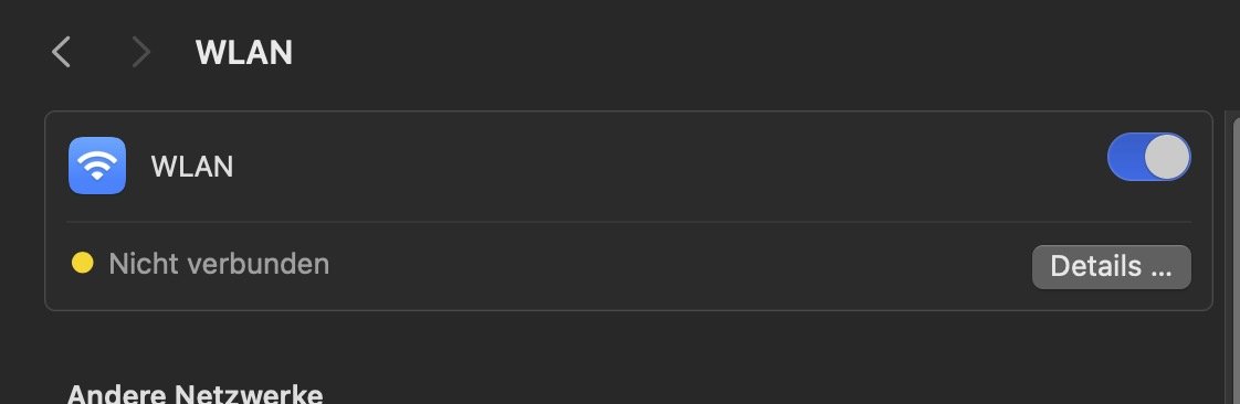

ichelash Posted March 6, 2024 Share Posted March 6, 2024 For me BT works..WiFi and Ethernet works, but when i go to settings it crashes the WiFi completely using AirportItlwm 2.3.0 Link to comment https://www.insanelymac.com/forum/topic/358024-sonoma-wi-fi-solutions-that-do-not-require-disabled-sip-eg-intel-ax210/page/4/#findComment-2817708 Share on other sites More sharing options...
miliuco Posted March 6, 2024 Author Share Posted March 6, 2024 (edited) @derpuma Sorry, I mixed the kexts, you're right, I replace the attachment in my previous post, get it, it's fixed. 1 hour ago, ichelash said: For me BT works. WiFi and Ethernet works, but when i go to settings it crashes the WiFi completely using AirportItlwm 2.3.0 AirportItlwm is alpha stage, maybe it doesn't work fine in all systems. Try this: On Sonoma 14.3, try AirportItlwm.kext from this issue in the OpenIntelWireless GitHub: https://github.com/OpenIntelWireless/itlwm/issues/937#issuecomment-1963569381 On Sonoma 14.4 beta, try this AirportItlwm.kext (different issue): https://github.com/OpenIntelWireless/itlwm/issues/953#issuecomment-1920413379 Edited March 6, 2024 by miliuco Link to comment https://www.insanelymac.com/forum/topic/358024-sonoma-wi-fi-solutions-that-do-not-require-disabled-sip-eg-intel-ax210/page/4/#findComment-2817709 Share on other sites More sharing options...
ichelash Posted March 6, 2024 Share Posted March 6, 2024 1 hour ago, miliuco said: @derpuma Sorry, I mixed the kexts, you're right, I replace the attachment in my previous post, get it, it's fixed. AirportItlwm is alpha stage, maybe it doesn't work fine in all systems. Try this: On Sonoma 14.3, try AirportItlwm.kext from this issue in the OpenIntelWireless GitHub: https://github.com/OpenIntelWireless/itlwm/issues/937#issuecomment-1963569381 On Sonoma 14.4 beta, try this AirportItlwm.kext (different issue): https://github.com/OpenIntelWireless/itlwm/issues/953#issuecomment-1920413379 I have the same kexts Link to comment https://www.insanelymac.com/forum/topic/358024-sonoma-wi-fi-solutions-that-do-not-require-disabled-sip-eg-intel-ax210/page/4/#findComment-2817712 Share on other sites More sharing options...

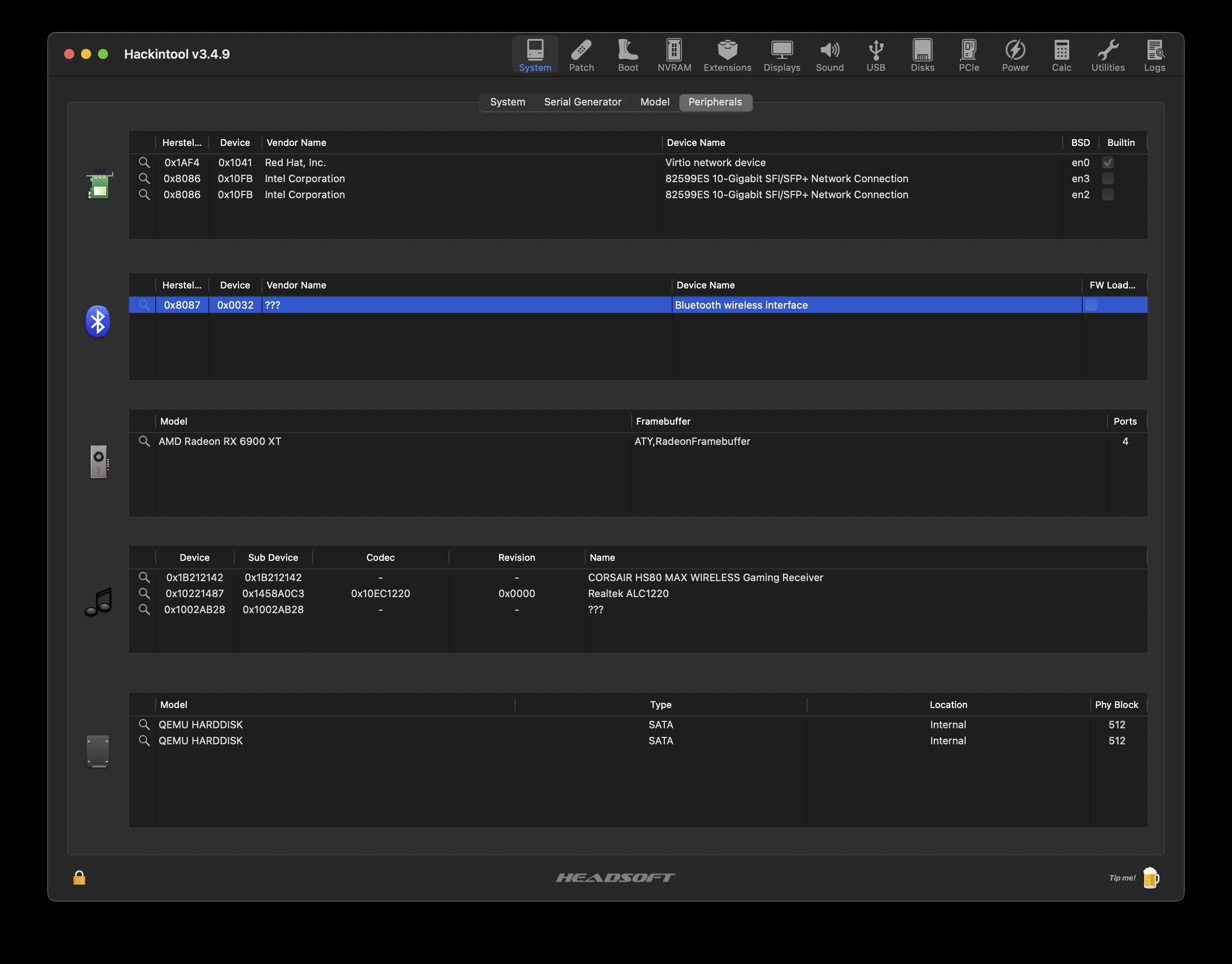

Max.1974 Posted March 6, 2024 Share Posted March 6, 2024 11 horas atrás, derpuma disse: @miliuco Você me confundiu com sua pasta 14.3.1. Acho que você escolheu um kext errado! Não deveria ser o IntelBTPatcherkext nele, em vez do IntelBluetoothInjector.kext. Hi, with Monterey works because you are using IntelBluetoothInjector, but in Ventura and Sonoma not use this kext, is the recommendation instruction on OpenIntel Wireless GIT HUB Olny use this with Sonoma or Ventura Im post for you my kexts, are you tested ? 1 Link to comment https://www.insanelymac.com/forum/topic/358024-sonoma-wi-fi-solutions-that-do-not-require-disabled-sip-eg-intel-ax210/page/4/#findComment-2817732 Share on other sites More sharing options...
Anto65 Posted March 6, 2024 Share Posted March 6, 2024 https://openintelwireless.github.io/IntelBluetoothFirmware/FAQ.html#intelbluetoothinjector 3 Link to comment https://www.insanelymac.com/forum/topic/358024-sonoma-wi-fi-solutions-that-do-not-require-disabled-sip-eg-intel-ax210/page/4/#findComment-2817734 Share on other sites More sharing options...

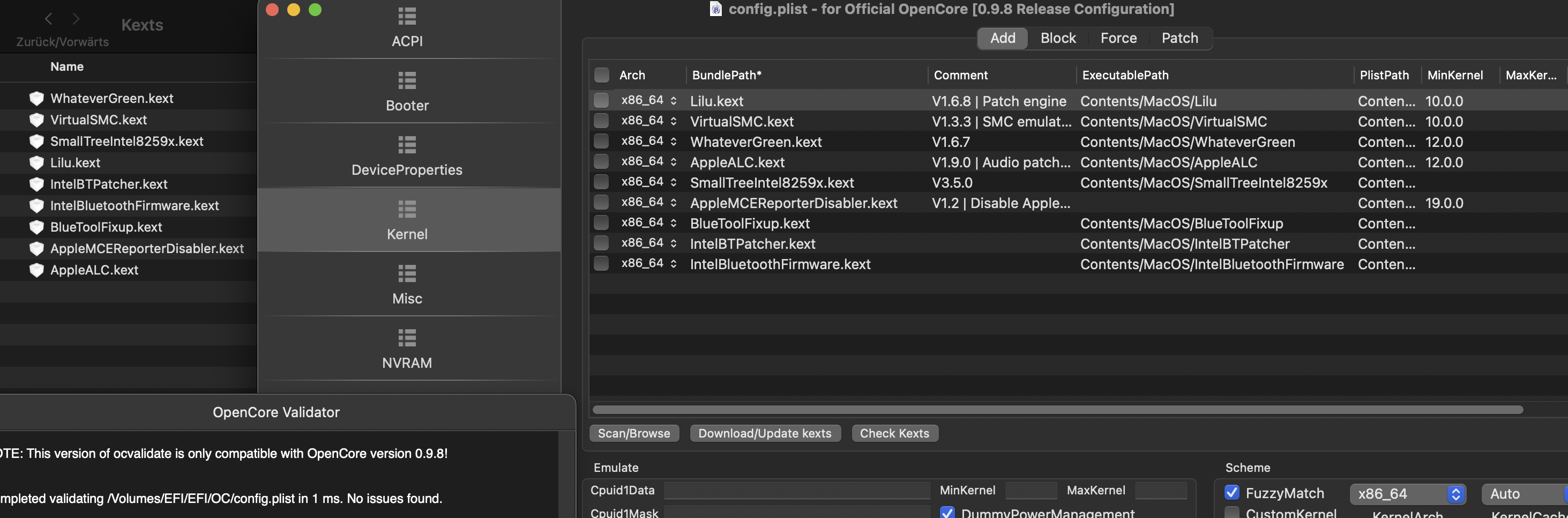

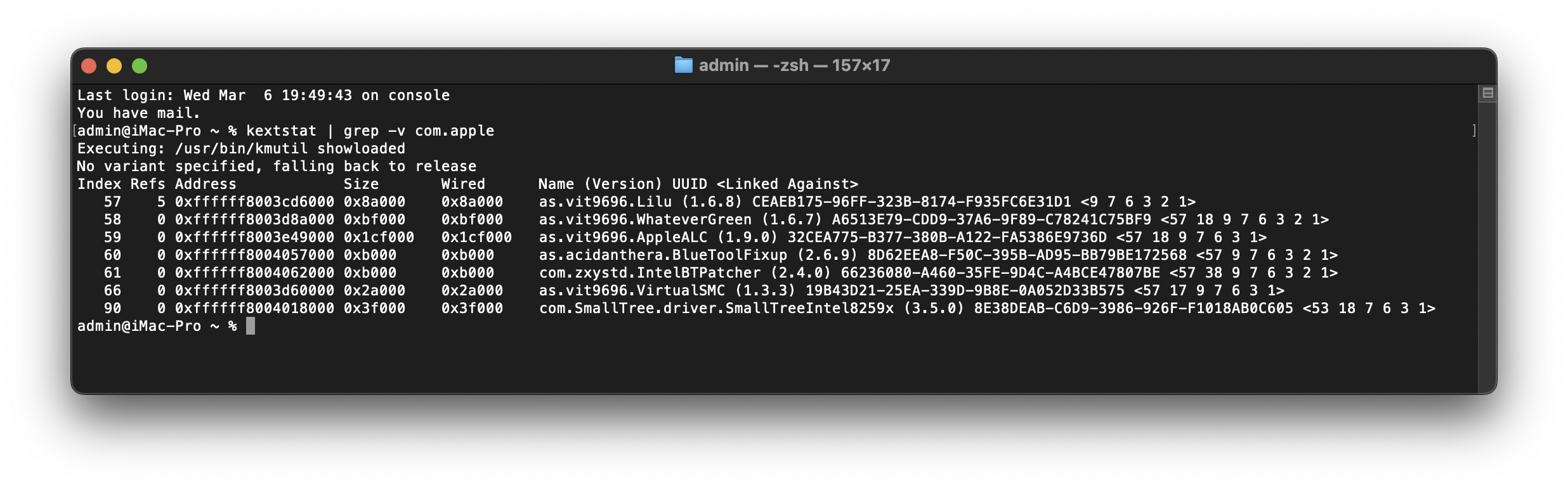

derpuma Posted March 6, 2024 Share Posted March 6, 2024 As you can see: kextstat | grep -v com.apple tells me that it does not load IntelBluetoothFirmware.kext while booting into Sonoma. So the Question is, why does it not load the IntelBluetoothFirmware.kext?! Any ideas? As you can see here, the kext folder has the kext and the rest of the config is also configured as it should. Spoiler 1 Link to comment https://www.insanelymac.com/forum/topic/358024-sonoma-wi-fi-solutions-that-do-not-require-disabled-sip-eg-intel-ax210/page/4/#findComment-2817736 Share on other sites More sharing options...
miliuco Posted March 6, 2024 Author Share Posted March 6, 2024 @derpuma Put IntelBluetoothFirmware.kext before IntelBTPatcher.kext and BluetoolFixup.kext. In this order. Try and comment. Link to comment https://www.insanelymac.com/forum/topic/358024-sonoma-wi-fi-solutions-that-do-not-require-disabled-sip-eg-intel-ax210/page/4/#findComment-2817738 Share on other sites More sharing options...
derpuma Posted March 6, 2024 Share Posted March 6, 2024 7 minutes ago, miliuco said: @derpuma Put IntelBluetoothFirmware.kext before IntelBTPatcher.kext and BluetoolFixup.kext. In this order. Try and comment. Same behaviour. Does not load IntelBluetoothFirmware.kext. 1 Link to comment https://www.insanelymac.com/forum/topic/358024-sonoma-wi-fi-solutions-that-do-not-require-disabled-sip-eg-intel-ax210/page/4/#findComment-2817739 Share on other sites More sharing options...
