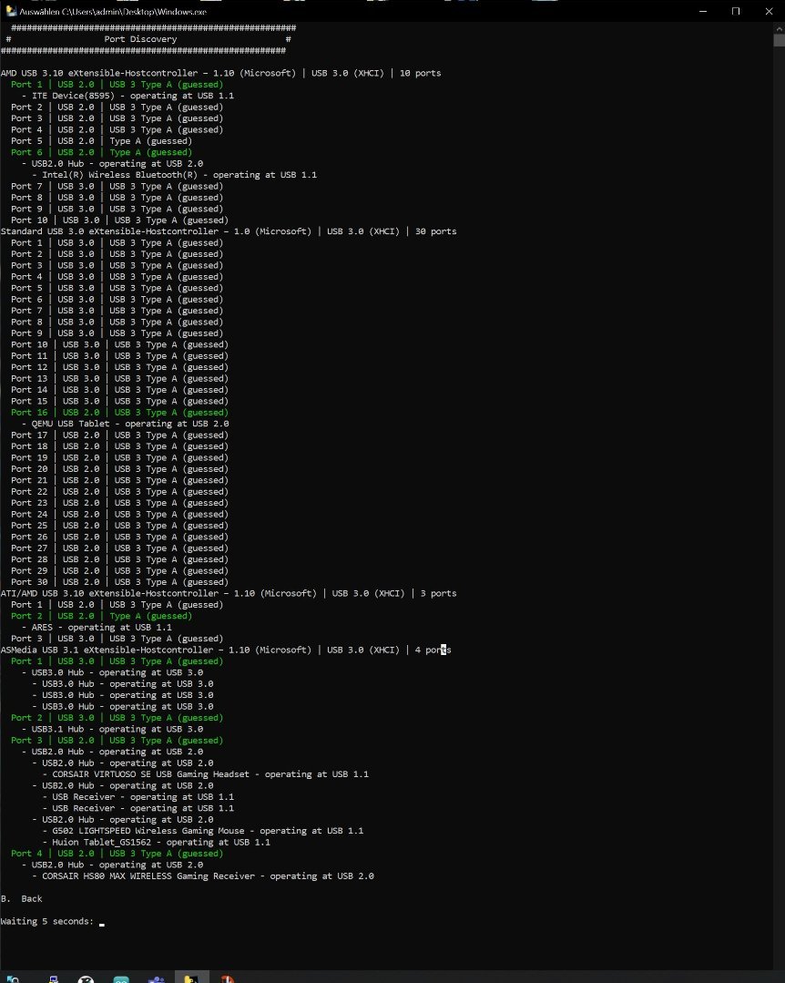

derpuma Posted March 6, 2024 Share Posted March 6, 2024 I don't know. I also tried to map my USB Ports in Windows, but it still does not load. Is there a way to map the USB Ports directly under Sonoma? Link to comment https://www.insanelymac.com/forum/topic/358024-sonoma-wi-fi-solutions-that-do-not-require-disabled-sip-eg-intel-ax210/page/5/#findComment-2817744 Share on other sites More sharing options...

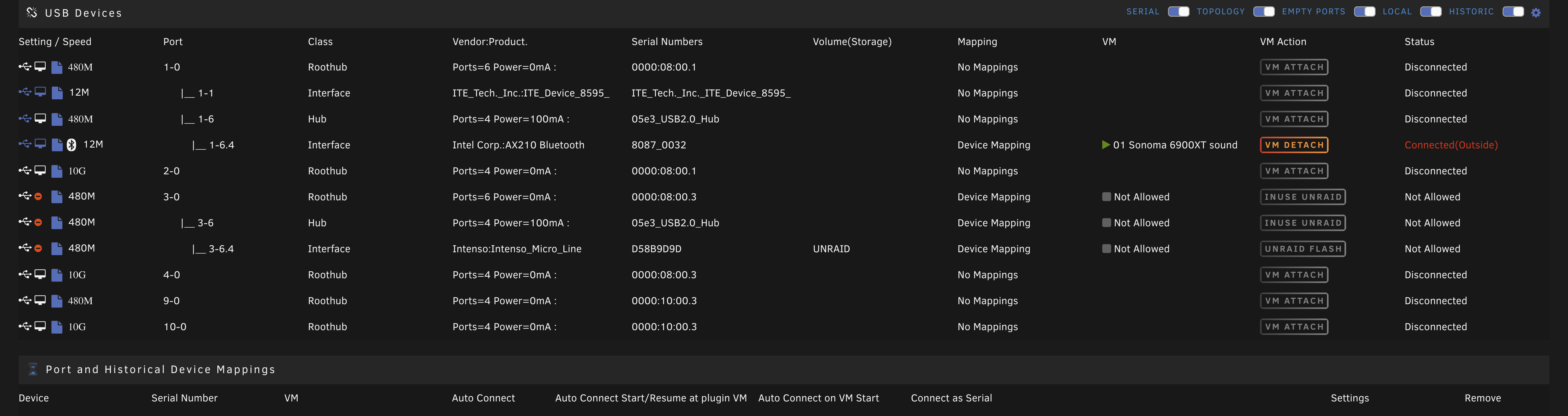

derpuma Posted March 6, 2024 Share Posted March 6, 2024 (edited) @ichelash Sure, no problem. config.plist FYI, I deleted the USB Portmapping, as it did not gave me any benefits. I can see the BT Part of the AX210s in UNRAIDs USB PLugin. But it does not load while booting into Sonoma. It does while booting into Monterey. Edited March 6, 2024 by derpuma 2 Link to comment https://www.insanelymac.com/forum/topic/358024-sonoma-wi-fi-solutions-that-do-not-require-disabled-sip-eg-intel-ax210/page/5/#findComment-2817747 Share on other sites More sharing options...

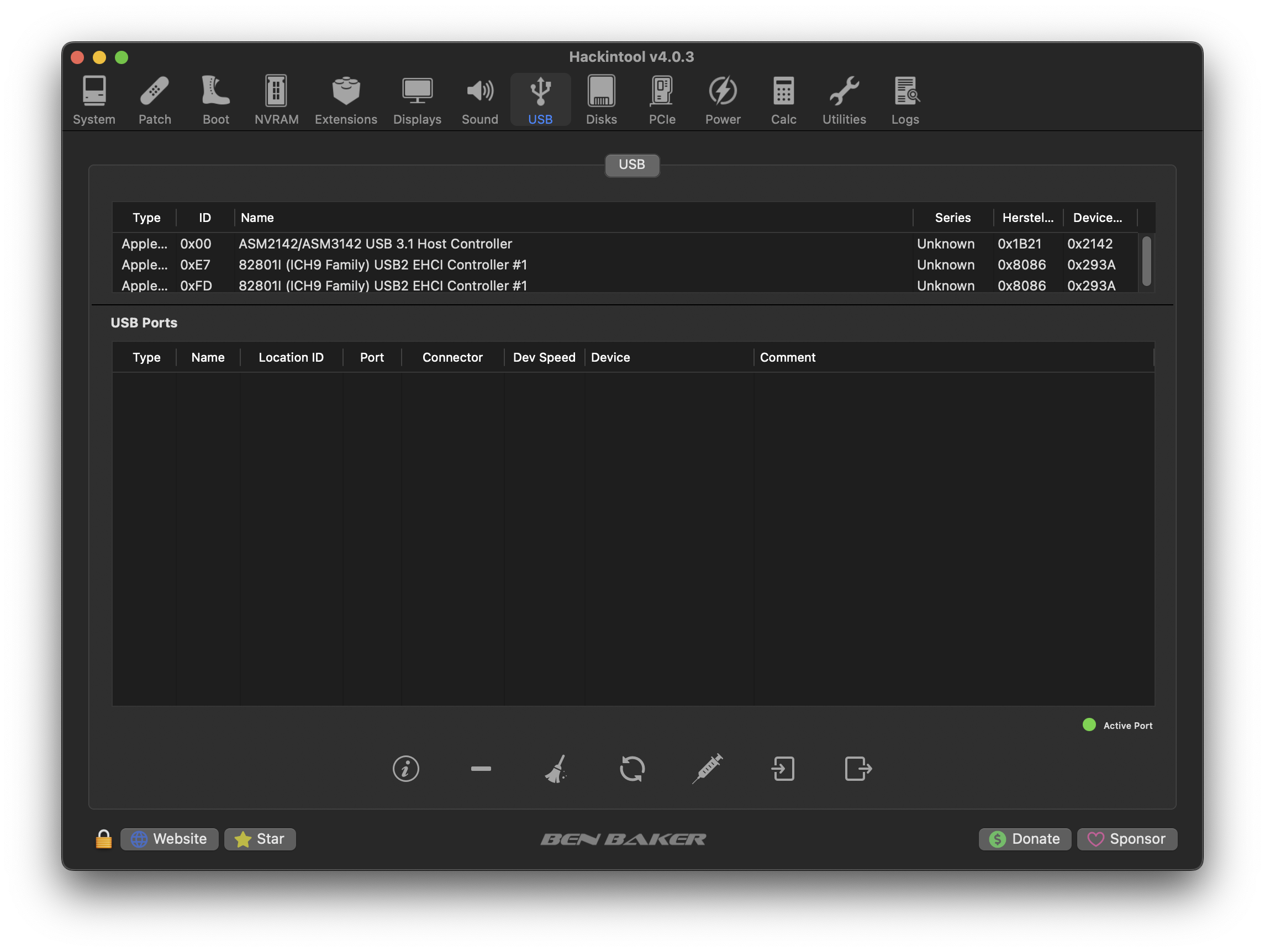

derpuma Posted March 7, 2024 Share Posted March 7, 2024 @ichelash That did not fix it too. Problem I discovered now is, that my Hackintool does not show me any USB Ports at all. I pressed wipe, but refresh does not load up any USB Ports again. Any Idea why? Link to comment https://www.insanelymac.com/forum/topic/358024-sonoma-wi-fi-solutions-that-do-not-require-disabled-sip-eg-intel-ax210/page/5/#findComment-2817761 Share on other sites More sharing options...
ichelash Posted March 7, 2024 Share Posted March 7, 2024 1 minute ago, derpuma said: @ichelash That did not fix it too. Problem I discovered now is, that my Hackintool does not show me any USB Ports at all. I pressed wipe, but refresh does not load up any USB Ports again. Any Idea why? Now try using USBinject all kext..instead and remove usbtool & utbmap see if it populate Link to comment https://www.insanelymac.com/forum/topic/358024-sonoma-wi-fi-solutions-that-do-not-require-disabled-sip-eg-intel-ax210/page/5/#findComment-2817762 Share on other sites More sharing options...

derpuma Posted March 7, 2024 Share Posted March 7, 2024 (edited) @ichelash I thought USBinject.kext is not nessecary in Sonoma anymore? I can try this. @Antonuccio I can try this too... I'm currently running my Windows VM and the USB ports actually look fine there. In Sonoma I need only the ASMedia USB 3.1 eXtensible host controller – 1.10 (Microsoft) | is enough for me USB 3.0 (XHCI) | 4 ports. The AX210s BT USB should be the one on Port 6 I guess? Update: Booting with USBinject.kext and Kernel Quirks XHCIPortLimit "on" did not bring the USB Ports back in Hackintool. Edited March 7, 2024 by derpuma Link to comment https://www.insanelymac.com/forum/topic/358024-sonoma-wi-fi-solutions-that-do-not-require-disabled-sip-eg-intel-ax210/page/5/#findComment-2817767 Share on other sites More sharing options...

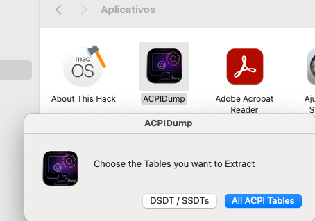

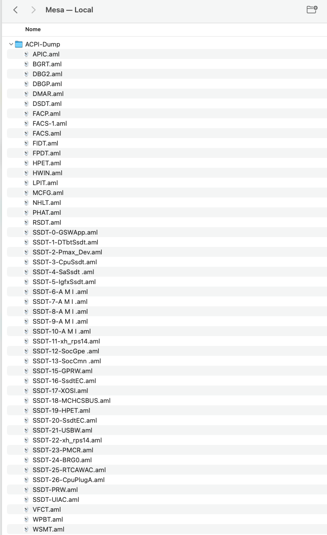

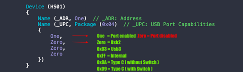

Anto65 Posted March 7, 2024 Share Posted March 7, 2024 (edited) Try if you want 🙃 Add to the last working EFI SSDT-XHC.aml.zip in ACPI and config.plist , delete UTBMAP, Usbinject..,Port limit If the USBs are shown 🤞 you can enable/disable the ports or change the type of connector by following here the example ... if needed Spoiler Edited March 7, 2024 by Antonuccio 3 Link to comment https://www.insanelymac.com/forum/topic/358024-sonoma-wi-fi-solutions-that-do-not-require-disabled-sip-eg-intel-ax210/page/5/#findComment-2817774 Share on other sites More sharing options...
derpuma Posted March 7, 2024 Share Posted March 7, 2024 @Antonuccio Thx a lot for your effort and help. I booted into Sonoma with this config.plist, but sill no USB Ports in Hackintool. Do you think I should try a new Installation of Sonoma and try it there? I am not sure what'S messing up my USB Ports under Sonoma at all... config.plist Link to comment https://www.insanelymac.com/forum/topic/358024-sonoma-wi-fi-solutions-that-do-not-require-disabled-sip-eg-intel-ax210/page/5/#findComment-2817775 Share on other sites More sharing options...

derpuma Posted March 7, 2024 Share Posted March 7, 2024 7 minutes ago, mariosun said: @derpumahave you passed through your USb controller where you connect your AX210 BT cable? you can also pass it as single USB device Sure, I did that. But this does not bring BT to life, if the IntelBluetoothFirmware.kext does not load at boot. <hostdev mode='subsystem' type='usb' managed='no'> <source> <vendor id='0x8087'/> <product id='0x0032'/> <address bus='1' device='4'/> </source> <alias name='hostdev9'/> <address type='usb' bus='0' port='2'/> </hostdev> Link to comment https://www.insanelymac.com/forum/topic/358024-sonoma-wi-fi-solutions-that-do-not-require-disabled-sip-eg-intel-ax210/page/5/#findComment-2817786 Share on other sites More sharing options...

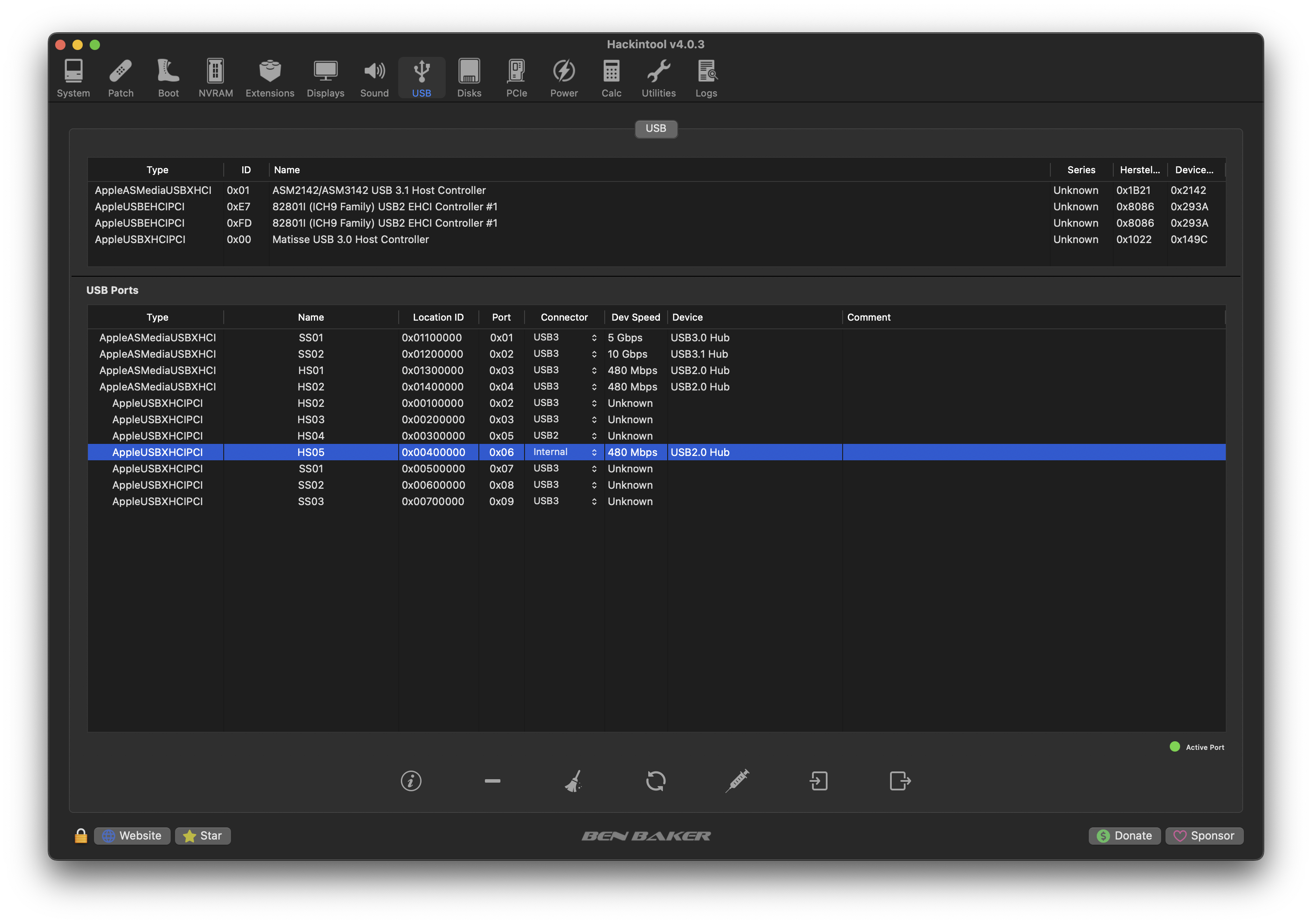

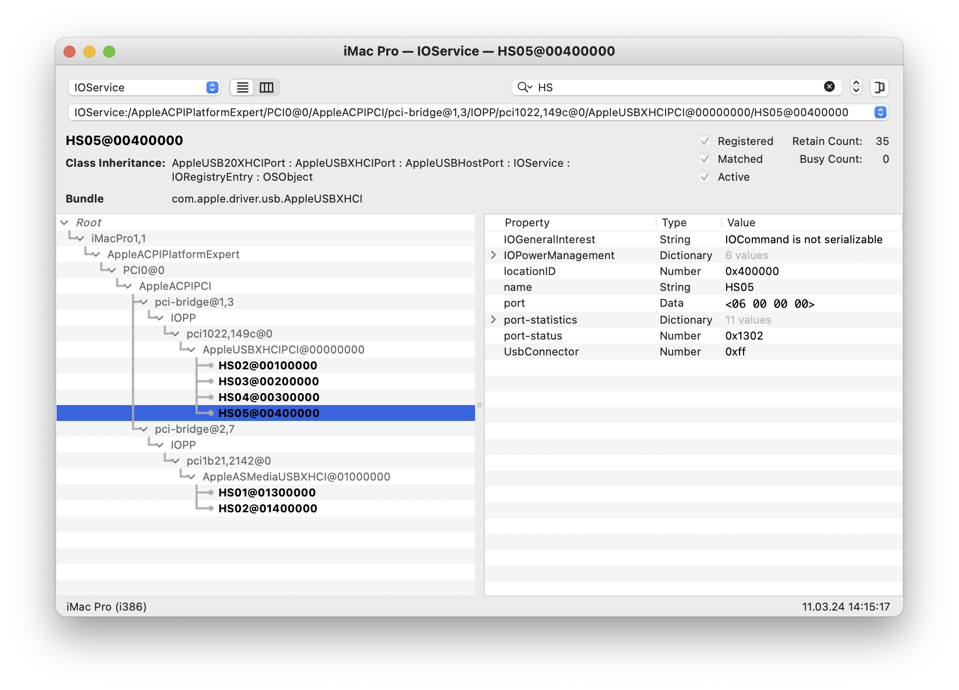

derpuma Posted March 7, 2024 Share Posted March 7, 2024 My USBPorts are messed up and I am not able to get them back or restore them via USBInjectall.kext, Hackintool Reload USB or anyting else. Hackintool does not load any USB Port. IOReg see screenshot. Not sure why and how this is like it is, but I am going to install a new Sonoma now and try from there. Right now I am struggeling in creating an img file fron the Sonoma Install App due to the immense diskspace it needs, which I do not have right now. I need an img file cause in install into a virtual KVM. Tools like Mist or AnymacOS also dont work increating and image... I will report back when I am ready and how the new system behaves. Link to comment https://www.insanelymac.com/forum/topic/358024-sonoma-wi-fi-solutions-that-do-not-require-disabled-sip-eg-intel-ax210/page/5/#findComment-2817792 Share on other sites More sharing options...

derpuma Posted March 11, 2024 Share Posted March 11, 2024 @Max.1974 Thanks for your reply. I managed the mapping of all USB Ports, nevertheless BT is not working. These are the mapped Ports. The internal is the USB BT part. Still Bluetooth-Controller: Adresse: NULL under Bluetooth... It must be the KVM macOS which causes the problem, as the other guy here with the same issue I have, also uses a KVM macOS. https://github.com/OpenIntelWireless/IntelBluetoothFirmware/issues/476 I also worked my way through this guide, but this also doesn't fix the problem. I am really clueless, what else to do... 1 Link to comment https://www.insanelymac.com/forum/topic/358024-sonoma-wi-fi-solutions-that-do-not-require-disabled-sip-eg-intel-ax210/page/5/#findComment-2817971 Share on other sites More sharing options...
