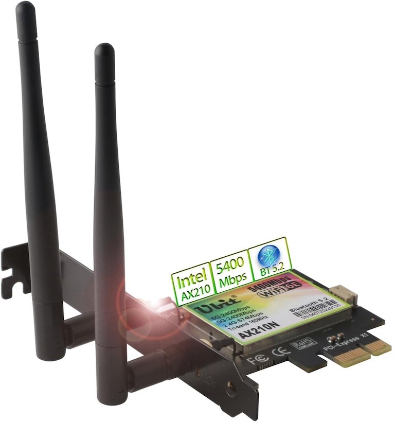

miliuco Posted December 21, 2023 Author Share Posted December 21, 2023 (edited) Another AX210 card that runs fine on Sonoma: Ubit AX210 WiFi 6E PCIe WiFI Wireless Card. Antennas are a little short, in my opinion. Spoiler Edited December 21, 2023 by miliuco 3 Link to comment https://www.insanelymac.com/forum/topic/358024-sonoma-wi-fi-solutions-that-do-not-require-disabled-sip-eg-intel-ax210/page/2/#findComment-2814769 Share on other sites More sharing options...
