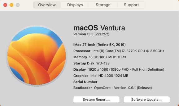

On 3/28/2023 at 3:00 AM, HyperX7 said:
OC 0.9.1
smooth update;

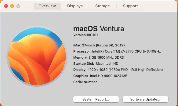

For my Q77 hackintoshs after patching Intel HD 4000 by OCLP 0.6.2 ther's one bug shown by About This Hack:
Incorrect MacOS version detected which should be 22E252 instead of 19G101.
Before patching it's normal and in Z77 hackintosh it's normal too !

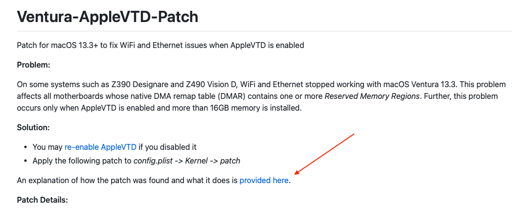

As @etorixand @Stefanalmare pointed out, a patch for IOPCIFamily fixes the WiFi and Ethernet problems in macOS 13.3+.
It’s available here:
https://github.com/CaseySJ/Ventura-AppleVTD-Patch
Nice job!  How did you figure out that patch?
Edited by deeveedee
1 hour ago, Casey_S.J. said:
I've added a link to the GitHub readme that explains the details of discovery:
Very informative!  Thank you!

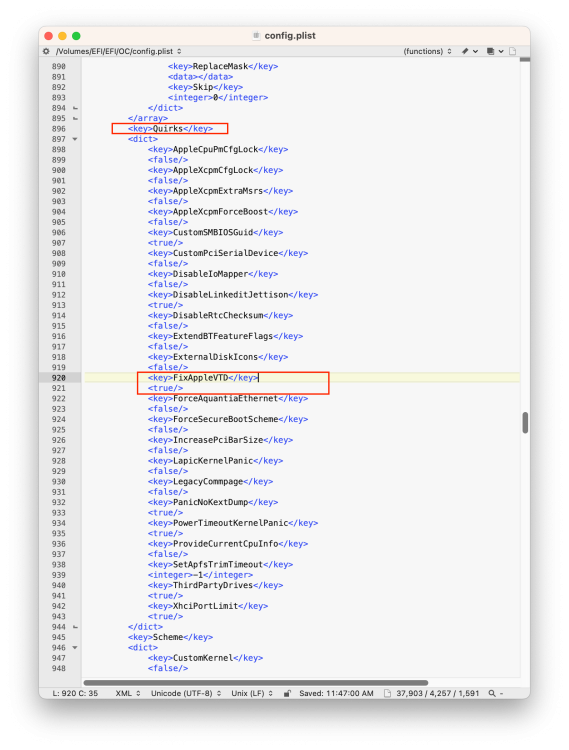

** Experimental OpenCore.efi with FixAppleVTD Kernel Quirk **
Purpose:
The patch to fix WiFi and Ethernet issues in macOS 13.3 has been incorporated directly into a test version of OpenCore that is attached to this post. This means it's not necessary to add the patch manually to config.plist.
Instead, a new Kernel Quirk called FixAppleVTD has been introduced that can be enabled and disabled as needed. When enabled, OpenCore itself will inject the patch into the right version of macOS.
Version:
This version of OpenCore.efi is based on the just-released OpenCore 0.9.1 code base, so it includes everything that's in 0.9.1.
Procedure:
  1. Disable the Kernel -> Patch if the patch has already been added and enabled.
  2. Replace existing OpenCore.efi in EFI/OC folder with the version attached below.
  3. Add these two lines (manually for now) into config.plist using a text editor as shown. The lines must be added in the Kernel Quirks section.
<key>FixAppleVTD</key>
<true/>
728119760_Screenshot2023-04-03at11_52_05AM.thumb.png.61cbd1cd5d3aa23c19788591eb3c88dd.png
Save config.plist and reboot. Do WiFi and Ethernet continue to work?
OpenCore.efi.zip
Edited by Casey_S.J.

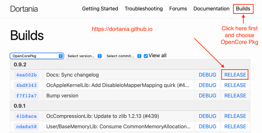

13 hours ago, Casey_S.J. said:
The new kernel quirk has been renamed from FixAppleVTD to DisableIoMapperMapping and merged into OpenCore. We should see it next month in 0.9.2!
An early build is available from https://dortania.github.io as shown below:
476081232_Screenshot2023-04-05at6_20_27PM.thumb.png.81806d0c9eeb69af77cbdb19ba714d42.png
