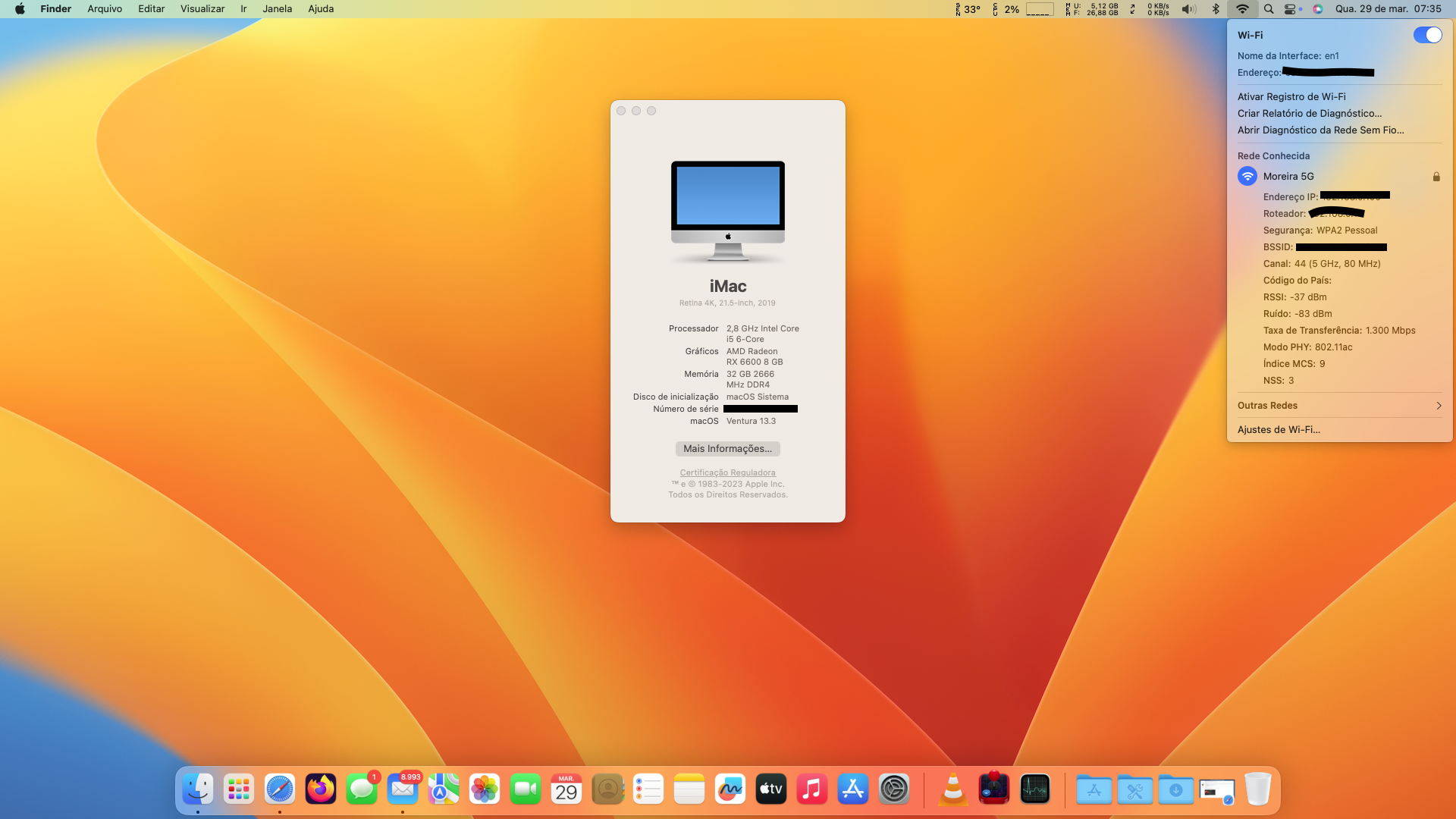

Update applied. I also use Broadcom (BCM94360CD), and it is working perfectly. SMBIOS iMac 19,2. The only thing I realize is, after sleep on waking up, Wi-Fi takes a long time to reconnect to the network for about 12 seconds

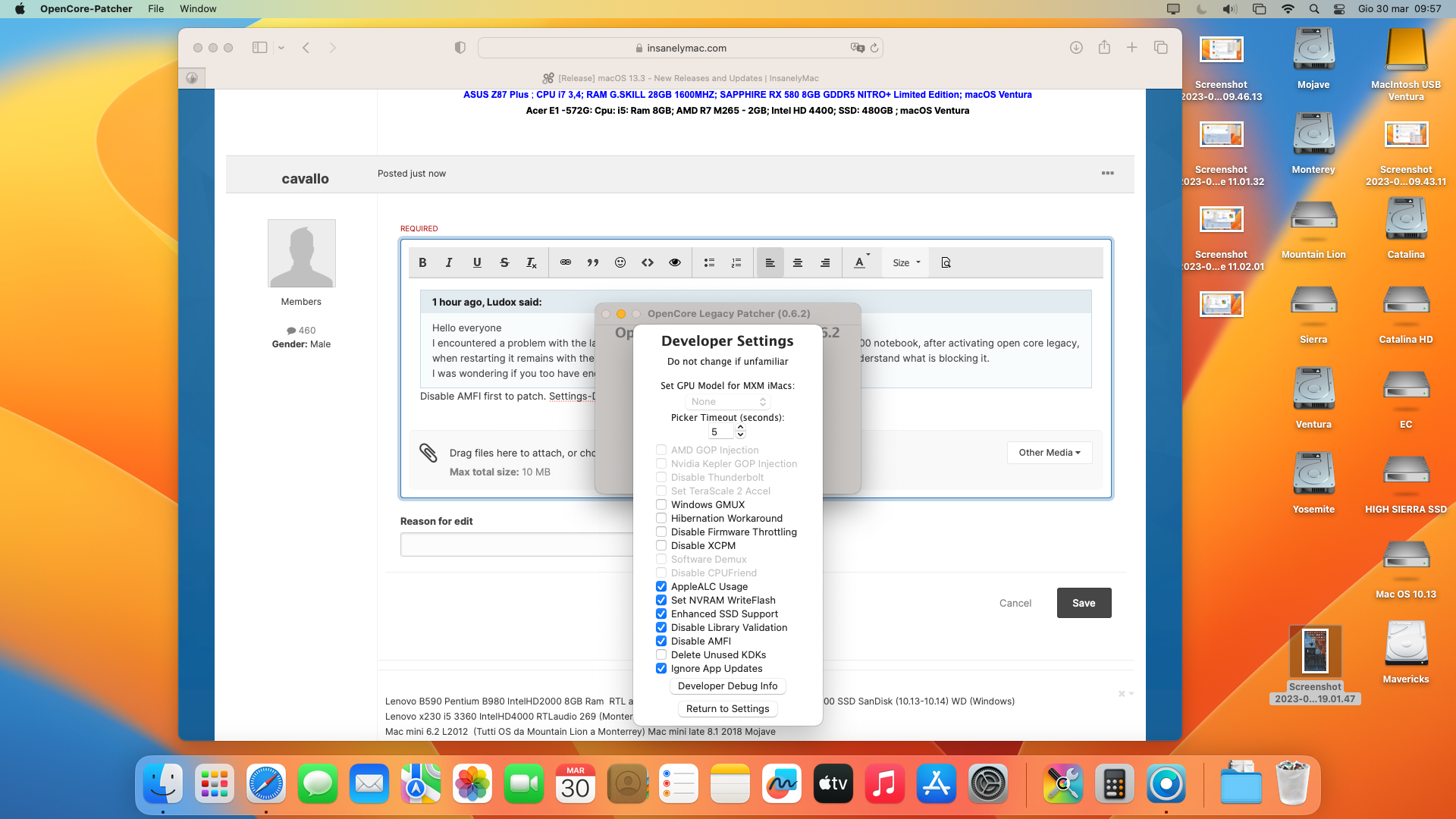

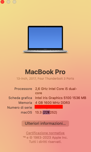

Hello everyone
I encountered a problem with the latest update on my Lenovo ideapad 100 15ibd Intel Iris 5100 notebook, after activating open core legacy, when restarting it remains with the apple logo loading it does not get to login, I will try to understand what is blocking it.
I was wondering if you too have encountered problems.
1 hour ago, Ludox said:
Hello everyone
Disable AMFI first to patch. Settings-Developper settings and check disable AMFI.
Edited by cavallo
Hello everyone
Try with boot arg -agdpmod=vit9696.
It helped me.

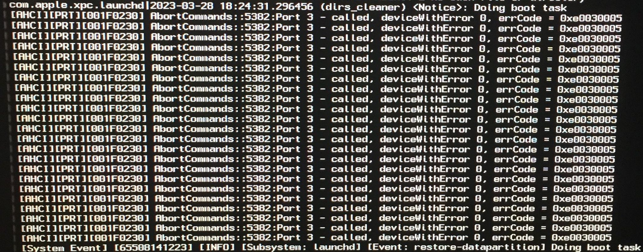

I've been getting spammed with this ever since the update;
[AHCI][PRT][00170000] AbortCommands::5382:Port 0 - called, deviceWithError 0, errCode = 0xe0030005
In IORegistryExplorer at  AppleACPiPCI > SAT1@17 > AppleAHCI > PRT0  is my DVD writer (yup, still got one of those, for some reason.) It and the other drives on the sata ports all work fine.
Google hasn't been much help so far. The error is slowing down the boot process significantly and it also keeps going after I get to the desktop (about once a second.) This is on the x299 build that's in my signature. Otherwise everything seems to be working, including VT-d and my Aquantia card.
- Quick Update: After figuring out that this was my DVD I disconnected it and booted, the error was gone. I’m going to reconnect it and ignore the error for now as I still use the drive with Windows. Seeing as this started with the update and the drive is working I'm assuming this is the update and not a coincidental hardware failure.

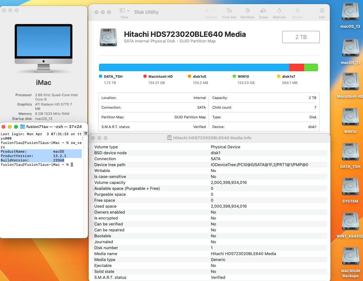

I successfully upgraded macOS 13.2 to 13.3 on my Legacy BIOS GA-P55aUD3 desktop using a full installer USB (made with createinstallmedia) and applied non-metal graphics patches for ATI HD 5770 with OCLP 0.6.2…

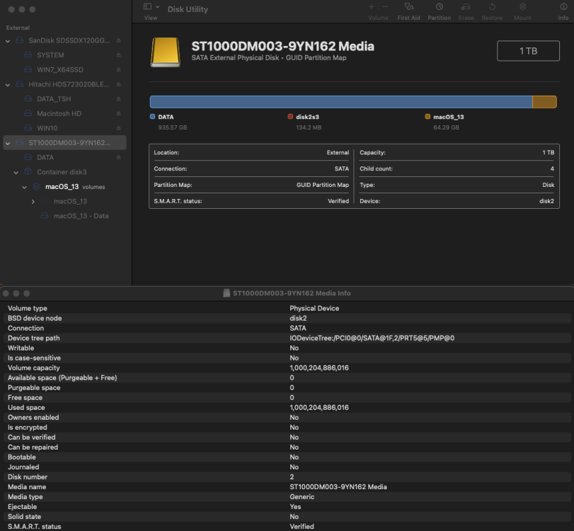

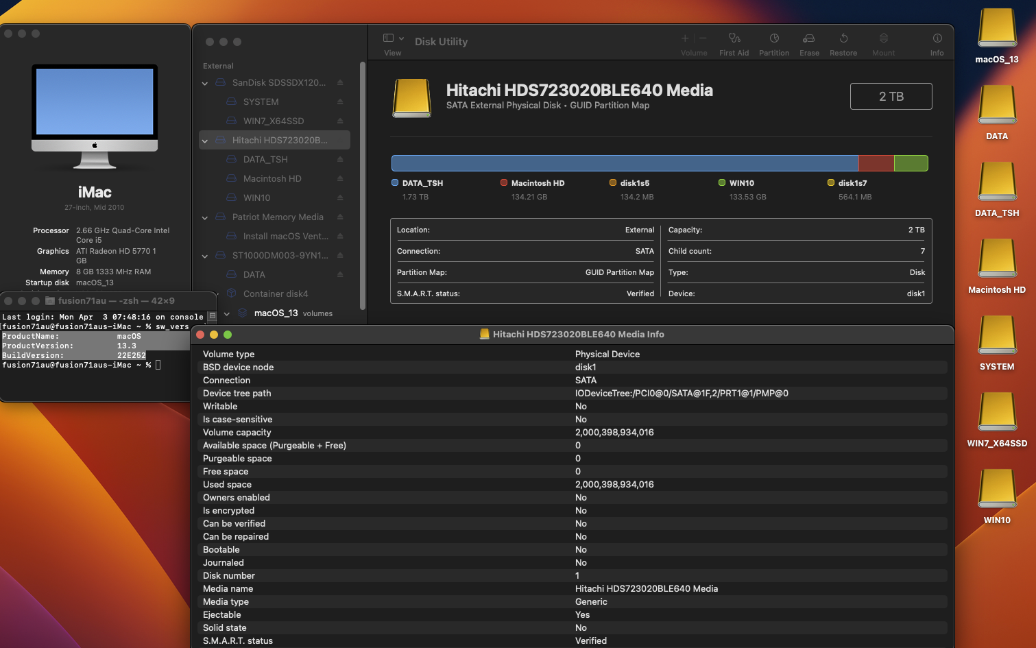

Seems like the OC ExternalDiskIcons quirk/AppleAHCIPort patch no longer works in 13.3 on my system, even with latest OC commit edb0419, my internal SATA HDD appeared as orange external drives.
Like @J Lamp, I noticed that the boot & shutdown processes were spammed with AHCI errors owing to the presence of my DVD-RW drive.  These went away if I disconnected the drive.  Hopefully someone smarter than me can devise an OC patch to prevent these AHCI error messages appearing in 13.3+...

14 minutes ago, miliuco said:
I don't have the ExternalDiskIcons quirk/IOAHCIBlockStorage patch issue. Even Trim is enabled on SATA drivers after sudo trim force enable. But the builds are different.
Same here. :yes:
I'm not using the ExternalDiskIcons quirk either, I have an injector kext that handles that for me. Also I'm booting with Clover, I don't think it supports that quirk anyway.
I also used trim force in terminal to enable that.
With that said I don't think this is bootloader related. Something has apparently changed in AHCI, it's reacting differently to different devices on the bus (in my case the DVD writer.) I don't think there are any Macs officially supported on Ventura that have an optical drive. (Might be wrong about that.)
Whatever changes have been made it's beyond my skill set to figure out what they've done.
