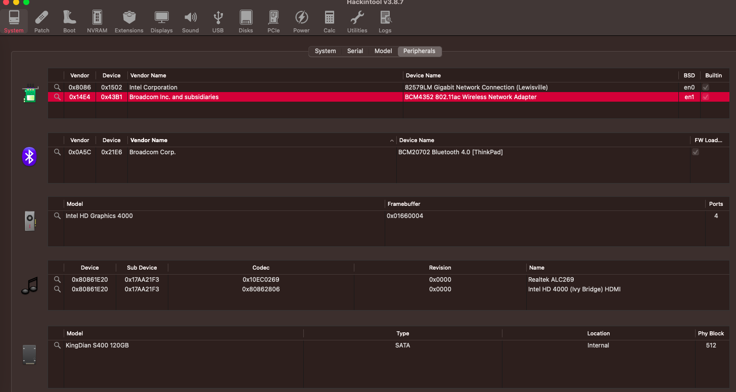

PoMpIs Posted October 26, 2022 Share Posted October 26, 2022 Today I received a wifi card for my T430, it is the Dell 1550 model: https://www.ebay.es/itm/203043709916 But it doesn't work in ventura... do you know what kext I need? Thanks a lot 🤗 2 Link to comment Share on other sites More sharing options...
miliuco Posted October 26, 2022 Share Posted October 26, 2022 @PoMpIs Officially it's supported up to Monterey but I'm not sure, wait for an user who can help you. 1 1 Link to comment Share on other sites More sharing options...
Stefanalmare Posted October 26, 2022 Share Posted October 26, 2022 (edited) 31 minutes ago, PoMpIs said: Today I received a wifi card for my T430, it is the Dell 1550 model: https://www.ebay.es/itm/203043709916 But it doesn't work in ventura... do you know what kext I need? Thanks a lot 🤗 I'm at work and I can't check right now, but I'm pretty sure I have 2 laptops with this card running Ventura. I'll report back. Below, the kexts: Spoiler Some laptops have white list for wifi cards. Maybe this card isn't compatible. If is this, search a modded BIOS with white list deleted. Edited October 26, 2022 by Stefanalmare 3 1 Link to comment Share on other sites More sharing options...

PoMpIs Posted October 26, 2022 Share Posted October 26, 2022 26 minutes ago, Stefanalmare said: I'm at work and I can't check right now, but I'm pretty sure I have 2 laptops with this card running Ventura. I'll report back. Below, the kexts: Hide contents Some laptops have white list for wifi cards. Maybe this card isn't compatible. If is this, search a modded BIOS with white list deleted. Thanks a lot!! In an hour I'll prove... that I've left the house for a moment the laptop does not have a white list, it has ivyra1n for years you can use any wiffi on it... the card appears in hackintool and in ioreg but it says that there is no driver loaded... obviously because I have not put any, I thought it would be OOTB 😁 Link to comment Share on other sites More sharing options...
Stefanalmare Posted October 26, 2022 Share Posted October 26, 2022 7 minutes ago, PoMpIs said: Thanks a lot!! In an hour I'll prove... that I've left the house for a moment the laptop does not have a white list, it has ivyra1n for years you can use any wiffi on it... the card appears in hackintool and in ioreg but it says that there is no driver loaded... obviously because I have not put any, I thought it would be OOTB 😁 BCM94352 never was OOTB. 4 Link to comment Share on other sites More sharing options...
PoMpIs Posted October 26, 2022 Share Posted October 26, 2022 26 minutes ago, Stefanalmare said: BCM94352 never was OOTB. aaahh!! ok...i didn't know.. in the other lenovo and in the 13900k I have these: https://www.ebay.es/itm/174224694910 and if they are OOTB... It could already be the Dell 1550 too 😁 1 Link to comment Share on other sites More sharing options...

Stefanalmare Posted October 26, 2022 Share Posted October 26, 2022 (edited) 10 hours ago, PoMpIs said: aaahh!! ok...i didn't know.. in the other lenovo and in the 13900k I have these: https://www.ebay.es/itm/174224694910 and if they are OOTB... It could already be the Dell 1550 too 😁 BCM94360 always OOTB, unless it has wrong device ID vendor ID. Edited October 26, 2022 by Stefanalmare 4 1 Link to comment Share on other sites More sharing options...

PoMpIs Posted October 26, 2022 Share Posted October 26, 2022 1 hour ago, Stefanalmare said: BCM94360 always OOTB, unless it has wrong device id. Well, it's working now. Thank you for giving me the information of the necessary kext 🙇♀️ 3 Link to comment Share on other sites More sharing options...

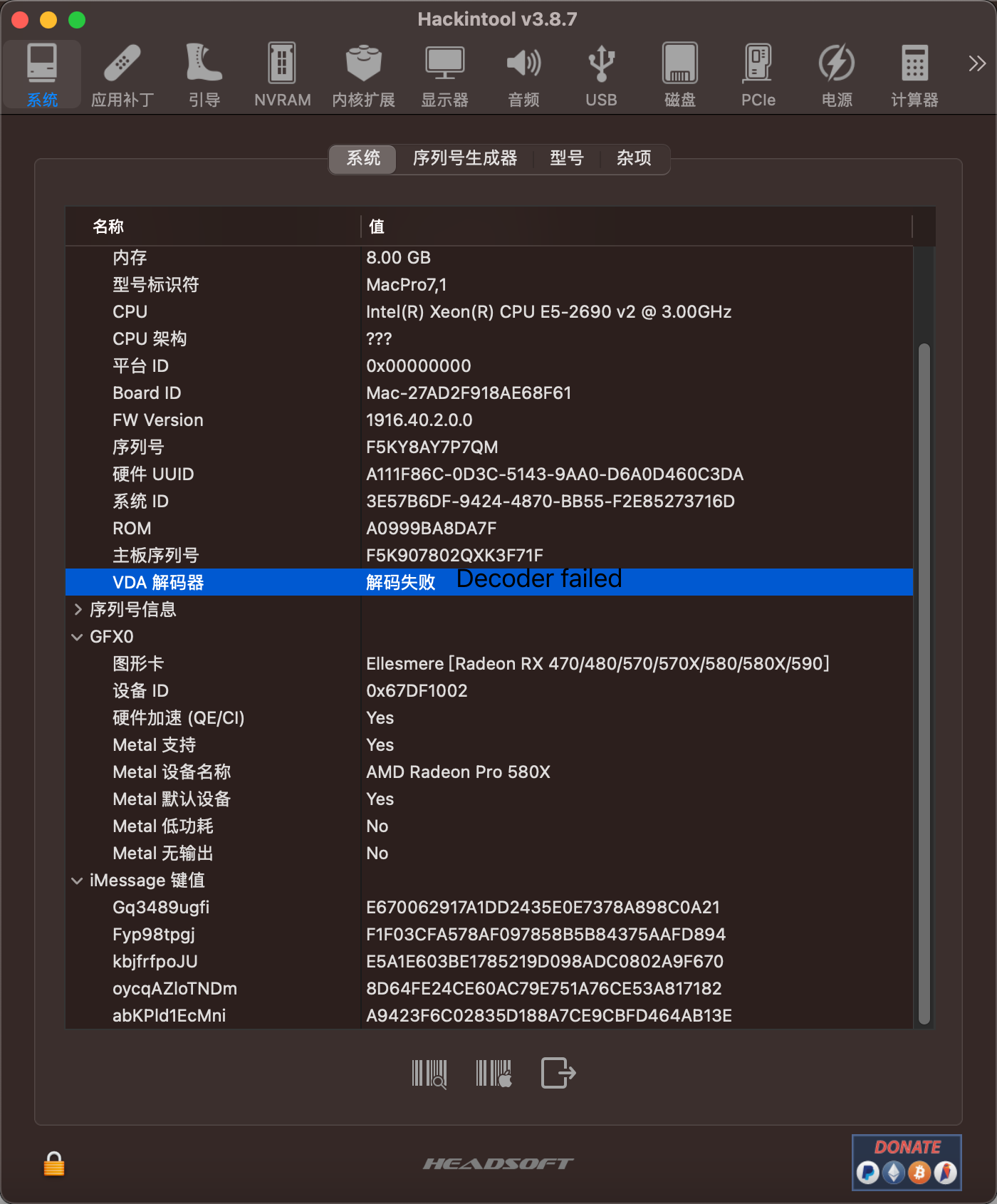

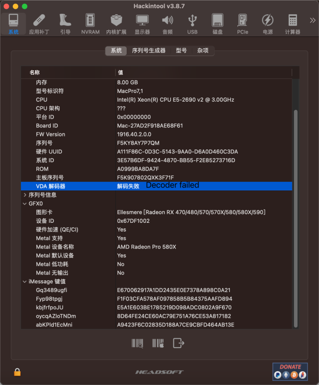

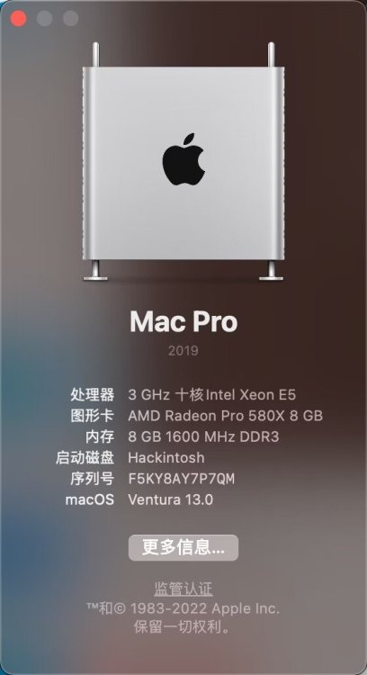

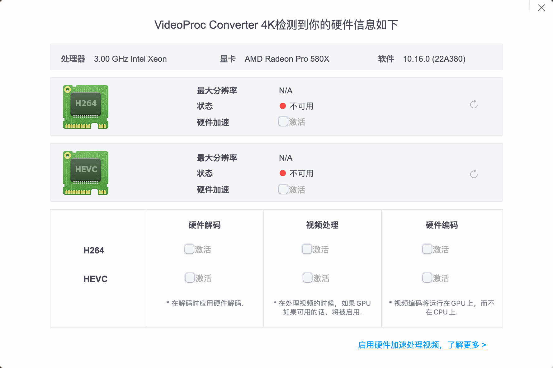

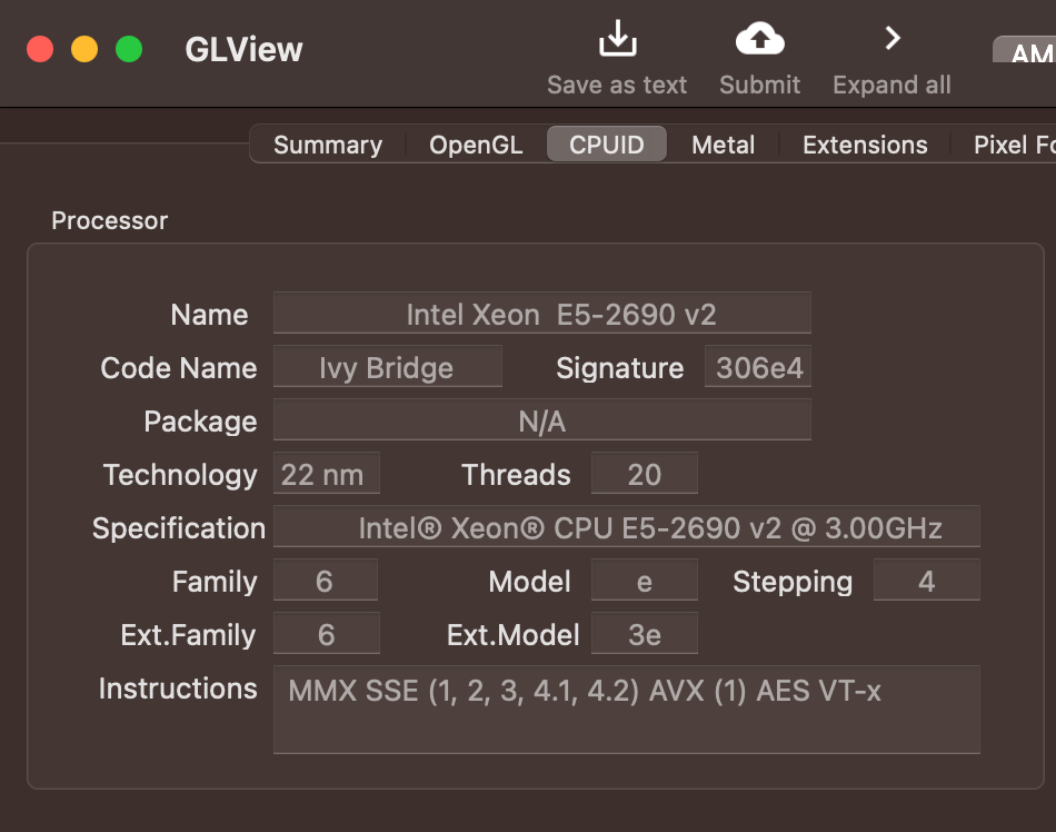

陈军鹏 Posted October 26, 2022 Share Posted October 26, 2022 How to get full hardware acceleration in AMD radeon RX 580 without iGPU and AVX2. VDA Decoder :Decoder failed Link to comment Share on other sites More sharing options...
miliuco Posted October 26, 2022 Share Posted October 26, 2022 22 minutes ago, 陈军鹏 said: How to get full hardware acceleration in AMD radeon RX 580 without iGPU and AVX2... Non AVX2 machines, iMac10,1 to iMac12,2 and MacPro3,1+MacPro5,1 using a Polaris dGPU, all these platforms currently no support DRM nor VDA Decoder (no Apple / Dortania support). Although you can set different SMBIOS with OpenCore (you have set MacPro7,1), really your hardware is like a 2012 MacPro so I think you can't get full hardware acceleration even with Polaris card. 3 Link to comment Share on other sites More sharing options...
