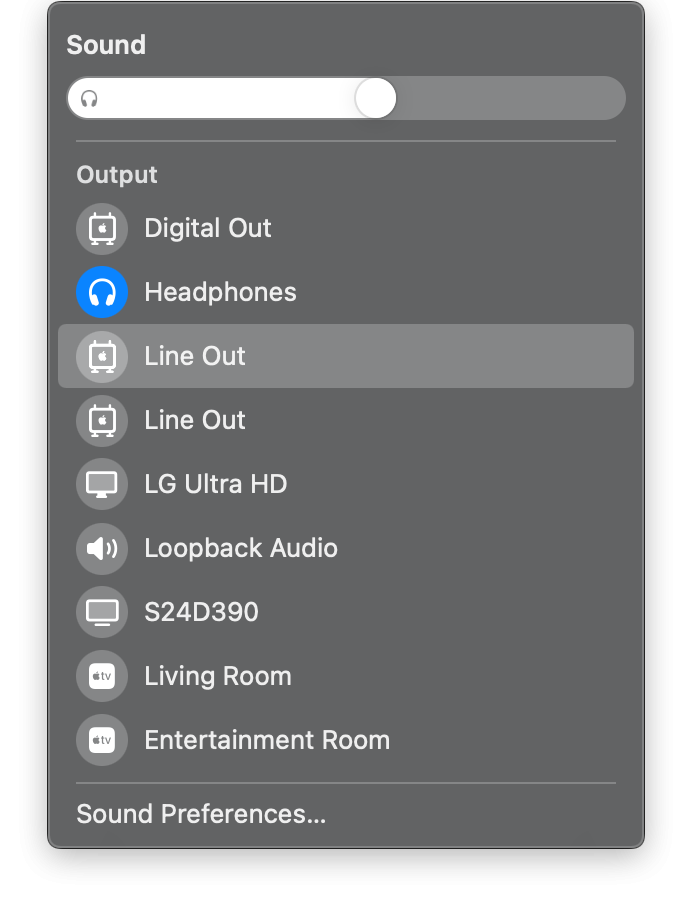

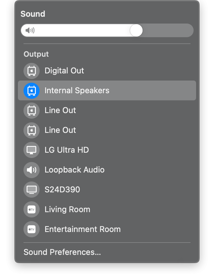

Guest 5T33Z0 Posted May 25, 2022 Share Posted May 25, 2022 @Cyberdevs Congrate on the new build. If you post a codec dump I could look into creating a new Layout-ID for your codec. I am srill learning this so it will take some time. The codec dump has to be generated in Linux so the tools I am using to visualize the routing can handle the data – dumps from Clover and OpenCore won't work. You can use Ventoy to run a live version from a usb flash drive directly from an ISO without having to install it and then run this terminal command in Linux to get the dump: cd ~/Desktop && mkdir CodecDump && for c in /proc/asound/card*/codec#*; do f="${c/\/*card/card}"; cat "$c" > CodecDump/${f//\//-}.txt; done && zip -r CodecDump.zip CodecDump Link to comment https://www.insanelymac.com/forum/topic/351792-ga-z690-aorus-master-intel-core-i9-12900k-hackintosh/page/2/#findComment-2782818 Share on other sites More sharing options...

Cyberdevs Posted May 25, 2022 Author Share Posted May 25, 2022 @5T33Z0 Thanks for the offer but I figured it out. I was injecting the layout-id via nvram but when i added the layout-id as a device properties it resolved the issue, so now when plug the headphone it detects it correctly and when I unplug it it shows the Internal Speaker. Thanks anyway 1 Link to comment https://www.insanelymac.com/forum/topic/351792-ga-z690-aorus-master-intel-core-i9-12900k-hackintosh/page/2/#findComment-2782823 Share on other sites More sharing options...
