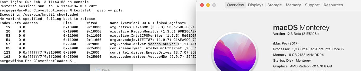

Slice Posted February 6, 2022 Share Posted February 6, 2022 4 hours ago, jsl2000 said: BTW can you fix VoodooTscSync.kext or CpuTscSync.kext to be working at Monterey because I found that you have the skill and experience to modify AppleIGB.kext well. I tested the kext VoodooTscSync in monterey 12.3b1 It works but I not need it so I don't know the result. First start the system say Quote Extension with identifiers org.voodoo.driver.VoodooTSCSync not approved to load. Please approve using System Preferences. I did this. Next boot I look into kernel.log and saw success Quote kernel: (Contents\MacOS\VoodooTSCSync) VoodooTSCSync: Current tsc from rdtsc64() is 33065177130057. Rendezvouing.. These kext attached. The project is forked to our git. VoodooTSCSync VoodooTSCSync.kext.zip VoodooTSCSyncAMD.kext.zip See also its Info.plist. There you should set VirtualNumberIfCores-1. So for my I5 I set 3 2 Link to comment https://www.insanelymac.com/forum/topic/350590-pre-release-macos-monterey-123/page/3/#findComment-2776356 Share on other sites More sharing options...

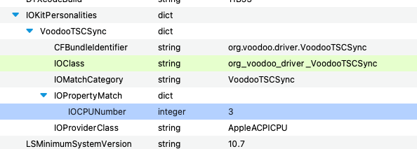

jsl2000 Posted February 6, 2022 Share Posted February 6, 2022 1 hour ago, Slice said: I tested the kext VoodooTscSync in monterey 12.3b1 It works but I not need it so I don't know the result. First start the system say I did this. Next boot I look into kernel.log and saw success These kext attached. The project is forked to our git. VoodooTSCSync VoodooTSCSync.kext.zip 8.43 kB · 2 downloads VoodooTSCSyncAMD.kext.zip 8.75 kB · 1 download See also its Info.plist. There you should set VirtualNumberIfCores-1. So for my I5 I set 3 Thanks for your prompt reply and help. In my Acer Veriton M4610 hackintosh it need VoodooTscSync.kext to boot for CPU i3-2120 (2C4T). This new one can boot Big Sur (11.6.4), but it will reboot at Monterey 12.3beta. I have set Number to 3. If it was set to 1, I'll get KP during booting of Monterey. Link to comment https://www.insanelymac.com/forum/topic/350590-pre-release-macos-monterey-123/page/3/#findComment-2776363 Share on other sites More sharing options...
Slice Posted February 6, 2022 Share Posted February 6, 2022 19 minutes ago, jsl2000 said: Thanks for your prompt reply and help. In my Acer Veriton M4610 hackintosh it need VoodooTscSync.kext to boot for CPU i3-2120 (2C4T). This new one can boot Big Sur (11.6.4), but it will reboot at Monterey 12.3beta. I have set Number to 3. If it was set to 1, I'll get KP during booting of Monterey. Can you catch the crash.log? I will to analyse why the KP. 1 Link to comment https://www.insanelymac.com/forum/topic/350590-pre-release-macos-monterey-123/page/3/#findComment-2776364 Share on other sites More sharing options...
jsl2000 Posted February 6, 2022 Share Posted February 6, 2022 8 minutes ago, Slice said: Can you catch the crash.log? I will to analyse why the KP. Do you need Number=1 KP crash report or Number=3 automatic reboot report ? Link to comment https://www.insanelymac.com/forum/topic/350590-pre-release-macos-monterey-123/page/3/#findComment-2776365 Share on other sites More sharing options...
Slice Posted February 6, 2022 Share Posted February 6, 2022 I think Number=3 is more interesting. 2 Link to comment https://www.insanelymac.com/forum/topic/350590-pre-release-macos-monterey-123/page/3/#findComment-2776368 Share on other sites More sharing options...
jsl2000 Posted February 6, 2022 Share Posted February 6, 2022 1 minute ago, Slice said: I think Number=3 is more interesting. Number=3 preboot.log preboot.log Link to comment https://www.insanelymac.com/forum/topic/350590-pre-release-macos-monterey-123/page/3/#findComment-2776369 Share on other sites More sharing options...
Slice Posted February 6, 2022 Share Posted February 6, 2022 6 minutes ago, jsl2000 said: Number=3 preboot.log preboot.log 112.69 kB · 0 downloads This is Sandy Bridge i3-2120. AFAIK never affected by TSC errors. May be your problem lays somewhere else? For example VirtualSMC. And I see you want to boot 12.3 which doesn't support Sandy Bridge as well as Keplers. So you have to make double workarounds to boot such a system. 1 Link to comment https://www.insanelymac.com/forum/topic/350590-pre-release-macos-monterey-123/page/3/#findComment-2776371 Share on other sites More sharing options...
jsl2000 Posted February 6, 2022 Share Posted February 6, 2022 (edited) 32 minutes ago, Slice said: This is Sandy Bridge i3-2120. AFAIK never affected by TSC errors. May be your problem lays somewhere else? For example VirtualSMC. And I see you want to boot 12.3 which doesn't support Sandy Bridge as well as Keplers. So you have to make double workarounds to boot such a system. Post-installation by GeoForce Kepler Patch can fix GT-730 graphics at Monterey without any issue. Booted by FakeSMC (3.5.0) still got reboot issue as before by VirtualSMC. Do you think it's the specific issue for Sandy Bridge only ? At present I must booted with cpus=1 to login desktop. preboot.log Edited February 6, 2022 by jsl2000 Link to comment https://www.insanelymac.com/forum/topic/350590-pre-release-macos-monterey-123/page/3/#findComment-2776372 Share on other sites More sharing options...
Slice Posted February 6, 2022 Share Posted February 6, 2022 It will be better you show kernel log corresponding to panic. Also exclude FSInject and AudioDxe. You may live without both. 1 Link to comment https://www.insanelymac.com/forum/topic/350590-pre-release-macos-monterey-123/page/3/#findComment-2776373 Share on other sites More sharing options...
jsl2000 Posted February 6, 2022 Share Posted February 6, 2022 28 minutes ago, Slice said: It will be better you show kernel log corresponding to panic. Also exclude FSInject and AudioDxe. You may live without both. Thanks and I need take a break now. Both FSInject & AudioDxe were deleted. preboot.log Link to comment https://www.insanelymac.com/forum/topic/350590-pre-release-macos-monterey-123/page/3/#findComment-2776375 Share on other sites More sharing options...
