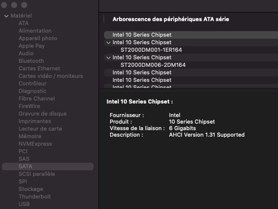

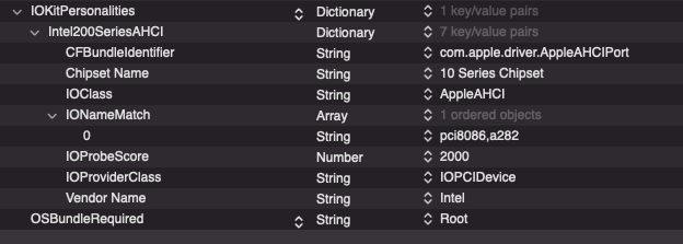

FredWst Posted November 22, 2020 Share Posted November 22, 2020 (edited) Hi, i've chipset 200 AHCI id a282, i inject id and change IOCLASS AppleIntelPchSeriesAHCI to AppleAHCI. At least now in system information it show Chipset Name you put in injector. IOReg always show AppleAHCI. I don't know if it has other positive effect. Fred Edited November 22, 2020 by FredWst 4 Link to comment Share on other sites More sharing options...
greythorne Posted November 23, 2020 Share Posted November 23, 2020 7 hours ago, FredWst said: Hi, i've chipset 200 AHCI id a282, i inject id and change IOCLASS AppleIntelPchSeriesAHCI to AppleAHCI. At least now in system information it show Chipset Name you put in injector. IOReg always show AppleAHCI. I don't know if it has other positive effect. Fred Hi could give me details how you do it? Mine shows a generic in Big Sur 11.0.1. Thanks. 1 Link to comment Share on other sites More sharing options...

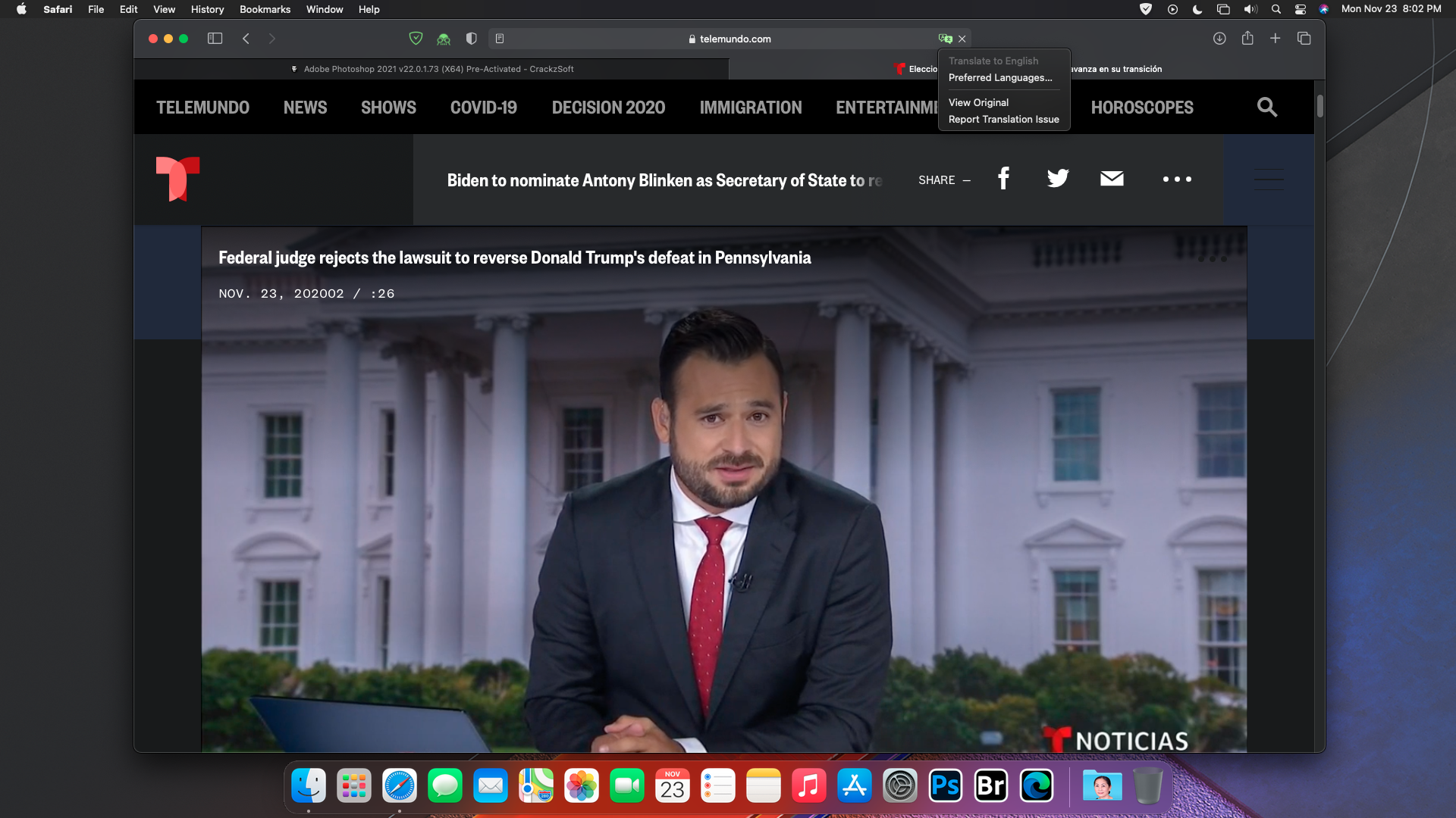

bisdak4920 Posted November 23, 2020 Share Posted November 23, 2020 Safari translator now available in my country - The Philippines. 2 Link to comment Share on other sites More sharing options...
Riley Freeman Posted November 24, 2020 Share Posted November 24, 2020 On 11/23/2020 at 2:20 AM, greythorne said: Hi could give me details how you do it? Mine shows a generic in Big Sur 11.0.1. Thanks. Easiest way is to use an injector kext. Here's the one from my Z68 (6 Series Chipset). Copy the correct entry for your chipset from /System/Library/Extensions/AppleAHCIPort.kext/Contents/Info.plist and change IOClass from AppleIntelPchSeriesAHCI to AppleAHCI. AHCIPortInjector.kext.zip 1 1 Link to comment Share on other sites More sharing options...

greythorne Posted November 30, 2020 Share Posted November 30, 2020 On 11/25/2020 at 1:58 AM, Riley Freeman said: Easiest way is to use an injector kext. Here's the one from my Z68 (6 Series Chipset). Copy the correct entry for your chipset from /System/Library/Extensions/AppleAHCIPort.kext/Contents/Info.plist and change IOClass from AppleIntelPchSeriesAHCI to AppleAHCI. AHCIPortInjector.kext.zip Great. That worked. Now SATA shows the correct chipset which is intel 10 series chipset. 1 Link to comment Share on other sites More sharing options...

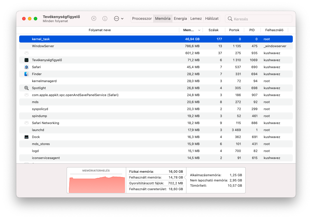

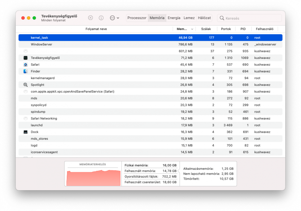

kushwavez Posted December 9, 2020 Share Posted December 9, 2020 (edited) Is there any way to downgrade Safari from 14 to 13? I have a very frustrating RAM usage issue when streaming 1080p videos. As you can see it's ridiculous high usage. It's eating up my swap so much and the system will become unusable. Not happening with Safari 13 on Catalina. If I just copy Safari 13 from Catalina it doesn't really work. This is also happening on a real MacBookAir (2017) and an iMac17,1, Notebook 1-2, and on my PC hack. Edited December 9, 2020 by kushwavez Link to comment Share on other sites More sharing options...
