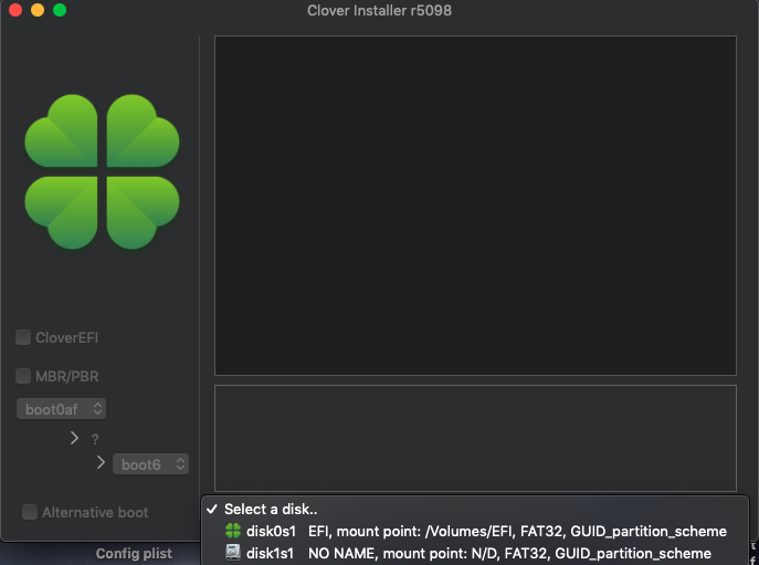

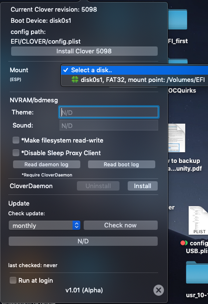

6 minutes ago, vector sigma said:
@Matgen84 thanks for your picture. Fat16 is not allowed, Clover legacy will never use it, so the installer is working properly. Backup your file and format the ESP in Fat32 ;)
I never use Fat16 and Clover Legacy: how my EFI partition is in FAT16 format?
Another OS doing that or a third party program? You almost made me take a heart attack Lol, but everything is ok instead.
Edited by vector sigma
27 minutes ago, vector sigma said:
@Matgen84
sudo newfs_msdos -v EFI -F 32 /dev/rdisk0s1
Thanks. All works fine.

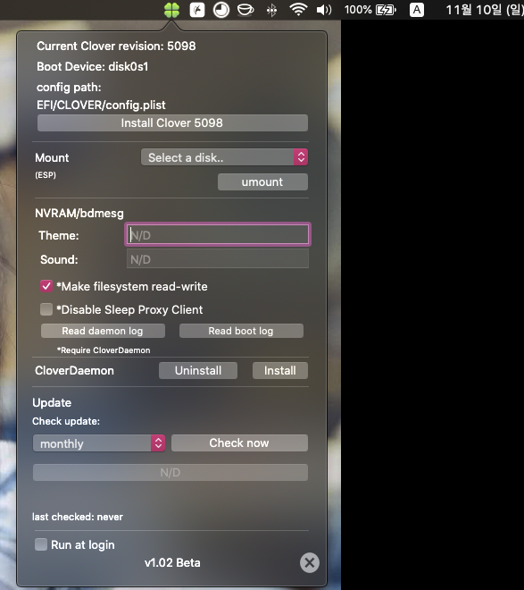

New Clover.app v1.02 Beta added at first post with the following fix:
Clver.app:
Corrected a bug that was causing the installer to fail on unknown drivers.
CloverDaemonNew :
Now is registered with the Power notifications (sleep and wake), so that can clean up nvram.plist files created by third party kexts.
At shut down it now delete the following nvram keys:
efi-backup-boot-device
efi-backup-boot-device-data
install-product-url
previous-system-uuid
Clover.app promoted to Beta.
@Sherlocks, now should does everything you told me.

1. Now is registered with the Power notifications (sleep and wake), so that can clean up nvram.plist files created by third party kexts.
- does it mean that nvram.plist that HBfixup created will be remove when enter hibernation mode?. if it is true, it is wrong.
first we have nvram.plist in ESP.
two when enter hibernate mode, HBfixup makes nvram.plist in root of macos.
and we turn on system, system starts to boot clover gui, when getting clover gui, clover read recent nvram.plist(last HBfixup made nvram.plist in root) then select macos partition. boot macos, your clover app check nvram.plist in location. then nvram will be remove in macos root.
this is entire process. if now your clover app was checkd for this process,
it is good.
2.At shut down it now delete the following nvram keys:
install-product-url
- it is good to keep more clean nvram to avoid created dummy nvram value when update macos.

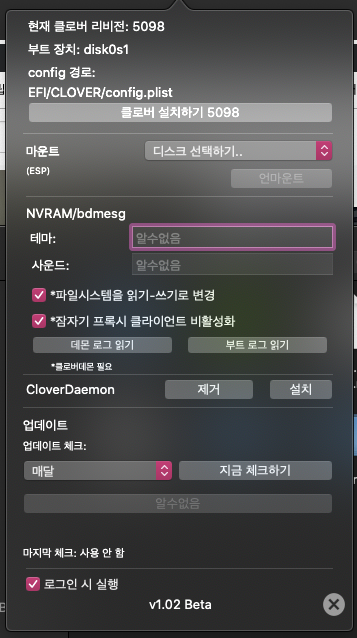

3. strangely korean lang pack is not working. only keep english now.
