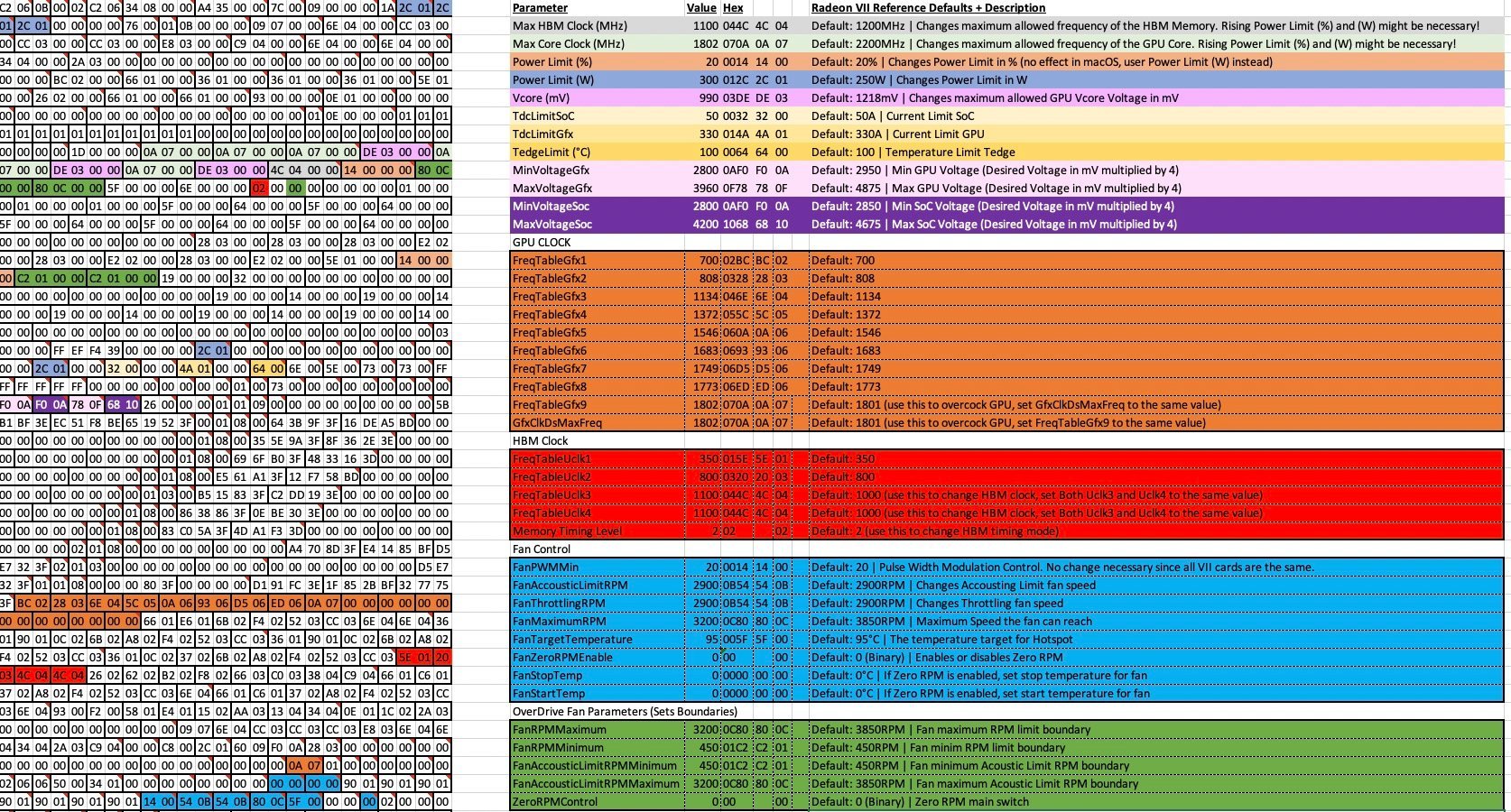

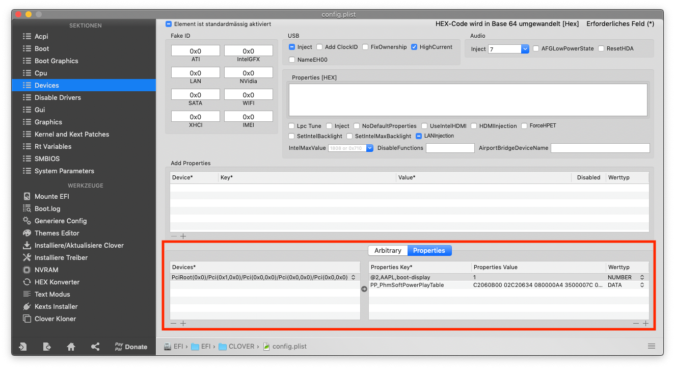

CMMChris Posted August 24, 2019 Share Posted August 24, 2019 (edited) Since apparently there is quite a big demand for it, I am now starting an official topic for my Radeon VII PowerPlay Table generator for macOS. It's a simple Excel spreadsheet where you can change the settings to your desired values. The result is a PowerPlay Table you can inject via Clover on your GPUs PCI path (example below). In Clover you can also use "PrimaryGPU" instead of the PCI path as target device. Recommendation: Set these device properties in addition to your PowerPlayTable. They come from the Mac Pro 2019 Pro Vega II framebuffer and will increase your Geekbench scores significantly. <key>ATY,EFIVersion</key> <data>MDEuMDAuMzE4MA==</data> <key>CFG_NVV</key> <integer>2</integer> <key>CFG_PTPL2_CNT</key> <integer>16</integer> <key>CFG_PTPL2_MAX</key> <integer>300</integer> <key>CFG_PTPL2_MIN</key> <integer>90</integer> <key>CFG_TPS1S</key> <integer>1</integer> <key>PP_ACDCGpioDisabled</key> <integer>0</integer> <key>PP_DiDtSQPatternWidthOverride</key> <integer>14</integer> <key>PP_DiDtSQStallPatternOverride</key> <integer>16383</integer> <key>PP_DisableDIDT</key> <integer>0</integer> <key>PP_DisablePCCLimitControl</key> <integer>1</integer> <key>PP_FclkGfxClkRatio</key> <integer>1036831949</integer> <key>PP_PhmUseDummyBackEnd</key> <integer>0</integer> <key>PP_WorkLoadPolicyMask</key> <integer>1</integer> If you have a good power supply and decent airflow in your case you can also use <key>PP_DisablePowerContainment</key> <integer>1</integer> Here is how the PowerPlay Table Generator looks like: It's possible to change GPU Clock, HBM Clock, GPU Voltage, SoC Voltage, SoC Clock, Power Limit, TDC Limit for GPU, TDC Limit for SoC as well as the Fan Curve. Something that's not working is ZeroRPM due to driver limitations. Turning those parameters on has no effect. The pre-set values are optimized for the vast majority of cards and use cases (changed Fan curve and UV as well as 1100MHz HBM OC). Please adjust if you have any issues. Warning: I am not responsible for any damaged cards by setting wrong / too high values. If you don't know what you are doing, don't touch it. Enjoy! RadeonVII-PPT-Generator.xlsx.zip Edited April 14, 2020 by CMMChris 9 5 Link to comment Share on other sites More sharing options...

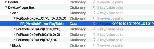

iTTT Posted August 25, 2019 Share Posted August 25, 2019 hi CMMChris, thats a very good tool. boot by Clover, now my R VII get 55802 scores in LuxMartk. i need to make a SSDT for this PPT if i use OpenCore. So do you know how to convert those Clover output data to SSDT format? thanks so much. Link to comment Share on other sites More sharing options...
HmO Posted August 25, 2019 Share Posted August 25, 2019 4 hours ago, iTTT said: hi CMMChris, thats a very good tool. boot by Clover, now my R VII get 55802 scores in LuxMartk. i need to make a SSDT for this PPT if i use OpenCore. So do you know how to convert those Clover output data to SSDT format? thanks so much. Just add PP_PhmSoftPowerPlayTable into Properties for your GPU 1 Link to comment Share on other sites More sharing options...
iTTT Posted August 25, 2019 Share Posted August 25, 2019 2 hours ago, HmO said: Just add PP_PhmSoftPowerPlayTable into Properties for your GPU that works. thanks so much. 1 Link to comment Share on other sites More sharing options...

CMMChris Posted September 12, 2019 Author Share Posted September 12, 2019 New Version 2.1 released (attached in starting post). Now you can enter GPU and SoC Min and Max voltages in mV instead of having to manually multiply the values by 4. 2 1 Link to comment Share on other sites More sharing options...

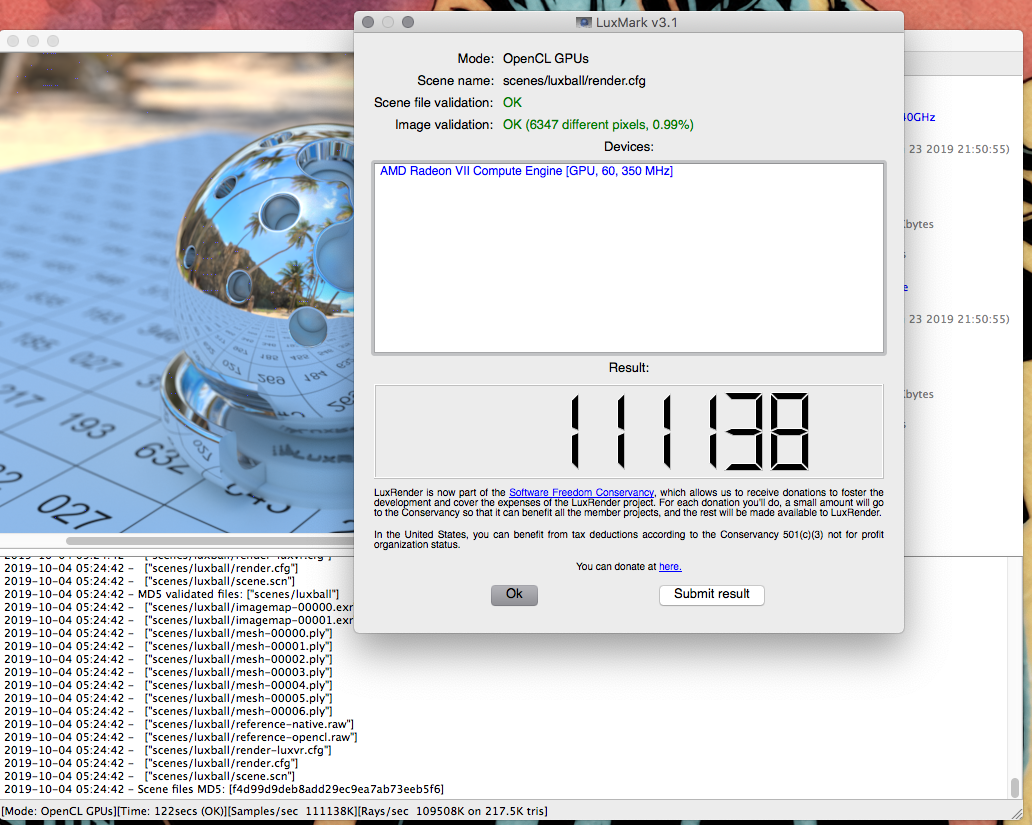

metacollin Posted October 7, 2019 Share Posted October 7, 2019 Lol, I am not sure if we should be using LuxMark, I don't think its results can always be trusted: 1 Link to comment Share on other sites More sharing options...
iTTT Posted October 8, 2019 Share Posted October 8, 2019 17 hours ago, metacollin said: Lol, I am not sure if we should be using LuxMark, I don't think its results can always be trusted: omg.....what is your setting? 1 Link to comment Share on other sites More sharing options...
NeXtor Posted October 15, 2019 Share Posted October 15, 2019 On 10/8/2019 at 8:23 AM, iTTT said: On 10/7/2019 at 2:41 PM, metacollin said: Lol, I am not sure if we should be using LuxMark, I don't think its results can always be trusted: omg.....what is your setting? I'm interested too 1 Link to comment Share on other sites More sharing options...

dlawrence Posted January 28, 2020 Share Posted January 28, 2020 @CMMChris - Many thanks for releasing this tool. I plan to use it when I get a Radeon VII to replace my 1080Ti. A couple questions: 1) I'm a bit new to this so where in Clover do parameters PP_DisableDIDT=1 (Number) and PP,PP_DisableULV=0 (Number) get set? 2) I'm planing to put an AIO water block on the card to get better performance and silence (my 1080Ti is an Aorus Waterforce Extreme so I'm used to fast and quiet). Is there anyway to set the AIO fan curves from the card's temperature, or do I just have to pick a speed and leave it? Thanks for your help! Link to comment Share on other sites More sharing options...

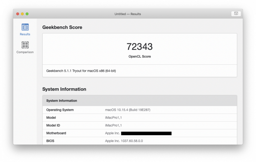

CMMChris Posted April 14, 2020 Author Share Posted April 14, 2020 (edited) I added recommended additional device properties in the opening post. Those significantly enhance Geekbench results, bringing your Radeon VII closer to the Pro Vega II in the new Mac Pro. @Teress Might be interesting for you as well. Edited April 14, 2020 by CMMChris 1 1 Link to comment Share on other sites More sharing options...

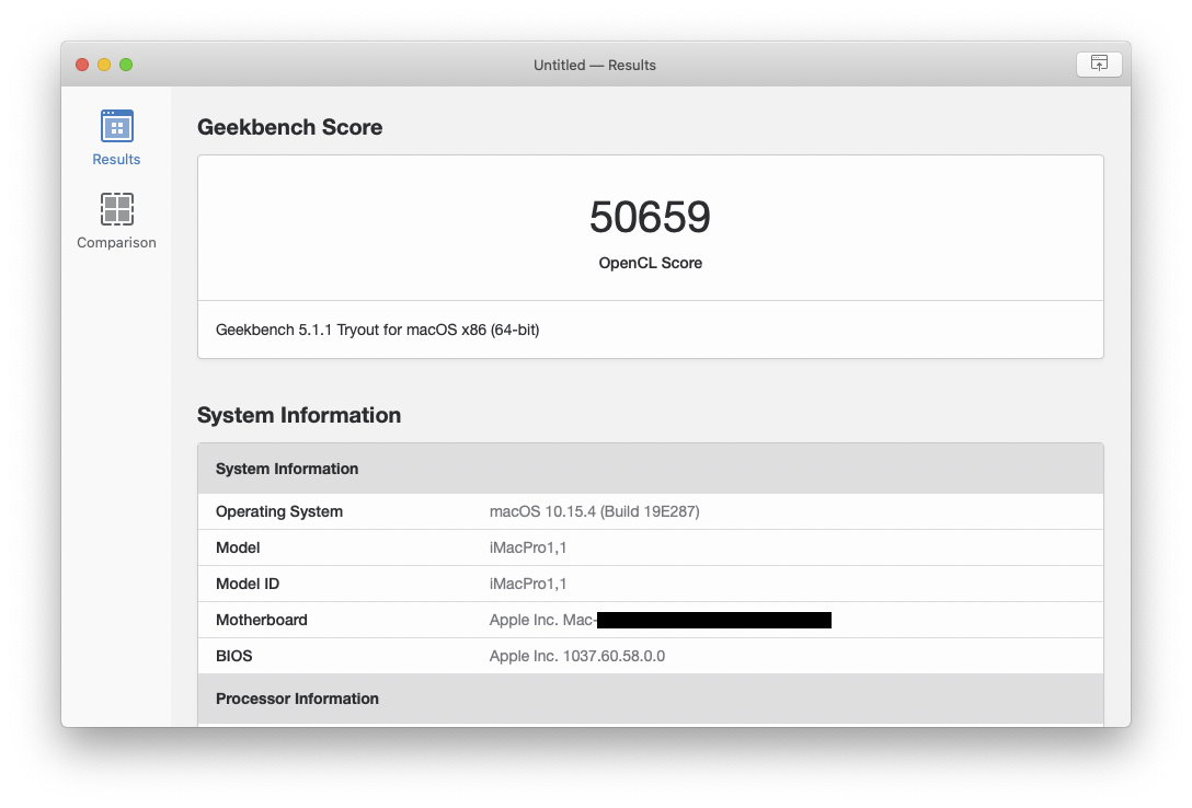

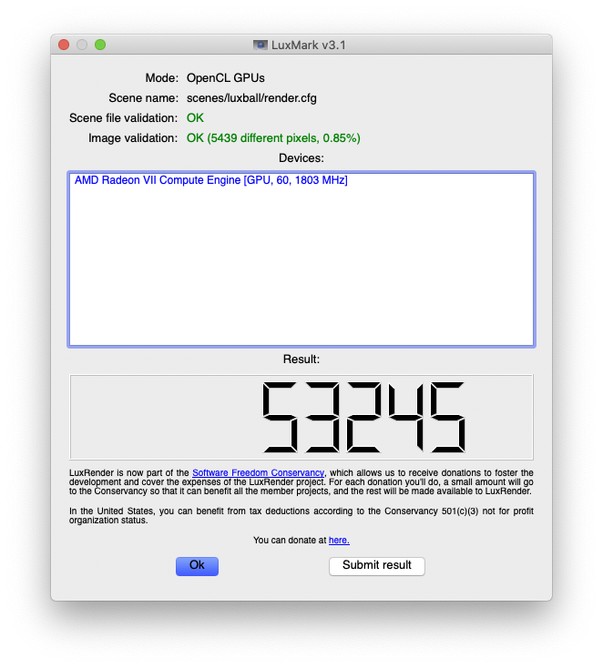

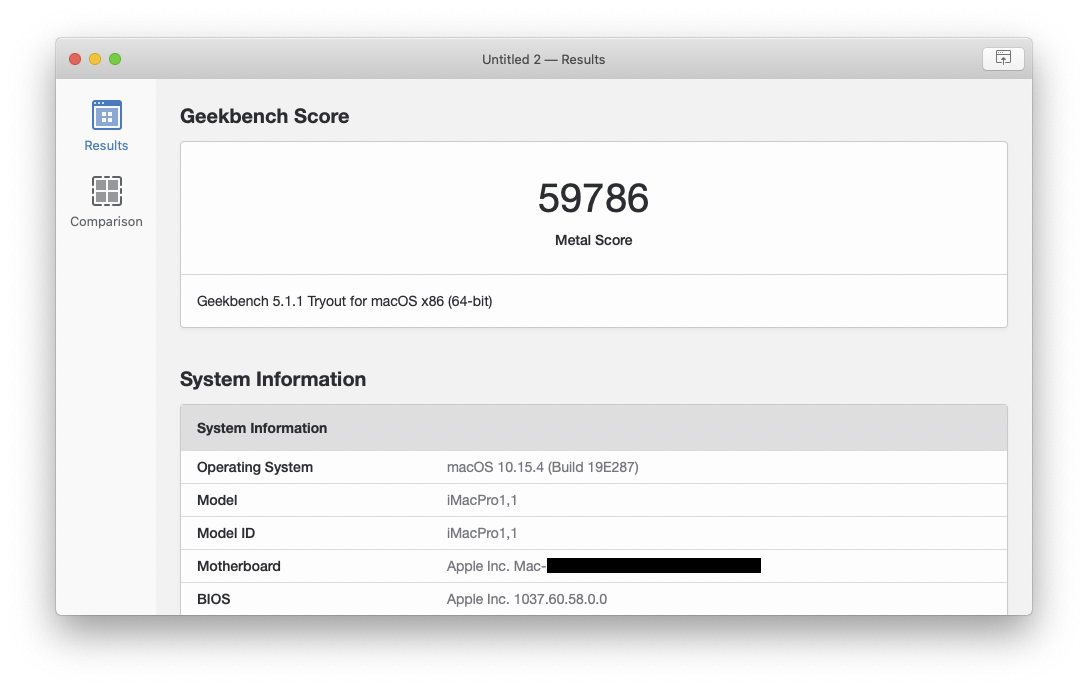

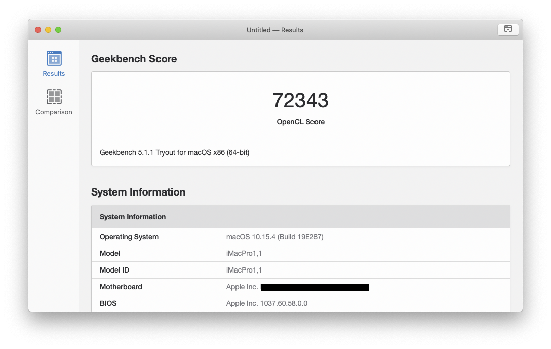

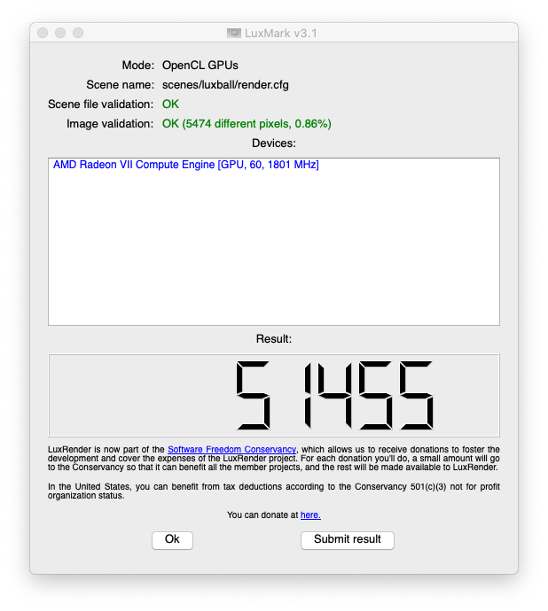

augustopaulo Posted April 16, 2020 Share Posted April 16, 2020 (edited) On 4/14/2020 at 1:40 PM, CMMChris said: I added recommended additional device properties in the opening post. Those significantly enhance Geekbench results, bringing your Radeon VII closer to the Pro Vega II in the new Mac Pro. @Teress Might be interesting for you as well. Thanks for the update @CMMChris! I've used the standard values from your latest excel. Did improve my GeekBench Scores quite a bit!! Metal up by 31.4% & OpenCL by 30%!! But the LuxMark are almost the same (51455->53245)... Any advice to improve these ? My Clover Devices->Properties section: Spoiler <key>PciRoot(0x0)/Pci(0x1,0x0)/Pci(0x0,0x0)/Pci(0x0,0x0)/Pci(0x0,0x0)</key> <dict> <key>@2,AAPL,boot-display</key> <integer>1</integer> <key>ATY,EFIVersion</key> <data>MDEuMDAuMzE4MA==</data> <key>CFG_NVV</key> <integer>2</integer> <key>CFG_PTPL2_CNT</key> <integer>16</integer> <key>CFG_PTPL2_MAX</key> <integer>300</integer> <key>CFG_PTPL2_MIN</key> <integer>90</integer> <key>CFG_TPS1S</key> <integer>1</integer> <key>PP_ACDCGpioDisabled</key> <integer>0</integer> <key>PP_DiDtSQPatternWidthOverride</key> <integer>14</integer> <key>PP_DiDtSQStallPatternOverride</key> <integer>16383</integer> <key>PP_DisableDIDT</key> <integer>0</integer> <key>PP_DisablePCCLimitControl</key> <integer>1</integer> <key>PP_DisablePowerContainment</key> <integer>1</integer> <key>PP_FclkGfxClkRatio</key> <integer>1036831949</integer> <key>PP_PhmSoftPowerPlayTable</key> <data>wgYLAALCBjQIAACkNQAAfAAJAAAAGvoA+gD6AAAAAAB2AAELAAAACQcAAG4EAADMAwAAzAMAAMwDAADoAwAAyQQAAG4EAABuBAAANAQAACoDAAAAAAAAAAAAAAAAAAAAAAAAAAAAALwCAABmAQAANgEAADYBAAA2AQAAXgEAACYCAABmAQAAZgEAAJMAAAAOAQAAAAAAAAAAAAAAAAAAAAAAAAAAAAABDgAAAAEBAQEBAQEBAQEBAQEBAAAAAAAAAAAAAAAAAAAAAAAAHQAAAJgIAACYCAAAmAgAAAYEAACYCAAABgQAAJgIAAAGBAAAsAQAABQAAAAoCgAAKAoAAF8AAABuAAAAAgAAAAAAAAABAAAAAQAAAAEAAABfAAAAZAAAAF8AAABkAAAAXwAAAGQAAABfAAAAZAAAAF8AAABkAAAAAAAAAAAAAAAAAAAAKAMAACgDAAAoAwAA4gIAACgDAADiAgAAKAMAAOICAABeAQAAFAAAAMIBAADCAQAAGQAAADIAAAAAAAAAAAAAAAAAAAAAAAAAAAAAABkAAAAUAAAAGQAAABQAAAAZAAAAFAAAABkAAAAUAAAAGQAAABQAAAAAAAAAAAAAAAAAAAAAAAAAAAAAAAAAAwAAAP/v9DkAAAAA+gAAAAAAAAAAAAAAAAAAAPoAAAAyAAAASgEAAGQAbgBeAHMAcwD///////8AAAAAAAAAAAEAcwAAAAAAAAAAACgKIAsYEDARJgAAAAEBCQAAAAAAAAAAAFuxvz7sUfi+ZRlSPwABCABkO58/Ft6lvQAAAAAAAAAAAAAAAAABCAA1Xpo/jzYuPgAAAAAAAAAAAAAAAAABCABpb7A/SDMWPQAAAAAAAAAAAAAAAAABCADlYaE/EvdYvQAAAAAAAAAAAAAAAAABAwC1FYM/wt0ZPgAAAAAAAAAAAAAAAAABCACGOIY/Dr4wPgAAAAAAAAAAAAAAAAABCACDwFo/TaHzPQAAAAAAAAAAAAAAAAIBCAAAAAAAAAAAAKRwjT/kFIW/1ecyPwIBAwAAAAAAAAAAAAAAAAAAAAAA1ecyPwEBCAAAAIA/AAAAANGR/D4fhSu/Mnd1P7wCKANuBFwFCgaTBtUG7QYKBwAAAAAAAAAAAAAAAAAAZgHmAWsC9AJSA8wDbgRuBDYBkAEMAmsCqAL0AlIDzAM2AZABDAJrAqgC9AJSA8wDNgEMAjcCawKoAvQCUgPMA14BIANMBEwEJgJiArIC+AJmA8ADOATJBGYBxgE3AqgC9AJSA8wDbgRmAcYBNwKoAvQCUgPMA24EkwDyAFgB5AEVAqoDEwQ0BA4BHAIqAwAAAAAAAAAAAAAJB24EzAPMA8wD6ANuBG4ENAQqA8kEAADIACwBYAnwCigDAAAAAAAAAAAAAAAAAAAAAAAAAAAAAAoHAQAAAAAAAAIGBlAANAEAAAAAAAAAAAAAAACQAZABkAGQAZABkAGQARQAKAooCigKXwAAAAACAAAAAAAAAAAAAQAAAAAAAFCNlzwK16M7AAAAAOqymDyHokA9AAAAAAAAAAAAAAAAAAAAAAAAAAAAAAAAAAAAAAAAAAAAAAAAAAAAAAAAAAAAAAAAAAAAAAAAAAAAAAAAAAAAAAAAAAAAAAAAAAAAAAAAAAAAAAAAAAAAAAAAoAABAAAAAAAAAKAAAAAIEAIQGgRMBOgD6APoA+gDAAAAAAAAAAAAAAAAAAAAAAAAAAAAAAAAAAAAAAAAAAAAAAAAAAAAAAAAAAAAAAAAAAAAAAAAAACGCyILVAsAAJABkAE4AAAAAAAAAAAAAAAAAAAAAAAAAAAAAAAAAAAAAAAAAAAAAAAAAAAAAAAAAAAAAAAAAAAAAAAAAAAAAAAAAAAAAAAAAAAAAAAAAAAAAAAAAAAAAAAAAAAAAAAAAAAAAAAAAAAAAAAAAAAAAAAAAAAAAAAAAAAAAAAAAAAAAAAAAAAAAAAAAAAAAAAAAAAAAAAAAAAAAAAAAAAAAAAAAAAAAAAAAAAAAAAAAAAAAAAAAAAAAAAAAAAAAAAAAAAAAAAAAAAAAAAAAAAAAAAAAAAAAAAAAAAAAAAAAAAAAAAAAAAAAAAAAAAAAAAAAAAAAAAAAAAAAAAAAAAAAAAAAAAAAAAAAAAAAAAAAAAAAAAAAAAAAAAAAAAAAAAAAAAAAAAAAAAAAAAAAAAAAAAAAAAAAAAAAAAAAAAAAAAAAAAAAAAAAAAAAAAAAAAAAAAAAAAAAAAAAAAAAAAAAAAAAAAAAAAAAAAAAAAAAAAAAAAAAAAAAAAAAAAAAAAAAAAAAAAAAAAAAAAAAA==</data> <key>PP_PhmUseDummyBackEnd</key> <integer>0</integer> <key>PP_WorkLoadPolicyMask</key> <integer>1</integer> </dict> Edited April 16, 2020 by augustopaulo Link to comment Share on other sites More sharing options...
CMMChris Posted April 16, 2020 Author Share Posted April 16, 2020 Nothing to improve with your Luxmark scores. Almost on par with the windows drivers. The properties just fix the issue that Geekbench reports low scores. Link to comment Share on other sites More sharing options...
