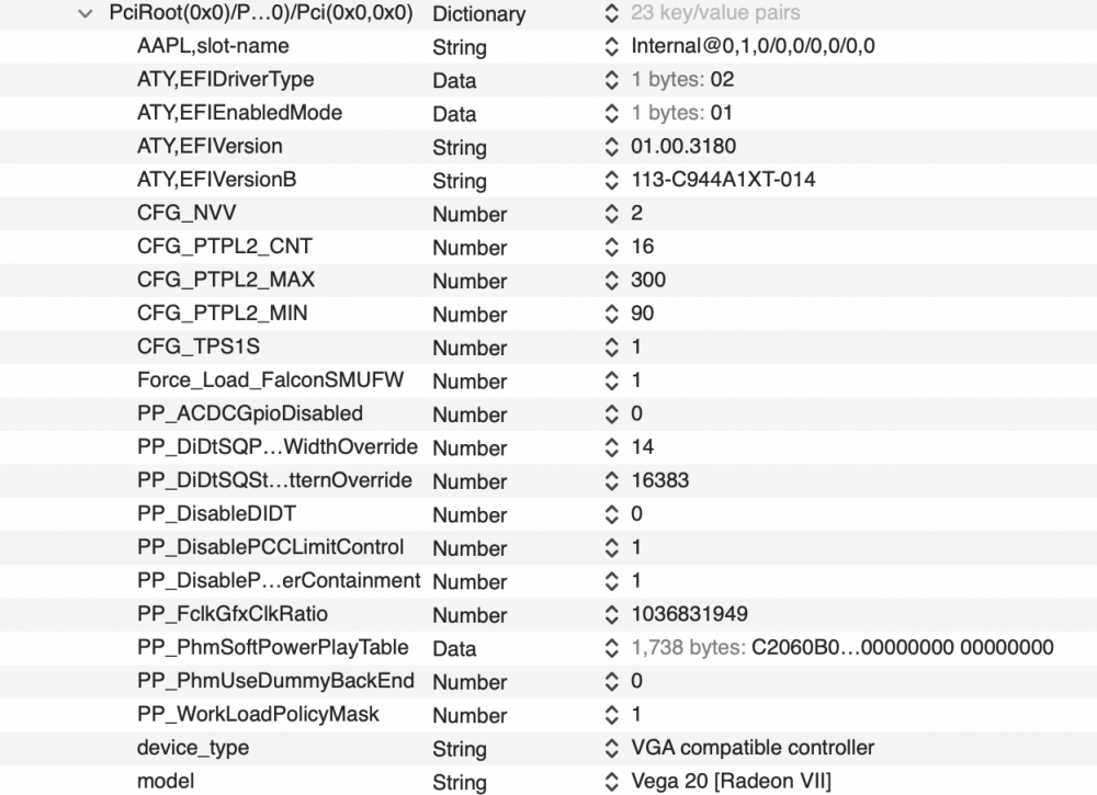

hackaro Posted December 17, 2020 Share Posted December 17, 2020 (edited) @CMMChris Hi Chris! I've just upgraded to 11.1 and I'm still using these properties (see attach) in OC 0.6.4 but they are not working anymore... is there anything we can do to have our boost back? Edited December 17, 2020 by hackaro Link to comment https://www.insanelymac.com/forum/topic/340009-tool-radeon-vii-powerplay-table-generator-oc-uv-fan-curve/page/2/#findComment-2747227 Share on other sites More sharing options...
Picasso Posted December 25, 2020 Share Posted December 25, 2020 On 12/17/2020 at 11:05 AM, hackaro said: @CMMChris Hi Chris! I've just upgraded to 11.1 and I'm still using these properties (see attach) in OC 0.6.4 but they are not working anymore... is there anything we can do to have our boost back? Hi @hackaro, come stai? Can you share Radeon VII Properties into Open Core? I want to apply the setting in a correct way and test it. I can't find any guide to do this in OC. Grazie! Link to comment https://www.insanelymac.com/forum/topic/340009-tool-radeon-vii-powerplay-table-generator-oc-uv-fan-curve/page/2/#findComment-2747671 Share on other sites More sharing options...
hackaro Posted December 26, 2020 Share Posted December 26, 2020 21 hours ago, Picasso said: Hi @hackaro, come stai? Can you share Radeon VII Properties into Open Core? I want to apply the setting in a correct way and test it. I can't find any guide to do this in OC. Grazie! ecco qua! let me know if it works... under BigSur 11.1 it doesn't boost anymore snippet.plist Link to comment https://www.insanelymac.com/forum/topic/340009-tool-radeon-vii-powerplay-table-generator-oc-uv-fan-curve/page/2/#findComment-2747698 Share on other sites More sharing options...
Picasso Posted January 2, 2021 Share Posted January 2, 2021 On 12/26/2020 at 4:53 PM, hackaro said: ecco qua! let me know if it works... under BigSur 11.1 it doesn't boost anymore snippet.plist Ciao @hackaro happy new year! It doesnt work even in Catalina. I think it's something related to OC 0.6.4, because with 0.6.3 worked. Link to comment https://www.insanelymac.com/forum/topic/340009-tool-radeon-vii-powerplay-table-generator-oc-uv-fan-curve/page/2/#findComment-2748074 Share on other sites More sharing options...

Aluveitie Posted March 21, 2022 Share Posted March 21, 2022 Big Sur locked down the properties on the unnamed framebuffer, with the VII you had to use the Araguaia Framebuffer to do this. With Monterey I think this works again, it at least seemed to work through an injector kext. Link to comment https://www.insanelymac.com/forum/topic/340009-tool-radeon-vii-powerplay-table-generator-oc-uv-fan-curve/page/2/#findComment-2778685 Share on other sites More sharing options...
