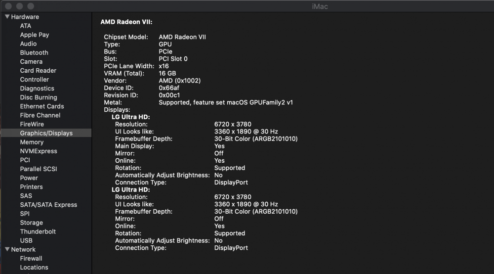

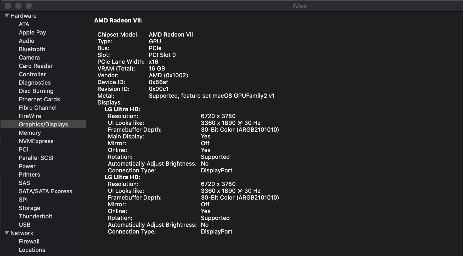

viccan Posted February 16, 2020 Share Posted February 16, 2020 @MaLd0n Have a lil problem and not sure what's causing it, but My graphics are only running @ 30Hz ? I noticed the lag yesterday and can't seem to get it running @ 60hz as it used to.. Any ideas or way you could help me out please? Both my displays are connected via Display port and not HDMI. Link to comment Share on other sites More sharing options...
