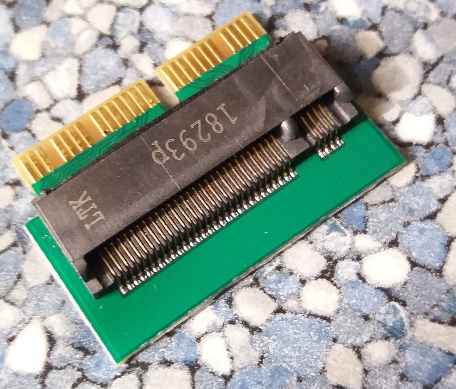

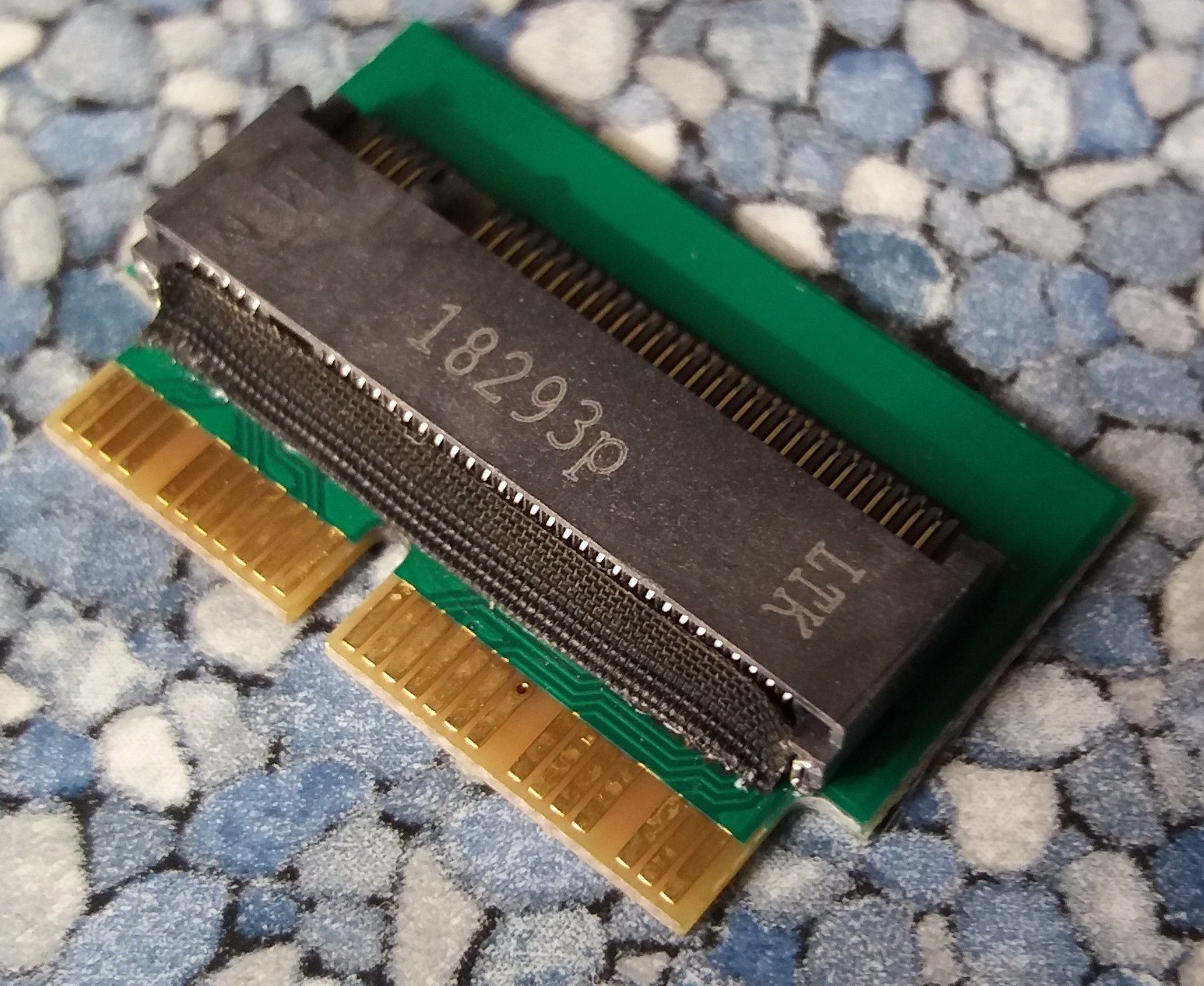

SMCprog Posted May 4, 2019 Share Posted May 4, 2019 (edited) First of all to upgrade from original Apple NVMe SSD to M.2 NVMe SSD like Samsung 970 You will need to buy an adapter like this: You can use any M.2 NVMe SSD drive, but I would not offer you to choose any of them except Intel 760p 256GB/512GB/1TB. The reason is simple - everybody who faced with such upgrades know that after installing Samsung SSD, WD SSD or others you wil have problems with waking your Mac from sleep(it will reboot each time, or you will have to switch "deep sleep" off) and also you will have problems with reboot(on reboot it will show you folder with a question mark, so you will have to shut Mac down and switch it on again). With Intel 760p SSD's you won't have such problems. It is very easy to explain why - original Apple SSD takes 2.3A of current at peak load. At the same time Samsung SSD's and others take over 2.5A of current on peak load, but Macs logic board was developed to let this part consume 2.3A of current. This means that your Mac won't be able to feed these SSD's at peak loads. At the same time Intel 760p SSD takes only 1.3-1.4A of current at peak load. With it all Macs functions will work perfectly, won't give extra heat(as Samsung or others) and even save a little bit of energy when working on battery. Yes, Intel is a little bit slower than Samsung, but simple user won't be able to notice the difference in working speed. So my advice to all who upgrades from OEM SSD is to switch to Intel 760p. Update: This info is only for 2015 year. 2013-2014 probably will will have all mentioned problems even with Intel 760p because they had problems even on OEM SSD drives. From my upgrade practice only 1 of 3 Macs worked without problems. Can't tell why. Edited May 5, 2019 by SMCprog 1 Link to comment https://www.insanelymac.com/forum/topic/338258-upgrading-my-macbook-pro-13-2015-ssd-storage-options/#findComment-2672494 Share on other sites More sharing options...
