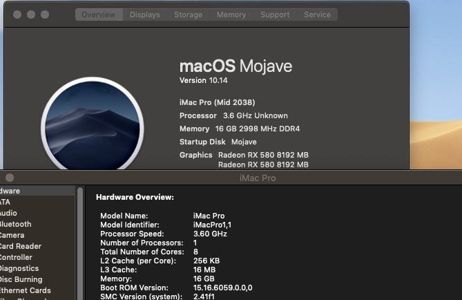

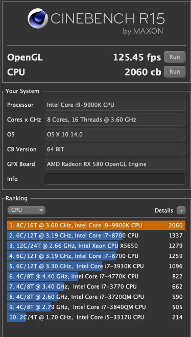

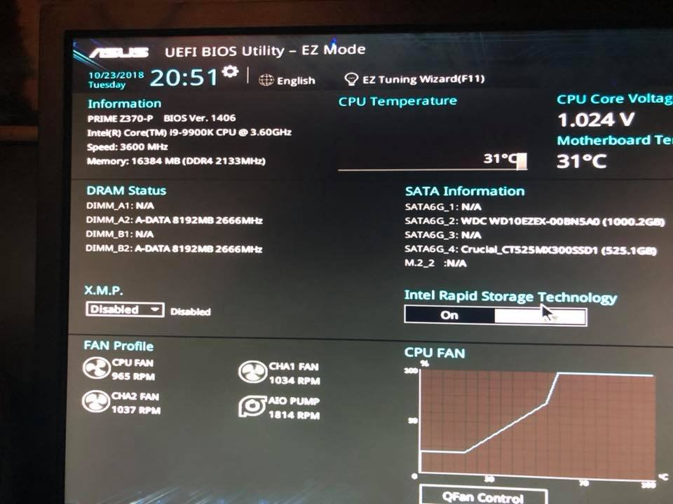

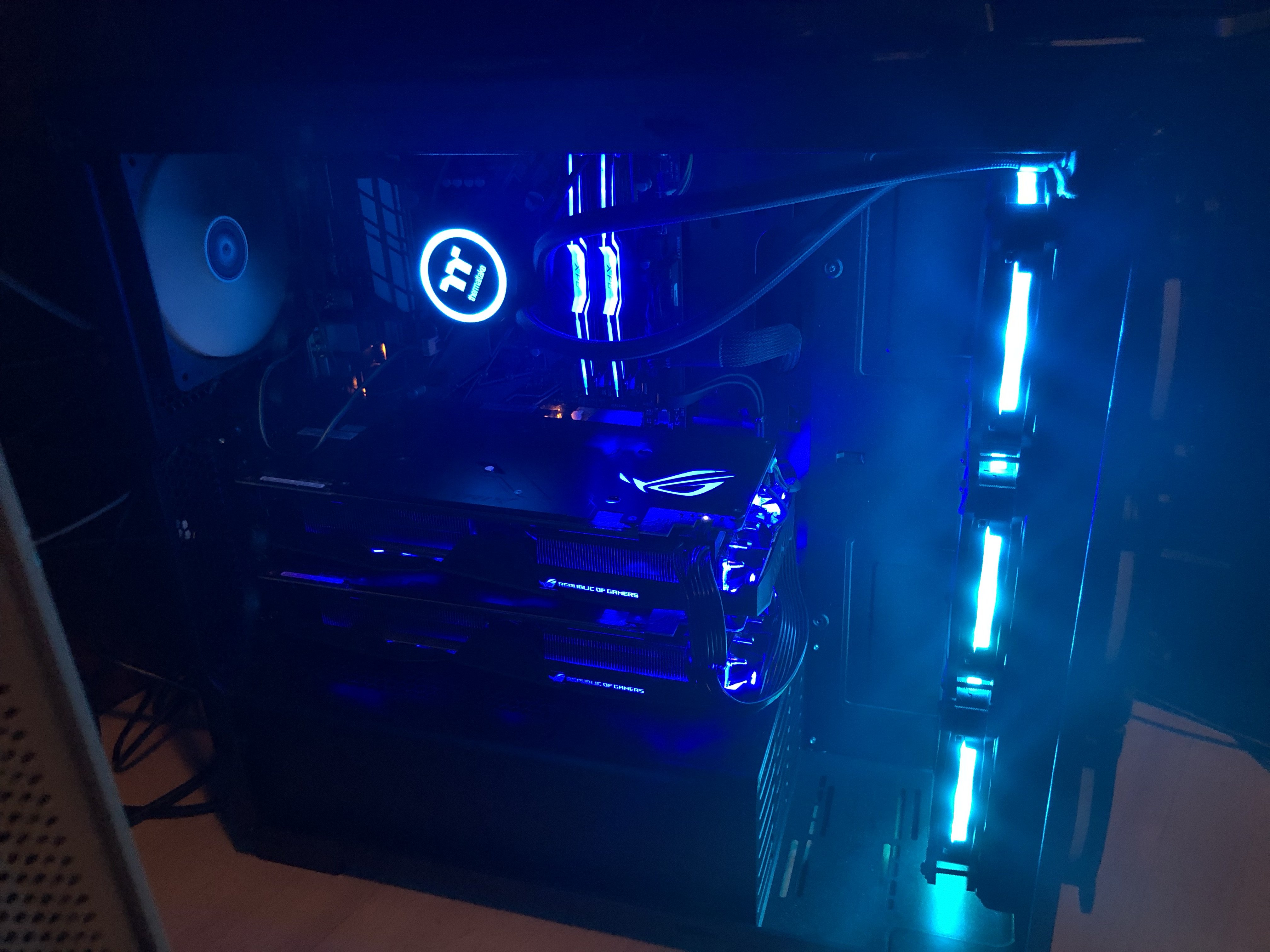

Erroruser Posted October 23, 2018 Share Posted October 23, 2018 Asus z370-p i9 9900k 3.6 GHz XPG Spectrix D40 RGB 3000MHz 16GB Asus GOD Strix rx 580 8g x2 Thermaltake CL-W158-PL12SW-A Floe Triple Ring RGB 360mm AIO 3 Link to comment https://www.insanelymac.com/forum/topic/336132-the-beast/ Share on other sites More sharing options...
onemanOSX Posted October 23, 2018 Share Posted October 23, 2018 beastly numbers!! 1 Link to comment https://www.insanelymac.com/forum/topic/336132-the-beast/#findComment-2642700 Share on other sites More sharing options...
Allan Posted October 24, 2018 Share Posted October 24, 2018 Wow!! 1 Link to comment https://www.insanelymac.com/forum/topic/336132-the-beast/#findComment-2642718 Share on other sites More sharing options...

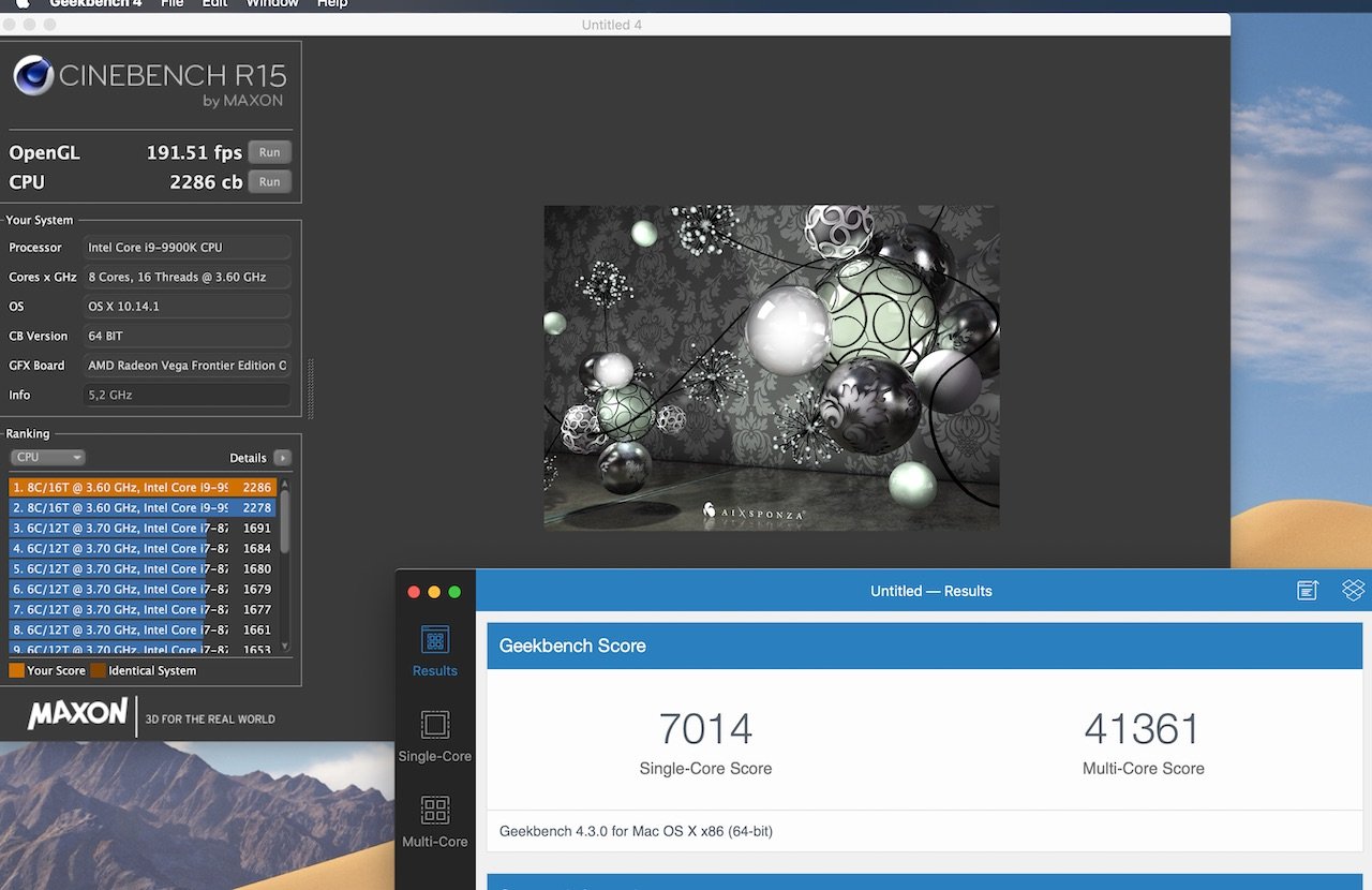

Brumbaer Posted October 24, 2018 Share Posted October 24, 2018 Overclocked to 5200. Board Z390 Phantom Gaming itx/ac 3 Link to comment https://www.insanelymac.com/forum/topic/336132-the-beast/#findComment-2642816 Share on other sites More sharing options...

Erroruser Posted October 24, 2018 Author Share Posted October 24, 2018 @Brumbaer that a nice score i was thinking of doing a o/c to test out an see what it has an thinking of going with a ROG Maximus XI Hero or just stick in the prime area Link to comment https://www.insanelymac.com/forum/topic/336132-the-beast/#findComment-2642870 Share on other sites More sharing options...

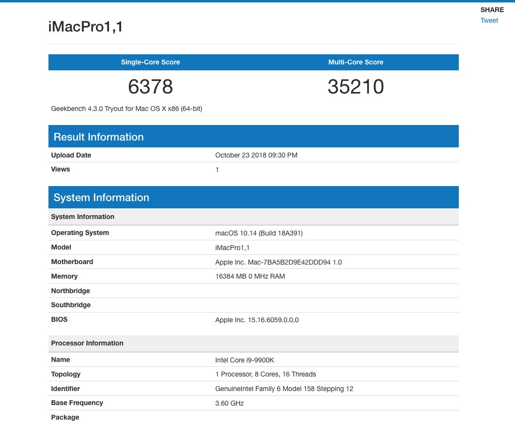

wham17wham Posted October 24, 2018 Share Posted October 24, 2018 iMac Pro (Mid 2038) 2 Link to comment https://www.insanelymac.com/forum/topic/336132-the-beast/#findComment-2642903 Share on other sites More sharing options...

Brumbaer Posted October 25, 2018 Share Posted October 25, 2018 23 hours ago, errorexists said: @Brumbaer that a nice score i was thinking of doing a o/c to test out an see what it has an thinking of going with a ROG Maximus XI Hero or just stick in the prime area Go ahead 5GHz on all cores should always be possible. Whether you go higher or not is just a question of your cooling solution and the strength of your wish to pass 7000/40000 Of course a 4% higher benchmark score can not be felt in daily operation, but sometimes you just have to cross that line of nice round numbers 1 Link to comment https://www.insanelymac.com/forum/topic/336132-the-beast/#findComment-2643064 Share on other sites More sharing options...
