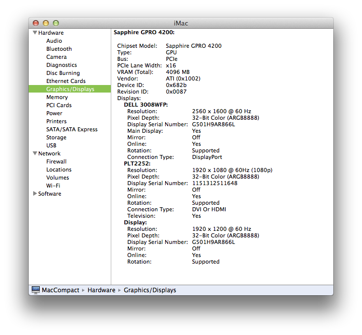

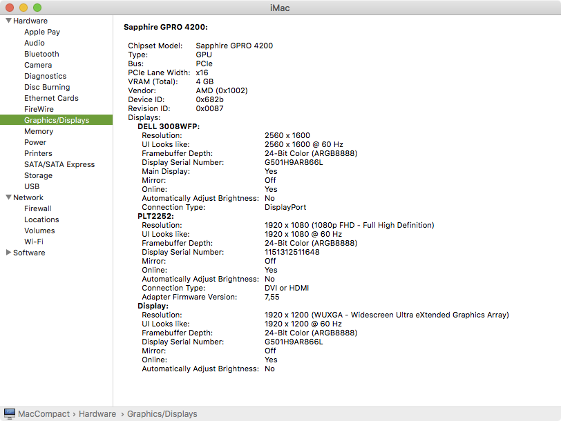

naquaada Posted July 18, 2025 Share Posted July 18, 2025 (edited) Now everything is working. Because neither on the slot nor on the PCB is a number, I assumed the first video port was the one on the bottom. This would have make sense because the 4200 has 4 ports and then ports 5 and 6 are added for the 6200 above them. But it was the other way round. The first port is on the top. Now I have three monitors, the VRAM is recognized and also the name entered in Clover is now displayed correctly. It's working in Mavericks and Mojave. The third monitor 'display' is using an passive Mini-DP -> DVI-Adapter. It's difficult to find an active DVI adapter which also supports Dual-Link. I have still enough DVI 4:3 monitors, so I want to use them. The only problem is the CPU name, it is shown as 700 MHz Intel Core i7 in the info and in System Profiler it has 1,6 GHz. It is an Intel Core i7 3770S with 3.1 GHz. The next step is getting Monterey to work on my Ivy Bridge systems. But I get a kernel panic soon when booting. Edited July 18, 2025 by naquaada Link to comment https://www.insanelymac.com/forum/topic/336118-amd-7750-7770-7xxxx-fixture-for-mojave/#findComment-2837386 Share on other sites More sharing options...
