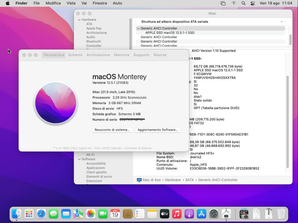

PippoX0 Posted August 19, 2022 Share Posted August 19, 2022 (edited) Hi, booring moring, so why don't experiment something wierd ?? MacOS 12.1 on HFS Can macOS Monterey boots from HFS drive ? YES it's smooth on my old RIG ?? YES ... My old RIG - CPU: Intel Core i5-2500k 3,3Ghz - MB: GA-H67N-USB3-B3 RAM: 8Gb DDR3 Skill Sniper 1.333Mhz - Ethernet: RTL8111 - Audio: Realtek ALC889 - Video: Intel HD 3000 512Mb QE/CI ok - HDD: 1.024 Gb SATA3 - BluRay DVD-RW: SONY BD-5300S So how to accomplish this exercise : 1) Install it on usual manner : Clover or OpenCore on APFS ... 2) Clone APFS Drive to HFS Drive I used ditto command ... - Boot on recovery ditto /Volumes/APFS/ /Volumes/HFS/ ditto /Volumes/APFS\ -\ Data/ /Volumes/HFS/ hint : I can use also SuperDuper! vers 3.17 which doesn't try to convert HFS to APFS during cloning. 3) Boot from HFS drive It works, some how ... ( I have to Fix QE/Ci on intel HD3000 .. yet) my Wifi USB 600Mbps works .... so Why ?? a) Because I don't like APFS ( too complicated ) and I like HFS ( very easy to create/delete/modify partitions) b) Because I want try to run new macOS on my old RIG c) Because I want to backup and restore in minutes (and I want a bootable copy of my OSes) d) Just for fun ... NOTE: I have updated also to macOs12.5.1 , but it will give me strange errors so I have downgraded to Mac OS 12.1 which runs fine for me ... Edited August 25, 2022 by PippoX0 3 2 Link to comment https://www.insanelymac.com/forum/topic/353024-weird-experiment-macos-monterey-on-hfs-drive-old-rig/ Share on other sites More sharing options...

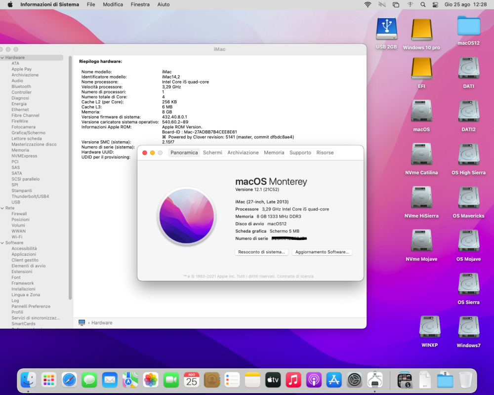

Slice Posted September 21, 2023 Share Posted September 21, 2023 On 9/3/2023 at 11:14 AM, AlainTox714 said: I am wondering which bootloader are you using? See first picture: Clover 5141. Link to comment https://www.insanelymac.com/forum/topic/353024-weird-experiment-macos-monterey-on-hfs-drive-old-rig/#findComment-2811389 Share on other sites More sharing options...
