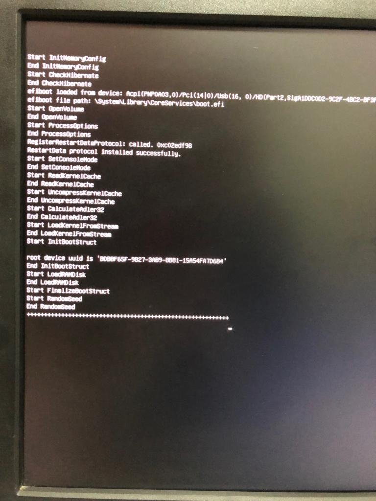

kisyu Posted October 28, 2018 Share Posted October 28, 2018 Hello, my setup is a bit different from yours: - Gigabyte z370N - i5-8600 - Samsung EVO 970 - G.Skill 16GB - wifi BCM94352Z followed your exact instructions but stuck at booting from USB drive. When I boot up, I choose USB disk and get the CBM and choose install MAC from USB. I see a white apple logo for about few seconds and then it just reboots. Enabled verbose boot log, please see attached - i can't figure out nothing from it. Link to comment Share on other sites More sharing options...

kisyu Posted October 29, 2018 Share Posted October 29, 2018 7 hours ago, TheMaxx32000 said: bios f5 settings @Luan Eduardo bios_set_f5 Have tried F5 (not the one you've supplied, original one) and F10 - cannot boot to OS. F1 is working, but the fan stops working after few minutes and system cpu gets ver hot!!! wtf??? any ideas? Link to comment Share on other sites More sharing options...

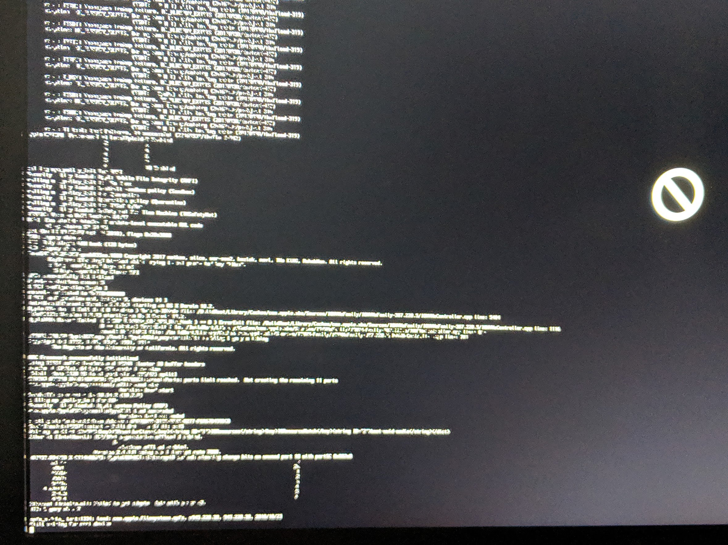

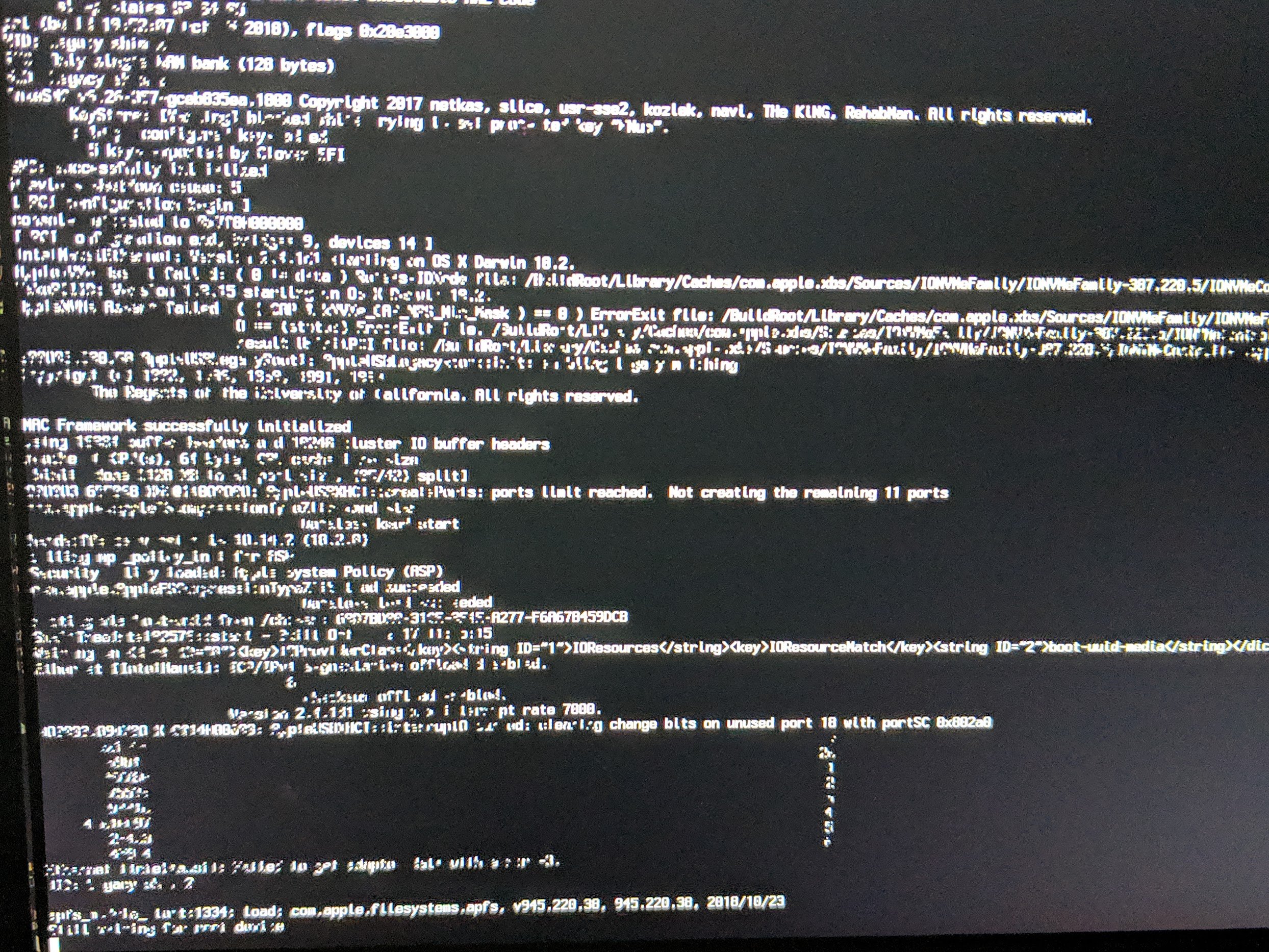

khamsakamal48 Posted November 7, 2018 Share Posted November 7, 2018 On 10/29/2018 at 12:04 AM, kisyu said: Hello, my setup is a bit different from yours: - Gigabyte z370N - i5-8600 - Samsung EVO 970 - G.Skill 16GB - wifi BCM94352Z followed your exact instructions but stuck at booting from USB drive. When I boot up, I choose USB disk and get the CBM and choose install MAC from USB. I see a white apple logo for about few seconds and then it just reboots. Enabled verbose boot log, please see attached - i can't figure out nothing from it. Hi, I had the exact same issue that you have after using for a few days. Even my macOS installer was stuck at ---End Randomseed----- too. I thought it was an issue with kexts or any files in driver64UEFI. I even spent 2 days blaming and resetting my BIOS, but I was wrong since the culprit was config.plist I made some changes in the config.plist file generated by Clover EFI Bootloader along with what was recommended in the OP. I don't remember the exact changes since I was just testing it out to make it work somehow. I even updated my BIOS to F10 & it works without any issue. Anyway, attaching my config.plist. Try replacing it with yours & if any luck it might just work. config.plist Link to comment Share on other sites More sharing options...

khamsakamal48 Posted November 8, 2018 Share Posted November 8, 2018 13 hours ago, registracii said: I'm getting this using this clover Seems like you are using USB 3.0 port during installation, are you? If so, try with a USB 2.0 port. Link to comment Share on other sites More sharing options...
STLVNUB Posted November 8, 2018 Share Posted November 8, 2018 Typical of what happens when you loose your USB 2 or 3. Trying different USB ports sometimes will sometimes kick it back to life, meaning some USB ports may still be working. You need to make a custom SSDT for your USB ports or customise USBInjectAll.kext Good luck Link to comment Share on other sites More sharing options...
registracii Posted November 8, 2018 Share Posted November 8, 2018 (edited) 12 hours ago, khamsakamal48 said: Seems like you are using USB 3.0 port during installation, are you? If so, try with a USB 2.0 port. 12 hours ago, STLVNUB said: Typical of what happens when you loose your USB 2 or 3. Trying different USB ports sometimes will sometimes kick it back to life, meaning some USB ports may still be working. You need to make a custom SSDT for your USB ports or customise USBInjectAll.kext Good luck Sorry I had to give more info. I have Mojave installed already. This is not installation, I'm just booting. There's no usb involved that's why I decided to share. Edited November 8, 2018 by registracii Link to comment Share on other sites More sharing options...
