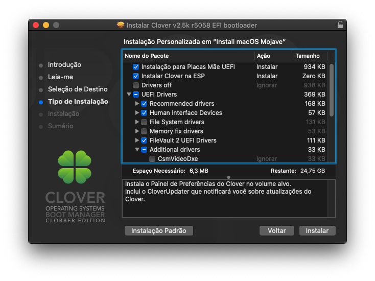

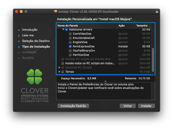

Install bootloader
Download the CloverEFI (used 5058, from Automated Clover Builds) and install with this options on "Install macOS Mojave":
- Install for UEFI booting only
- Install Clover in the ESP
- UEFI Drivers - Recommended drivers (check all)
- UEFI Drivers - Human Interface Devices (check all)
- UEFI Drivers - FileVault 2 UEFI Drivers (check all, If you are going to use FileVault)
- UEFI Drivers - Additional drivers - NvmExpressDxe (if you are going to use NVMe)
1642205338_CapturadeTela2019-09-01as12_33_22.png.502101fa5117822ad1673af0dee1b97e.png230650598_CapturadeTela2019-09-01as12_33_29.png.a2df01790d3c650a7a905d53b8a8dfa6.png

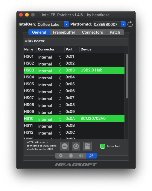

All USBs (2.0, 3.0, Type-C, internal)
KERNEL AND KEXT PATCHES Page - KextsToPatch
- Name*: com.apple.iokit.IOUSBHostFamily
- Find* [HEX]: 83FB0F0F
- Replace* [HEX]: 83FB3F0F
- Comment: USB Port Limit Patch 1 PMHeart/DalianSky
- MatchOS: 10.14.x
- Comment: USB Port Limit Patch 2 PMHeart/DalianSky
- MatchOS: 10.14.x
- Name*: com.apple.driver.usb.AppleUSBXHCI
- Comment: USB Port Limit Patch 3 PMHeart/DalianSky
- MatchOS: 10.14.x
- Find* [HEX]: 83FF0F0F
- Replace* [HEX]: 83FF3F0F
- Comment: USB Port Limit Patch 4 PMHeart/DalianSky
- MatchOS: 10.14.x
Need a Kext in the folder /EFI/CLOVER/kexts/Other/
Download the USBInjectAll.kext from here. I used the version 2018-1108.
Need SSDT patch in the folder /EFI/CLOVER/ACPI/patched/
- Download the SSDT-EC.aml, SSDT-UIAC.aml and SSDT-USBX attached bellow.

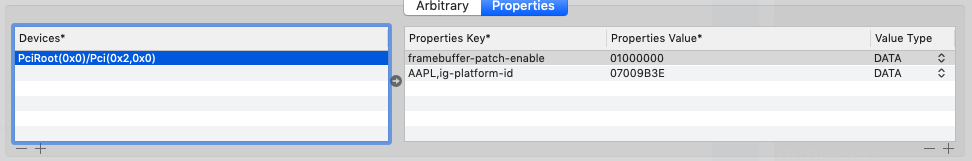

On 10/7/2018 at 12:16 AM, Luan Eduardo said:
config.plist (Clover Configurator):
- Uncheck: Acpi - Fixes - FixDisplay
- Uncheck: Acpi - Fixes - AddHDMI
- Add value: Devices - Properties - Devices*: PciRoot(0x0)/Pci(0x2,0x0)
- Add value: Devices - Properties - Devices* - PciRoot(0x0)/Pci(0x2,0x0):
                 Propertie Key: framebuffer-patch-enable
                 Propertie Value: 01000000
                 Propertie Key: AAPL,ig-platform-id
                 Propertie Value: 07009B3E
- Change value: Gui - Screen Resolution to 3840x2160 (Your screen resolution, mine is 4k)
- Change value: Rt Variables - CsrActiveConfig to 0x3
- Select value: SMBIOS - Up/Down arrows - iMac18,1 - Intel Core i5-7360U @ 2.30Ghz (I know, it's not our processor, but is that option)
 image.png.676dbf1a708a6ad758c50302db3f05fb.pngimage.png.fd3643539222aa3eb215ca414573215a.png

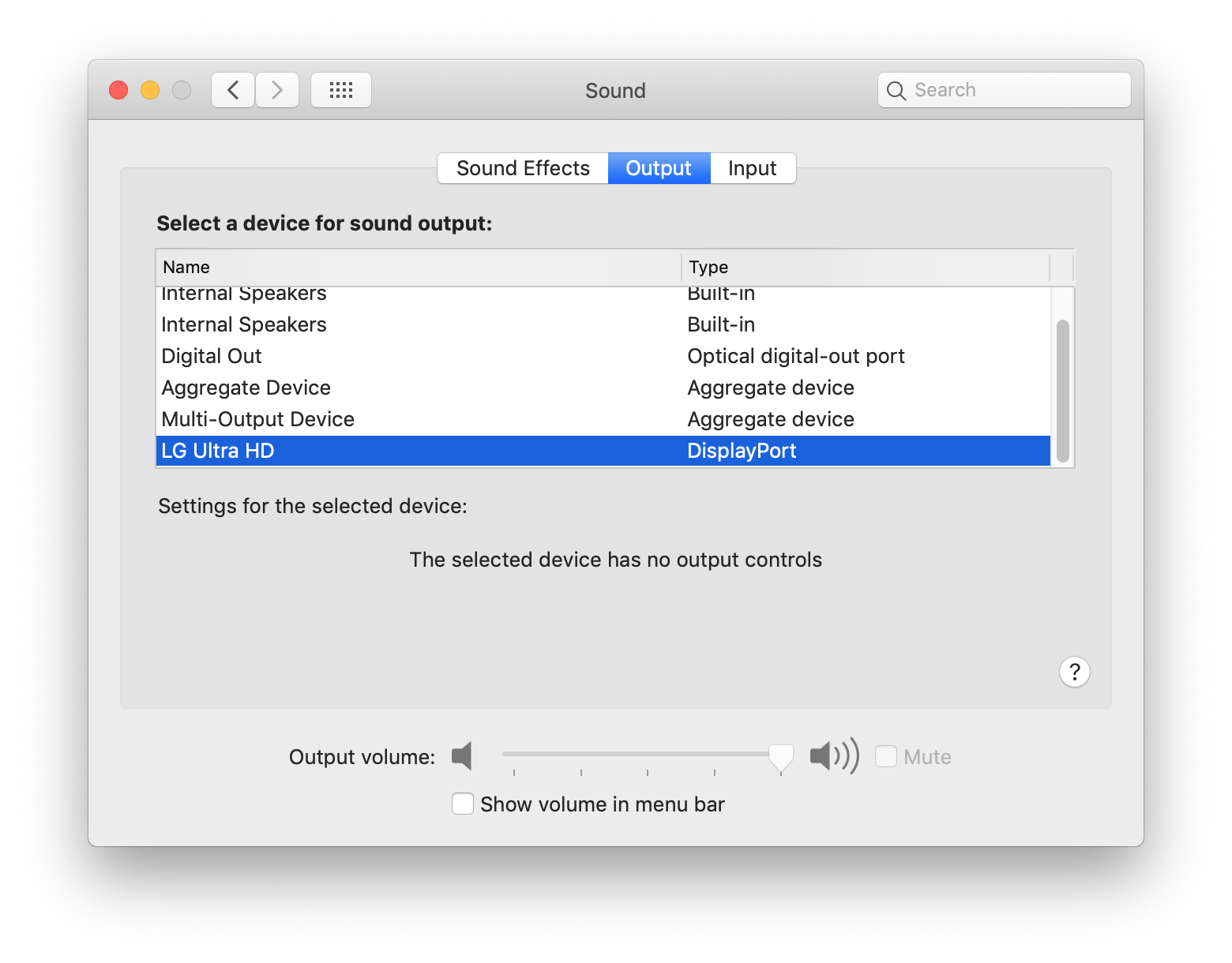

I have the same motherboard. So, this is what I did to make Audio Work:
In config.plist, Devices -> Audio -> Inject = 7
Reboot, and you will have audio over HDMI. Didn't test the actual audio ports.
Credits to Hackintosher forum.

Actually I don't use HDMI audio. I'm testing audio_CloverALC right now. The audio output works, but input not work because of layout-id = 2 that I'm using in place of layout-id 1 that Mojave drop it.

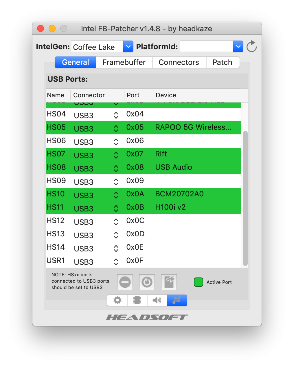

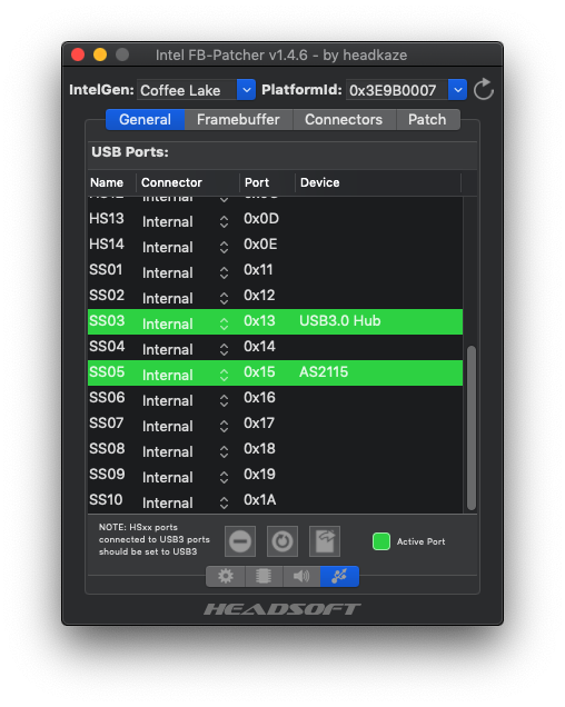

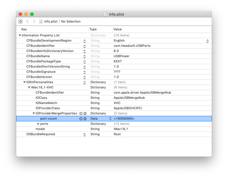

@NeedForSpeed73 Fixed it!
Followed this guide: Intel FB-Patcher v1.5.0
- Add USBInjextAll.kext to /EFI/CLOVER/Kexts/Other
- Add XHCI-300-series-injector.kext to /EFI/CLOVER/Kexts/Other
- Add Port Limit Patch (already patched in my guide)
- Restart
- Open Intel FB-Patcher
- Go to General > USB
- Insert and remove a USB 2.0 and USB 3.0 on each port
- All ports used becames Green
- Define alls connectors as USB3, except that used by the Bluetooth on Wifi Card must be Internal
- Select and delete others ports (not green)
- Click in Export
- Move the USBPorts.kext to /Library/Extensions
- Fix permissions and cache
- Remove USBInjectAll.kext, XHCI-300-series-injector.kext and Port Limit from Kernel and Kext Patches - KextsToPatch in config.plist
- Restart
In my case that my PC is on the bench and I don't have external ports, I have: HS03, HS04, HS05, HS06, HS07, HS08, HS10 (Internal Bluetooth), SS03, SS04, SS05, SS06, SS07, SS08.
Although I followed the procedure to the letter, I had a problem. After reopening the Intel FB-Patcher to verify, only until port 0x15 was appearing with USBPorts.kext that was generated. I needed to open the Kext Info.plist file with Xcode.app and change the port-count tag from <15000000> to <18000000>. 0x18 was the highest port I identified (SS08). Maybe it's an Intel FP-Patcher bug. After that, all the doors recognized normally.
Edited by Luan Eduardo

Install bootloader
Download the CloverEFI (used 4674) and install with this options on "Install macOS Mojave":
- UEFI Drivers - ApfsDriverLoader-64
- UEFI Drivers - AptioMemoryFix64
image.png.72397ab3e9ce542c2a618510f55e7461.pngimage.png.172a42dffb293f26265a7e00826953dd.png

Full UHD630 Acceleration

@khamsakamal48 Using AppleALC with Lilu I was able to make the onboard audio and HDMI work perfectly. Even with the microphone. The layout-id = 7 worked that a beauty.
Guide updated.

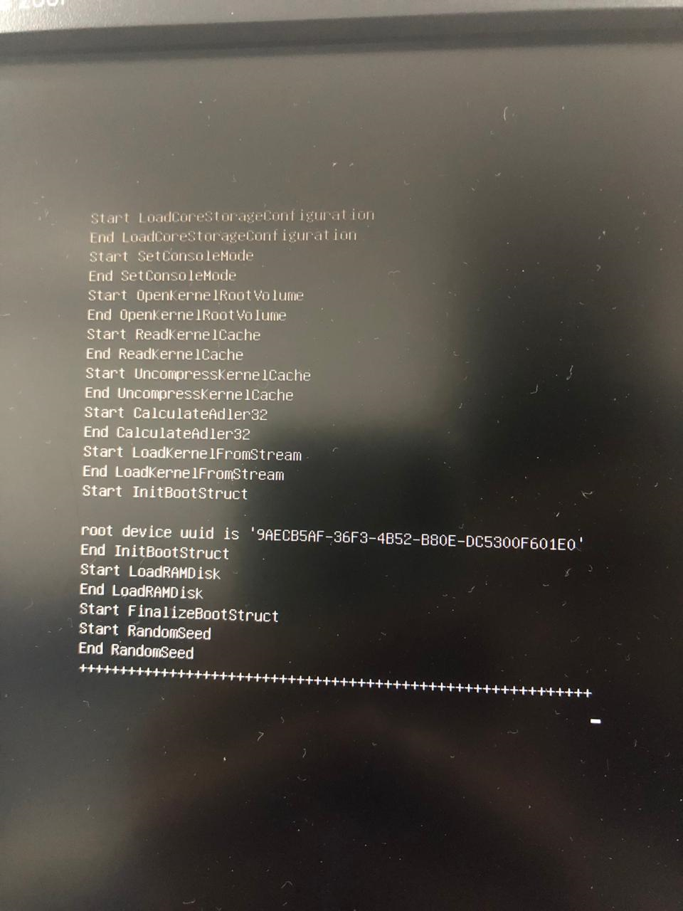

Mess is growing: I re-run the Mojave installer and now I have problems with graphics (stutters and very long boot time due to IGPU retrying many times to do something). I attach pics of the USB situation and config.plist. But don't struggle too much on it: next week I will change some hardware on this machine (new discrete videocard) so I guess I'll do a clean install of both Windows and OSX; this one has been upgraded at least two times (since Sierra or maybe even ElCap) and I guess it's full of garbage.
Thanks for your time.

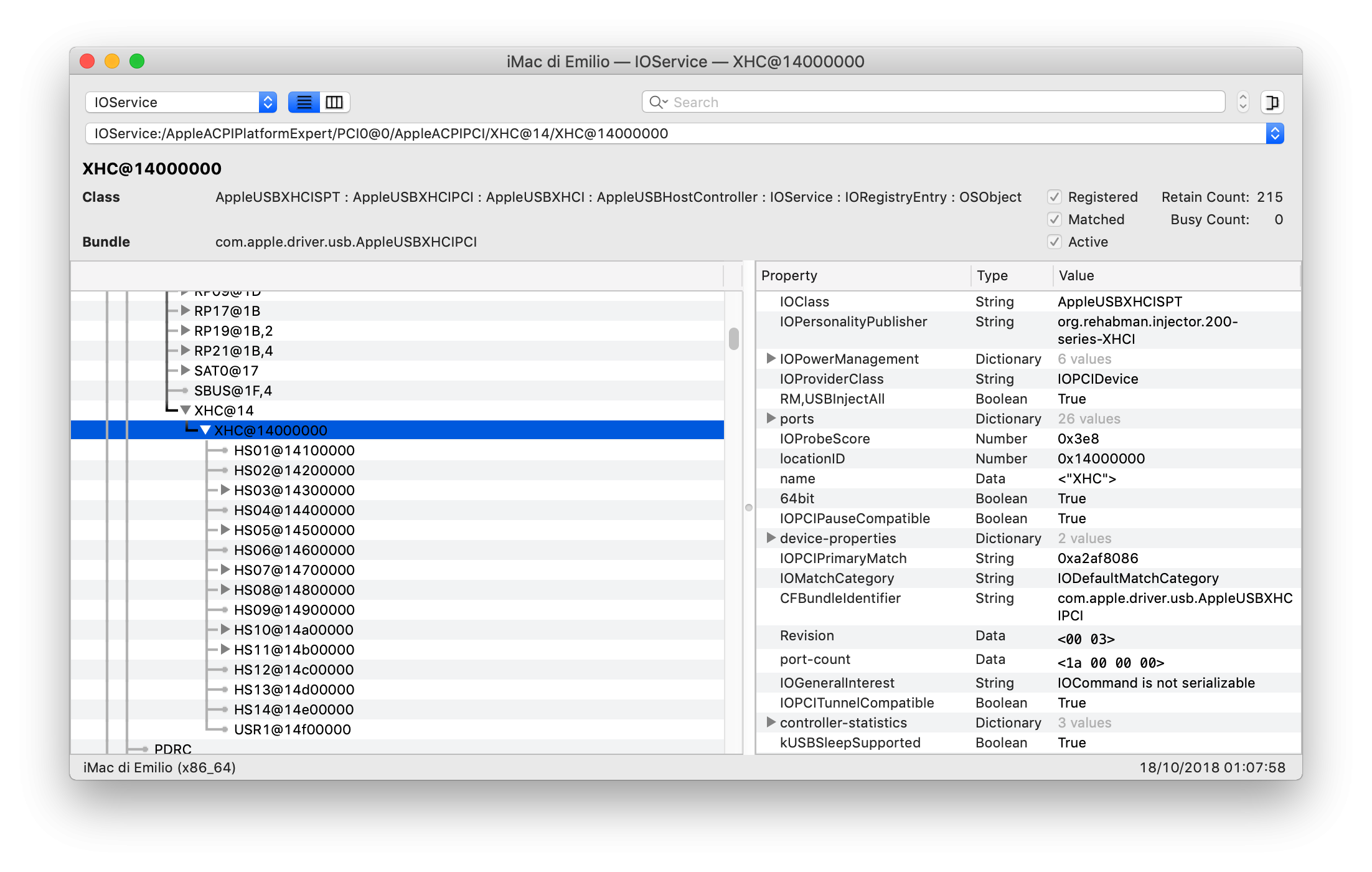

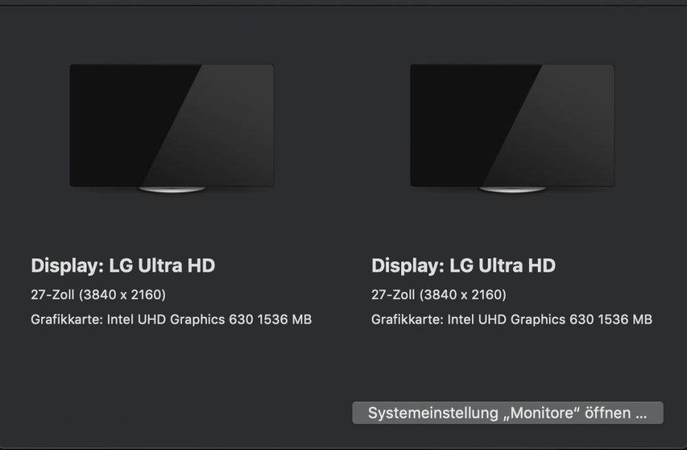

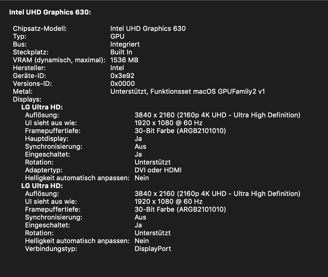

Hi @Luan Eduardo
please find my clover folder attached – I set up everything to use as little patching as possible.
DP and secondary eth work (needs modded FakePCIID_Intel_GbX.kext + SmallTreeIntel82576.kext) – running in dual-4k@60hz over here.
Also added ig-platform-id through ssdt-2 and some cosmetics (built-ins, device names etc).
Also all USB ports, including the front USB3.0 ones, work as expected.
Credits to @MaLd0n for the initial patched dsdt-version.
CLOVER.zip
screenshot_dual4k60.thumb.png.e892d2d45790e027af974ef00b7b3139.pngscreenshot_dual4k60-2.thumb.png.022d6070b57dee1a8801da2c47f1ce1a.png
Edited by TheMaxx32000

My system only boot with F1, tried F2, F3, F4, F5 and the new F10, and only the F1 works.
Tried all the three MemoryFix of Clover, tried with only one Ram module too...
Tried serveral UEFI options. IGFX and Discrete Card, CSM on and off, Secure Boot on and off, with everything don't work...
If boot with verbose, I stop in this:
If don't use verbose the system reboots in loop.
Share this post
Link to post

On 10/18/2018 at 11:25 AM, TheMaxx32000 said:
Hi @Luan Eduardo
It works.No second NIC
my setup is
i5-8600, 960evo, 32gb, F10
On DP I am experiencing some random flickers and video artefacts and the display "reboots" often (goes off and comes back up rapidly).
HDMI appears to be solid atm will test more.
edit:
Changing the DP cable fixed all the problems. Oddly enough the cable works with no problem on High Sierra.
Edited by registracii

Hi @Luan Eduardo (I'm BR too hehe). Thanks for your post. It helped me a lot.
I hope I can help you too. I used some configs from my High Sierra setup in the mojave one and I managed to make DP and its audio interface work. I didn't tested the 2nd eth interface since I use only wifi.
I have the exactly same build you have (i8700, z370n wifi, bcm BCM94352Z). I'ts very similar to yours except for some arbitrary device properties and some kexttopatch.
I hope it helps you https://www.dropbox.com/s/v4ao0vqdzvk078m/EFI.zip?dl=0
gave it a try. All works well DP audio also, however I lost the BT audio. Connects to the device can be selected volume works but no sound is routed there.
also About This Mac wont load...not a bother just
