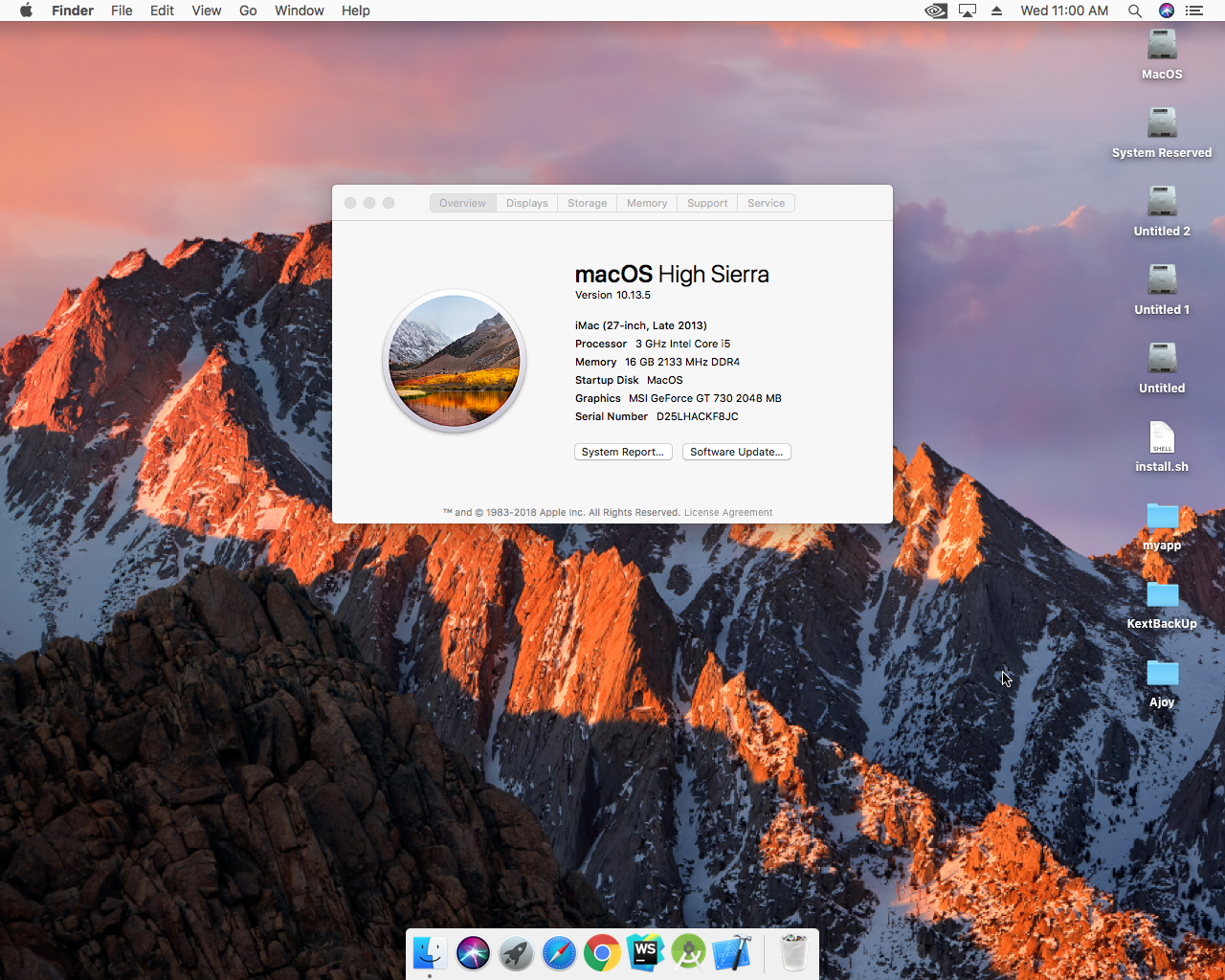

Ajoy karmakar Posted July 4, 2018 Author Share Posted July 4, 2018 (edited) I am able integrate nvidia using nvidia hdmi port. I have to add nvda_drv =0 and nv_disable=1. Now the graphics is horrible. I have already installed nvidia web driver and select graphics driver - nvidia web driver. And if I replace nvda_drv=1 and remove nvdisable then boot but stuck at black screen with a active cursor. Edited July 4, 2018 by Ajoy karmakar Link to comment https://www.insanelymac.com/forum/topic/334713-nvidia-ioconsoleusers-gioscreenlockstate-3-hs-0-bs-0-now-0-sm-0x0-error/page/4/#findComment-2624206 Share on other sites More sharing options...
Cyberdevs Posted July 4, 2018 Share Posted July 4, 2018 59 minutes ago, Ajoy karmakar said: I am able integrate nvidia using nvidia hdmi port. I have to add nvda_drv =0 and nv_disable=1. Now the graphics is horrible. I have already installed nvidia web driver and select graphics driver - nvidia web driver. And if I replace nvda_drv=1 and remove nvdisable then boot but stuck at black screen with a active cursor. nv_disable=1 simply disables the nVidia GPUs drivers being loaded by macOS but with nvda_drv=1 (which I think is deprecated) they get loaded, have you tried adding NvidiaWeb in config.plist under the System Parameters? Link to comment https://www.insanelymac.com/forum/topic/334713-nvidia-ioconsoleusers-gioscreenlockstate-3-hs-0-bs-0-now-0-sm-0x0-error/page/4/#findComment-2624218 Share on other sites More sharing options...
Ajoy karmakar Posted July 4, 2018 Author Share Posted July 4, 2018 5 minutes ago, Cyberdevs said: have you tried adding NvidiaWeb in config.plist under the System Parameters? Yesss Link to comment https://www.insanelymac.com/forum/topic/334713-nvidia-ioconsoleusers-gioscreenlockstate-3-hs-0-bs-0-now-0-sm-0x0-error/page/4/#findComment-2624220 Share on other sites More sharing options...

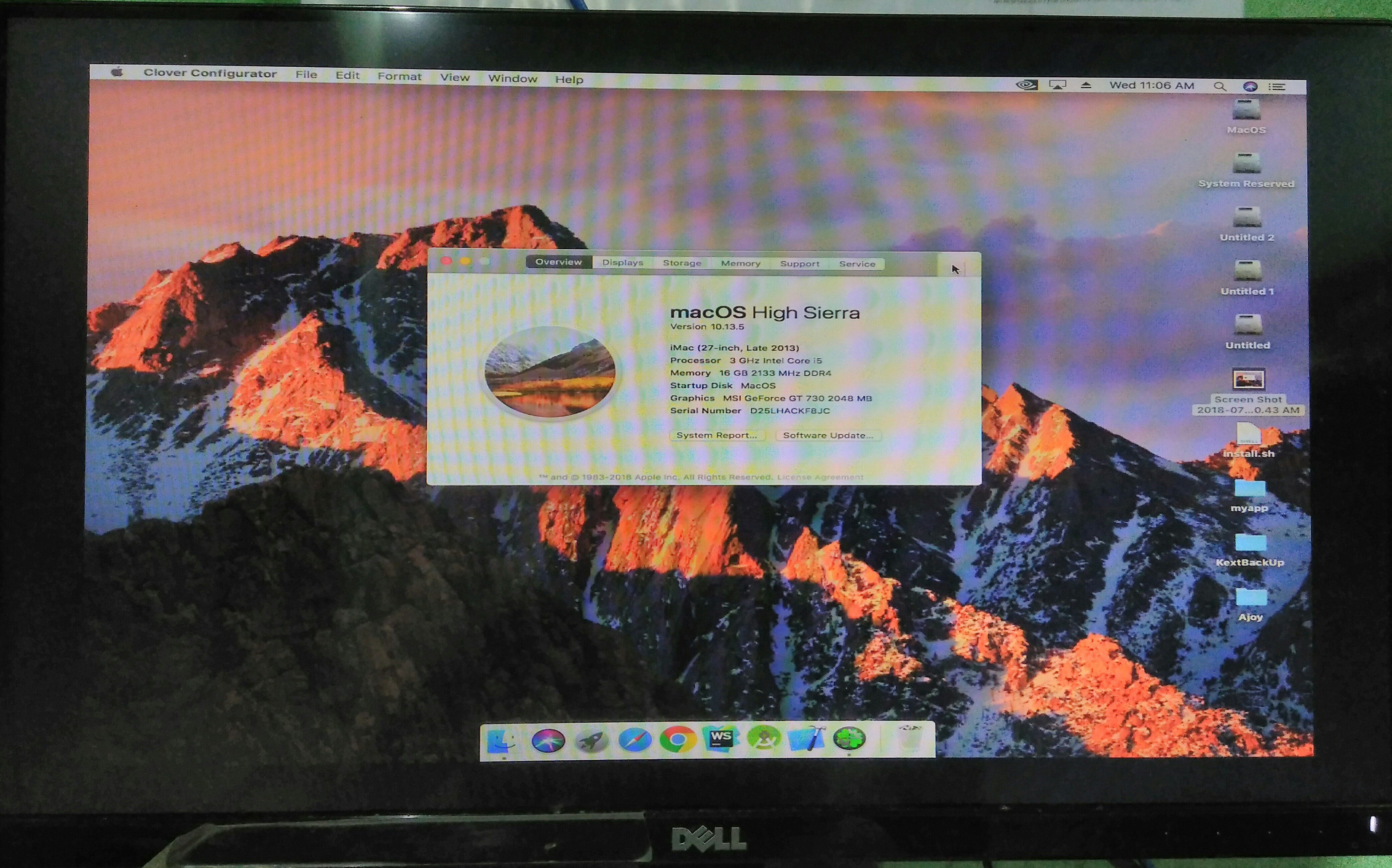

Ajoy karmakar Posted July 7, 2018 Author Share Posted July 7, 2018 I have managed to fix the resolution of the screen and also bios screen. Just need to accelerate with Nvidia driver which can't boot with nvda_drv = 1 , Boot only with nv_disable =1 Link to comment https://www.insanelymac.com/forum/topic/334713-nvidia-ioconsoleusers-gioscreenlockstate-3-hs-0-bs-0-now-0-sm-0x0-error/page/4/#findComment-2624709 Share on other sites More sharing options...
Cyberdevs Posted July 7, 2018 Share Posted July 7, 2018 57 minutes ago, Ajoy karmakar said: I have managed to fix the resolution of the screen and also bios screen. Just need to accelerate with Nvidia driver which can't boot with nvda_drv = 1 , Boot only with nv_disable =1 Which OsxAptioFix driver are you using? If you are using OsxAptioFixDrv or OsxAptioFix2Drv you need to add the EmuVaraiableUEFI.efi to your config.plist as well. Link to comment https://www.insanelymac.com/forum/topic/334713-nvidia-ioconsoleusers-gioscreenlockstate-3-hs-0-bs-0-now-0-sm-0x0-error/page/4/#findComment-2624714 Share on other sites More sharing options...
angel___eyes Posted July 8, 2018 Share Posted July 8, 2018 try nvidia single=true along with inject nvidia in clover config setting... worked for my for my 710 Link to comment https://www.insanelymac.com/forum/topic/334713-nvidia-ioconsoleusers-gioscreenlockstate-3-hs-0-bs-0-now-0-sm-0x0-error/page/4/#findComment-2624920 Share on other sites More sharing options...
Ajoy karmakar Posted August 1, 2018 Author Share Posted August 1, 2018 Hello angel__eyes can you describe the full method? How can you activate your nvidia graphics card? Link to comment https://www.insanelymac.com/forum/topic/334713-nvidia-ioconsoleusers-gioscreenlockstate-3-hs-0-bs-0-now-0-sm-0x0-error/page/4/#findComment-2628341 Share on other sites More sharing options...

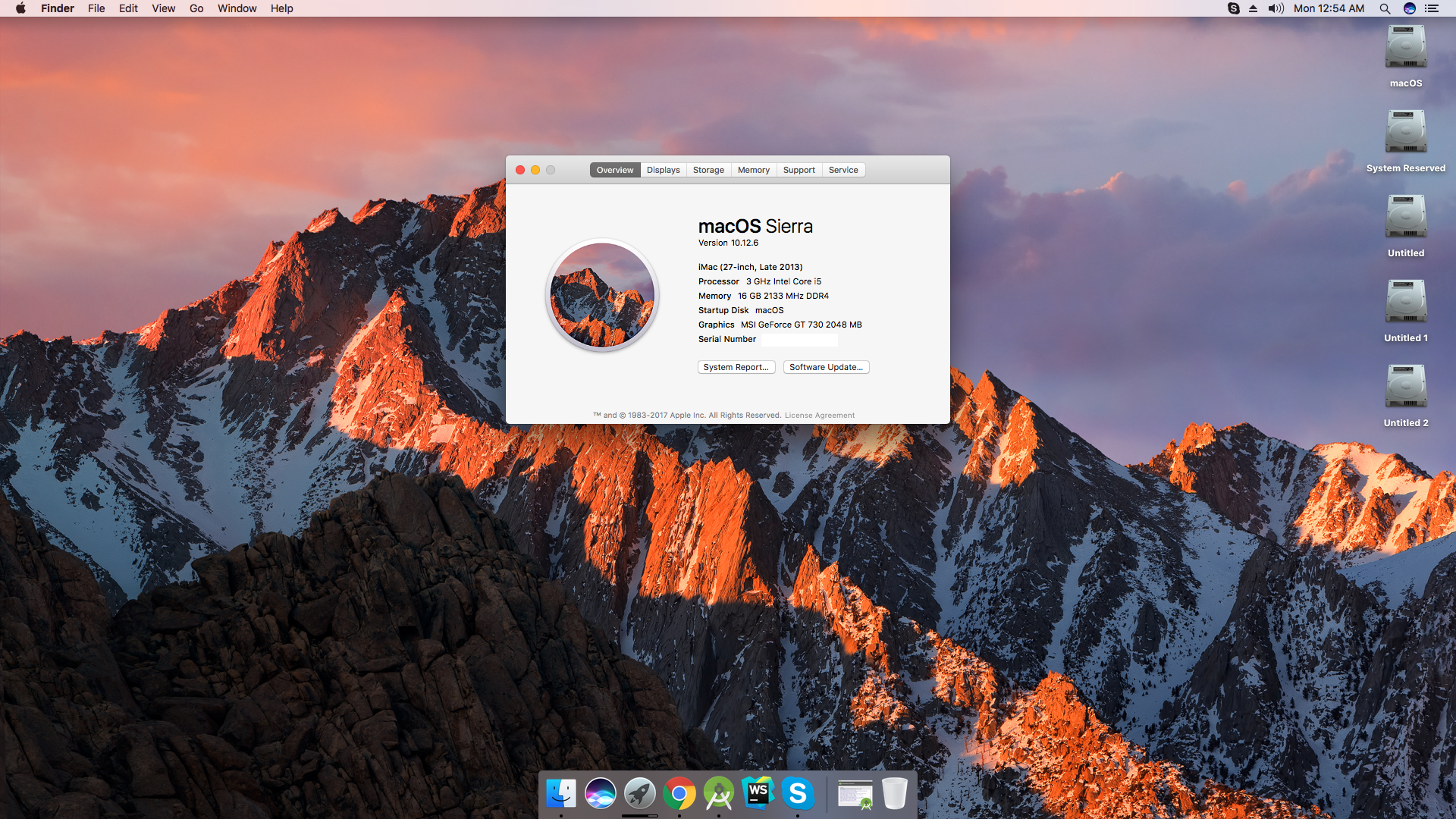

Ajoy karmakar Posted August 12, 2018 Author Share Posted August 12, 2018 (edited) Hello, Cyberdevs thanks for the support. insanelymac is the best forum for new bae hackintosher. i will recommend everyone Insanelymac. And I have succeeded to installed Sierra on my machine and it's working fine with this graphics cards. Just one thing to ask that can I adjust the brightness of the screen? Edited August 12, 2018 by Ajoy karmakar 1 Link to comment https://www.insanelymac.com/forum/topic/334713-nvidia-ioconsoleusers-gioscreenlockstate-3-hs-0-bs-0-now-0-sm-0x0-error/page/4/#findComment-2629838 Share on other sites More sharing options...
Cyberdevs Posted August 12, 2018 Share Posted August 12, 2018 (edited) 18 minutes ago, Ajoy karmakar said: Hello, Cyberdevs thanks for the support. insanelymac is the best forum for new bae hackintosher. i will recommend everyone Insanelymac. And I have succeeded to installed Sierra on my machine and it's working fine with this graphics cards. Hello @Ajoy karmakar You're welcome I'm glad that your hack is up and running Edited August 12, 2018 by Cyberdevs 1 Link to comment https://www.insanelymac.com/forum/topic/334713-nvidia-ioconsoleusers-gioscreenlockstate-3-hs-0-bs-0-now-0-sm-0x0-error/page/4/#findComment-2629839 Share on other sites More sharing options...

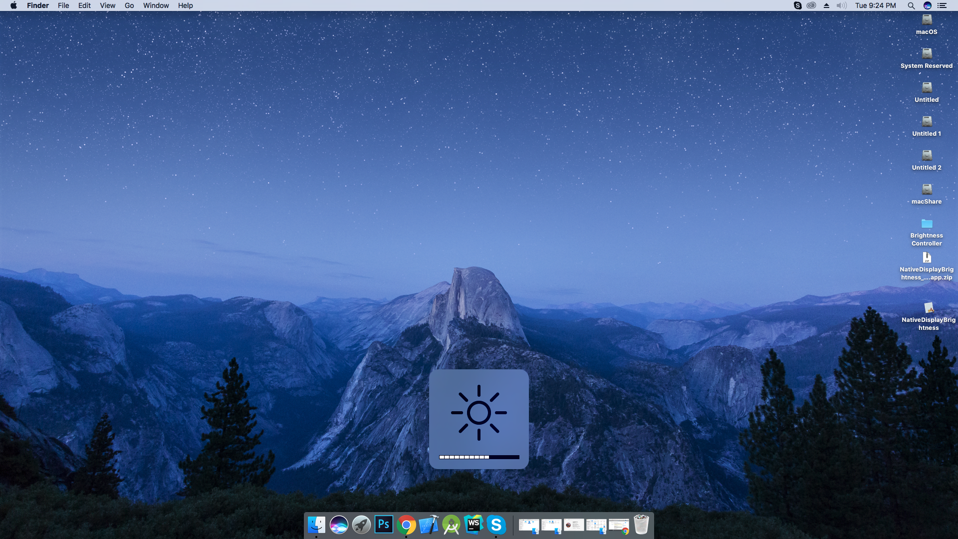

ajoykarmakar Posted August 13, 2018 Share Posted August 13, 2018 Hello @Cyberdevs, Can you please guide me on how to control the brightness of the screen? Some experts said that it's impossible to control on pc and I have remembered that you said that we can do but it's very tricky. Link to comment https://www.insanelymac.com/forum/topic/334713-nvidia-ioconsoleusers-gioscreenlockstate-3-hs-0-bs-0-now-0-sm-0x0-error/page/4/#findComment-2629887 Share on other sites More sharing options...
Cyberdevs Posted August 13, 2018 Share Posted August 13, 2018 1 hour ago, ajoykarmakar said: Hello @Cyberdevs, Can you please guide me on how to control the brightness of the screen? Some experts said that it's impossible to control on pc and I have remembered that you said that we can do but it's very tricky. Take a look at this post it might help you. I have to say that it didn't work on my rig anyways but the only working solution so far is described in this post: https://www.insanelymac.com/forum/topic/333876-brightness-not-working-on-wake-on-desktop-pc-locked-level-from-prior-to-sleep/?do=findComment&comment=2610430 1 Link to comment https://www.insanelymac.com/forum/topic/334713-nvidia-ioconsoleusers-gioscreenlockstate-3-hs-0-bs-0-now-0-sm-0x0-error/page/4/#findComment-2629894 Share on other sites More sharing options...
Ajoy karmakar Posted August 14, 2018 Author Share Posted August 14, 2018 One more time you provide a great support towards the issue, love it. 1 Link to comment https://www.insanelymac.com/forum/topic/334713-nvidia-ioconsoleusers-gioscreenlockstate-3-hs-0-bs-0-now-0-sm-0x0-error/page/4/#findComment-2630080 Share on other sites More sharing options...

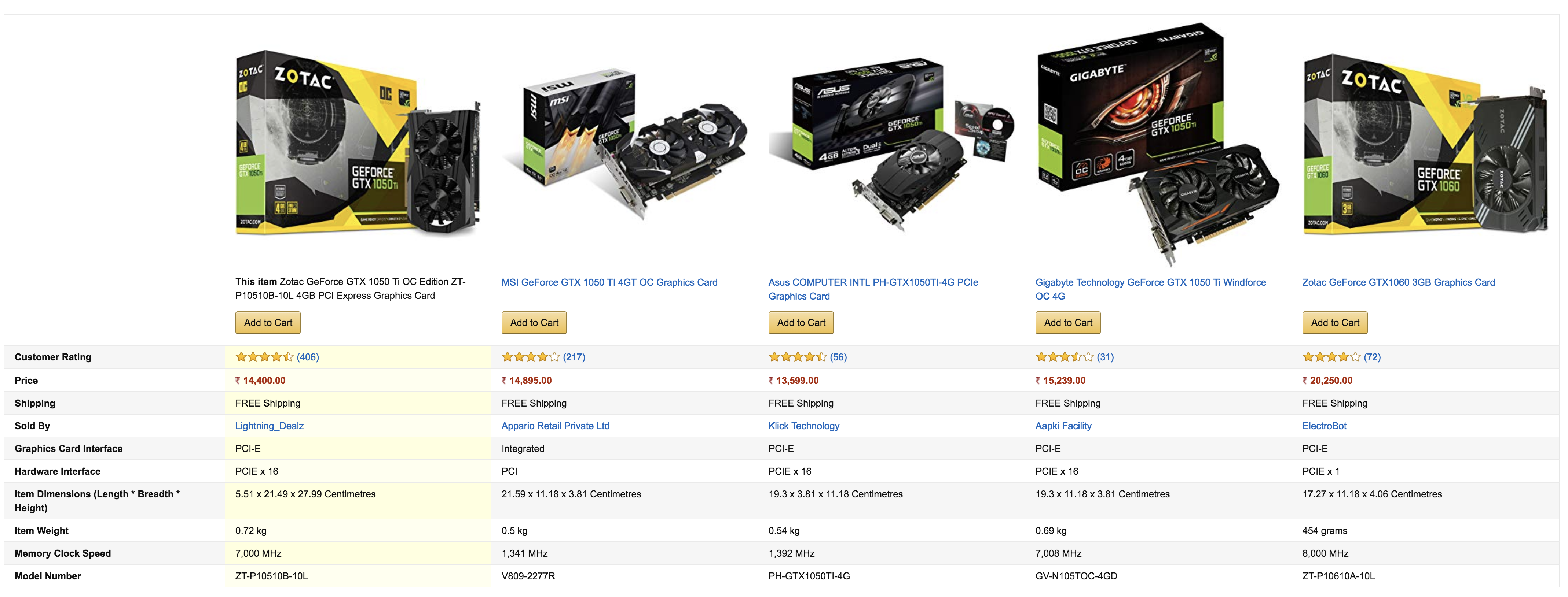

ajoykarmakar Posted September 8, 2018 Share Posted September 8, 2018 Hello @Cyberdevs, I am thinking about to upgrade my graphics card. So I can build my .ipa to the latest version of iOS supported. So should I buy this graphics card or can you suggest the best graphics card that best suit my system and even play the latest games with that? Name - Zotac GeForce GTX 1050 Ti OC Edition ZT-P10510B-10L 4GB PCI Express Graphics Card Link to comment https://www.insanelymac.com/forum/topic/334713-nvidia-ioconsoleusers-gioscreenlockstate-3-hs-0-bs-0-now-0-sm-0x0-error/page/4/#findComment-2633845 Share on other sites More sharing options...
Cyberdevs Posted September 8, 2018 Share Posted September 8, 2018 28 minutes ago, ajoykarmakar said: Hello @Cyberdevs, I am thinking about to upgrade my graphics card. So I can build my .ipa to the latest version of iOS supported. So should I buy this graphics card or can you suggest the best graphics card that best suit my system and even play the latest games with that? Name - Zotac GeForce GTX 1050 Ti OC Edition ZT-P10510B-10L 4GB PCI Express Graphics Card Hi there, I personally suggest using AMD GPUs instead of nVidia if you want to buy a 1050 TI I recommend using RX 580 or Vega (Sapphire and PowerColor) which are the best choices. AMD has full and native support in macOS and there's no need to wait and install nVidia WebDrivers after each macOS update. But if you insist of using nVidia 1050 TI and 1060 TI are more reasonable in price rather than the 1070 or 1080. Link to comment https://www.insanelymac.com/forum/topic/334713-nvidia-ioconsoleusers-gioscreenlockstate-3-hs-0-bs-0-now-0-sm-0x0-error/page/4/#findComment-2633848 Share on other sites More sharing options...

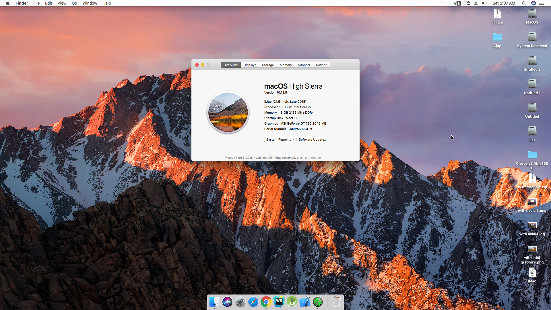

ajoykarmakar Posted October 6, 2018 Share Posted October 6, 2018 Hello, thank you for the reply but still, I didn't change the graphics card because Mac OS released a new version Mojave. Before upgrading I want to know is Mojave work with Nvidia gt730 4gb ddr3 128 bit graphics card? and one more thing after downloading the os from the apple store and after the upgrade, if I faced any problem can I reverse all the things like I have before upgrading the OS? I know only you can assist me with the best things as you already did in previous time. Link to comment https://www.insanelymac.com/forum/topic/334713-nvidia-ioconsoleusers-gioscreenlockstate-3-hs-0-bs-0-now-0-sm-0x0-error/page/4/#findComment-2639065 Share on other sites More sharing options...
Cyberdevs Posted October 6, 2018 Share Posted October 6, 2018 10 minutes ago, ajoykarmakar said: Hello, thank you for the reply but still, I didn't change the graphics card because Mac OS released a new version Mojave. Before upgrading I want to know is Mojave work with Nvidia gt730 4gb ddr3 128 bit graphics card? and one more thing after downloading the os from the apple store and after the upgrade, if I faced any problem can I reverse all the things like I have before upgrading the OS? I know only you can assist me with the best things as you already did in previous time. Hi there, how is it going? If your GPU needs thawed drivers DON'T update to Mojave until nVidia releases the new web drivers because they haven't release them for macOS Mojave. To answer your second question, the EFI folder (a working EFI folder) is all you need, if you make backups and keep it updated you can use it to install, re-install, upgrade, downgrade to any version of macOS that you like as long as your hardware is supported by macOS. Link to comment https://www.insanelymac.com/forum/topic/334713-nvidia-ioconsoleusers-gioscreenlockstate-3-hs-0-bs-0-now-0-sm-0x0-error/page/4/#findComment-2639069 Share on other sites More sharing options...
ajoykarmakar Posted October 6, 2018 Share Posted October 6, 2018 Hello, the mac is working fine in sierra version and now I don't need any web driver to run the graphics card still is it risky to upgrade the Mojave version? Actually, I didn't sure this graphics card is worked well or not in Mojave because in Sierra it's working absolutely fine but in high Sierra, it's not working. Link to comment https://www.insanelymac.com/forum/topic/334713-nvidia-ioconsoleusers-gioscreenlockstate-3-hs-0-bs-0-now-0-sm-0x0-error/page/4/#findComment-2639082 Share on other sites More sharing options...
Cyberdevs Posted October 6, 2018 Share Posted October 6, 2018 3 hours ago, ajoykarmakar said: Hello, the mac is working fine in sierra version and now I don't need any web driver to run the graphics card still is it risky to upgrade the Mojave version? Actually, I didn't sure this graphics card is worked well or not in Mojave because in Sierra it's working absolutely fine but in high Sierra, it's not working. Yeah if you couldn't manage to get it to work on High Sierra it might not be easy to activate it on Mojave and besides Mojave has some new issues with systems GPU regarding the preview and quick look. look here: https://www.insanelymac.com/forum/topic/334881-how-to-fix-quick-look-and-preview-issues-in-mojave/ Link to comment https://www.insanelymac.com/forum/topic/334713-nvidia-ioconsoleusers-gioscreenlockstate-3-hs-0-bs-0-now-0-sm-0x0-error/page/4/#findComment-2639117 Share on other sites More sharing options...

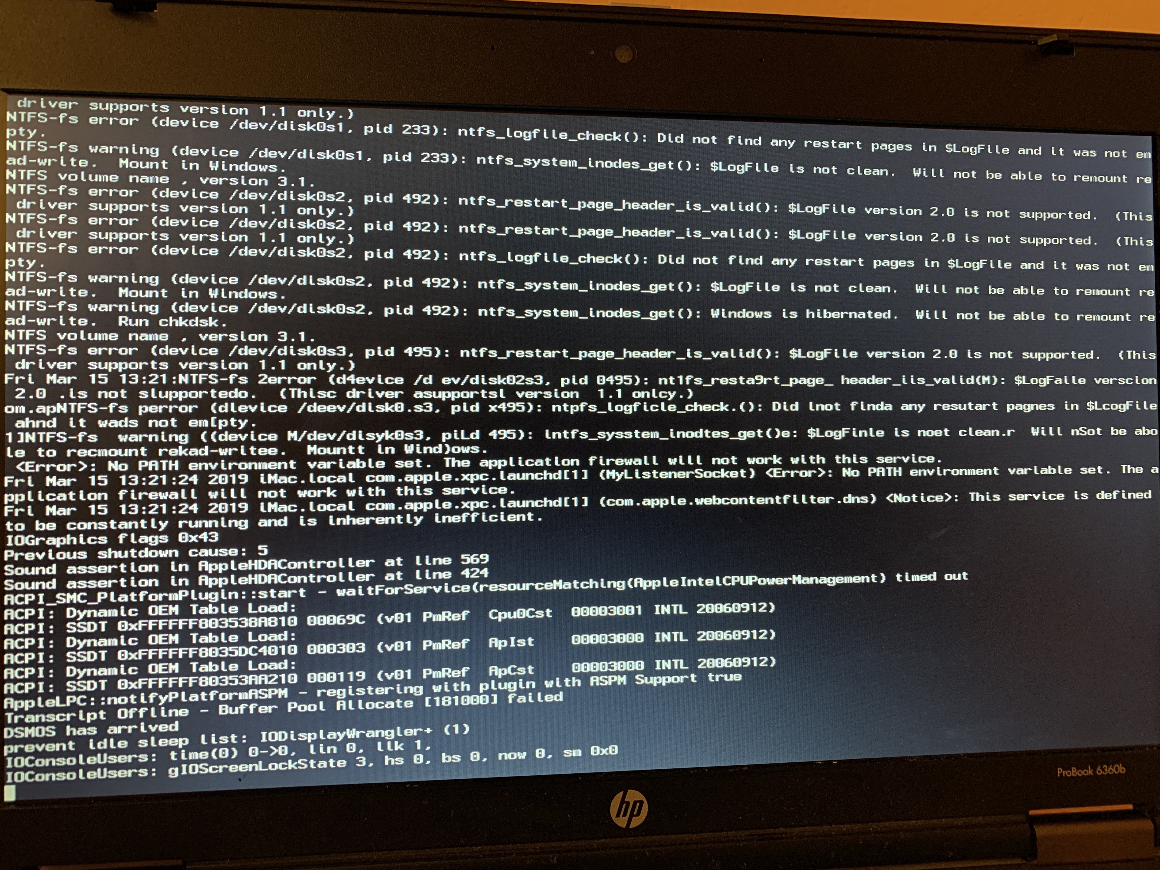

Ivan T Posted March 15, 2019 Share Posted March 15, 2019 (edited) I have the same issue on laptop up ProBook 6360b: Intel Core I5-2520M Intel HD 3000 trying to install Mac OS 10.12.6 Sierra Edited March 15, 2019 by Ivan T Link to comment https://www.insanelymac.com/forum/topic/334713-nvidia-ioconsoleusers-gioscreenlockstate-3-hs-0-bs-0-now-0-sm-0x0-error/page/4/#findComment-2667052 Share on other sites More sharing options...
