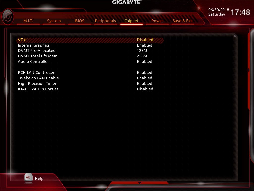

Cyberdevs Posted June 30, 2018 Share Posted June 30, 2018 If the Internal Graphics is set to enable you should have this feature as well. Just make sure that the Internal Graphics is set to enable not Auto. Set the DMVT Pre-Allocated to 128M DMVT Total Gfx Mem to 256 Use this folder instead. However I was successfully booted into macOS Installer on my system using the same config I posted earlier. EFI.zip Link to comment https://www.insanelymac.com/forum/topic/334713-nvidia-ioconsoleusers-gioscreenlockstate-3-hs-0-bs-0-now-0-sm-0x0-error/page/2/#findComment-2623431 Share on other sites More sharing options...
Cyberdevs Posted June 30, 2018 Share Posted June 30, 2018 9 minutes ago, Ajoy karmakar said: The default value is - Change them to the values I said in the previous post. Link to comment https://www.insanelymac.com/forum/topic/334713-nvidia-ioconsoleusers-gioscreenlockstate-3-hs-0-bs-0-now-0-sm-0x0-error/page/2/#findComment-2623435 Share on other sites More sharing options...

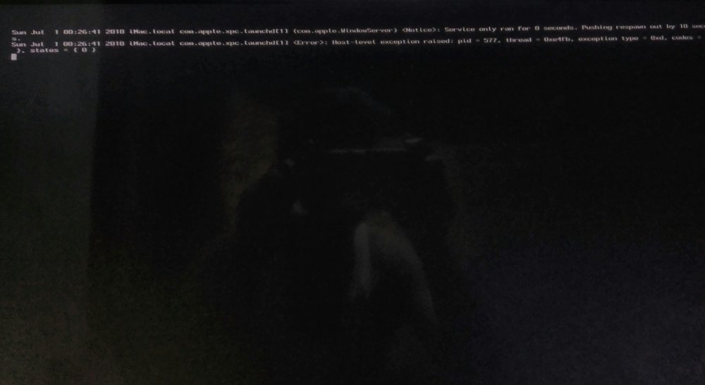

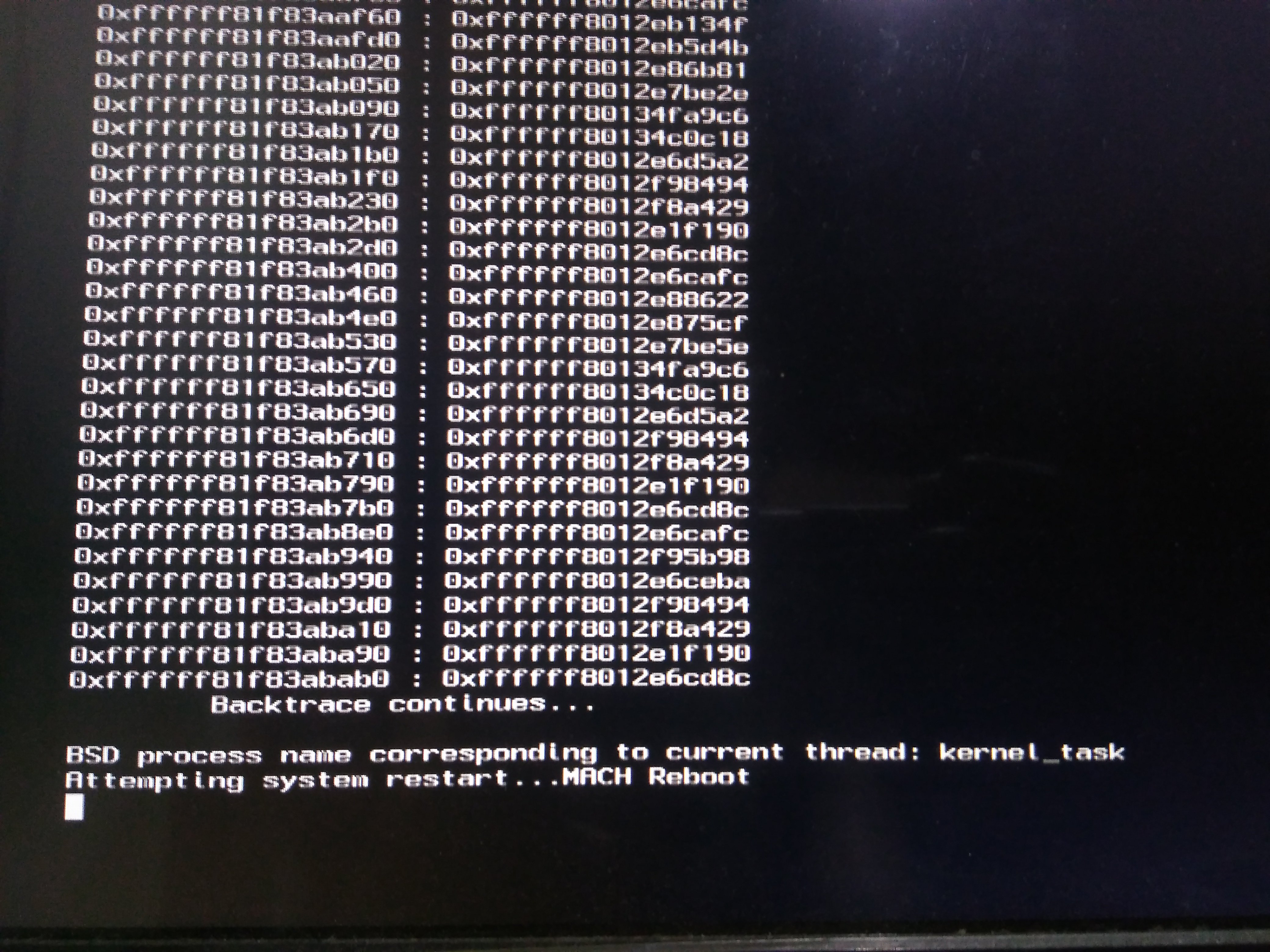

Ajoy karmakar Posted June 30, 2018 Author Share Posted June 30, 2018 Same attempting system restart....Mach reboot error....and I keep the internal graphic enable. Link to comment https://www.insanelymac.com/forum/topic/334713-nvidia-ioconsoleusers-gioscreenlockstate-3-hs-0-bs-0-now-0-sm-0x0-error/page/2/#findComment-2623437 Share on other sites More sharing options...
Cyberdevs Posted June 30, 2018 Share Posted June 30, 2018 Just now, Ajoy karmakar said: Same attempting system restart....Mach reboot error....and I keep the internal graphic enable. Did you use this attachment https://www.insanelymac.com/forum/topic/334713-nvidia-ioconsoleusers-gioscreenlockstate-3-hs-0-bs-0-now-0-sm-0x0-error/?do=findComment&comment=2623431 I attached another folder to the bottom of the post?! Link to comment https://www.insanelymac.com/forum/topic/334713-nvidia-ioconsoleusers-gioscreenlockstate-3-hs-0-bs-0-now-0-sm-0x0-error/page/2/#findComment-2623438 Share on other sites More sharing options...
Ajoy karmakar Posted June 30, 2018 Author Share Posted June 30, 2018 Yes i pick the latest one folder. Link to comment https://www.insanelymac.com/forum/topic/334713-nvidia-ioconsoleusers-gioscreenlockstate-3-hs-0-bs-0-now-0-sm-0x0-error/page/2/#findComment-2623439 Share on other sites More sharing options...

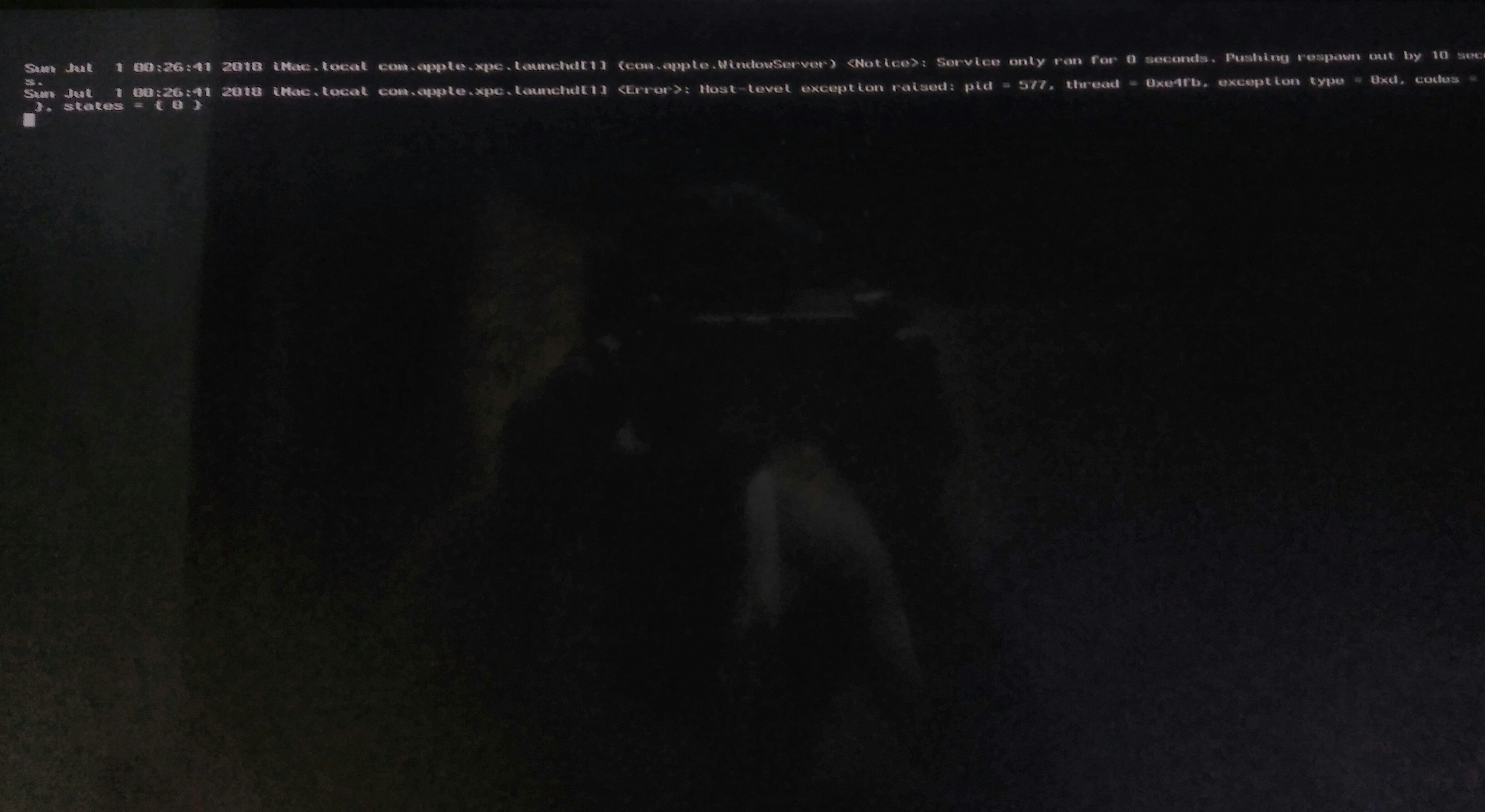

Cyberdevs Posted June 30, 2018 Share Posted June 30, 2018 This might help to get passed the MACH reboot error. just replace the config with this one config.plist.zip Link to comment https://www.insanelymac.com/forum/topic/334713-nvidia-ioconsoleusers-gioscreenlockstate-3-hs-0-bs-0-now-0-sm-0x0-error/page/2/#findComment-2623442 Share on other sites More sharing options...
Ajoy karmakar Posted June 30, 2018 Author Share Posted June 30, 2018 (edited) Same error. Edited June 30, 2018 by Ajoy karmakar Link to comment https://www.insanelymac.com/forum/topic/334713-nvidia-ioconsoleusers-gioscreenlockstate-3-hs-0-bs-0-now-0-sm-0x0-error/page/2/#findComment-2623443 Share on other sites More sharing options...
Cyberdevs Posted June 30, 2018 Share Posted June 30, 2018 Try this last one. I need to test these folders on an actual system with the similar specs as you have. Until then I can't be sure what could be the cause. In the mean while I suggest that you use the same folder that you have already used to install macOS High Sierra 10.13 in the first post and see if that still works. config.plist.zip you can also check this guide and see if the folders uploaded there can help you boot into macOS Installer. https://www.insanelymac.com/forum/topic/322004-guide-sierra-high-sierra-on-gigabyte-ga h110m-s2-dsdt/?tab=comments#comment-2387063 Link to comment https://www.insanelymac.com/forum/topic/334713-nvidia-ioconsoleusers-gioscreenlockstate-3-hs-0-bs-0-now-0-sm-0x0-error/page/2/#findComment-2623444 Share on other sites More sharing options...

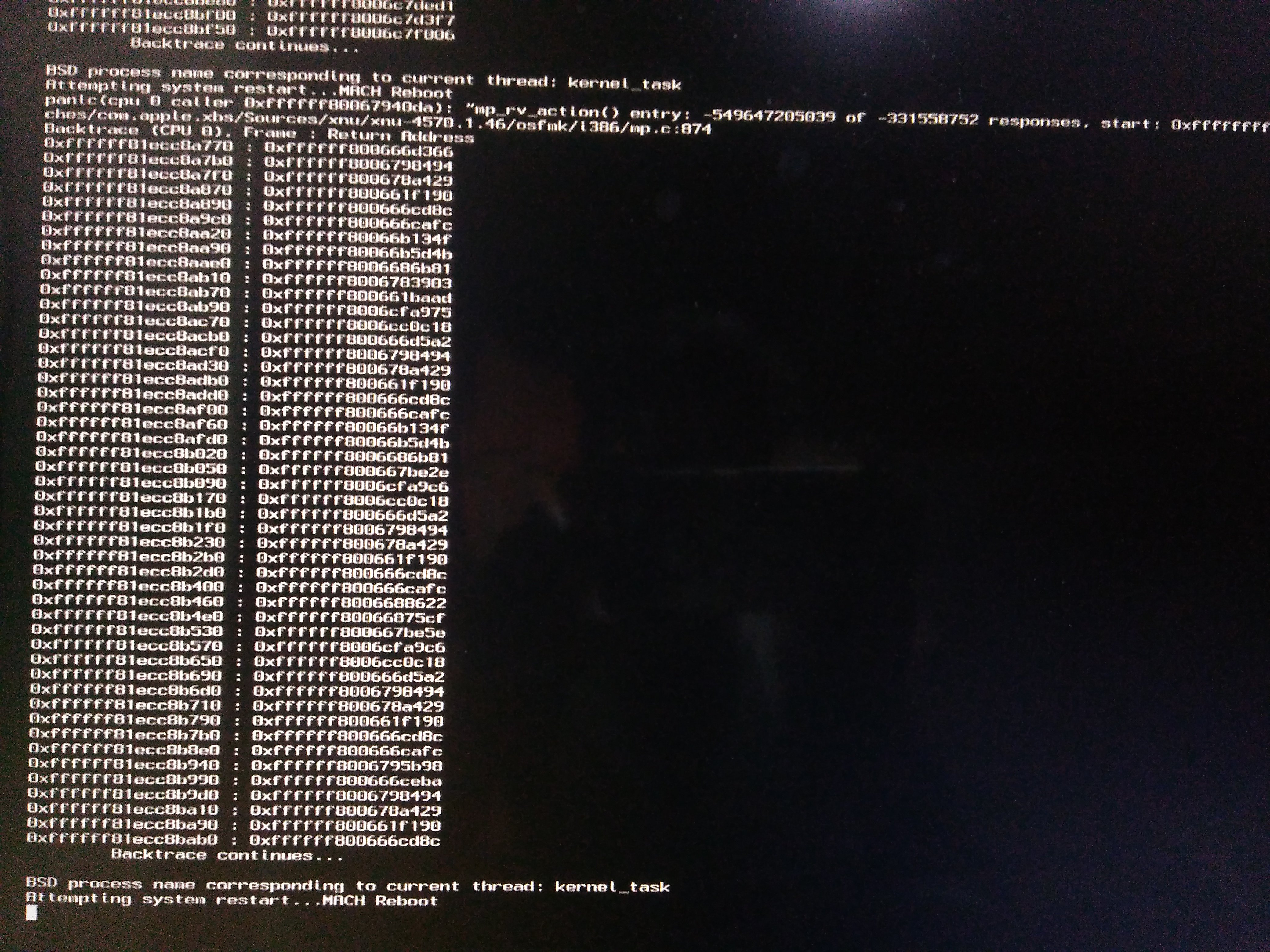

Ajoy karmakar Posted June 30, 2018 Author Share Posted June 30, 2018 I have use this config file and something changed..means the error is gone but now we have new error. 11 minutes ago, Cyberdevs said: Try this last one. I need to test these folders on an actual system with the similar specs as you have. Until then I can't be sure what could be the cause. In the mean while I suggest that you use the same folder that you have already used to install macOS High Sierra 10.13 in the first post and see if that still works. config.plist.zip you can also check this guide and see if the folders uploaded there can help you boot into macOS Installer. https://www.insanelymac.com/forum/topic/322004-guide-sierra-high-sierra-on-gigabyte-ga h110m-s2-dsdt/?tab=comments#comment-2387063 Link to comment https://www.insanelymac.com/forum/topic/334713-nvidia-ioconsoleusers-gioscreenlockstate-3-hs-0-bs-0-now-0-sm-0x0-error/page/2/#findComment-2623448 Share on other sites More sharing options...
Cyberdevs Posted June 30, 2018 Share Posted June 30, 2018 1 minute ago, Ajoy karmakar said: I have use this config file and something changed..means the error is gone but now we have new error. config-5.plist.zip Link to comment https://www.insanelymac.com/forum/topic/334713-nvidia-ioconsoleusers-gioscreenlockstate-3-hs-0-bs-0-now-0-sm-0x0-error/page/2/#findComment-2623449 Share on other sites More sharing options...
Ajoy karmakar Posted June 30, 2018 Author Share Posted June 30, 2018 Same error. Link to comment https://www.insanelymac.com/forum/topic/334713-nvidia-ioconsoleusers-gioscreenlockstate-3-hs-0-bs-0-now-0-sm-0x0-error/page/2/#findComment-2623452 Share on other sites More sharing options...
Cyberdevs Posted June 30, 2018 Share Posted June 30, 2018 (edited) 5 minutes ago, Ajoy karmakar said: Same error. Well I guess that's it unless I can test on a similar system it's just going to be an endless loop. Sorry man! you can change your bios settings to the way it was before and just disable the iGPU and test your previous working EFI folder and use the latest USB installer and try to boot into the installer only using your nVidia GPU. Check the link that I posted to the topic I gave you and see if you can find a working solution to your problem. Edited June 30, 2018 by Cyberdevs Link to comment https://www.insanelymac.com/forum/topic/334713-nvidia-ioconsoleusers-gioscreenlockstate-3-hs-0-bs-0-now-0-sm-0x0-error/page/2/#findComment-2623453 Share on other sites More sharing options...

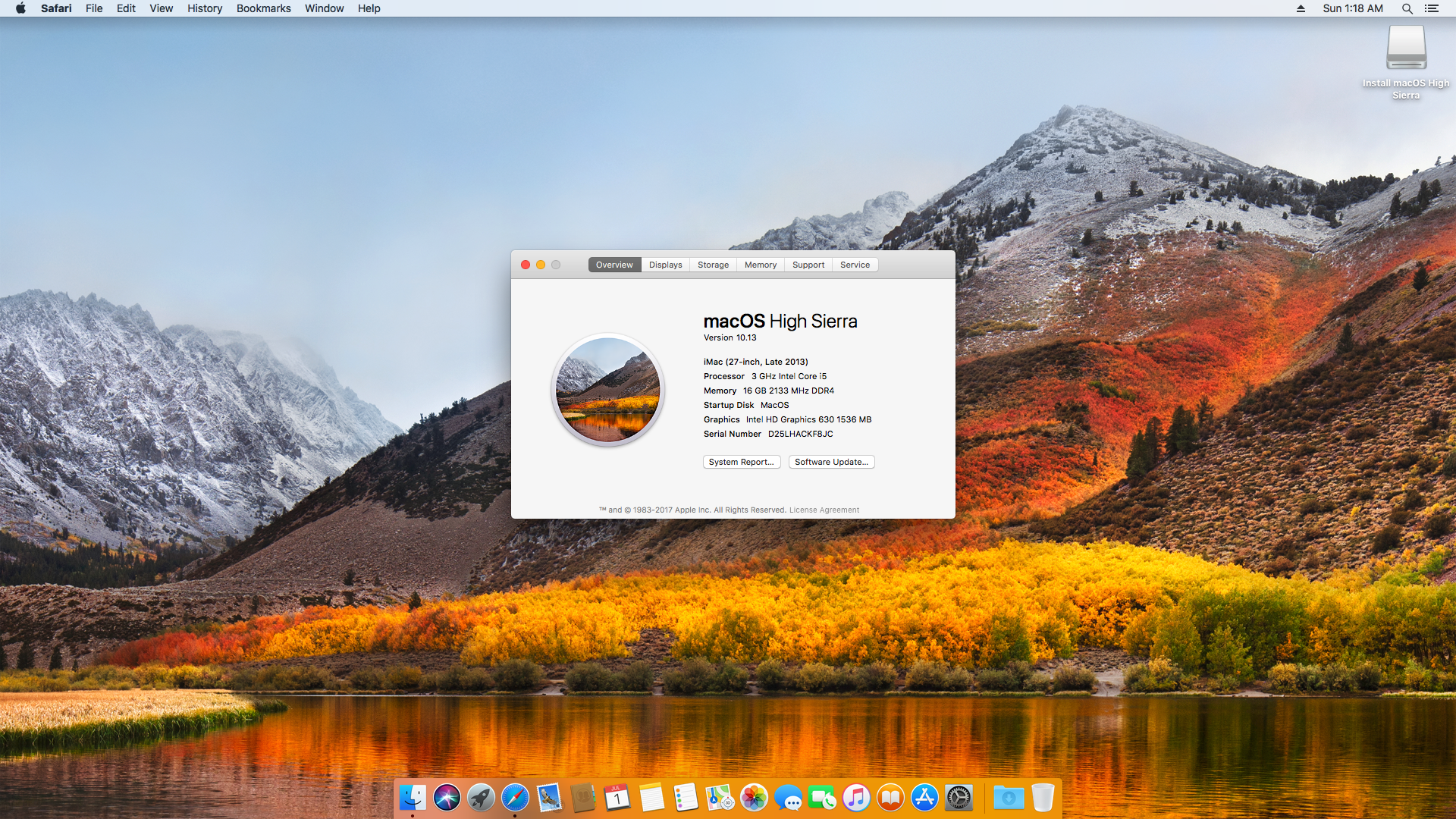

Ajoy karmakar Posted July 1, 2018 Author Share Posted July 1, 2018 (edited) OH..... I have a very good news that I have able to install 10.3 without any problem. I changed Initial display output - IGPU, and then the I have successfully boot into Mac OS. Now the situation is Mac OS currently used Intel graphics, so how can I used Nvidia graphics because in my 2nd hard disk I have install windows 10 and I played lots of game there.Now if the graphics card is disabled then can't play the games and one more question now If I get os update in App Store..can I install those update?..or it will crash everything? Edited July 1, 2018 by Ajoy karmakar 1 Link to comment https://www.insanelymac.com/forum/topic/334713-nvidia-ioconsoleusers-gioscreenlockstate-3-hs-0-bs-0-now-0-sm-0x0-error/page/2/#findComment-2623537 Share on other sites More sharing options...
Cyberdevs Posted July 1, 2018 Share Posted July 1, 2018 2 minutes ago, Ajoy karmakar said: OH..... I have a very good news that I have able to install 10.3 without any problem. I changed Initial display output - IGPU, and then the I have successfully boot into Mac OS. Now the situation is Mac OS currently used Intel graphics, so how can I used Nvidia graphics because in my 2nd hard disk I have install windows 10 and I played lots of game there.Now if the graphics card is disabled then can't play the games. Oh that's great news! Congrats! Which EFI folder did you finally use to boot into the installer and macOS itself? for nVidia web drivers look here: https://www.insanelymac.com/forum/topic/324195-nvidia-web-driver-updates-for-macos-high-sierra-update-06012018/ Link to comment https://www.insanelymac.com/forum/topic/334713-nvidia-ioconsoleusers-gioscreenlockstate-3-hs-0-bs-0-now-0-sm-0x0-error/page/2/#findComment-2623539 Share on other sites More sharing options...
Ajoy karmakar Posted July 1, 2018 Author Share Posted July 1, 2018 I have used first EFI folder that you advised to use and now after installing the Nvidia driver, I can change Initial display output - PCIe ? Link to comment https://www.insanelymac.com/forum/topic/334713-nvidia-ioconsoleusers-gioscreenlockstate-3-hs-0-bs-0-now-0-sm-0x0-error/page/2/#findComment-2623542 Share on other sites More sharing options...
Cyberdevs Posted July 1, 2018 Share Posted July 1, 2018 I think if you switch to PCIe it will result in the same situation unless you update your macOS to 10.13.5. I believe if you update to macOS 10.13.5 and switched the GPU afterwards you'll probably have a better change to boot successfully into macOS. Link to comment https://www.insanelymac.com/forum/topic/334713-nvidia-ioconsoleusers-gioscreenlockstate-3-hs-0-bs-0-now-0-sm-0x0-error/page/2/#findComment-2623543 Share on other sites More sharing options...
