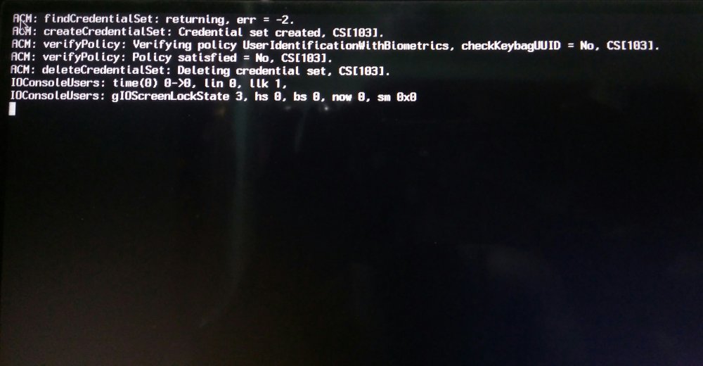

Ajoy karmakar Posted June 27, 2018 Share Posted June 27, 2018 I have successfully installed High Sierra (10.13) but when I want to boot from the installed hard drive, it's through an error. I checked others same thread on Insanelymac, Github, and Tonymacx86 but those won't work for me. Can anyone help me, please?My computer specification is - Motherboard: Gigabyte h110m-h-cf CPU: Intel Core i5-7400 CPU@3.00GHZ Graphics: 4gb GeForce GT730 DDR3 Ram - 16gb ddr4 Monitor - Dell connects through HDMI port. I have attached error screen and my EFI folder for better understanding the issue. EFI.zip Link to comment https://www.insanelymac.com/forum/topic/334713-nvidia-ioconsoleusers-gioscreenlockstate-3-hs-0-bs-0-now-0-sm-0x0-error/ Share on other sites More sharing options...
Cyberdevs Posted June 27, 2018 Share Posted June 27, 2018 You either need to use Lilu + nVidiaGraphicsFixup or simply add this patch the AGDP to avoid the black screen issue which I added to your config.plist config.plist.zip 5 hours ago, Ajoy karmakar said: I have successfully installed High Sierra (10.13) but when I want to boot from the installed hard drive, it's through an error. I checked others same thread on Insanelymac, Github, and Tonymacx86 but those won't work for me. Can anyone help me, please?My computer specification is - Motherboard: Gigabyte h110m-h-cf CPU: Intel Core i5-7400 CPU@3.00GHZ Graphics: 4gb GeForce GT730 DDR3 Ram - 16gb ddr4 Monitor - Dell connects through HDMI port. I have attached error screen and my EFI folder for better understanding the issue. EFI.zip Link to comment https://www.insanelymac.com/forum/topic/334713-nvidia-ioconsoleusers-gioscreenlockstate-3-hs-0-bs-0-now-0-sm-0x0-error/#findComment-2622683 Share on other sites More sharing options...
Ajoy karmakar Posted June 28, 2018 Author Share Posted June 28, 2018 Thanks for replying. I have placed the config.plist file in the EFI folder which you have modified but no luck same issue. Now what should I do? Link to comment https://www.insanelymac.com/forum/topic/334713-nvidia-ioconsoleusers-gioscreenlockstate-3-hs-0-bs-0-now-0-sm-0x0-error/#findComment-2622800 Share on other sites More sharing options...
Cyberdevs Posted June 28, 2018 Share Posted June 28, 2018 9 minutes ago, Ajoy karmakar said: Thanks for replying. I have placed the config.plist file in the EFI folder which you have modified but no luck same issue. Now what should I do? Try this folder EFI.zip Link to comment https://www.insanelymac.com/forum/topic/334713-nvidia-ioconsoleusers-gioscreenlockstate-3-hs-0-bs-0-now-0-sm-0x0-error/#findComment-2622807 Share on other sites More sharing options...

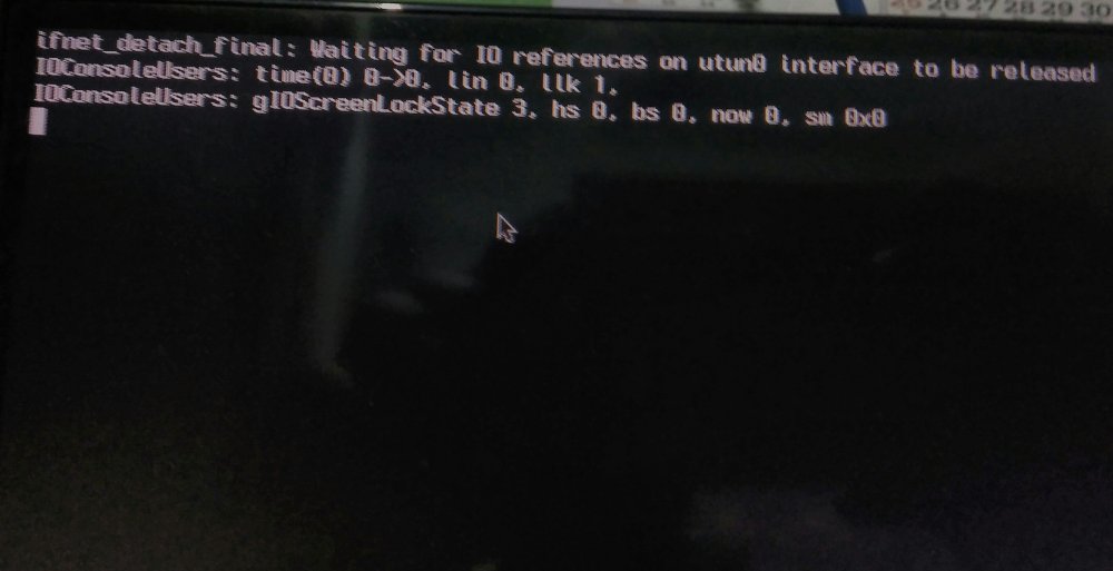

Ajoy karmakar Posted June 28, 2018 Author Share Posted June 28, 2018 (edited) Hi, First try - disable the internal graphics and try to boot but it restarts the system. The bootloader graphics is a little bit awkward from the beginning I mean the bootloader is not showing in full resolution, put gap around the edge, I think the total issue begin with that. I am attaching a picture you can understand and one thing I feel very bad to bother you in this way but I think only you can help me with this matter. Edited June 28, 2018 by Ajoy karmakar Link to comment https://www.insanelymac.com/forum/topic/334713-nvidia-ioconsoleusers-gioscreenlockstate-3-hs-0-bs-0-now-0-sm-0x0-error/#findComment-2622836 Share on other sites More sharing options...
Cyberdevs Posted June 29, 2018 Share Posted June 29, 2018 11 hours ago, Ajoy karmakar said: Hi, First try - disable the internal graphics and try to boot but it restarts the system. The bootloader graphics is a little bit awkward from the beginning I mean the bootloader is not showing in full resolution, put gap around the edge, I think the total issue begin with that. I am attaching a picture you can understand and one thing I feel very bad to bother you in this way but I think only you can help me with this matter. Hi there, Which port do you use on your GPU? DVI? HDMI? DP? The resolution in the clover GUI can be fixed don't worry about it just let teak one step at the time and solve one issue and then we will fix the next one did you succeed on booting into macOS with the last EFI folder I posted at all or you just get the same issue? Link to comment https://www.insanelymac.com/forum/topic/334713-nvidia-ioconsoleusers-gioscreenlockstate-3-hs-0-bs-0-now-0-sm-0x0-error/#findComment-2622957 Share on other sites More sharing options...

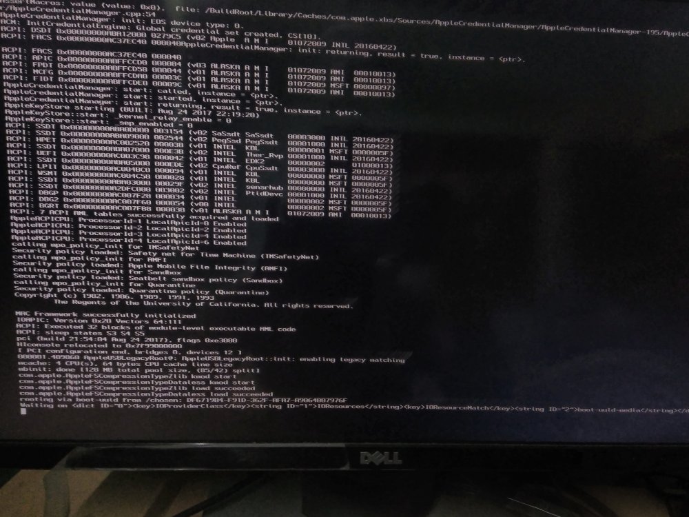

Ajoy karmakar Posted June 29, 2018 Author Share Posted June 29, 2018 Hello there, I have placed your 2nd modified efi and change internal graphics to enable and giolocakscreenstate error is gone but now in vast log after checking intel and nvidia graphics the system is restarting. Link to comment https://www.insanelymac.com/forum/topic/334713-nvidia-ioconsoleusers-gioscreenlockstate-3-hs-0-bs-0-now-0-sm-0x0-error/#findComment-2623071 Share on other sites More sharing options...
Cyberdevs Posted June 29, 2018 Share Posted June 29, 2018 2 minutes ago, Ajoy karmakar said: Hello there, I have placed your 2nd modified efi and change internal graphics to enable and giolocakscreenstate error is gone but now in vast log after checking intel and nvidia graphics the system is restarting. Hi there, I believe we encountered a new problem and it's some sort of a kernel panic. Try this. EFI 3.zip Link to comment https://www.insanelymac.com/forum/topic/334713-nvidia-ioconsoleusers-gioscreenlockstate-3-hs-0-bs-0-now-0-sm-0x0-error/#findComment-2623074 Share on other sites More sharing options...

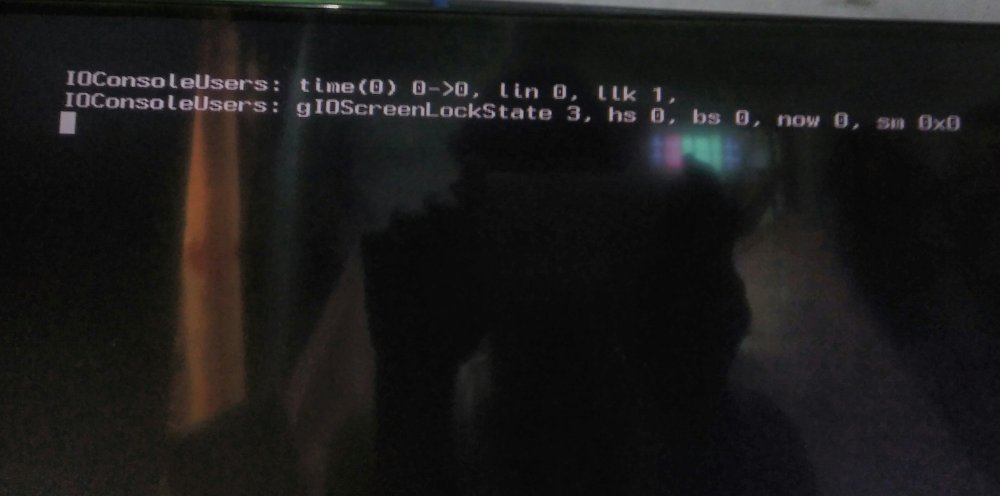

Ajoy karmakar Posted June 29, 2018 Author Share Posted June 29, 2018 Ok before trying new one I got a new log. In the bootloader graphic injector i check inject nvidia gt730 and check nvdra driver then encountered a new log with lockscreen state error. Screenshot - Link to comment https://www.insanelymac.com/forum/topic/334713-nvidia-ioconsoleusers-gioscreenlockstate-3-hs-0-bs-0-now-0-sm-0x0-error/#findComment-2623075 Share on other sites More sharing options...
Cyberdevs Posted June 29, 2018 Share Posted June 29, 2018 Can you do a clean install? or use a newer version of macOS High Sierra? Say 10.13.5? it has a better chance of detecting multiple GPUs I remember that with 10.13 and 10.13.1,2,3 I had a similar issue with using dual GPU setup. Link to comment https://www.insanelymac.com/forum/topic/334713-nvidia-ioconsoleusers-gioscreenlockstate-3-hs-0-bs-0-now-0-sm-0x0-error/#findComment-2623079 Share on other sites More sharing options...

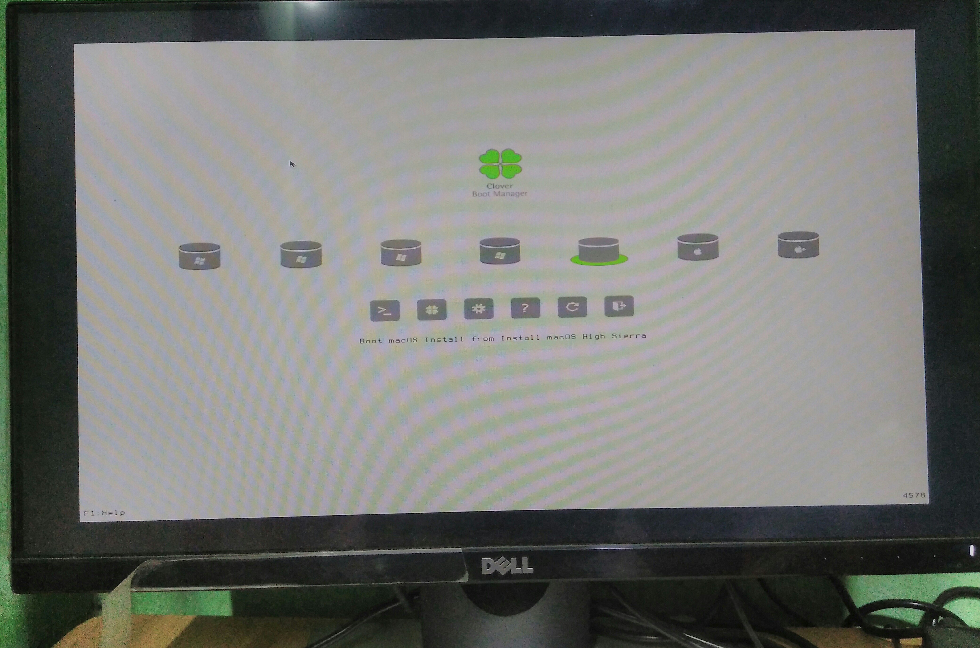

Ajoy karmakar Posted June 29, 2018 Author Share Posted June 29, 2018 Ok no problem to install the latest os. Can you suggest me where I can begin for the successful installation with this configuration? Link to comment https://www.insanelymac.com/forum/topic/334713-nvidia-ioconsoleusers-gioscreenlockstate-3-hs-0-bs-0-now-0-sm-0x0-error/#findComment-2623083 Share on other sites More sharing options...
Cyberdevs Posted June 29, 2018 Share Posted June 29, 2018 2 hours ago, Ajoy karmakar said: Ok no problem to install the latest os. Can you suggest me where I can begin for the successful installation with this configuration? The best source for getting a head start is this guide You can check it out and see if you can find what you are looking for. I did some optimization to your EFI folder which I hope you can use to boot into macOS installer. Test it and let me know. EFI.zip Link to comment https://www.insanelymac.com/forum/topic/334713-nvidia-ioconsoleusers-gioscreenlockstate-3-hs-0-bs-0-now-0-sm-0x0-error/#findComment-2623118 Share on other sites More sharing options...

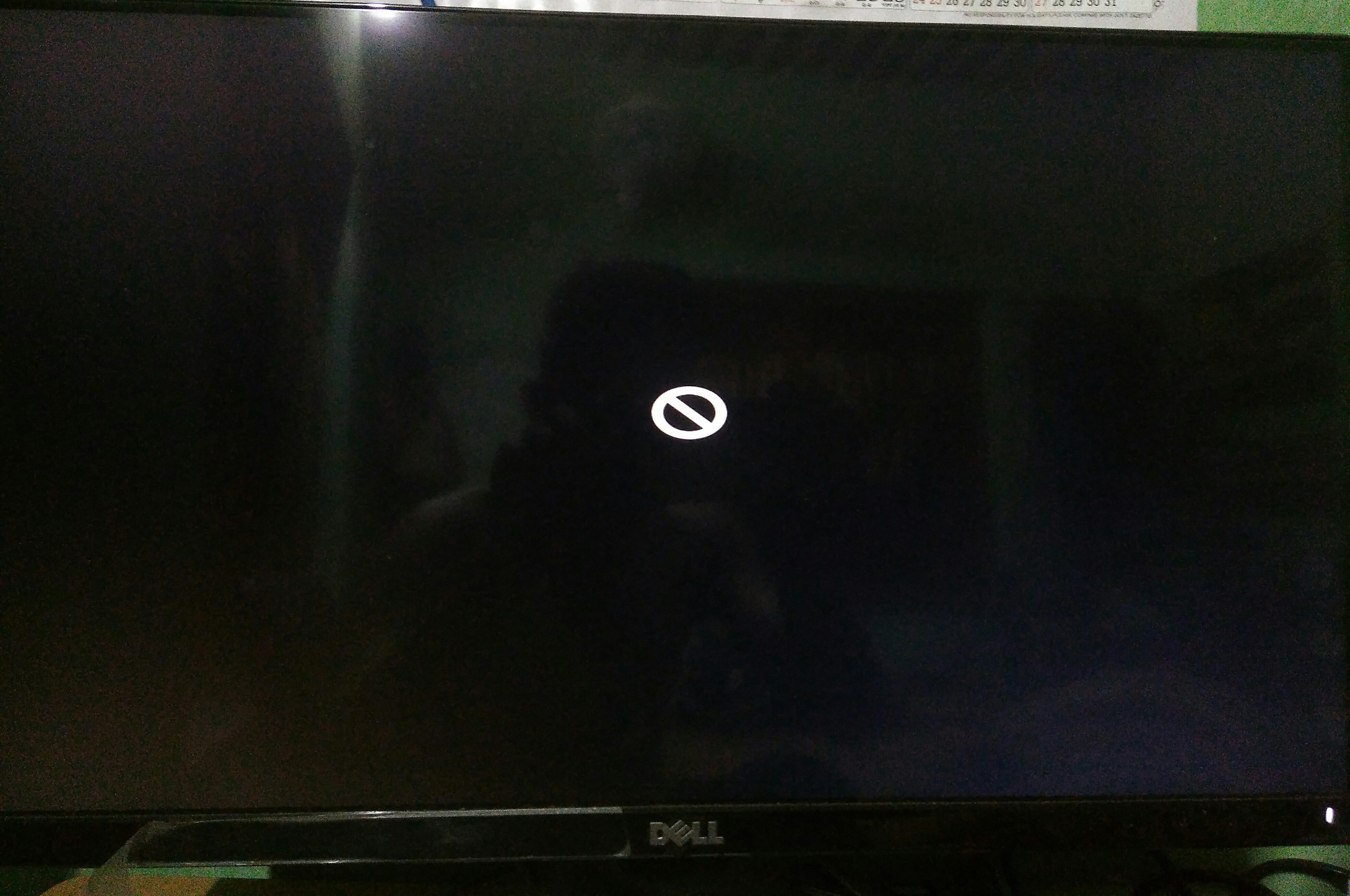

Ajoy karmakar Posted June 30, 2018 Author Share Posted June 30, 2018 Hello there, I have created a 10.13.5 usb installer. It's booting but after 50% progress...the screen is becoming black with a circle cross icon.I did google, some experts says it's cause of a usb3.0 . So i changed the port but it's doesn't work..what should I do now?.. Link to comment https://www.insanelymac.com/forum/topic/334713-nvidia-ioconsoleusers-gioscreenlockstate-3-hs-0-bs-0-now-0-sm-0x0-error/#findComment-2623385 Share on other sites More sharing options...

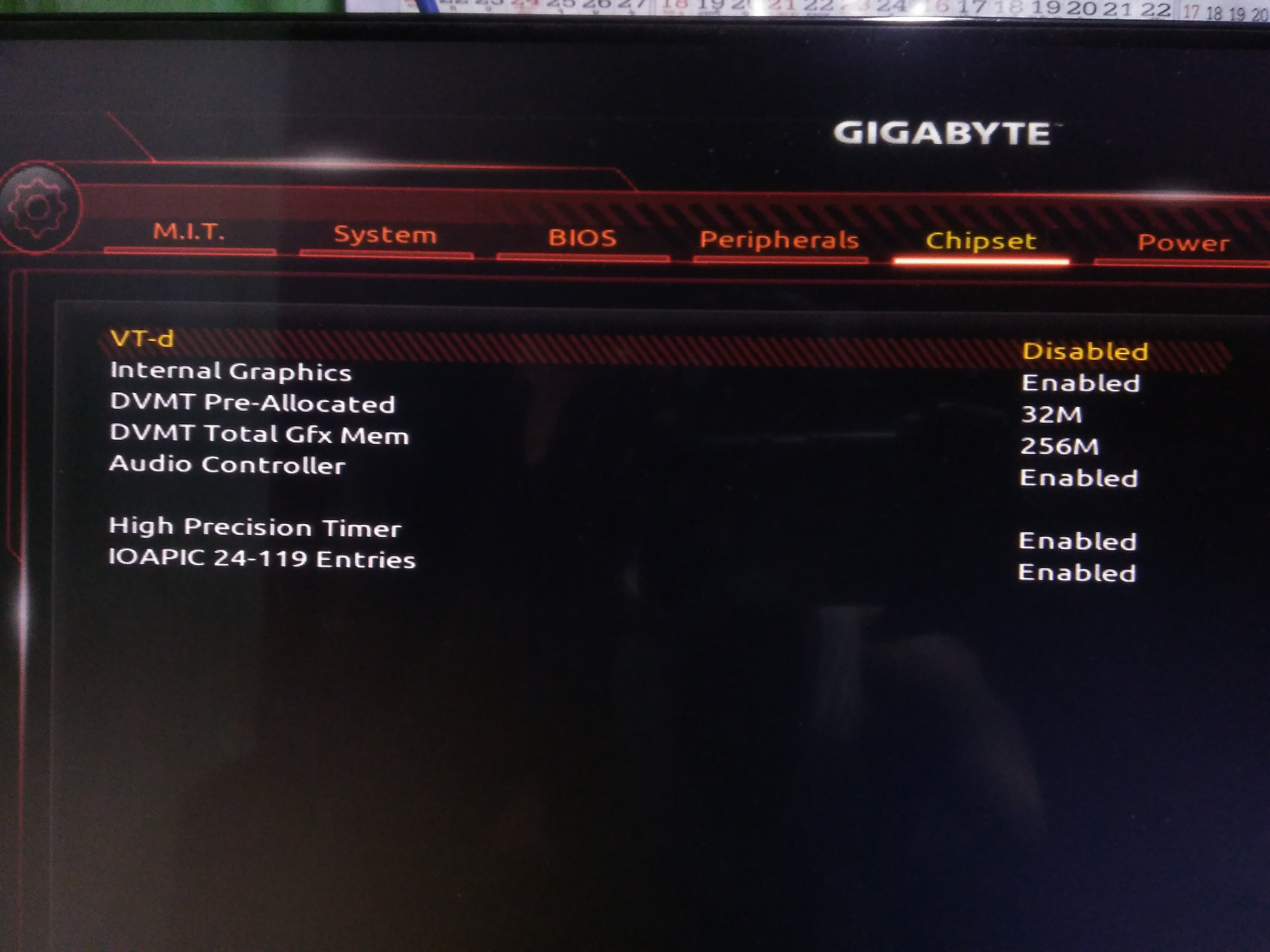

Cyberdevs Posted June 30, 2018 Share Posted June 30, 2018 Just now, Ajoy karmakar said: I got this error - attempting system restart mach reboot How the DMVT is configured in BIOS/UEFI? Link to comment https://www.insanelymac.com/forum/topic/334713-nvidia-ioconsoleusers-gioscreenlockstate-3-hs-0-bs-0-now-0-sm-0x0-error/#findComment-2623424 Share on other sites More sharing options...
Ajoy karmakar Posted June 30, 2018 Author Share Posted June 30, 2018 (edited) The default value is - Edited June 30, 2018 by Ajoy karmakar Link to comment https://www.insanelymac.com/forum/topic/334713-nvidia-ioconsoleusers-gioscreenlockstate-3-hs-0-bs-0-now-0-sm-0x0-error/#findComment-2623430 Share on other sites More sharing options...
