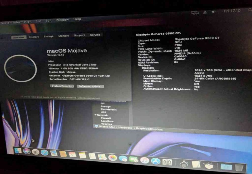

On 6/26/2018 at 10:27 AM, fantomas1 said:
OpenCL hidden or not, if Apple removed the kext(s) (or the support) for no-metal gpu's, barring a miracle, it will never work - unless if nvidia (in our case here) or someone else provides the kext(s) in question.  :)
A miracle or not, my g210 works very well  :)

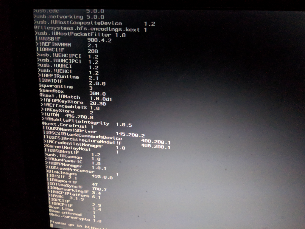

help,
after install all new patched kext files with kext wizard , then reboot nVidia kext not working for 9500gt with boot args inject nvidia and with uncheck nv_disable=1(can't boot to the system) with kernel panic :( any solution???

help,
2 hours ago, robif2002 said:
help,
Remove all /S/L/E/Geforce*** and /S/L/E/NVDA***.
If you still get kernel panic, I think, it's not graphic kext issue, it's something wrong else.
after deleted selsected files then reboot with inject nvidia, detected 1 gb video memory, but still laggy when open lainchpad, not fix resolution and no alpha blur :( what's wrong.???.

6 minutes ago, robif2002 said:
after deleted selsected files then reboot with inject nvidia, detected 1 gb video memory, but still not fix resolution and no alpha blur :( what's wrong.???.
thanks b4..
Refer to my config.plist.zip. FYI.
And re-install all the kexts, if you need NVDAStartup.kext.310.42.25f01.zip from nawcom too.
