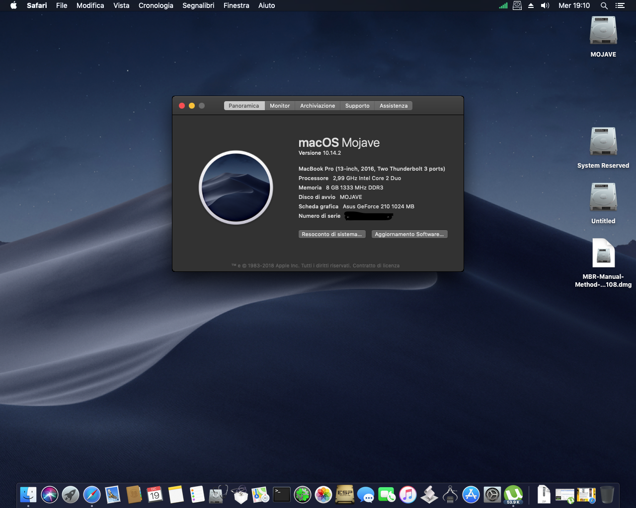

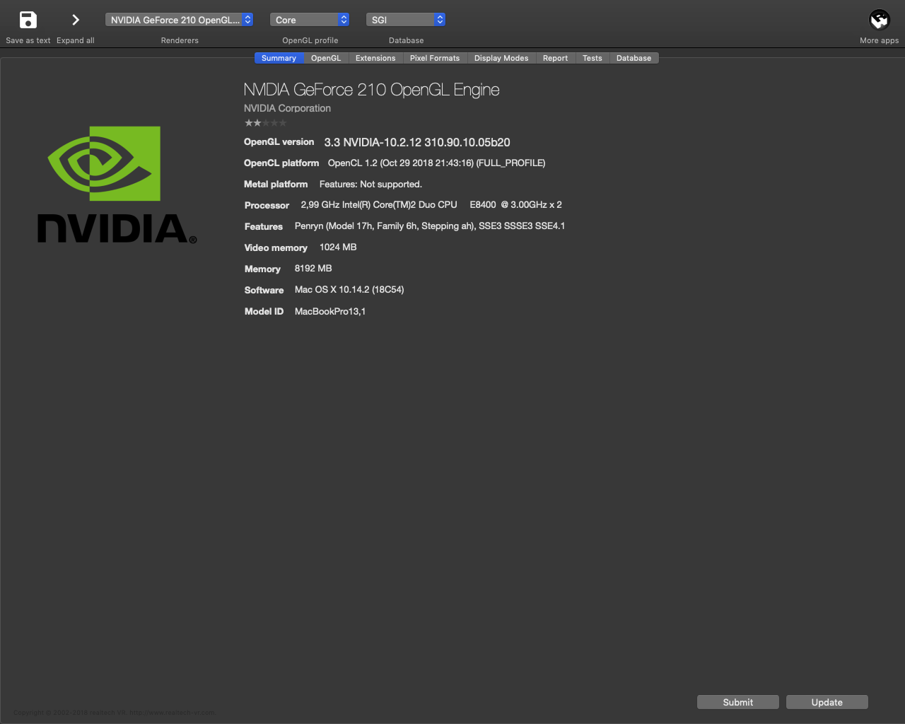

Hi, do a fresh install, in my case 10.14.1, install updated clover (config.plist + drivers64 edit), on USB installer and GeForceTesla.kext from https://forums.macrumors.com/members/asentientbot.1135186/(Installed manually).Repair permissions and rebuild cache with Kext utility (put directly directory S/L/E from usb into the app) then become installation.This has been my method after many times i stucked on grey screen with cursor mouse locked during the first boot after installation.Maybe these steps can help people with the same card trying Mojave for the first time.
I don't know if QE/CI are fully enabled, launchpad I think is accelerated, but of course metal is unsurpotted.
Post install you have to reinstall graphics kexts as crazybirdy says with kext utility.

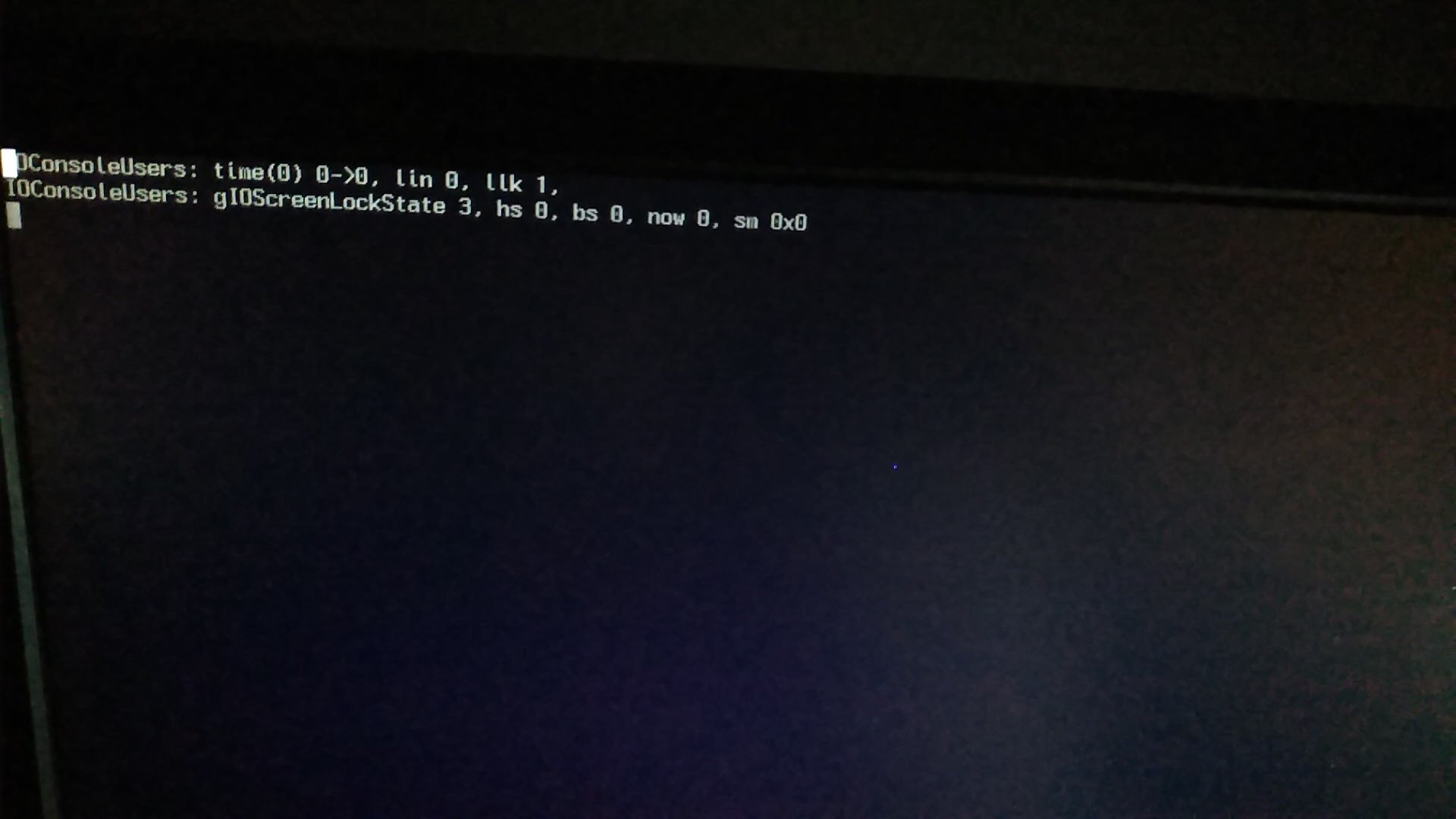

hi,i downloaded the package, and install it with kext utility,and it stuck here
how to fixed ,i use GeForce_10136-NEW method.
