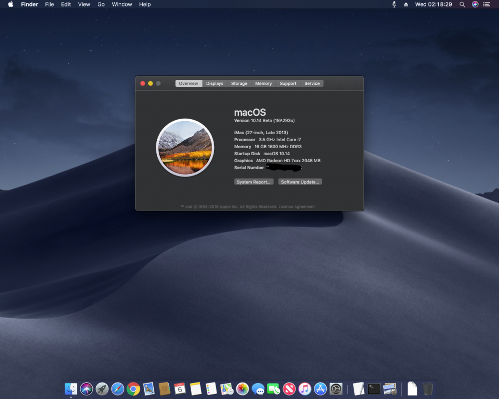

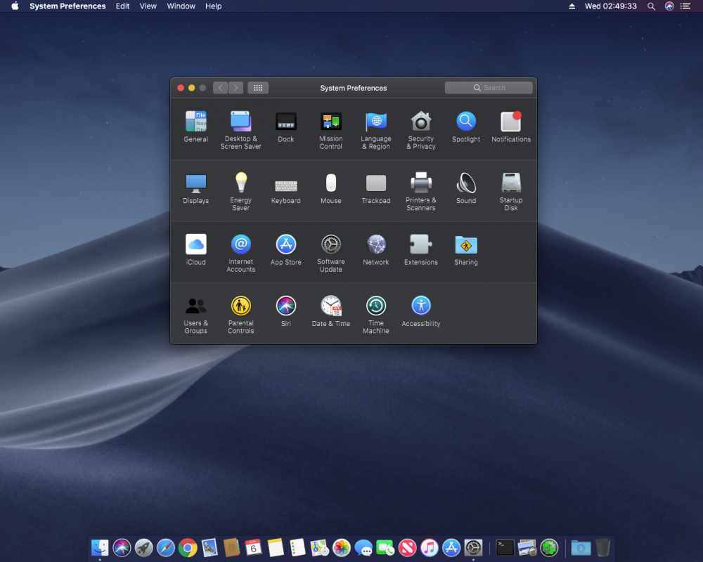

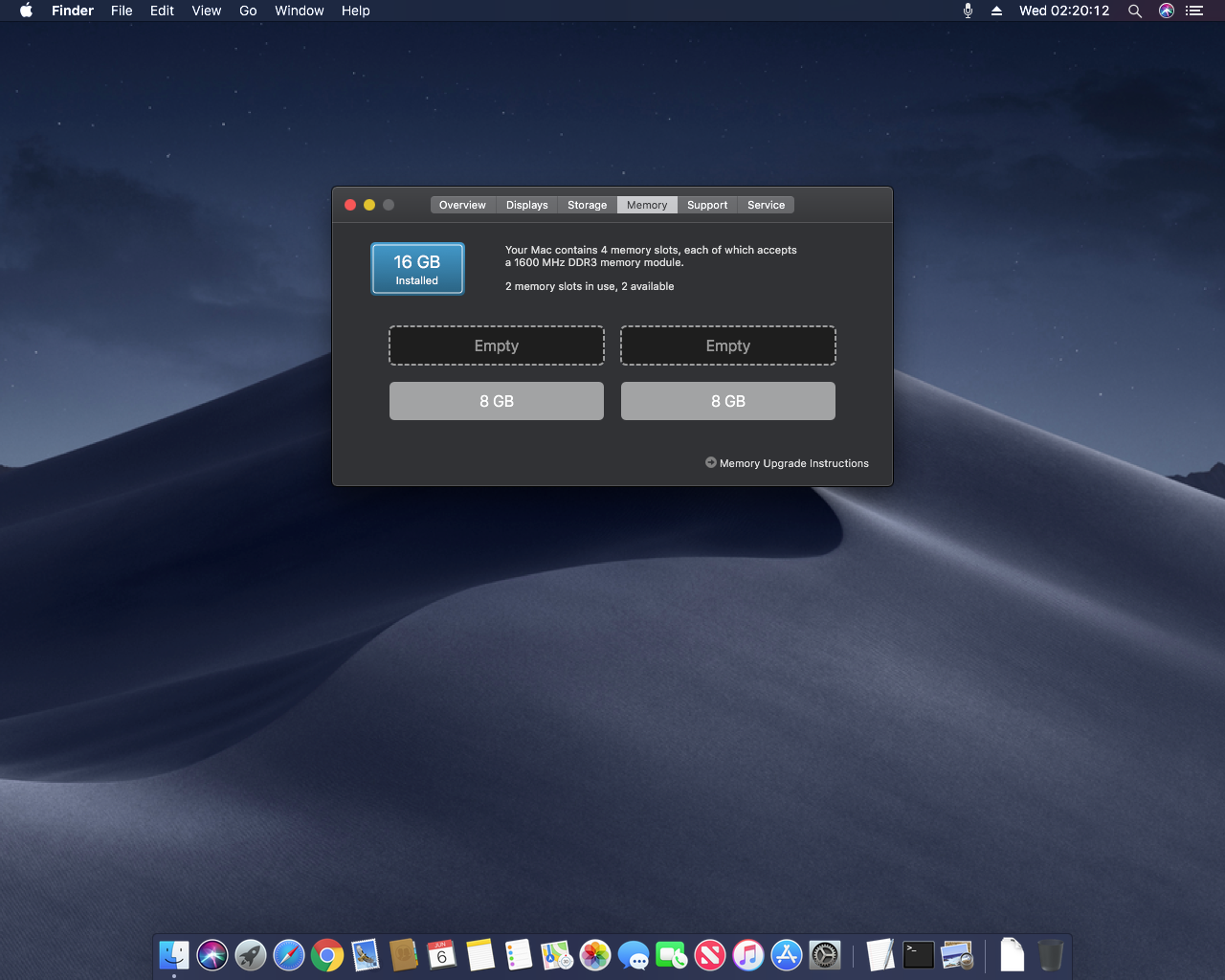

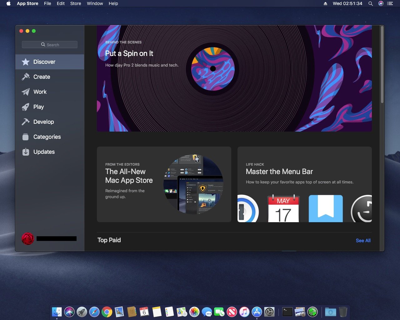

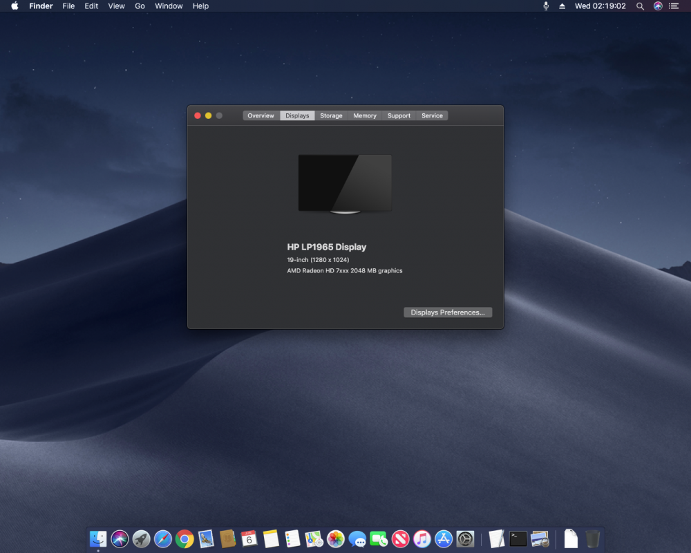

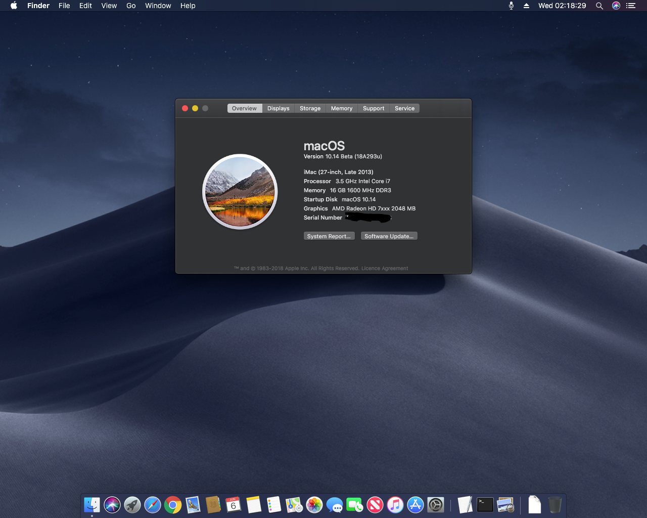

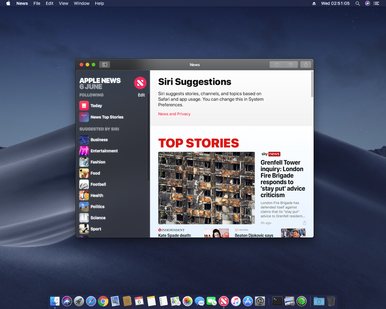

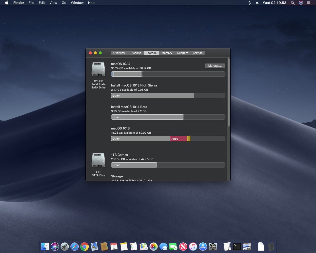

moman2000 Posted June 6, 2018 Share Posted June 6, 2018 (edited) Hi, I thought it would be nice that I would be the first here to give my experience with getting Mojave running and mostly working on my system. My specifications are as follows: iMac 14,2 GIGABYTE GA-Z97X-UD5H / Intel Core i7-4770k @ 4.4GHz / 16GB Corsair Vengeance DDR3 @ 1600MHz MSI AMD Radeon HD 7870 2GB OC 250GB SanDisk Ultra 3D NAND SSD / 120GB OCZ Agility 3 SSD 1TB 5.4K HDD I used the config that @MaLd0n helped me with. Seriously, he is a legend. HERE is my Clover Config including everything I use for 10.13 High Sierra and 10.14 Mojave. Installation Procedure: Create bootable USB media with createinstallmedia - sudo /Applications/Install\ macOS\ 10.14\ Beta.app/Contents/Resources/createinstallmedia --volume /Volumes/"Insert Volume Name here" ***** Remove quotation marks!!! **"--Applicationpath" is now depreciated and should not be used when making a 10.14 Mojave USB. I do not know if this will change in upcoming releases. ** ConvertToAPFS is now depreciated and no longer works when installing 10.14 Mojave beta 1. Using the command "--converttoapfs NO" will not work if you use it with "createinstallmedia". Editing "minstallconfig.xml" within the "macOS Install Data" folder on the target partition chosen during installation to change "ConvertToAPFS" from "TRUE" to "FALSE" would also not disable APFS conversion. Installation ran through well, but it did restart just after installation began which seemed to have been caused by a crash, but it seemed like it was normal as this happened twice as I tried installing Mojave earlier and the same thing happened. Rebooting again into the installation on the target drive that was selected before described as "macOS Install" and named "macOS 10.14" resumed installation. Everything from then on was easy and smooth. I set-up my iCloud and things as such and was brought to the desktop of macOS 10.14 Mojave! What does work: Graphics (Acceleration/Metal) // 4K video dropped 0 frames // Picture-in-Picture Mouse and Keyboard USB 3.0 - Full 5 GBP/s - Only ports above HDMI Port and front I/O USB 3.0 under both Intel and Killer Ethernet ports function with USB 2.0 devices. Ethernet (only Intel NIC so far) Both NIC's work, Intel I217-V and Killer E2200 iMessage Sleep and Wake Shutdown Restart Update #1: Temporary Fix: ***I have gotten audio to work after browsing Reddit, I stumbled across this post: https://www.reddit.com/r/hackintosh/comments/8orn7w/mojave_files_needed/e05kkj9/ Update #2: I have just found a kext for the on-board Killer E2200 NIC after searching with device and vendor ID's on this forum. https://www.insanelymac.com/forum/files/file/313-atherose2200ethernet/ Update #3: Audio is now fully operational with new version 1.2.8 of AppleALC, from here: What does NOT work: USB 3 under Intel I217-V NIC and Killer E2200 NIC Ethernet Ports // Only function with USB 2.0 devices. Audio Temporary fix in Update #1 above Fixed in Update #3 Killer E2200 NIC Fixed in Update #2 above This is the information I have been able to gather thus far whilst using Mojave. I hope this helps someone in getting Mojave running on their system. Regards, Mohamed CLOVER_moman2000 No SN.zip Edited June 21, 2018 by moman2000 Addition of Screenshots and text changes Link to comment Share on other sites More sharing options...
