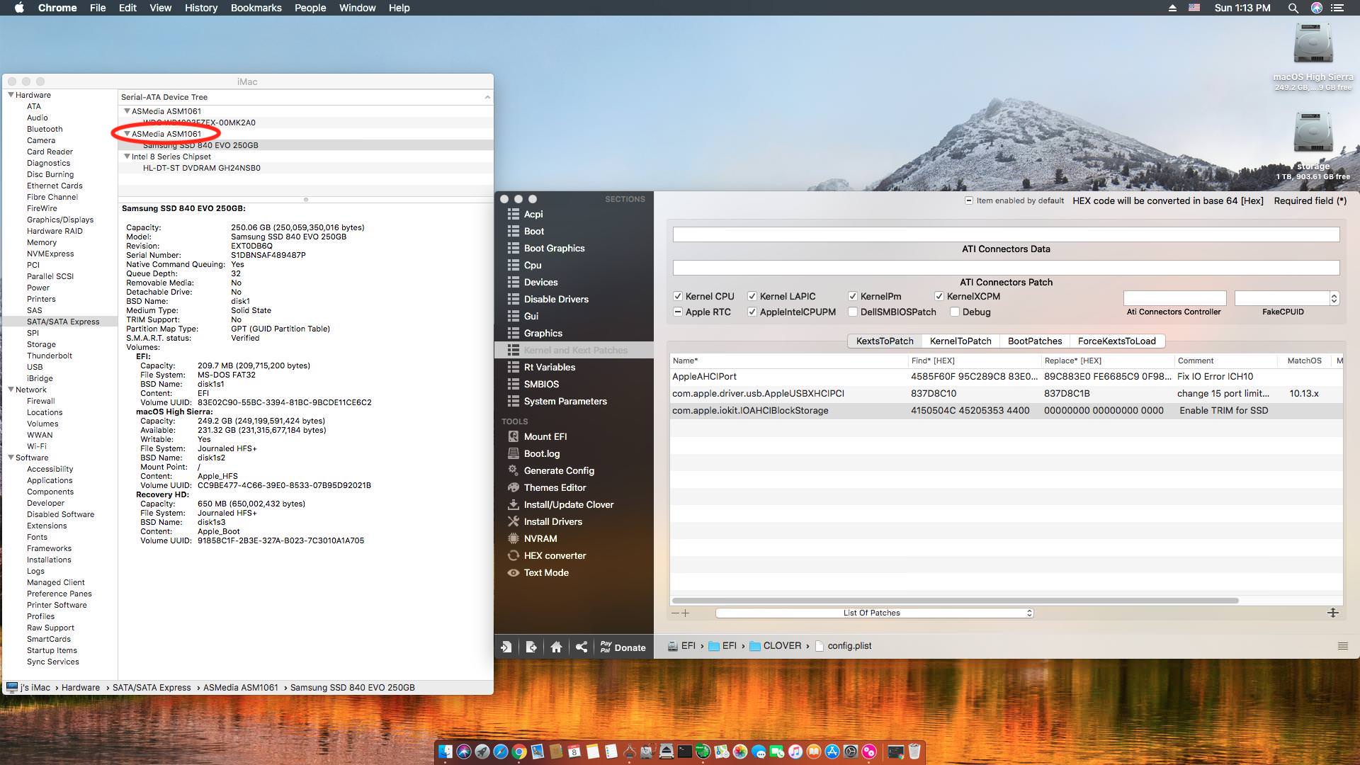

patricia2626 Posted April 8, 2018 Share Posted April 8, 2018 (edited) i update macos high sierra 10.13.4 everthings works but says trim off for 840 samsung evo as others used this same ssd and there trim are on and i try useing clovers text and copy the info not sure if i need a kext in the other folder did that and terminal sudo did nothing is it even support for my version? Edited April 8, 2018 by patricia2626 Link to comment https://www.insanelymac.com/forum/topic/333737-ssd-trim-on-support/ Share on other sites More sharing options...

patricia2626 Posted April 8, 2018 Author Share Posted April 8, 2018 37 minutes ago, Allan said: This is the best way! https://imgur.com/a/IO0fa https://imgur.com/a/rn94w 2 minutes ago, Cyberdevs said: What happens when you run the Terminal command? do you get a message like this? Reveal hidden contents Cyberdevss-iMac-2:~ cyberdevs$ sudo trimforce enable Password: IMPORTANT NOTICE: This tool force-enables TRIM for all relevant attached devices, even though such devices may not have been validated for data integrity while using TRIM. Use of this tool to enable TRIM may result in unintended data loss or data corruption. It should not be used in a commercial operating environment or with important data. Before using this tool, you should back up all of your data and regularly back up data while TRIM is enabled. This tool is provided on an “as is” basis. APPLE MAKES NO WARRANTIES, EXPRESS OR IMPLIED, INCLUDING WITHOUT LIMITATION THE IMPLIED WARRANTIES OF NON-INFRINGEMENT, MERCHANTABILITY AND FITNESS FOR A PARTICULAR PURPOSE, REGARDING THIS TOOL OR ITS USE ALONE OR IN COMBINATION WITH YOUR DEVICES, SYSTEMS, OR SERVICES. BY USING THIS TOOL TO ENABLE TRIM, YOU AGREE THAT, TO THE EXTENT PERMITTED BY APPLICABLE LAW, USE OF THE TOOL IS AT YOUR SOLE RISK AND THAT THE ENTIRE RISK AS TO SATISFACTORY QUALITY, PERFORMANCE, ACCURACY AND EFFORT IS WITH YOU. Are you sure you wish to proceed (y/N)? y Your system will immediately reboot when this is complete. Is this OK (y/N)? y Enabling TRIM... . . Operation succeeded. Your system will reboot momentarily, please wait... https://imgur.com/a/IO0fa https://imgur.com/a/rn94w Link to comment https://www.insanelymac.com/forum/topic/333737-ssd-trim-on-support/#findComment-2608591 Share on other sites More sharing options...
Cyberdevs Posted April 8, 2018 Share Posted April 8, 2018 use either the command or the clover's patch. don't use both and if the command fails double check the clover's patch: the name should be: com.apple.iokit.IOAHCIBlockStorage not IOAHCIBlackStorage under macOS 10.13.4 and remove the MatchOS info as well and try again. Link to comment https://www.insanelymac.com/forum/topic/333737-ssd-trim-on-support/#findComment-2608593 Share on other sites More sharing options...
patricia2626 Posted April 8, 2018 Author Share Posted April 8, 2018 10 minutes ago, Cyberdevs said: use either the command or the clover's patch. don't use both and if the command fails double check the clover's patch: the name should be: com.apple.iokit.IOAHCIBlockStorage not IOAHCIBlackStorage under macOS 10.13.4 and remove the MatchOS info as well and try again. like this https://imgur.com/a/VNm6w Link to comment https://www.insanelymac.com/forum/topic/333737-ssd-trim-on-support/#findComment-2608596 Share on other sites More sharing options...
Cyberdevs Posted April 8, 2018 Share Posted April 8, 2018 Just use the patch I gave you, You are still using an incorrect patch in your clover. you should find: 00415050 4C452053 534400 and replace it with: 00000000 00000000 000000 Your patch says: find : 4150504C 45205353 4400 Link to comment https://www.insanelymac.com/forum/topic/333737-ssd-trim-on-support/#findComment-2608598 Share on other sites More sharing options...
patricia2626 Posted April 8, 2018 Author Share Posted April 8, 2018 6 minutes ago, Cyberdevs said: Just use the patch I gave you, You are still using an incorrect patch in your clover. you should find: 00415050 4C452053 534400 and replace it with: 00000000 00000000 000000 Your patch says: find : 4150504C 45205353 4400 like this https://imgur.com/a/jniF5 Link to comment https://www.insanelymac.com/forum/topic/333737-ssd-trim-on-support/#findComment-2608600 Share on other sites More sharing options...

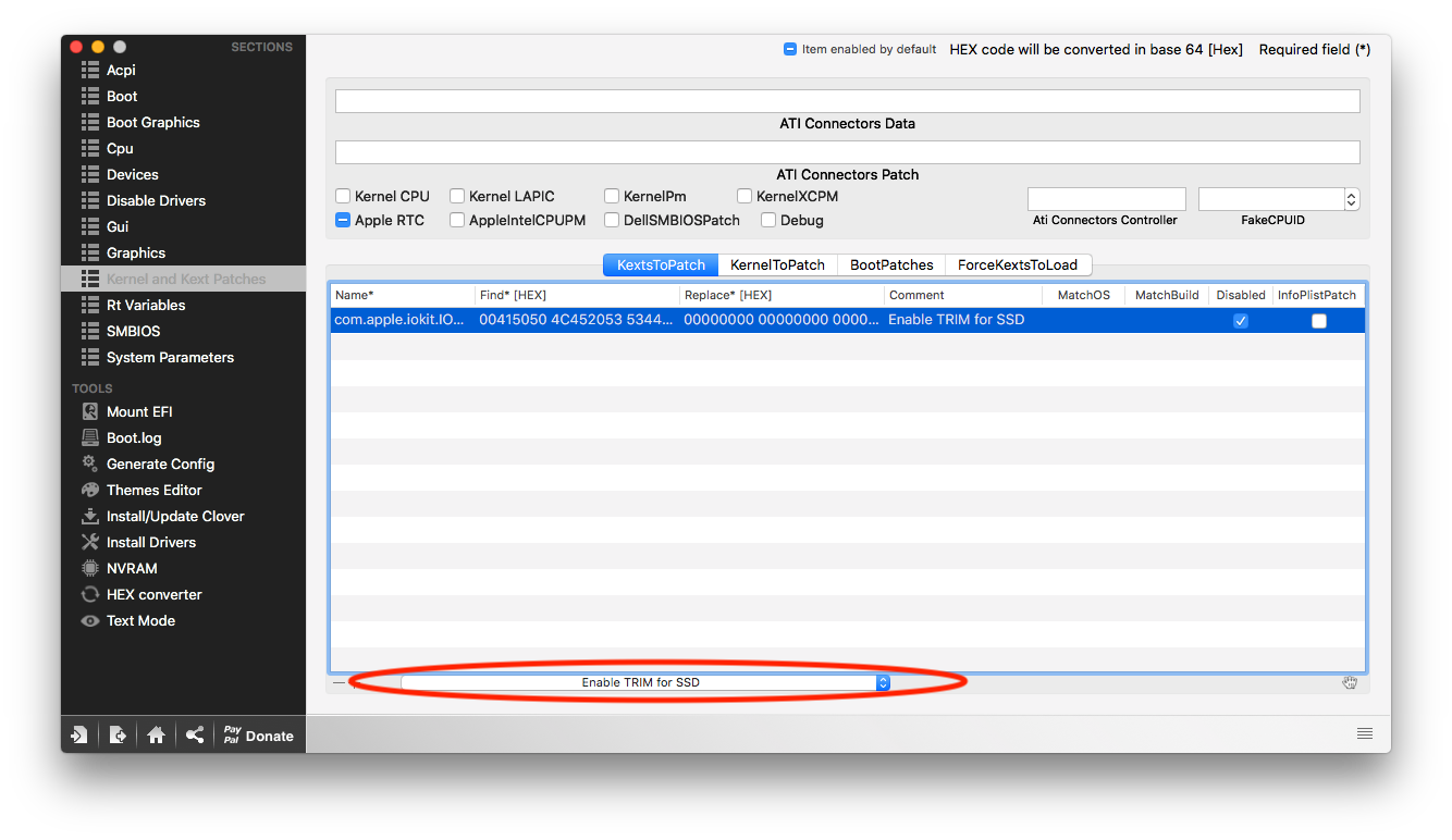

Cyberdevs Posted April 8, 2018 Share Posted April 8, 2018 (edited) 18 minutes ago, patricia2626 said: like this https://imgur.com/a/jniF5 NO, Just click on the drop down menu which says "List Of Patches" and select "Enable TRIM for SSD" Edited April 8, 2018 by Cyberdevs 1 Link to comment https://www.insanelymac.com/forum/topic/333737-ssd-trim-on-support/#findComment-2608606 Share on other sites More sharing options...
patricia2626 Posted April 8, 2018 Author Share Posted April 8, 2018 2 minutes ago, Cyberdevs said: NO, Just click on the drop down menu which says "List Of Patches" and select "Enable TRIM for SSD" do i need the check mark too where it says disable Link to comment https://www.insanelymac.com/forum/topic/333737-ssd-trim-on-support/#findComment-2608607 Share on other sites More sharing options...
Cyberdevs Posted April 8, 2018 Share Posted April 8, 2018 Just now, patricia2626 said: do i need the check mark too where it says disable No just uncheck it, if it's check the patch will be disabled. When you add a patch from that list it is disabled by default. Link to comment https://www.insanelymac.com/forum/topic/333737-ssd-trim-on-support/#findComment-2608608 Share on other sites More sharing options...
Cyberdevs Posted April 8, 2018 Share Posted April 8, 2018 Click on the section I selected from your image and then check the TRIM's status Link to comment https://www.insanelymac.com/forum/topic/333737-ssd-trim-on-support/#findComment-2608612 Share on other sites More sharing options...

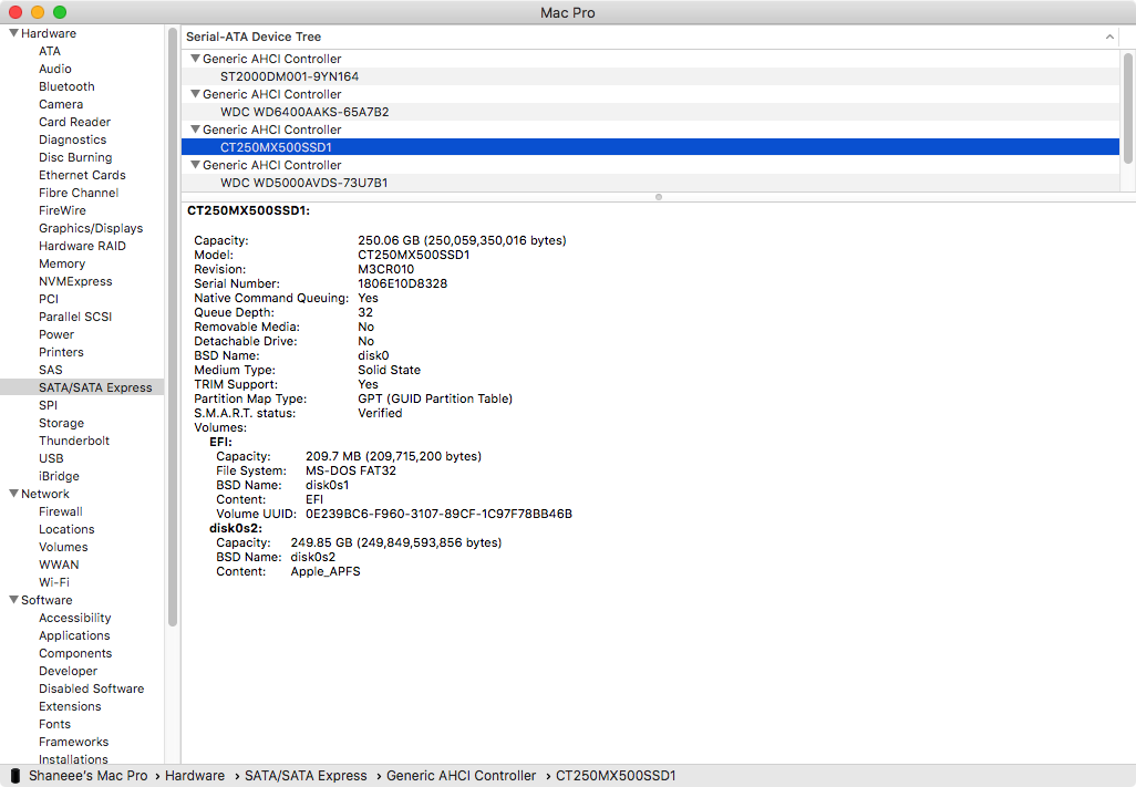

Shaneee Posted April 8, 2018 Share Posted April 8, 2018 1 hour ago, Cyberdevs said: Well, I'm not sure why it's not working. Maybe that's because of your SSD itself or it might be related to the AMD build that you are using. I'm not sure but AFIAK AMD needs an optimized version of the kernel which is different than the regular kernel. Maybe @Shaneee can shed some light on the subject. Don't think it's kernel related. My MX500 250GB is working with sudo trimforce enable 1 Link to comment https://www.insanelymac.com/forum/topic/333737-ssd-trim-on-support/#findComment-2608627 Share on other sites More sharing options...
patricia2626 Posted April 8, 2018 Author Share Posted April 8, 2018 32 minutes ago, Shaneee said: Don't think it's kernel related. My MX500 250GB is working with sudo trimforce enable is there anything i can check if it turn on bios Link to comment https://www.insanelymac.com/forum/topic/333737-ssd-trim-on-support/#findComment-2608630 Share on other sites More sharing options...
