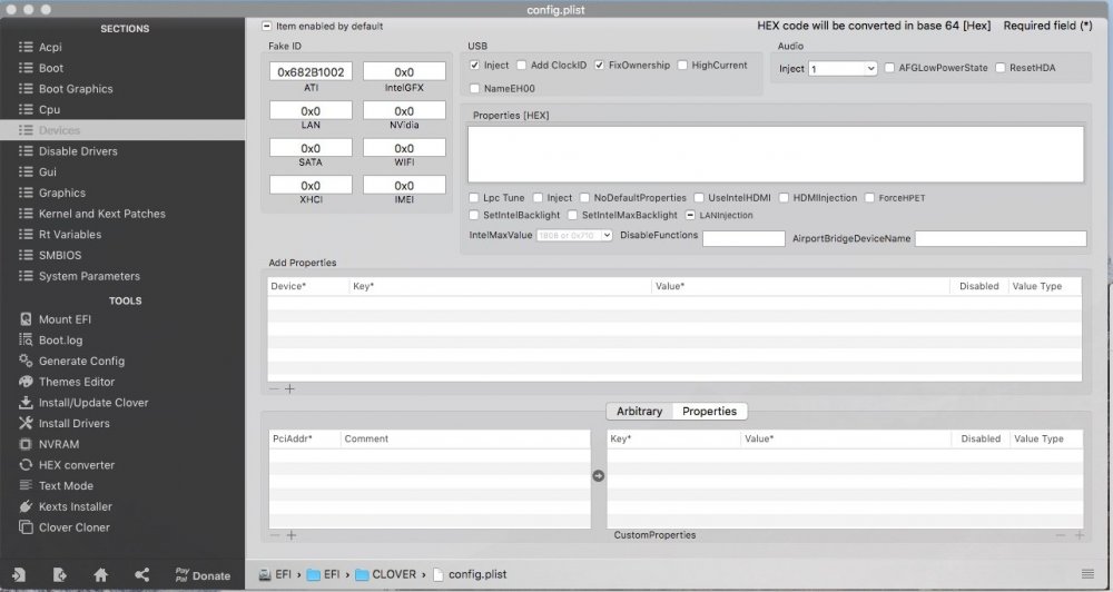

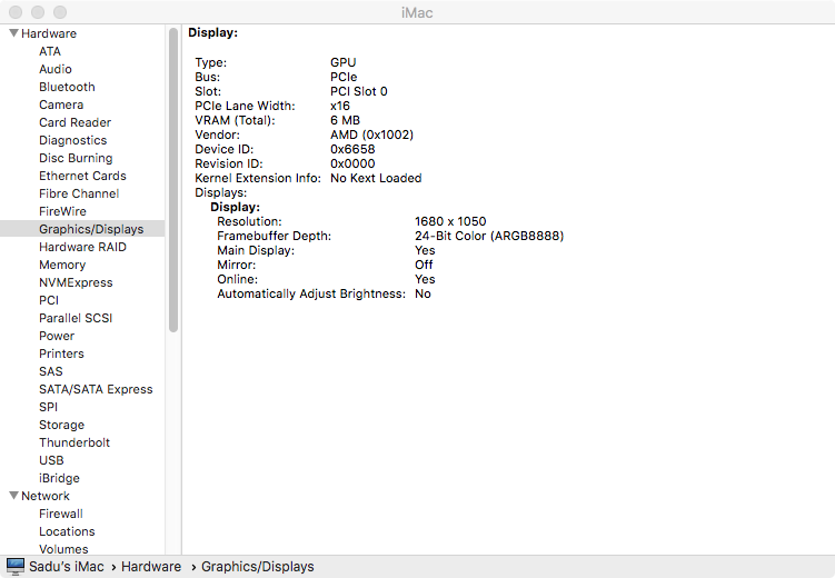

saduisahu Posted March 23, 2018 Share Posted March 23, 2018 Hello guys, I apologise for it's my first time building a Hackintosh, and I seem to have a bit of problem with my GPU, (only shows 6mb ) After fresh Install I installed lilu.kext and whatevergreen.kext, I injected ATI through Clover and added my fake id (0x66581002) but nothing seems to solve this problem, I really need help here guys as I am very new to this kind of things, I will attach my pc specifications and my config.plist file for you guys to examine thank you in advance config.plist Link to comment Share on other sites More sharing options...

Guest ricoc90 Posted March 24, 2018 Share Posted March 24, 2018 (edited) I don't have experience with whatevergreen, so I don't know exactly how it works and what it does. I do know that your device ID not listed in AMD8000Controller.kext nor in AMDRadeonX4000.kext, hence why they won't load. You could manually add your Device ID in their info.plist But again, I don't know if whatevergreen deals with that already. Edited March 24, 2018 by ricoc90 Link to comment Share on other sites More sharing options...
Cyberdevs Posted March 24, 2018 Share Posted March 24, 2018 18 hours ago, saduisahu said: Hello guys, I apologise for it's my first time building a Hackintosh, and I seem to have a bit of problem with my GPU, (only shows 6mb ) After fresh Install I installed lilu.kext and whatevergreen.kext, I injected ATI through Clover and added my fake id (0x66581002) but nothing seems to solve this problem, I really need help here guys as I am very new to this kind of things, I will attach my pc specifications and my config.plist file for you guys to examine thank you in advance The device ID 0x66581002 isn't natively supported by macOS you should either use another fake device ID such as 0x665C1002 or you should add your deviceID to the kexts that @ricoc90 mentioned and replace the kext using kext wizard or kext utility and the repair the permissions afterwards. Besides you shouldn't use InjectATI and WhateverGreen together anyway. Link to comment Share on other sites More sharing options...
saduisahu Posted March 24, 2018 Author Share Posted March 24, 2018 Ok so for some reasons I dint have permissions to change the info.plist in AMD8000Controller.kext and AMDRadeonX4000.kext so I used this fake ID 0x665C1002 that was listed, also I set inject ati to False I rebuild permissions and cache, but still nothing has changed it's still the same Heres my config.plist file... config.plist Link to comment Share on other sites More sharing options...

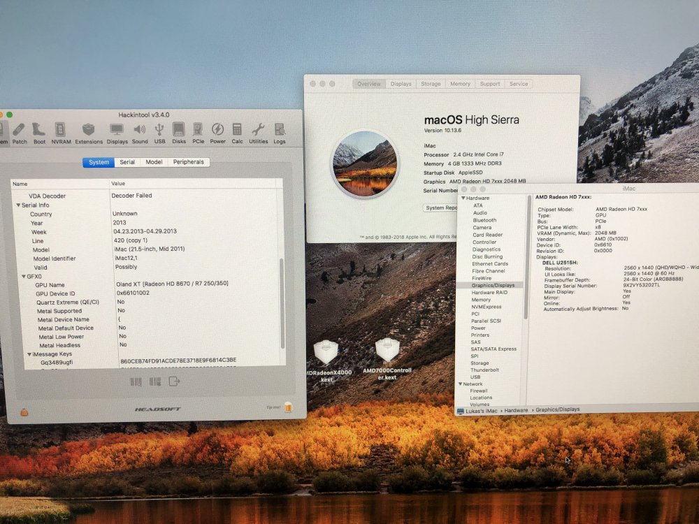

luki1979 Posted June 8, 2020 Share Posted June 8, 2020 (edited) OK some progress. I edited Info.plist in kexts again this time with textedit and than rebuild with Hackintool. My card is XFX R7 250 A which is based on Oland chip. Some R7 200 are based on Verde or Bonaire chip (check in GPU-Z) in that case you're lucky and you have support in AMDRadeonX4000.kext. I added my card id 0x66101002 to Bonaire section in AMDRadeonX4000.kext and nothing, than I added ID to both sections in AMD7000Controller.kext and now I got card recognised as 7xxx 2GB, full resolution which is nice but no QE/CI. I moved my id in X4000.kext to Verde section but this has no effect. I will try my luck with 8000 controller tomorrow as 8570 and 8670 are both Oland. Edited June 8, 2020 by luki1979 Link to comment Share on other sites More sharing options...
luki1979 Posted June 9, 2020 Share Posted June 9, 2020 With AMD8000Controller it won’t even boot. So will try to get QE/CI working with 7000 controller. Link to comment Share on other sites More sharing options...
luki1979 Posted June 14, 2020 Share Posted June 14, 2020 Works Link to comment Share on other sites More sharing options...
snakeman Posted July 9, 2020 Share Posted July 9, 2020 @luki1979 How did you get it working? Link to comment Share on other sites More sharing options...
luki1979 Posted July 9, 2020 Share Posted July 9, 2020 As you can see just fake ID and nothing else needed Link to comment Share on other sites More sharing options...
