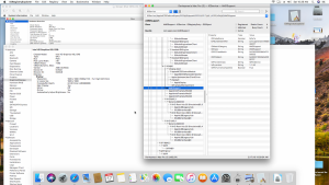

Gigamaxx Posted February 17, 2018 Author Share Posted February 17, 2018 Hallelujah! I'm in! Here's my IOReg. Donkeymac’s Mac Pro Ryzen 2200g.zip Clover boot log Ryzen 2200g boot log.txt 3 Link to comment https://www.insanelymac.com/forum/topic/332740-amd-ryzen-2200g-with-vega-graphics-hackintoshable/#findComment-2593615 Share on other sites More sharing options...

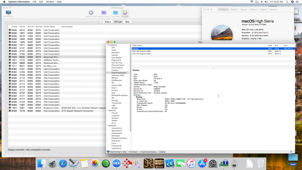

Gigamaxx Posted March 11, 2018 Author Share Posted March 11, 2018 I updated to HS 13.4 beta 4 and installed my RX Vega 64 card. With no edits to IGPU graphics it goes to black screen but the Vega card is initializing as the fan goes through its usual slow down at boot. I was able to run it by editing the AppleIntelKBLGraphicskext adding 0x15DD1002 to the info.plists to it and the frame buffer kext. It has good performance in initial testing similar to my Intel Pentium at similar CPU frequency rate. Without any edits to the IntelGrtaphics kexts It will run by disabling the IGPU graphics. My gut feeling on this is that the Vega graphics kexts are designed to run with HBM2 memory and the IGPU Vega graphics are using DDR4 memory. It seems pretty stable running either KBL spoofing or with IGPU disabled and the usual 15-20% performance drop that I see with my Ryzen 7 1700 and previous Ryzen 5 1500X does not appear to be happening. Performance with this second gen Ryzen seems better and equal to Intel CPUs at this point. I picked up a Nvidia 1060 3gb last night but its an open box unit and I can't get any graphics output through HDMi in OS or Windows so I'm taking it back and will try another for testing to check the Horrible Nvidia performance loss with Ryzen. Geekbench compute 186,000 for Vega, Valley Extreme HD 2206. With Ryzen 7 1700 Geekbench averages 152,000 and Valley Ex HD 1800. Check out these benches from the Vega and Ryzen 2200g they are pretty good for AMD kernel in OS High Sierra and seem to be up to par with Intel CPUs. Edit error -200 for loading images to the site. I will try later to add pics. Link to comment https://www.insanelymac.com/forum/topic/332740-amd-ryzen-2200g-with-vega-graphics-hackintoshable/#findComment-2602402 Share on other sites More sharing options...

Shaneee Posted April 25, 2018 Share Posted April 25, 2018 This is as far as I can get with the AMD kexts and the device ID added. They load but the frame buffer isn't loaded. I've tried loading all 7 frame buffers included in the X1000 kext with no luck. From the tests Gigamaxx did there seems to be more luck spoofing as Intel graphics there. More support may come from integrated Vega though, hard to tell. 1 Link to comment https://www.insanelymac.com/forum/topic/332740-amd-ryzen-2200g-with-vega-graphics-hackintoshable/#findComment-2611488 Share on other sites More sharing options...

Shaneee Posted April 26, 2018 Share Posted April 26, 2018 Yeah the kexts were loaded but no framebuffer attached. I'll post an ioreg later after work. Edit: I've attached the IOReg with the device ID added to the AMD kexts. Shaneee’s Mac Pro.zip 1 Link to comment https://www.insanelymac.com/forum/topic/332740-amd-ryzen-2200g-with-vega-graphics-hackintoshable/#findComment-2611533 Share on other sites More sharing options...
