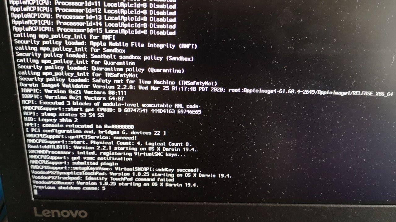

b0ltun Posted May 8, 2020 Share Posted May 8, 2020 (edited) @Gigamaxx i don`t think that EFI gonna work, heh. AMD-USB is pretty default (laptops are using XHC0, XHC1 controllers) + SMCAMD won`t let boot the system. VirtualSMC + AMDpowerManagement is okay (sometimes it force closing), if i add SMCAMD - it`s stuck on "Previous shutdown 5" or "afps blah-blah" (edited: sorry, my fault, didn`t see that actually is a desktop ryzen with integrated graphics, so it`s might boot) I have booted Mojave with the help of one guy, who has already written in that topic. Two days ago we managed to boot latest Catalina 10.15.4 (after release of OC 0.5.8). I tried to map USB correctly (because we have some trouble with it - it`s randomly stuck on booting, but sometimes it`s boot well). I have edit kext according my DSDT, edit SSDT-USBX. So it`s booting now more stable, but it`s still sometimes stuck on booting (100% that`s USB problem or related to it) I got Lenovo 330-15ARR (2500u + Vega8) with Radeon 540 (which is disabled, because it`s not possible to disable fully Vega - if i disable Vega - no screen at all even with HMDI connected) + i have bios unlocked (can manage XCH controllers, processor settings and more stuff). Even with that - we don`t know how to fix that USB issue to get stable boot for testing other stuff. Still has no graphics acceleration and sound crackling, but it`s already known, heh Touchpad is not working, because we`ve got ELAN connected to I2C, and VoodooI2C is not working at all (i have checked all docs of VoodooI2C + made all patches and still nothing, until i realised that AMD laptop can`t has and Intel I2C controller xD. So it`s not working because there is no support for AMD I2C controllers + we were unlucky to get ELAN with I2C and not Synaptics on PS2 So it`s kinda stable, at least to boot. But if it`s possible to fix that issue with booting - it will be cool, at least we will get stable boot btw, we can only boot without any issues and without random stuck with GenericUSBXCHI kext, but then we won`t get USB at all (no cam, no bluetooth, no cardreader, no tethering via USB). I will try to check again what`s the problem with USB ports, but if somebody can help me with that - that`s will be cool. On amd hackintosh discord if you tell somebody that you trying to boot amd laptop - you will get the answer "no laptops supported", "it won`t boot" and etc. I know, that`s because lack of Vega support, but still, why don`t just at least to boot. Maybe someone will understand how to fix common problems with that hardware Edited May 8, 2020 by b0ltun Link to comment https://www.insanelymac.com/forum/topic/332740-amd-ryzen-2200g-with-vega-graphics-hackintoshable/page/3/#findComment-2721457 Share on other sites More sharing options...

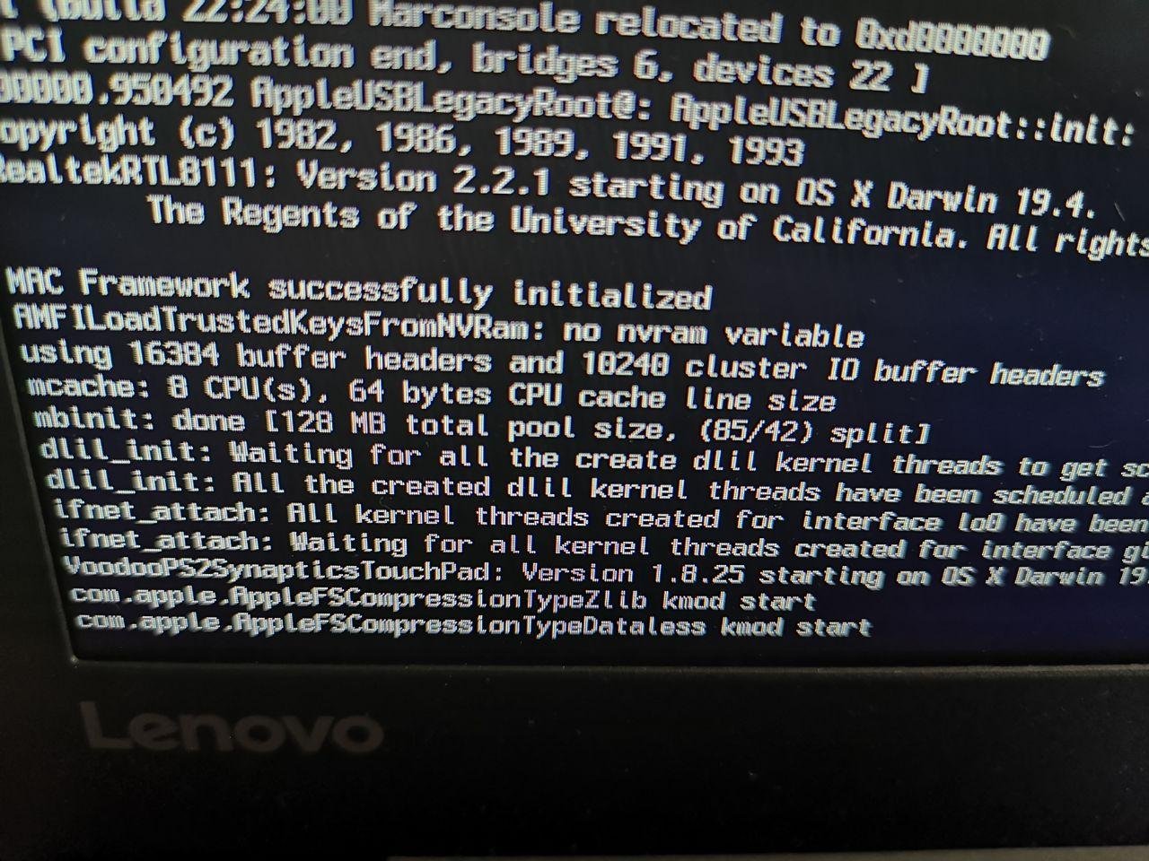

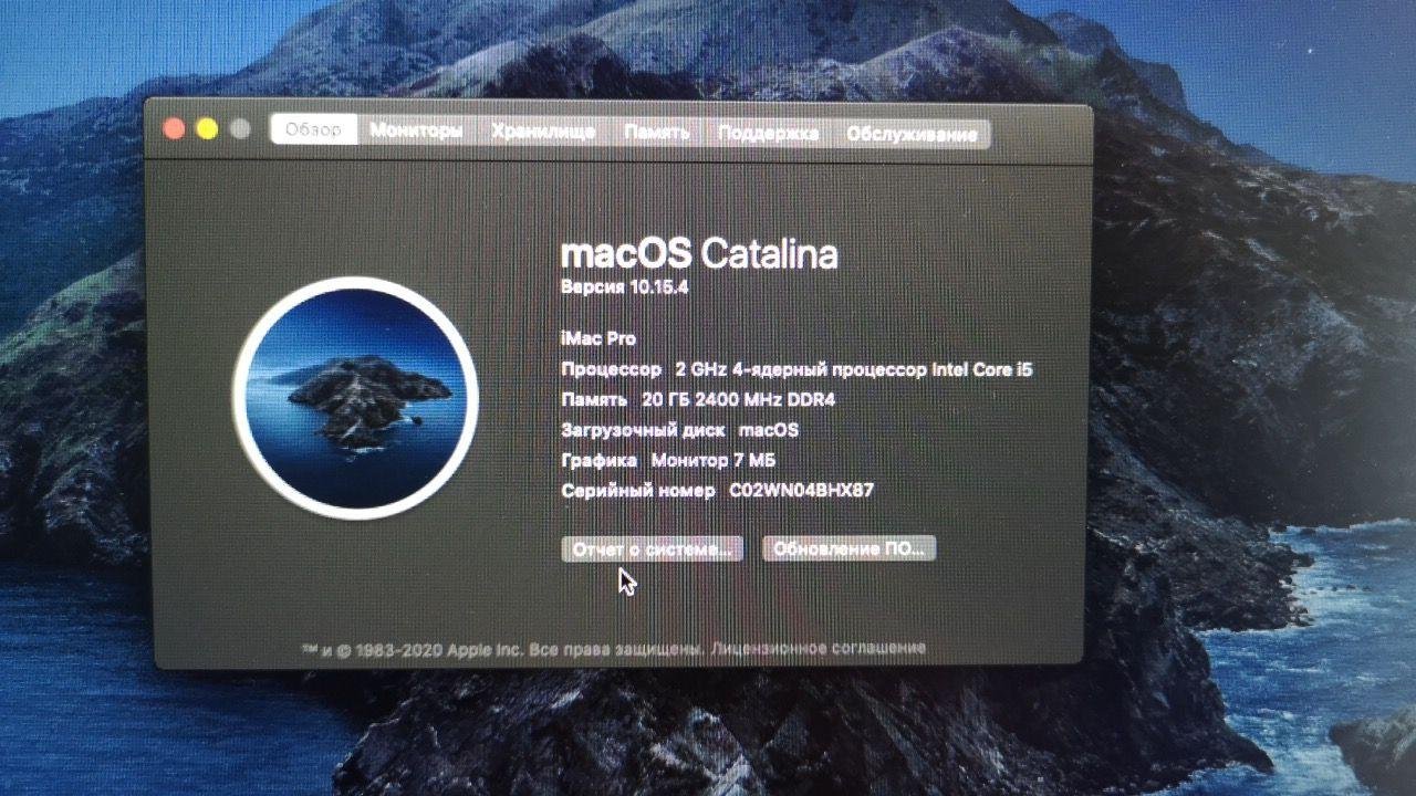

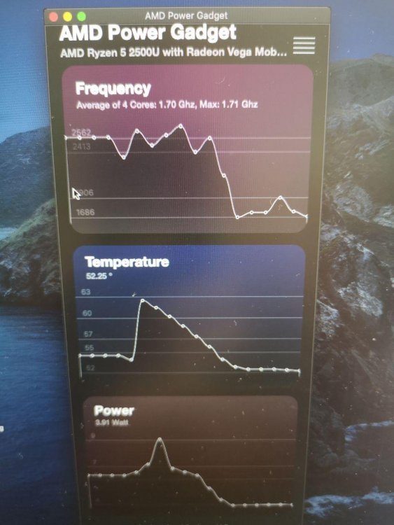

b0ltun Posted June 12, 2020 Share Posted June 12, 2020 Some updates. Touchpad is still not working, i was trying to fake AMD controller into Intel one (tried two of them) - nothing worked. Booting is more stable now, usb issues is still random, but it's better now. Also SMCAMDProccessor.kext is fully working now. Spoofing Vega into new Intel graphics (Comet/IceLake) is not working. It's spoofing, but still trying to load AMDSupport.kext, not intel graphics one. (Still 7mb) But on previous version of OC and macOS i won't boot if i spoof into Coffee or Comet, so that strange. I will dive dipper in whatevergreen faqs to check if i skip something special Link to comment https://www.insanelymac.com/forum/topic/332740-amd-ryzen-2200g-with-vega-graphics-hackintoshable/page/3/#findComment-2725591 Share on other sites More sharing options...

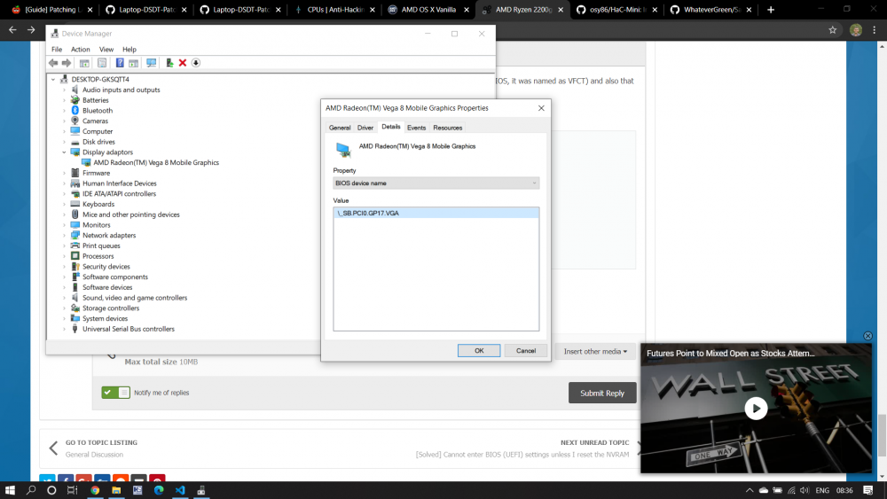

mvaisakh Posted September 10, 2020 Share Posted September 10, 2020 (edited) So, I was digging through my ACPI Tables, I found out that there's a separate VBIOS (I'm really not sure if it is the VBIOS, it was named as VFCT) and also that the DSDT has the none of the commonly used ACPI Paths for GPU (i.e., GFX0, AGP1, VID etc), instead has GP17. External (_SB_.PCI0.GP17.VGA_, DeviceObj) And this path points to my Graphics driver on my Windows. Also looking through the ACPI, I found out that there were several SSDTs apart from the main DSDT (Which on decompiling threw warnings, but after linking all the SSDTs together it decompiled without warnings). I'm gonna need some help regarding this "DSDT" patching, because I'm really new to this ACPI patching. Oh and yeah I have Catalina Booting with WiFi (Thanks to itlwm by @zxystd), keyboard works, just no GPU acceleration with 7mb vram. Edited September 10, 2020 by mvaisakh 1 Link to comment https://www.insanelymac.com/forum/topic/332740-amd-ryzen-2200g-with-vega-graphics-hackintoshable/page/3/#findComment-2736974 Share on other sites More sharing options...

b0ltun Posted September 19, 2020 Share Posted September 19, 2020 On 9/15/2020 at 5:03 AM, mvaisakh said: So in theory, spoofing to use a GCN 5 architecture GPU should give us HW accel (if the kext loads, ofcourse), but instead the above mentioned happens (it's probably trying to accelerate, but is failing somewhere?). not possible imo even in theory. GCN 5 are made with HBM2 memory. So they are using HBM2 memory and ofc all the kexts made for HBM2 for sure made only for HBM2 to work with. Vega 8 is using memory from RAM (again, afaik - on my laptop with modded bios i was able to set Vega to 4gb VRAM, getting 16 GB RAM (in summary i had 20 gigs, 20-4=16)), same like Intel Graphics (ofc, there are many differences, vega and intel graphics are not equal at all) I really don't think that spoofing into AMD graphics for desktops gonna work. They are not gonna work due to memory they are using, heh. So in theory, you might be able to spoof it into some Intel graphics, here some guys already did that (without graphics accel). So you might research in that field, it seems to be more optimistics, maybe my vbios files will help you with that Link to comment https://www.insanelymac.com/forum/topic/332740-amd-ryzen-2200g-with-vega-graphics-hackintoshable/page/3/#findComment-2737836 Share on other sites More sharing options...
mvaisakh Posted September 20, 2020 Share Posted September 20, 2020 (edited) 8 hours ago, b0ltun said: not possible imo even in theory. GCN 5 are made with HBM2 memory. So they are using HBM2 memory and ofc all the kexts made for HBM2 for sure made only for HBM2 to work with. Vega 8 is using memory from RAM (again, afaik - on my laptop with modded bios i was able to set Vega to 4gb VRAM, getting 16 GB RAM (in summary i had 20 gigs, 20-4=16)), same like Intel Graphics (ofc, there are many differences, vega and intel graphics are not equal at all) Yep, the last time I had it powered on, the kext was crying as there was no VRAM. There should be a way to reserve memory from ram, I'm just not sure how. Writing a kext at the moment seems impossible to me since I'm really unfamiliar with Darwin. Edited September 20, 2020 by mvaisakh Link to comment https://www.insanelymac.com/forum/topic/332740-amd-ryzen-2200g-with-vega-graphics-hackintoshable/page/3/#findComment-2737852 Share on other sites More sharing options...
