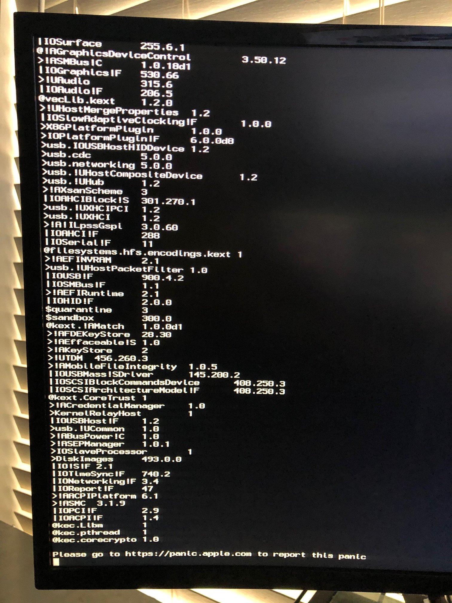

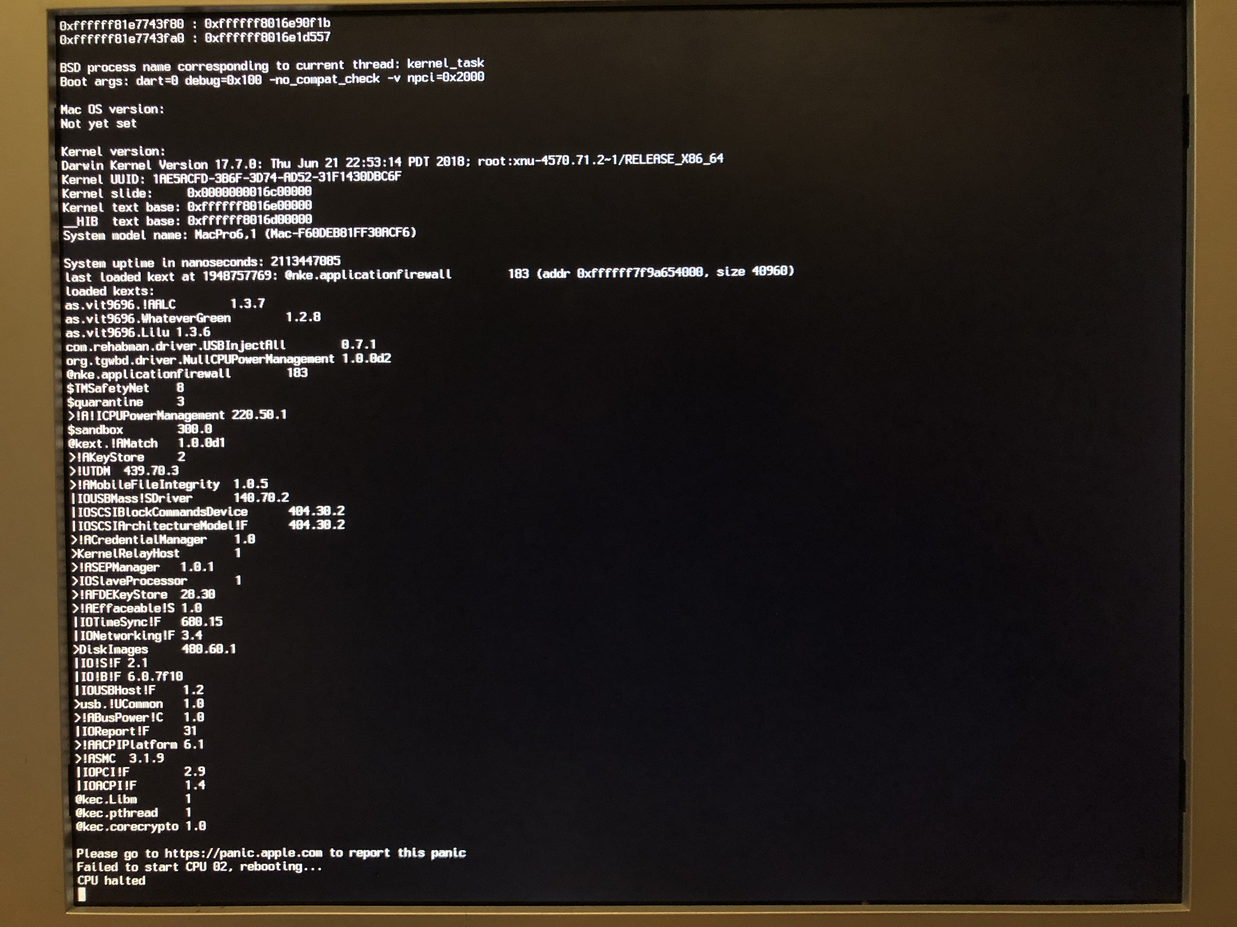

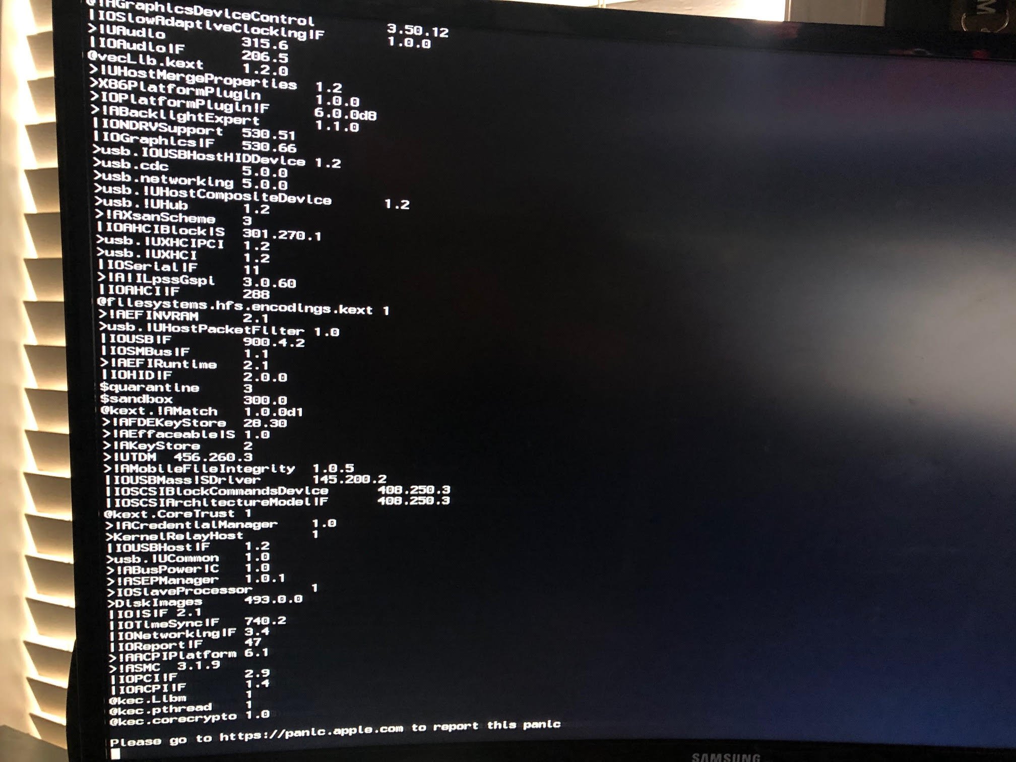

schrodinger Posted May 8, 2019 Share Posted May 8, 2019 21 hours ago, MaLd0n said: try with MacPro6,1 smbios, press O clover boot screen and change in smbios section Identical kernel panic using MacPro6,1 Link to comment https://www.insanelymac.com/forum/topic/331009-high-sierra-on-supermicro-x10dai-dual-xeon-e5-2690v4-dsdt/page/7/#findComment-2672972 Share on other sites More sharing options...
MaLd0n Posted May 8, 2019 Author Share Posted May 8, 2019 1 hour ago, schrodinger said: Identical kernel panic using MacPro6,1 send me ur clover folder inside usb stick Link to comment https://www.insanelymac.com/forum/topic/331009-high-sierra-on-supermicro-x10dai-dual-xeon-e5-2690v4-dsdt/page/7/#findComment-2672980 Share on other sites More sharing options...
schrodinger Posted May 8, 2019 Share Posted May 8, 2019 3 hours ago, MaLd0n said: send me ur clover folder inside usb stick Here you go. Thanks for the help! If we can get this working 100% I'll donate much more. CLOVER.zip Link to comment https://www.insanelymac.com/forum/topic/331009-high-sierra-on-supermicro-x10dai-dual-xeon-e5-2690v4-dsdt/page/7/#findComment-2673005 Share on other sites More sharing options...
MaLd0n Posted May 8, 2019 Author Share Posted May 8, 2019 58 minutes ago, schrodinger said: Here you go. Thanks for the help! If we can get this working 100% I'll donate much more. CLOVER.zip a default config for ur chipset, try EFI.zip Link to comment https://www.insanelymac.com/forum/topic/331009-high-sierra-on-supermicro-x10dai-dual-xeon-e5-2690v4-dsdt/page/7/#findComment-2673013 Share on other sites More sharing options...
schrodinger Posted May 8, 2019 Share Posted May 8, 2019 4 hours ago, MaLd0n said: a default config for ur chipset, try EFI.zip Just replace files in installer? Link to comment https://www.insanelymac.com/forum/topic/331009-high-sierra-on-supermicro-x10dai-dual-xeon-e5-2690v4-dsdt/page/7/#findComment-2673046 Share on other sites More sharing options...
MaLd0n Posted May 9, 2019 Author Share Posted May 9, 2019 4 hours ago, schrodinger said: Just replace files in installer? replace full efi Link to comment https://www.insanelymac.com/forum/topic/331009-high-sierra-on-supermicro-x10dai-dual-xeon-e5-2690v4-dsdt/page/7/#findComment-2673057 Share on other sites More sharing options...
schrodinger Posted May 9, 2019 Share Posted May 9, 2019 46 minutes ago, MaLd0n said: replace full efi OK! Mounted EFI partition under High Sierra using: diskutil list sudo diskutil mount /dev/disk11s1 Where disk11 was the device and s1 pointed to the EFI partition. I then replaced the files completely. Got the panic screen below. Link to comment https://www.insanelymac.com/forum/topic/331009-high-sierra-on-supermicro-x10dai-dual-xeon-e5-2690v4-dsdt/page/7/#findComment-2673059 Share on other sites More sharing options...

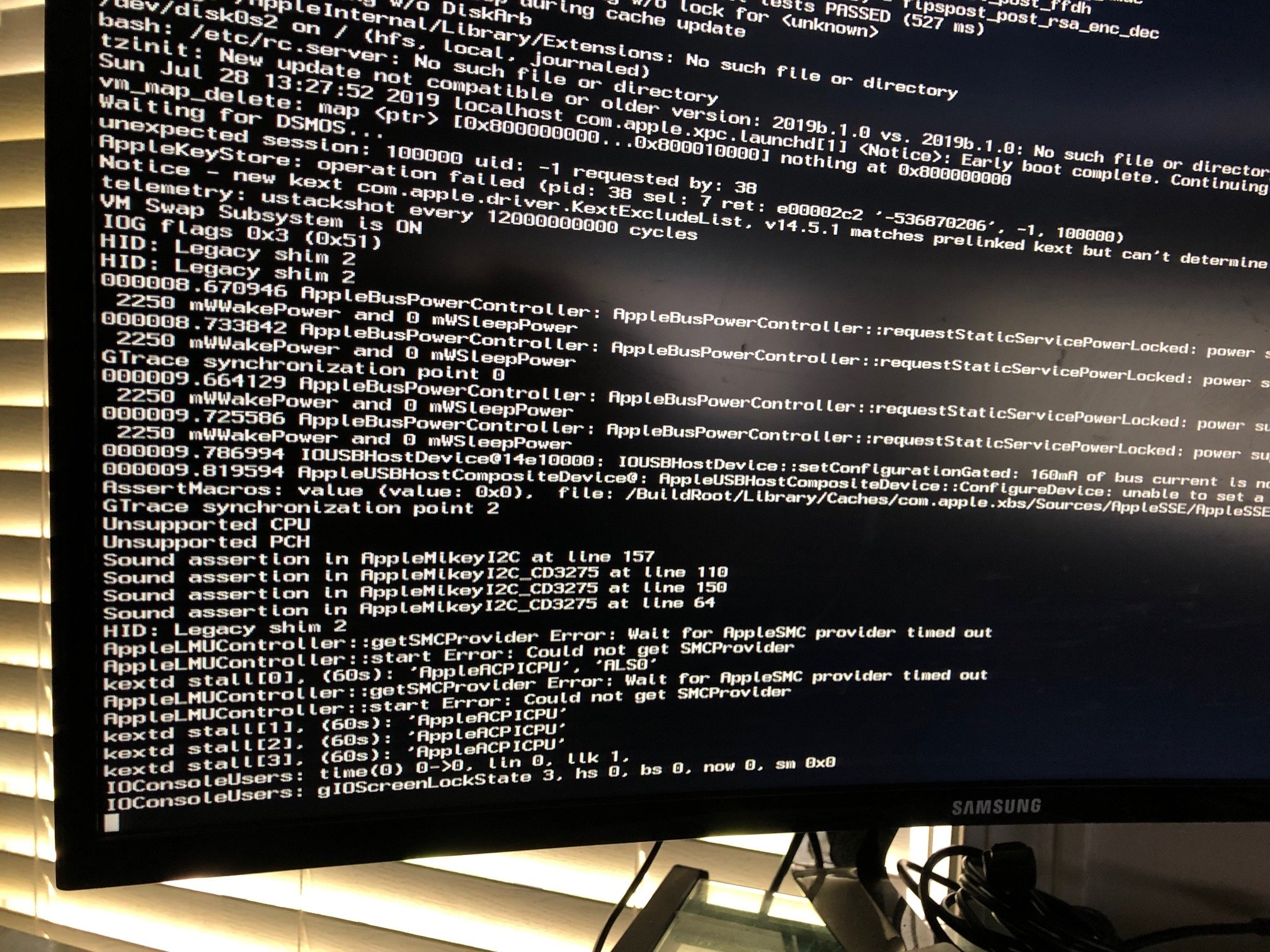

Dasoslukos Posted July 27, 2019 Share Posted July 27, 2019 On 7/25/2019 at 5:20 PM, MaLd0n said: Arquivo Comprimido.zip So I goofed, I didn't have the right chipset loaded (X99 in my case). Here is a new upload and the KP on screen reconfigured for X99. Thanks! Send me dasoss-air.den.wetdoggo.com.zip Link to comment https://www.insanelymac.com/forum/topic/331009-high-sierra-on-supermicro-x10dai-dual-xeon-e5-2690v4-dsdt/page/7/#findComment-2683156 Share on other sites More sharing options...
MaLd0n Posted July 28, 2019 Author Share Posted July 28, 2019 21 minutes ago, Dasoslukos said: So I goofed, I didn't have the right chipset loaded (X99 in my case). Here is a new upload and the KP on screen reconfigured for X99. Thanks! Send me dasoss-air.den.wetdoggo.com.zip try without "kernel to patches" patches Link to comment https://www.insanelymac.com/forum/topic/331009-high-sierra-on-supermicro-x10dai-dual-xeon-e5-2690v4-dsdt/page/7/#findComment-2683159 Share on other sites More sharing options...
Dasoslukos Posted July 28, 2019 Share Posted July 28, 2019 1 hour ago, MaLd0n said: try without "kernel to patches" patches Rodger that, little confused though. Is that clover boot option or an install option? (excuse my ignorance, first time getting back into the scene in many, many years lol) Link to comment https://www.insanelymac.com/forum/topic/331009-high-sierra-on-supermicro-x10dai-dual-xeon-e5-2690v4-dsdt/page/7/#findComment-2683164 Share on other sites More sharing options...

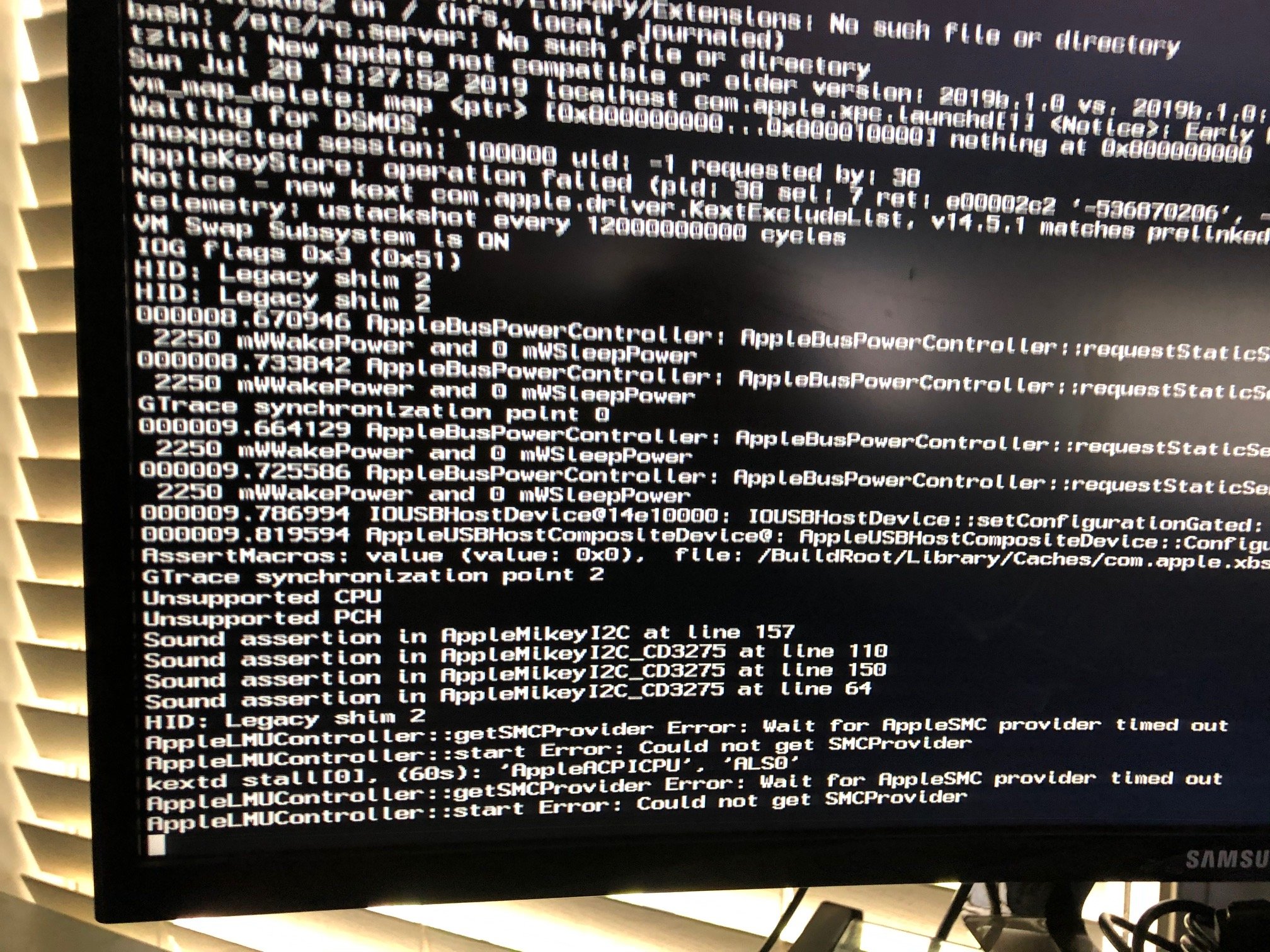

Dasoslukos Posted July 28, 2019 Share Posted July 28, 2019 17 hours ago, MaLd0n said: try without "kernel to patches" patches Okay, derp, I figured what you meant (i think at least). So I booted without injecting any kexts. The system hangs here for a while then reboots. Link to comment https://www.insanelymac.com/forum/topic/331009-high-sierra-on-supermicro-x10dai-dual-xeon-e5-2690v4-dsdt/page/7/#findComment-2683223 Share on other sites More sharing options...
MaLd0n Posted July 28, 2019 Author Share Posted July 28, 2019 1 hour ago, Dasoslukos said: Okay, derp, I figured what you meant (i think at least). So I booted without injecting any kexts. The system hangs here for a while then reboots. smc emulate is mandatory for all hacks use fakesmc or virtualsmc Link to comment https://www.insanelymac.com/forum/topic/331009-high-sierra-on-supermicro-x10dai-dual-xeon-e5-2690v4-dsdt/page/7/#findComment-2683229 Share on other sites More sharing options...
Dasoslukos Posted July 28, 2019 Share Posted July 28, 2019 24 minutes ago, MaLd0n said: smc emulate is mandatory for all hacks use fakesmc or virtualsmc Makes sense. So booting with injected kexts only with FakeSMC I get this. Link to comment https://www.insanelymac.com/forum/topic/331009-high-sierra-on-supermicro-x10dai-dual-xeon-e5-2690v4-dsdt/page/7/#findComment-2683231 Share on other sites More sharing options...

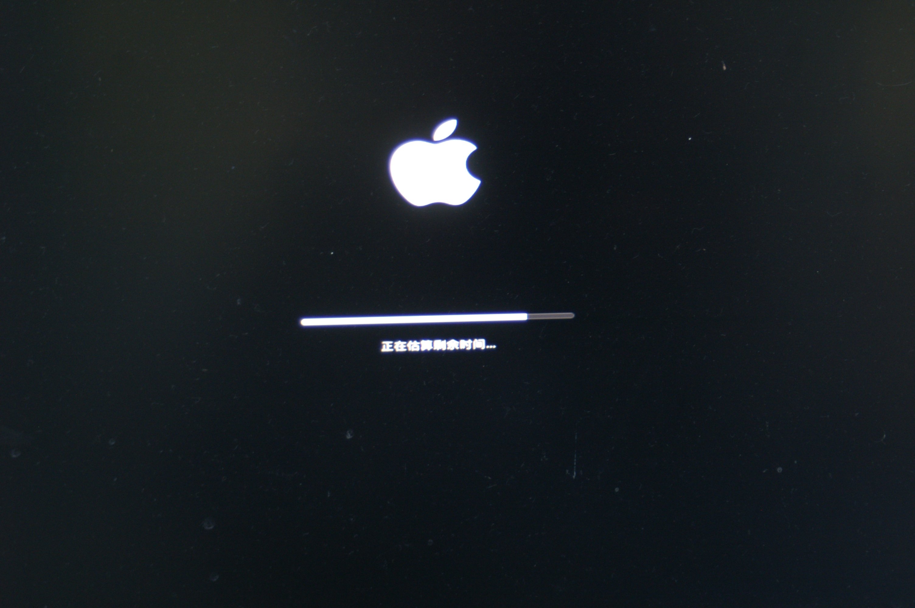

YangJsheng Posted October 2, 2019 Share Posted October 2, 2019 The last installation got stuck in the last 22 minutes in the second restart, so the installation didn’t complete. Hope I can get your help and advice on how to proceed. Please see attached photos. Thanks. Link to comment https://www.insanelymac.com/forum/topic/331009-high-sierra-on-supermicro-x10dai-dual-xeon-e5-2690v4-dsdt/page/7/#findComment-2691941 Share on other sites More sharing options...
MaLd0n Posted October 2, 2019 Author Share Posted October 2, 2019 20 hours ago, YangJsheng said: The last installation got stuck in the last 22 minutes in the second restart, so the installation didn’t complete. Hope I can get your help and advice on how to proceed. Please see attached photos. Thanks. send me ur efi folder Link to comment https://www.insanelymac.com/forum/topic/331009-high-sierra-on-supermicro-x10dai-dual-xeon-e5-2690v4-dsdt/page/7/#findComment-2692020 Share on other sites More sharing options...
