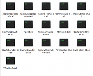

See attached:  post-1048561-0-88745700-1508647380_thumb.png

As I understand the problem is in the EFI partition and specifically in drivers64UEFI right? If thats the case I would boot with the USB installer mount EFI and backup it to the desktop, delete the EFI folder completely from the partition and install Clover again with the preferred settings, then transfer config.plist and kexts needed from the backup folder in the desktop.

This is definitely an issue with the OS and not clover! The EFI drivers are fine. I've used them for a long time. The reason this is happening is not random. I was doing maintenance and stupidly cleared the Kernel Cache with Onyx.app. Now I can't boot.
