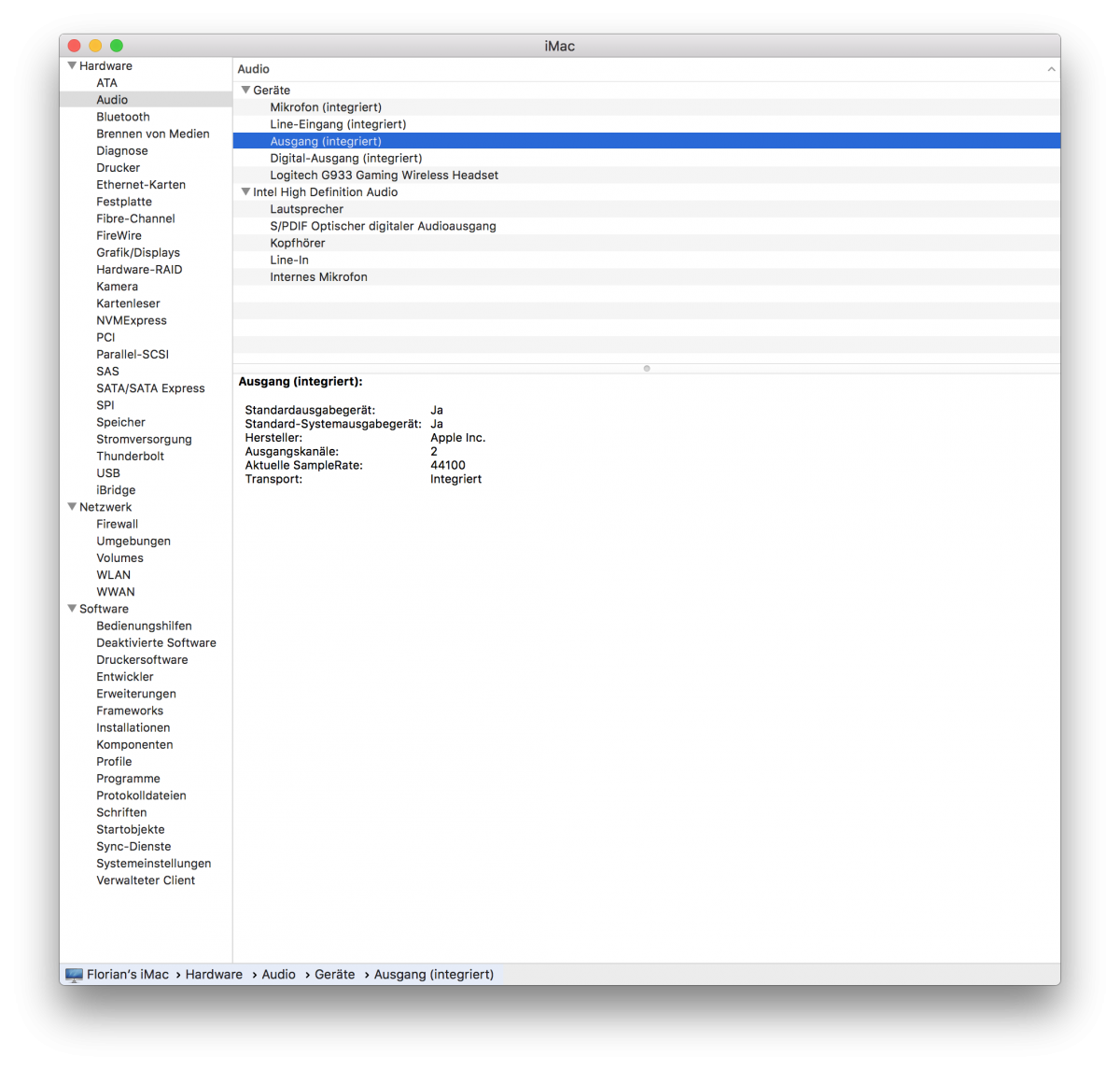

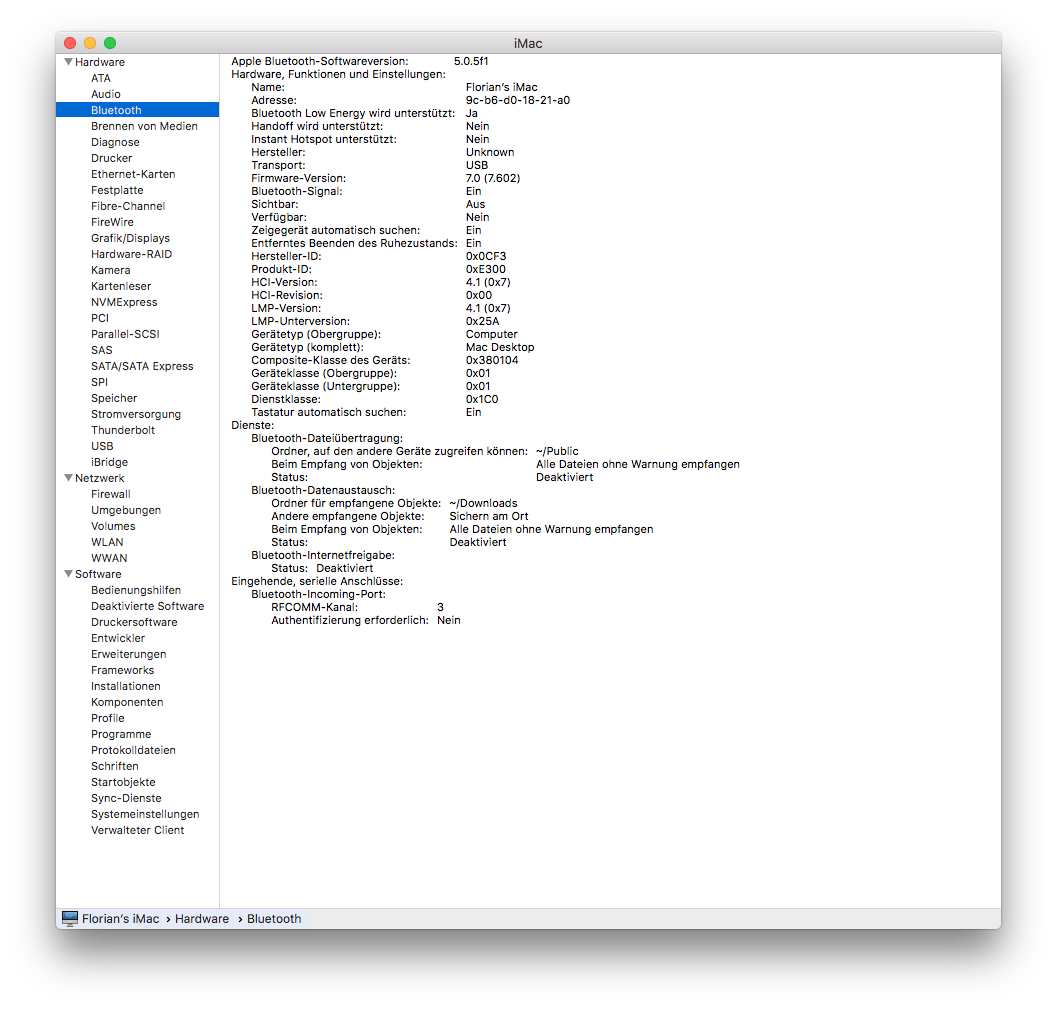

FEAM Posted September 5, 2017 Share Posted September 5, 2017 Hey Guys,I need a little bit help with my first hackintosh build. As you can see in the attached screenshots, I got a working build with the following setup: Gigabyte GA-Z270X-Gaming 8Intel i7-7700k 4,2 GHzG.Skill 64 GB RAM 3600 MHzAORUS GeForce® GTX 1080 Ti Xtreme Edition 11G2x Samsung 850 EVO 500GB SSDWD Black 2TBAfter spending the whole weekend to get it up and running I now stuck on the onboard bluetooth and sound. While configuring the setup I already read several posts about bluetooth, so I decided to buy a simple Bluetooth USB Stick to get rid of all the issues. What I have not considered is the fact that macOS ignores my USB Stick and tries to load the onboard bluetooth as you can see in the screenshot. I already tried to implement the BrcmPatchRAM and I'm sure it would work with the USB Stick, but it won't work with the onboard device. Sound is also a problem. I tried the AppleALC and the VoodoHDA, but none of them works. I haven't any output device in the settings and the VoodoHDA returned "No VoodoHDA device found".Any ideas or solutions on this?I would appreciate any kind of help. Thanks in advance.Flo Link to comment https://www.insanelymac.com/forum/topic/326840-gigabyte-ga-z270x-gaming-8-no-bluetooth-and-sound/ Share on other sites More sharing options...

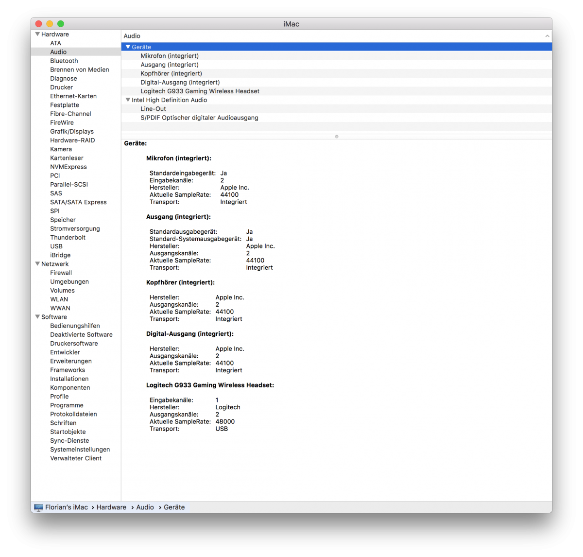

FEAM Posted September 7, 2017 Author Share Posted September 7, 2017 Hi @sab4! As you can see on the third screenshot, macOS tries to load drivers for the Gigabyte Onboard Wifi/BT chip. It's an Atheros Qualcomm QCA61x4 (0x0CF3, 0xE300). Unfortunately I couldn't find any kext or workarounds for this chip and the BIOS doesn't have an entry for disabling onboard Wifi/BT-chip. Link to comment https://www.insanelymac.com/forum/topic/326840-gigabyte-ga-z270x-gaming-8-no-bluetooth-and-sound/#findComment-2490917 Share on other sites More sharing options...

al6042 Posted September 7, 2017 Share Posted September 7, 2017 Hi @FEAM For Audio: Try to use the combination of AppleALC., Lilu.kext and the following settings in your config.plist: "Acpi"->"DSDT"->"Fixes"->"FixHDA_8000" "Devices"->"Audio"->"Inject"-> enter "1" (without quotes) directly into the selection field. Make sure no residue of other Audio-related Kexts are still running on your box. That would be any other patched AppleHDA (you must use the original one), realtekALC, cloverALC, VoodooHDA together with their HDAdisabler or any On-the-Fly-Patches in Clover. Also make sure there is no HDAEnabler.kext running, which would interfere with the "FixHDA_8000" entry. You might check this within "Systembericht"->"Software"->"Erweiterungen". Wait until the list is completed. Then click on the column "Erhalten von" two times, so the sort order starts with "Verifizierte Entwickler". Within "Verifizierte Entwickler" and "Apple" you might find a couple of kexts which are marked as "Unbekannt" or "Nicht Signiert"... If those are related to audio, get rid of them. Link to comment https://www.insanelymac.com/forum/topic/326840-gigabyte-ga-z270x-gaming-8-no-bluetooth-and-sound/#findComment-2490932 Share on other sites More sharing options...

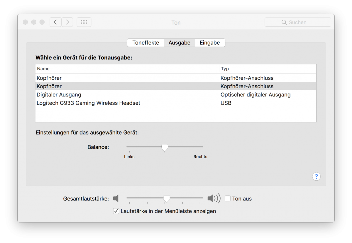

FEAM Posted September 7, 2017 Author Share Posted September 7, 2017 Hi @al6042 After checking the running extensions (AppleALC 1.1.4 and Lilu 1.1.6 already there, AppleHDA original) I changed the Clover configuration and restarted the system. Now I have several devices listed on the audio tab, but sill no sound. Link to comment https://www.insanelymac.com/forum/topic/326840-gigabyte-ga-z270x-gaming-8-no-bluetooth-and-sound/#findComment-2490950 Share on other sites More sharing options...
al6042 Posted September 7, 2017 Share Posted September 7, 2017 Then try "Devices"->"Audio"->"Inject"->"2" instead of "1". Link to comment https://www.insanelymac.com/forum/topic/326840-gigabyte-ga-z270x-gaming-8-no-bluetooth-and-sound/#findComment-2490952 Share on other sites More sharing options...
FEAM Posted September 7, 2017 Author Share Posted September 7, 2017 Then try "Devices"->"Audio"->"Inject"->"2" instead of "1". The devices changed, but still ... no sound. Link to comment https://www.insanelymac.com/forum/topic/326840-gigabyte-ga-z270x-gaming-8-no-bluetooth-and-sound/#findComment-2490953 Share on other sites More sharing options...

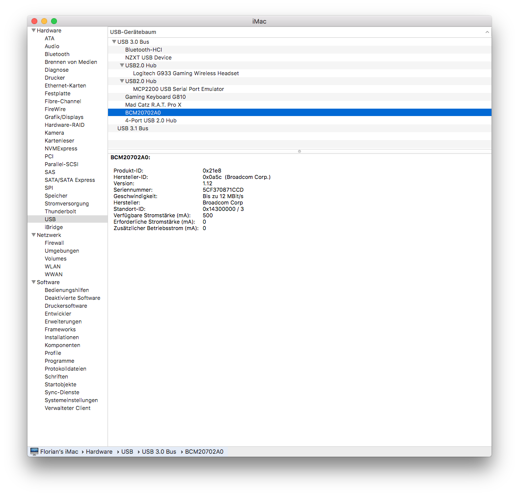

FEAM Posted September 8, 2017 Author Share Posted September 8, 2017 Thanks guys. I will have a look at the weekend if anything works. @sab4: Both kexts are installed and running, but these two kexts support more Broadcom devices than any other one. I installed them for the USB dongle. But macOS ignores the dongle as long as the onboard device is enabled. I found a post about "Bluetooth Firmware Updater" with many Qualcomm Atheros devices but the onboard chip seems not to be supported again. Link to comment https://www.insanelymac.com/forum/topic/326840-gigabyte-ga-z270x-gaming-8-no-bluetooth-and-sound/#findComment-2491324 Share on other sites More sharing options...
