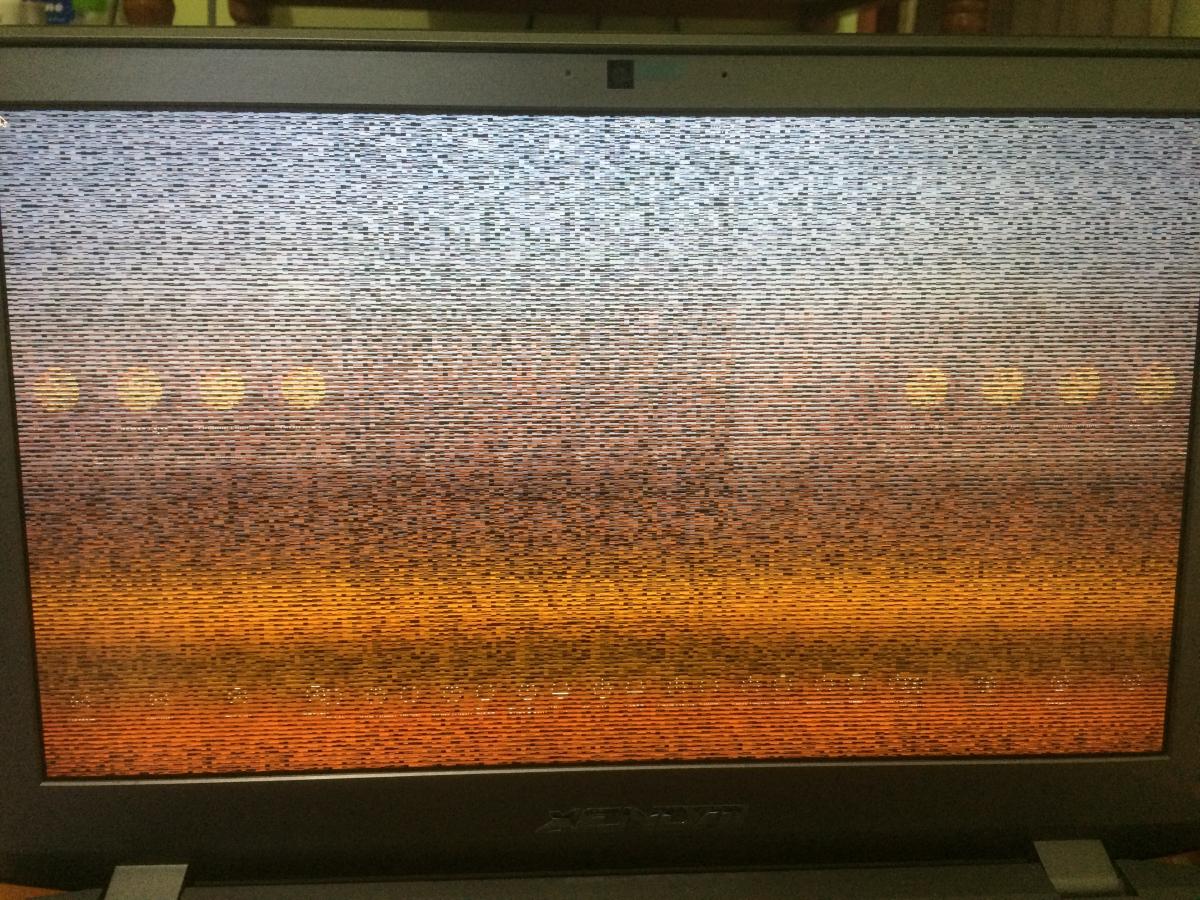

momodding Posted July 25, 2017 Share Posted July 25, 2017 Hello everyone, i want to ask. Why every boot and get in on my laptop home screen has grable or screen crash like this. But the screen will return to normal after sleep and the cursor will getting lag for a moment Here are the specifications of my laptop: Core i5 4200m Intel hd 4600Nvidia gtx765m(disable ssdt)Screen Resolution1920x1080Audio via vt1082Clover r4110Bootargs: -vKext : Fakesmc, FakePCIID, AppleBacklightInjektor, voodooPS2, applealc, lilu Update 29-10-2017: Fixed screen proble - if you using UEFI boot, enable CSM option. Then change option in "Launch Video OpROM" into legacy only - place CsmVideoDxe.efi in Driver64UEFI for better clover resolution 2 Link to comment https://www.insanelymac.com/forum/topic/325601-intelhd-4600-screen-problem/ Share on other sites More sharing options...

Gigamaxx Posted July 26, 2017 Share Posted July 26, 2017 Hello everyone, i want to ask. Why every boot and get in on my laptop home screen has grable or screen crash like this. But the screen will return to normal after sleep and the cursor will getting lag for a moment Here are the specifications of my laptop: Core i5 4200m Intel hd 4600 Nvidia gtx765m(disable ssdt) Screen Resolution1920x1080 Audio via vt1082 Clover r4110 Bootargs: -v Kext : Fakesmc, FakePCIID, AppleBacklightInjektor, voodooPS2, applealc, lilu Did you try pulling the lilu kext? I use it for my Skylake and Kaby Lake builds but not for my Haswell pentium build. Pentium = Inject Intel, fake Id 0x04128086, or 0x04168086, ig platform ID 0x0d220003. If you download the latest clover configurator app it has many ig platforms to try out just hit the cursor arrow on the side of the window for Ig platform. I've used a few of these and got various results including that screen blizzard. You might just need a different ig config. Link to comment https://www.insanelymac.com/forum/topic/325601-intelhd-4600-screen-problem/#findComment-2469700 Share on other sites More sharing options...
momodding Posted July 27, 2017 Author Share Posted July 27, 2017 @momodding, can you post a zipped copy of your Clover EFI folder? @pianoguy, the DualLink parameter only applies to laptops... You should create your own thread rather than use this one. thanks for your attention @Herve here is my clover folder Other kext i store inside fakesmc.kext as plugins CLOVER.zip Link to comment https://www.insanelymac.com/forum/topic/325601-intelhd-4600-screen-problem/#findComment-2469793 Share on other sites More sharing options...
momodding Posted July 27, 2017 Author Share Posted July 27, 2017 Did you try pulling the lilu kext? I use it for my Skylake and Kaby Lake builds but not for my Haswell pentium build. Pentium = Inject Intel, fake Id 0x04128086, or 0x04168086, ig platform ID 0x0d220003. If you download the latest clover configurator app it has many ig platforms to try out just hit the cursor arrow on the side of the window for Ig platform. I've used a few of these and got various results including that screen blizzard. You might just need a different ig config. yes. i already pulling lilu. still getting glitches. i inject ig platform and fake pciid inside ssdt. all kext, config.plist, acpi already tested and being used for elcapitan Link to comment https://www.insanelymac.com/forum/topic/325601-intelhd-4600-screen-problem/#findComment-2469817 Share on other sites More sharing options...
momodding Posted July 27, 2017 Author Share Posted July 27, 2017 'had a look at your Clover with Clover Configurator app. Here are my comments: ACPI section: You've specified a list of SST tables going from -1 to -9 whereas you don't have a -4 and -5 in your file set. This is an anomaly to me. If the files aren't missing, you should remove the references to them in the Clover list. CPU section: Turbo is disabled. Is this wanted? Devices: It does not do any harm but you fake HD4600 desktop id 0412 yet you've already injected this in SSDT for IGPU. Graphics section: I think this is where you went wrong: you've ticked "Inject EDID", specified a custom one, ticked "Inject Intel" and specified Azul FB #12. DualLink parameter is not set. It does not do any harm but here again you've already injected Intel and the required frame buffer in SSDT for IGPU... Kext & Patches section: Remove Kernel lapic and Asus AICPUPM; former would only be required if you got a Lapic KP (like HP laptops often experience) and the latter is only for Sandy/Ivy Bridge systems. Action: to begin with, I would advise you remove your custom EDID, tick off Inject EDID and simply set DualLink to 1. This could then be added to your SSDT for IGPU as an extra parameter to the Device (IGPU) section: "AAPL00,DualLink", Buffer () { 0x01, 0x00, 0x00, 0x00 } Or try the attached revised Clover config. config.plist.zip I've revised it. But the problem still exists when i remove acpi patched and use clover acpi patch the problem has gone i think my ssdt or dsdt make this problem. but it work fine in el capitan 1 Link to comment https://www.insanelymac.com/forum/topic/325601-intelhd-4600-screen-problem/#findComment-2469868 Share on other sites More sharing options...

zacharyrs Posted October 1, 2017 Share Posted October 1, 2017 Hiya all, I have this issue too, on my laptop, as you can see here. As with @momodding it goes away after a sleep/wake cycle, however after this, the screen occasionally flickers. My clover folder can be seen here, with sensitive details removed. My clover config is all via hotpatching, the source for which is in the ACPI patched folder along with the compiled files. I am injecting IntelGFX=0x04128086, and ig-platform-id=0x0a260006. All kexts are injected via Clover currently (albeit CodecCommander, BrcmPatchRam2, and BrcmFirmwareRepo, which are in /L/E). I did previously try with my kexts in /S/L/E. If you have any other questions feel free to ask, I'm currently stuck so any help is great. Link to comment https://www.insanelymac.com/forum/topic/325601-intelhd-4600-screen-problem/#findComment-2505799 Share on other sites More sharing options...
momodding Posted October 1, 2017 Author Share Posted October 1, 2017 Hiya all, I have this issue too, on my laptop, as you can see here. As with @momodding it goes away after a sleep/wake cycle, however after this, the screen occasionally flickers. My clover folder can be seen here, with sensitive details removed. My clover config is all via hotpatching, the source for which is in the ACPI patched folder along with the compiled files. I am injecting IntelGFX=0x04128086, and ig-platform-id=0x0a260006. All kexts are injected via Clover currently (albeit CodecCommander, BrcmPatchRam2, and BrcmFirmwareRepo, which are in /L/E). I did previously try with my kexts in /S/L/E. If you have any other questions feel free to ask, I'm currently stuck so any help is great. is your hdmi port working? Link to comment https://www.insanelymac.com/forum/topic/325601-intelhd-4600-screen-problem/#findComment-2505812 Share on other sites More sharing options...

bronxteck Posted October 1, 2017 Share Posted October 1, 2017 I have the login screen issue where I have to sleep then wake the machine. the solution for me was to reduce my resolution from "1920 x1080" to "1600 x 900" Link to comment https://www.insanelymac.com/forum/topic/325601-intelhd-4600-screen-problem/#findComment-2506342 Share on other sites More sharing options...
zacharyrs Posted October 1, 2017 Share Posted October 1, 2017 I have the login screen issue where I have to sleep then wake the machine. the solution for me was to reduce my resolution from "1920 x1080" to "1600 x 900" Do you mean in Clover, or the actual macOS settings? Link to comment https://www.insanelymac.com/forum/topic/325601-intelhd-4600-screen-problem/#findComment-2506622 Share on other sites More sharing options...
bronxteck Posted October 1, 2017 Share Posted October 1, 2017 actual Mac OS display prefpane Link to comment https://www.insanelymac.com/forum/topic/325601-intelhd-4600-screen-problem/#findComment-2506655 Share on other sites More sharing options...
zacharyrs Posted October 1, 2017 Share Posted October 1, 2017 actual Mac OS display prefpane Unfortunately I need the full 1080p. Setting resolution in clover to 1024x768 does fix the boot glitch though, just not the flickering. Link to comment https://www.insanelymac.com/forum/topic/325601-intelhd-4600-screen-problem/#findComment-2506660 Share on other sites More sharing options...

zacharyrs Posted October 6, 2017 Share Posted October 6, 2017 (edited) Hiya all, Finally got a fix! Ended up swapping to inject ig-platform-id=0x04260000, which has solved all my graphics issues including flickering. HDMI works, except for audio, which I'll work on eventually. I had to set Clover to 1024x768 in order to solve the graphics glitch though. EDIT: Got HDMI audio working by injecting a custom HDEF and HDAU SSDT. Very distorted, but that might just be the HDMI -> VGA adaptor. Edited October 6, 2017 by zacharyrs Link to comment https://www.insanelymac.com/forum/topic/325601-intelhd-4600-screen-problem/#findComment-2509480 Share on other sites More sharing options...

momodding Posted October 7, 2017 Author Share Posted October 7, 2017 Hiya all, Finally got a fix! Ended up swapping to inject ig-platform-id=0x04260000, which has solved all my graphics issues including flickering. HDMI works, except for audio, which I'll work on eventually. I had to set Clover to 1024x768 in order to solve the graphics glitch though. EDIT: Got HDMI audio working by injecting a custom HDEF and HDAU SSDT. Very distorted, but that might just be the HDMI -> VGA adaptor. change ig-platform-id=0x04260000 make my screen blinking Link to comment https://www.insanelymac.com/forum/topic/325601-intelhd-4600-screen-problem/#findComment-2511077 Share on other sites More sharing options...
momodding Posted October 29, 2017 Author Share Posted October 29, 2017 Update 29-10-2017: Fixed screen proble - if you using UEFI boot, enable CSM option. Then change option in "Launch Video OpROM" into legacy only - place CsmVideoDxe.efi in Driver64UEFI for better clover resolution Link to comment https://www.insanelymac.com/forum/topic/325601-intelhd-4600-screen-problem/#findComment-2524382 Share on other sites More sharing options...
