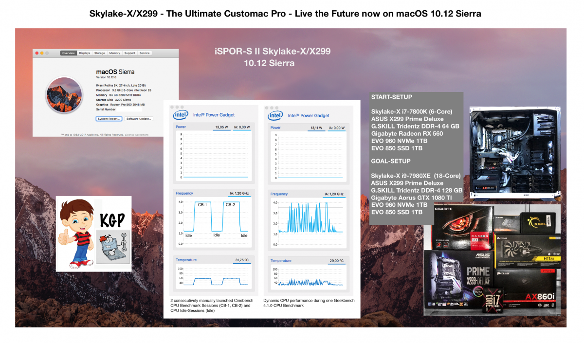

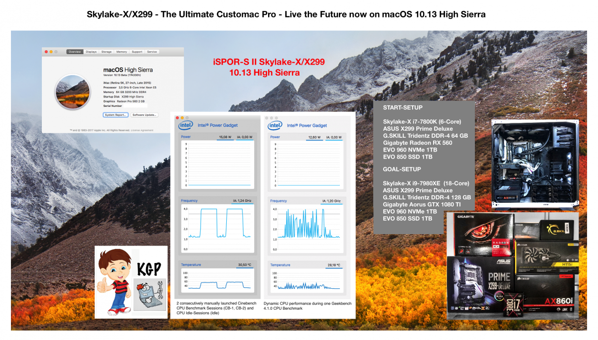

kgp Posted August 18, 2017 Share Posted August 18, 2017 First version of my Skylake-X/X299 macOS Sierra 10.12 and macOS High Sierra 10.13 Desktop Guides released in the forum I am not allowed to mention Many thanks to @DSM2 and @PMHeart for their estimated contributions! 2 Link to comment https://www.insanelymac.com/forum/topic/324857-skylake-x-testing-i7-7800x-i7-7820x-i9-7900x/page/5/#findComment-2481208 Share on other sites More sharing options...

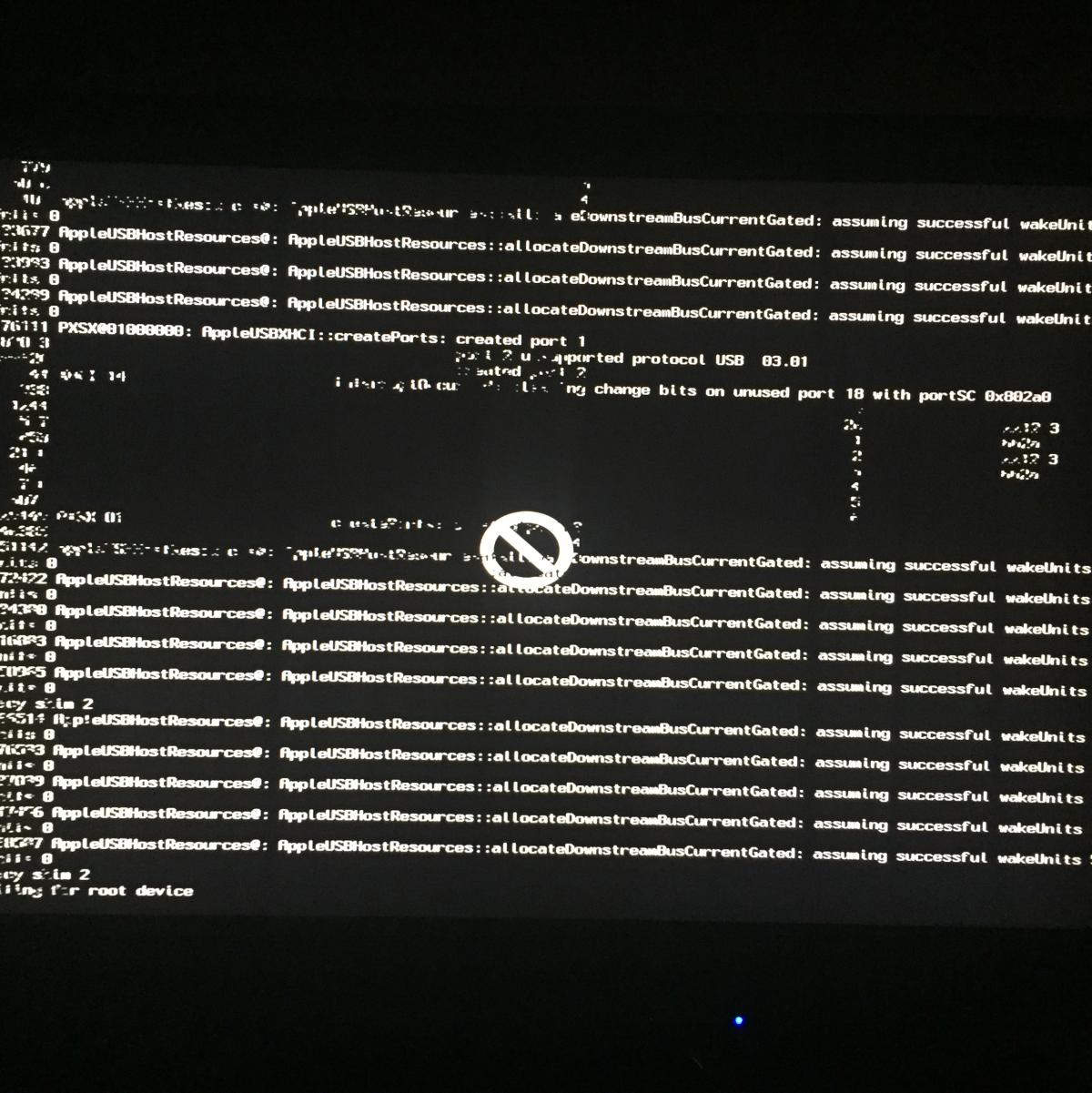

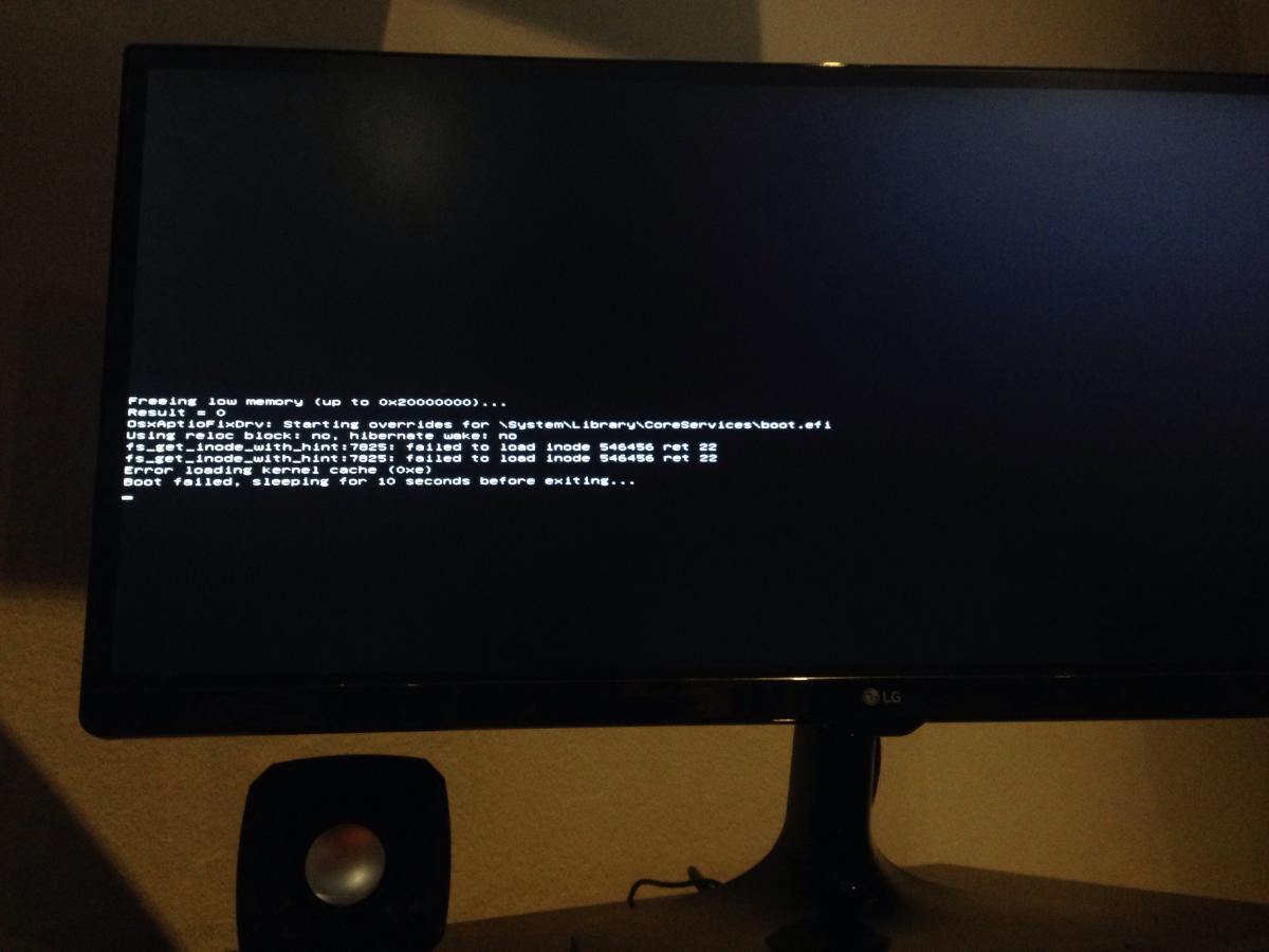

Quadro78 Posted August 20, 2017 Share Posted August 20, 2017 hi Quadro78,where are you stuck?I have problems with acpi and the alc1220 sound, no working, the rest normal working.. Its to hard lavel for me. Please find my screenshots Link to comment https://www.insanelymac.com/forum/topic/324857-skylake-x-testing-i7-7800x-i7-7820x-i9-7900x/page/5/#findComment-2482298 Share on other sites More sharing options...
MAGSP27 Posted August 20, 2017 Share Posted August 20, 2017 hi quadro78,i have the same issue, I resolve it by installing from hard disk...it,s a usb installer? Link to comment https://www.insanelymac.com/forum/topic/324857-skylake-x-testing-i7-7800x-i7-7820x-i9-7900x/page/5/#findComment-2482301 Share on other sites More sharing options...
Ritz Carltn Posted August 20, 2017 Share Posted August 20, 2017 It seems to be USB issue. You should be change USB port. Its to hard lavel for me. Please find my screenshots IMG_5414.JPG IMG_5413.JPG 2 Link to comment https://www.insanelymac.com/forum/topic/324857-skylake-x-testing-i7-7800x-i7-7820x-i9-7900x/page/5/#findComment-2482304 Share on other sites More sharing options...
Quadro78 Posted August 20, 2017 Share Posted August 20, 2017 Great!!!!It's working with back USB connectors.Thx guys a lot!But...1. System recognizes 3,6 E-5 xeon not 7820x2. Incompatible nvidia web drivers.3. Audio drivers not work (realtekALC.kext) Can you guys install nvidia and Realtek ALC1220 correctly? 1 Link to comment https://www.insanelymac.com/forum/topic/324857-skylake-x-testing-i7-7800x-i7-7820x-i9-7900x/page/5/#findComment-2482307 Share on other sites More sharing options...
