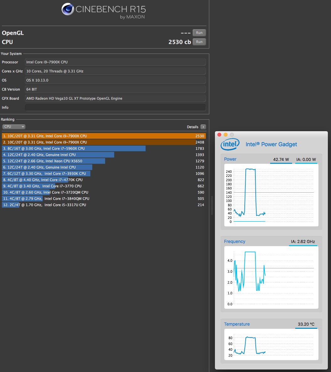

Menno Posted August 7, 2017 Share Posted August 7, 2017 Hi Menno, The vega card went in without a hitch - oob, and is running on 10.13 beta latest, but you're right. The The X299 and i9 is fine, but the vega is slowish. About 95 on cinebench 15 - half as fast as my R9 390x. Cinebench on windows is better, but still only as fast as the 390x and a bit slower than my old Nano. The biggest issue is the CPU running at max and averaging 150 watts on 4.5GHz (60 deg under water). I've run out of time for now and need to design Do you have multicore enhancement enabled in the bios? Then it auto overclocks to 4.5GHz. Mine is running on stock 4.0GHz. I need to much voltage for 4.5GHz. This thing is almost cooking here at 1.15v - 1.2v (95c). It's a standard AIO (Kraken X62). Also you don't need an FakeCPU ID for high Sierra, but it does not make much difference. What's your Geekbench score in 10.13? It's seems that the drivers for Vega in 10.13 are very immature and my CPU scores in Geekbench are also lower. Link to comment https://www.insanelymac.com/forum/topic/324857-skylake-x-testing-i7-7800x-i7-7820x-i9-7900x/page/3/#findComment-2475449 Share on other sites More sharing options...
surfinchina Posted August 7, 2017 Share Posted August 7, 2017 Do you have multicore enhancement enabled in the bios? Then it auto overclocks to 4.5GHz. Mine is running on stock 4.0GHz. I need to much voltage for 4.5GHz. This thing is almost cooking here at 1.15v - 1.2v (95c). It's a standard AIO (Kraken X62). Also you don't need an FakeCPU ID for high Sierra, but it does not make much difference. What's your Geekbench score in 10.13? It's seems that the drivers for Vega in 10.13 are very immature and my CPU scores in Geekbench are also lower. Geekbench on the GPU crashes, as do pretty well all the GPU benchmarks at the moment. Cinebench came up with 80 on the GPU lol. My R9 390x was 200, as was the R9 Nano so it's a backward step there at the moment. I've left the bios stuff completely stock, so yes it is enabled. I'm just reading up on it on overclock net to figure out how to keep the power down for now, until the speedstep gets sorted. Probably I can run 4.5, just not on auto volts. I've got a 420 rad right now and have another 360 on order I think I'll set volts at 1.1 and see how many multipliers I can get out of it. There's some sort of new-fangled turbo mode? I think that can be cut down a bit or disabled... Link to comment https://www.insanelymac.com/forum/topic/324857-skylake-x-testing-i7-7800x-i7-7820x-i9-7900x/page/3/#findComment-2475455 Share on other sites More sharing options...

Menno Posted August 7, 2017 Share Posted August 7, 2017 I feel like if you're at 95c and not OCing in Prime95 you probably have a problem w/ how your cooler is installed. Not normal! 1.2v is nothing. It spikes to 95c at 1.2v in windows with occt. Cooler is seated correctly. Stock (1.07v in bios) gets 65-75c over the cores with occt. Link to comment https://www.insanelymac.com/forum/topic/324857-skylake-x-testing-i7-7800x-i7-7820x-i9-7900x/page/3/#findComment-2475611 Share on other sites More sharing options...
maleorderbride Posted August 7, 2017 Share Posted August 7, 2017 I feel like if you're at 95c and not OCing in Prime95 you probably have a problem w/ how your cooler is installed. Not normal! 1.2v is nothing. Read the Tom's hardware review (or anyone but AnandTech's) and you'll see the i9's are actually miniture space heaters that happen to have some compute capabilities. Tom's had to switch to a liquid loop in order to not see their i9-7900X throttle at stock voltage, but even a custom loop was seeing throttling when overclocked. http://www.tomshardware.com/reviews/intel-core-i9-7900x-skylake-x,5092-11.html And Menno, you probably should go -4 or -5 on the AVX downclock. Link to comment https://www.insanelymac.com/forum/topic/324857-skylake-x-testing-i7-7800x-i7-7820x-i9-7900x/page/3/#findComment-2475700 Share on other sites More sharing options...

mr. west Posted August 8, 2017 Share Posted August 8, 2017 Read the Tom's hardware review (or anyone but AnandTech's) and you'll see the i9's are actually miniture space heaters that happen to have some compute capabilities. Tom's had to switch to a liquid loop in order to not see their i9-7900X throttle at stock voltage, but even a custom loop was seeing throttling when overclocked. http://www.tomshardware.com/reviews/intel-core-i9-7900x-skylake-x,5092-11.html And Menno, you probably should go -4 or -5 on the AVX downclock. Scary! Actually a pretty big turn off, especially to learn it's just because of a minor cost-savings from Intel. Link to comment https://www.insanelymac.com/forum/topic/324857-skylake-x-testing-i7-7800x-i7-7820x-i9-7900x/page/3/#findComment-2476373 Share on other sites More sharing options...
surfinchina Posted August 8, 2017 Share Posted August 8, 2017 Scary! Actually a pretty big turn off, especially to learn it's just because of a minor cost-savings from Intel. Not really. 10 cores at 4.5 is always going to crank out the heat. Anyone buying these has really got to think about 380 radiator space minimum. As for the cost savings, I agree! Although I did pay less for the 10 core 7900x than I did for my 8 core 5960x a few years ago. If it's too bad I guess I'll delid. Hoping I can get the speedstep going soon - Brumbaer is onto it even though he's short of a computer right now and just theorising. Link to comment https://www.insanelymac.com/forum/topic/324857-skylake-x-testing-i7-7800x-i7-7820x-i9-7900x/page/3/#findComment-2476426 Share on other sites More sharing options...
Menno Posted August 9, 2017 Share Posted August 9, 2017 Not really. 10 cores at 4.5 is always going to crank out the heat. Anyone buying these has really got to think about 380 radiator space minimum. As for the cost savings, I agree! Although I did pay less for the 10 core 7900x than I did for my 8 core 5960x a few years ago. If it's too bad I guess I'll delid. Hoping I can get the speedstep going soon - Brumbaer is onto it even though he's short of a computer right now and just theorising. Try and remove (or disable at boot) the _xcpm_bootstrap patch? 1 Link to comment https://www.insanelymac.com/forum/topic/324857-skylake-x-testing-i7-7800x-i7-7820x-i9-7900x/page/3/#findComment-2476579 Share on other sites More sharing options...

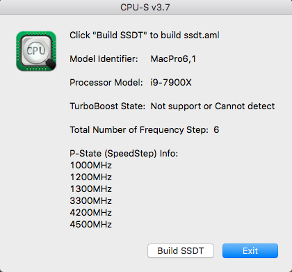

Menno Posted August 10, 2017 Share Posted August 10, 2017 ciao fabiosun I did what you suggested and actually removed all of the kernel and kext patches. As a result now I have full speedstep, my USBs still all work but my sound is no good - I use a USB DAC anyway so don't need the sound. HDMI sound is working without patches. Thanks!!! :-) Screenshot 2017-08-10 16.48.48.png edit: I've just been playing with an overclock. You know, this platform is amazing!!! No kext or kernel patches, no ssdt or dsdt, just npci 2000 and pretty well only fakesmc in clover. About as close to a true Apple as I've ever been really, but faster Screenshot 2017-08-10 21.40.15.png Good work! Do you have sleep/wake? I don't. It goes to sleep now but if I wake it it just reboots. Oh well. It's a workstation, not a laptop lol. I can wait a few min for boot. Link to comment https://www.insanelymac.com/forum/topic/324857-skylake-x-testing-i7-7800x-i7-7820x-i9-7900x/page/3/#findComment-2477314 Share on other sites More sharing options...
