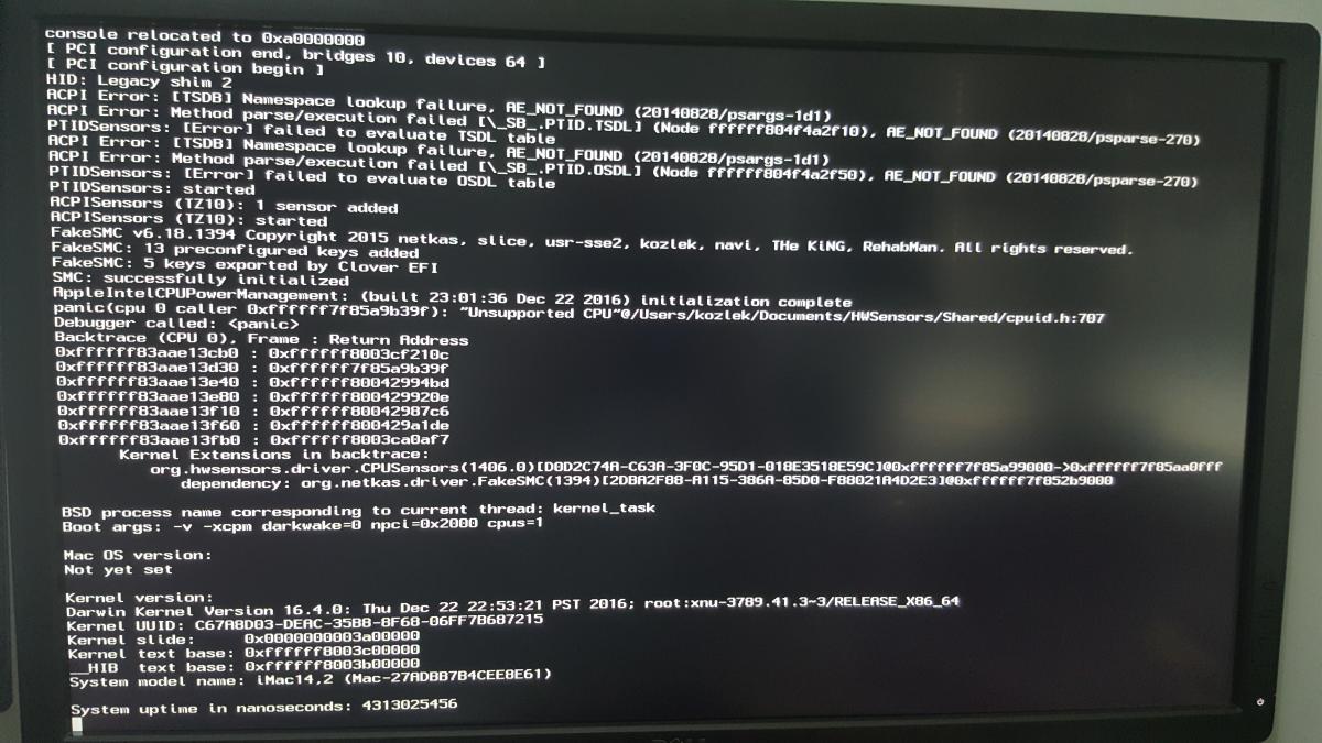

surfinchina Posted August 5, 2017 Share Posted August 5, 2017 I'm slowly working through stuff. Got it from stuck on pluses to a kp The stuck on pluses was just old caches in my install. The kp has moved along a bit, I had to get rid of some kexts and various patches. Possibly this one is hwmonitor? I attach the screen dump and would appreciate some advice! i9 7900x, Ga Aorus 9. 1 Link to comment https://www.insanelymac.com/forum/topic/324857-skylake-x-testing-i7-7800x-i7-7820x-i9-7900x/page/2/#findComment-2474777 Share on other sites More sharing options...
maleorderbride Posted August 5, 2017 Share Posted August 5, 2017 Yes, you need to delete all of the sensors in your Plugins folder in FakeSMC. 1 Link to comment https://www.insanelymac.com/forum/topic/324857-skylake-x-testing-i7-7800x-i7-7820x-i9-7900x/page/2/#findComment-2474818 Share on other sites More sharing options...
surfinchina Posted August 5, 2017 Share Posted August 5, 2017 Yes, you need to delete all of the sensors in your Plugins folder in FakeSMC. Yes indeed. Thanks maleorderbride. Worked that out just before you posted haha. Now I've just got a reboot way further along the boot process. I'll try to get a pic of it before it disappears. Along the way I figured cpus=1 is not a good idea. This is always quite fun Nice way to spend a Sunday. Oh, btw, My radeon vega isn't arriving until Tuesday, so I've got until then to work out how to get this going in Sierra, then how to get it going in HS. Link to comment https://www.insanelymac.com/forum/topic/324857-skylake-x-testing-i7-7800x-i7-7820x-i9-7900x/page/2/#findComment-2474828 Share on other sites More sharing options...
Sherlocks Posted August 5, 2017 Share Posted August 5, 2017 Yes indeed. Thanks maleorderbride. Worked that out just before you posted haha. Now I've just got a reboot way further along the boot process. I'll try to get a pic of it before it disappears. Along the way I figured cpus=1 is not a good idea. This is always quite fun Nice way to spend a Sunday. Oh, btw, My radeon vega isn't arriving until Tuesday, so I've got until then to work out how to get this going in Sierra, then how to get it going in HS. If you need only cpus=1, remove cpus=1 on bootarg. And check Kernel LAPIC patch on KernelAndKextsPatches in config.plist. i am not sure but its simliar issue on HP laptop. 나의 LG-F800S 의 Tapatalk에서 보냄 Link to comment https://www.insanelymac.com/forum/topic/324857-skylake-x-testing-i7-7800x-i7-7820x-i9-7900x/page/2/#findComment-2474831 Share on other sites More sharing options...
surfinchina Posted August 5, 2017 Share Posted August 5, 2017 If you need only cpus=1, remove cpus=1 on bootarg. And check Kernel LAPIC patch on KernelAndKextsPatches in config.plist. i am not sure but its simliar issue on HP laptop. 나의 LG-F800S 의 Tapatalk에서 보냄 I don't think I need cpus=1, I just had a go on account of the cpu being unsupported. It worked once for my xeon to get it going. I tried lapic patch but no change... This is the latest screenshot. it's nearer the end of the boot sequence and usb stuff etc has loaded. Thanks for your work! I realise that only NZ is awake usually at this time... Link to comment https://www.insanelymac.com/forum/topic/324857-skylake-x-testing-i7-7800x-i7-7820x-i9-7900x/page/2/#findComment-2474842 Share on other sites More sharing options...

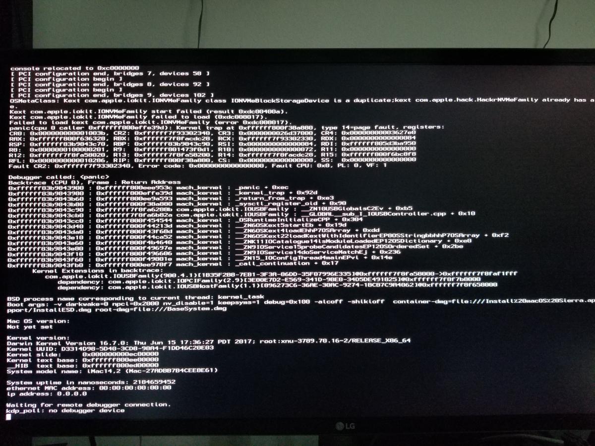

samaelestevez Posted August 6, 2017 Share Posted August 6, 2017 Got it Screenshot 2017-08-06 13.59.18.png How did you get past your last error? I'm stuck in the same place. Link to comment https://www.insanelymac.com/forum/topic/324857-skylake-x-testing-i7-7800x-i7-7820x-i9-7900x/page/2/#findComment-2474906 Share on other sites More sharing options...
surfinchina Posted August 6, 2017 Share Posted August 6, 2017 How did you get past your last error? I'm stuck in the same place. I don't know! The only thing I did differently was to accidentally boot from the NVME instead of the USB HD. I'll try to figure it out and let you know. My EFI is really messy now, but I'll attach it anyway. Some kexts and patches needed to be disabled or removed from my X99 install. edit: So, I'm not clever with this sort of stuff (just persistent), so if some kind and clever person can take a look at the IO reg, the send me and clover attachments and help me figure out how to get X299 working on High Sierra I'd be very happy!!! This is because I have the Radeon Vega turning up next week, which will only work on HS... Thanks in advance CLOVER.zip Send me pete’s Mac Pro.zip pete’s Mac Pro.zip 1 Link to comment https://www.insanelymac.com/forum/topic/324857-skylake-x-testing-i7-7800x-i7-7820x-i9-7900x/page/2/#findComment-2474914 Share on other sites More sharing options...

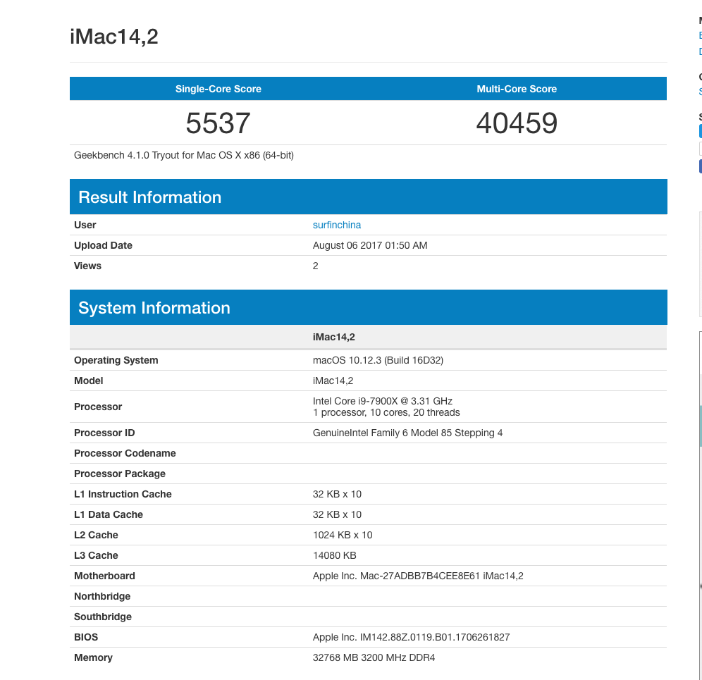

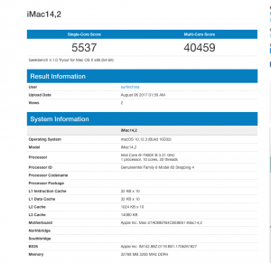

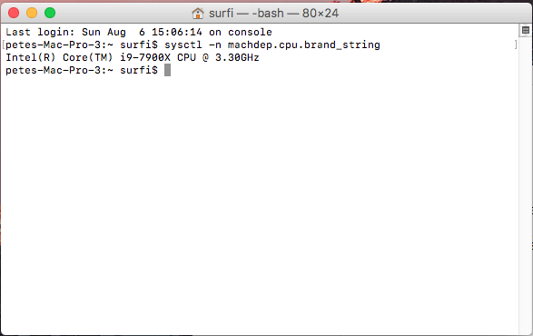

surfinchina Posted August 6, 2017 Share Posted August 6, 2017 I7 problem, apple not release i9 processor mac series. At least best one is i7. Or xenon. In autumn, we can expect to use i9. If you can take a kernel panic pic, upload here. EDIT i will find cputype. Maybe has big chance that has i9 info on 10.13 나의 LG-F800S 의 Tapatalk에서 보냄 Hi Sherlocks, How do I find out if the i9 is being supported? Attached is a snapshot in Sierra which seems to recognise it? Link to comment https://www.insanelymac.com/forum/topic/324857-skylake-x-testing-i7-7800x-i7-7820x-i9-7900x/page/2/#findComment-2474947 Share on other sites More sharing options...
Sherlocks Posted August 6, 2017 Share Posted August 6, 2017 Hi Sherlocks, How do I find out if the i9 is being supported? Attached is a snapshot in Sierra which seems to recognise it? Screenshot 2017-08-06 15.49.41.png Its no problem. What is your cpu info on system identifier? 나의 LG-F800S 의 Tapatalk에서 보냄 Link to comment https://www.insanelymac.com/forum/topic/324857-skylake-x-testing-i7-7800x-i7-7820x-i9-7900x/page/2/#findComment-2474951 Share on other sites More sharing options...
surfinchina Posted August 6, 2017 Share Posted August 6, 2017 Its no problem. What is your cpu info on system identifier? 나의 LG-F800S 의 Tapatalk에서 보냄 3.31 GHz unknown. As you say, it doesn't seem to be a problem with the general function of it. Cinebench recognises it correctly also and gives an appropriate score (similar to windows). Link to comment https://www.insanelymac.com/forum/topic/324857-skylake-x-testing-i7-7800x-i7-7820x-i9-7900x/page/2/#findComment-2474956 Share on other sites More sharing options...
Sherlocks Posted August 6, 2017 Share Posted August 6, 2017 3.31 GHz unknown. As you say, it doesn't seem to be a problem with the general function of it. Cinebench recognises it correctly also and gives an appropriate score (similar to windows). Not sure. Try 0x0805 cpu type on cpu part in config.plist.Then tell me. 나의 LG-F800S 의 Tapatalk에서 보냄 Link to comment https://www.insanelymac.com/forum/topic/324857-skylake-x-testing-i7-7800x-i7-7820x-i9-7900x/page/2/#findComment-2474960 Share on other sites More sharing options...

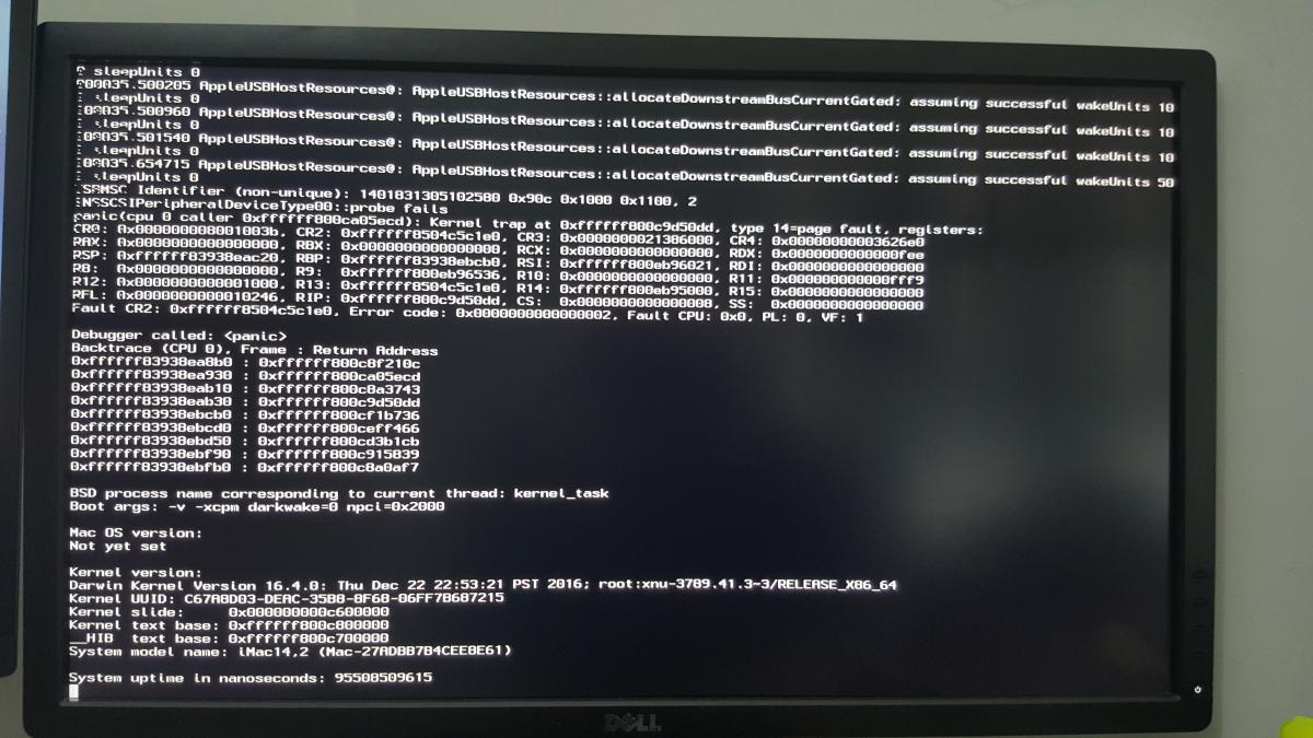

surfinchina Posted August 6, 2017 Share Posted August 6, 2017 Not sure. Try 0x0805 cpu type on cpu part in config.plist. Then tell me. 나의 LG-F800S 의 Tapatalk에서 보냄 0x0805 didn't work - got a hang on +++++ There is something new before the clover screen. Link to comment https://www.insanelymac.com/forum/topic/324857-skylake-x-testing-i7-7800x-i7-7820x-i9-7900x/page/2/#findComment-2474965 Share on other sites More sharing options...
Sherlocks Posted August 6, 2017 Share Posted August 6, 2017 0x0805 didn't work - got a hang on +++++ There is something new before the clover screen. Sorry it's so blurry, it lasts for a split second. I'll try to do better next time. 20170806_162927.jpg Sorry. It is just test. You have to use 0x0705 to avoid unknown processor. But you have i7. We will wait new imac pro series on fall 2017. Thank you for testing EDIT i7 0x0705 Xeon 0x0A02 나의 LG-F800S 의 Tapatalk에서 보냄 1 Link to comment https://www.insanelymac.com/forum/topic/324857-skylake-x-testing-i7-7800x-i7-7820x-i9-7900x/page/2/#findComment-2474966 Share on other sites More sharing options...
surfinchina Posted August 6, 2017 Share Posted August 6, 2017 Sorry. It is just test. You have to use 0x0705 to avoid unknown processor. But you have i7. We will wait new imac pro series on fall 2017. Thank you for testing EDIT i7 0x0705 Xeon 0x0A02 나의 LG-F800S 의 Tapatalk에서 보냄 I can wait. It's working well and I want to focus on either getting X299 to work on 10.13 or getting the vega kexts to work on Sierra, so my rig will all work together. Thanks for the help! Link to comment https://www.insanelymac.com/forum/topic/324857-skylake-x-testing-i7-7800x-i7-7820x-i9-7900x/page/2/#findComment-2474999 Share on other sites More sharing options...

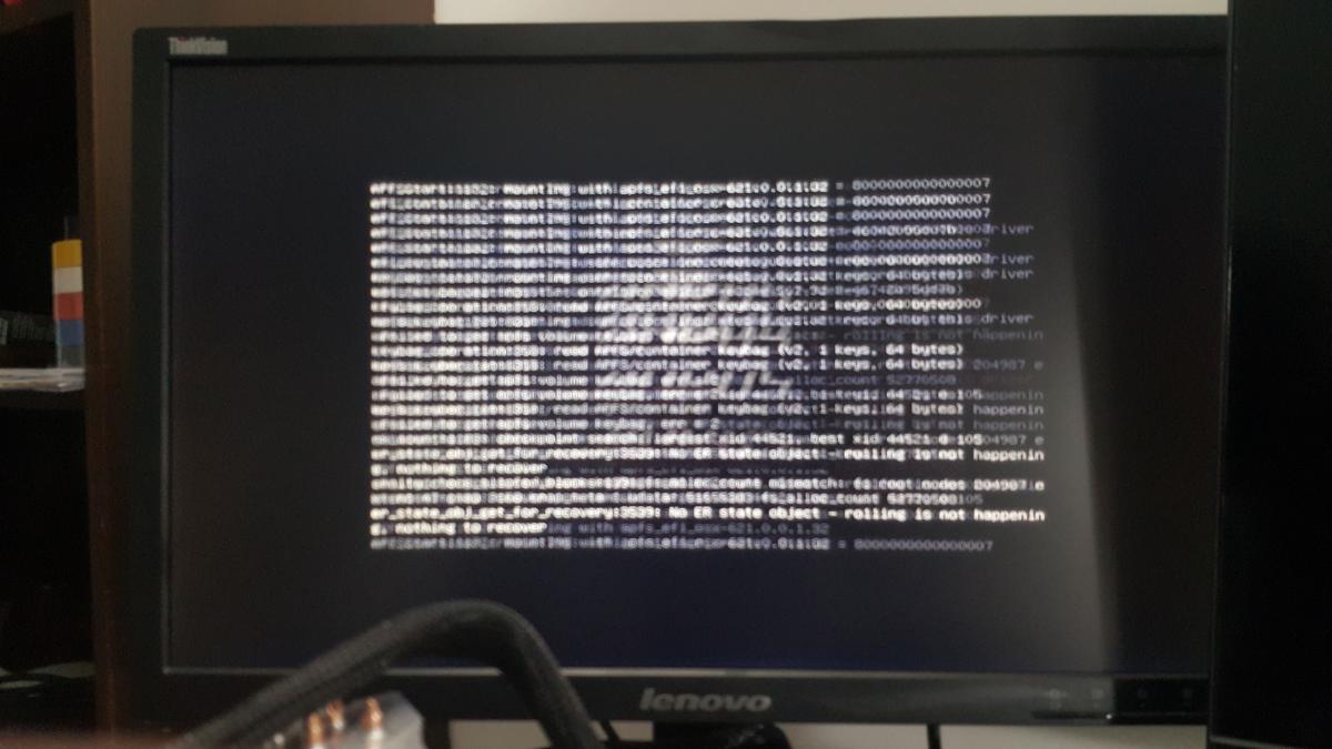

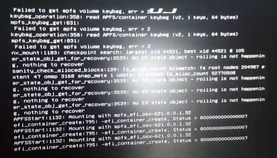

samaelestevez Posted August 6, 2017 Share Posted August 6, 2017 I'm stuck at this screen. If anybody can offer a little bit of guidance, please. I'm thinking of putting a guide together for X299 users. Here's a quick outline of my system: i7-7800X Water Cooled ASUS X299 Prime-A MB NVidia GTX 1070 and/or Radeon R9-280X (tried with each one and got stuck in the same place) 32 GB DDR4 G.Skills Ripjaws 3200MHZ 850W Power Supply I tried each and every one of the tips given in this thread to no avail. Link to comment https://www.insanelymac.com/forum/topic/324857-skylake-x-testing-i7-7800x-i7-7820x-i9-7900x/page/2/#findComment-2475319 Share on other sites More sharing options...
surfinchina Posted August 6, 2017 Share Posted August 6, 2017 I'm stuck at this screen. If anybody can offer a little bit of guidance, please. I'm thinking of putting a guide together for X299 users. Here's a quick outline of my system: i7-7800X Water Cooled ASUS X299 Prime-A MB NVidia GTX 1070 and/or Radeon R9-280X (tried with each one and got stuck in the same place) 32 GB DDR4 G.Skills Ripjaws 3200MHZ 850W Power Supply I tried each and every one of the tips given in this thread to no avail. IONvmeFamily kext gave me a kp. I had to take it out. Also plugins in fakeSMC needed to go. I got this clover that works on High Sierra now but not Sierra. You can make a few changes around your motherboard (if necessary) and your GPU and give it a go. CLOVER.zip Link to comment https://www.insanelymac.com/forum/topic/324857-skylake-x-testing-i7-7800x-i7-7820x-i9-7900x/page/2/#findComment-2475320 Share on other sites More sharing options...
