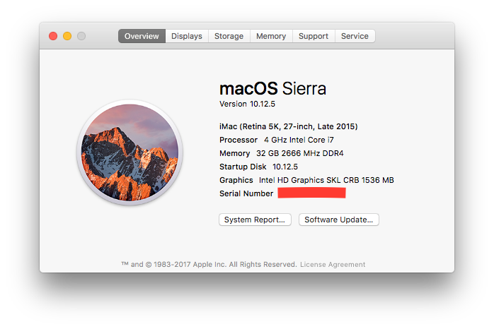

Cyberdevs Posted May 21, 2017 Share Posted May 21, 2017 It seems to be workingĀ IntelHD530 10.12.5 Working.zip 1 Link to comment https://www.insanelymac.com/forum/topic/323805-problems-with-z170x-ud3-i7-6700k-updating-from-1012-to-10125/page/3/#findComment-2428853 Share on other sites More sharing options...

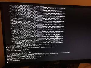

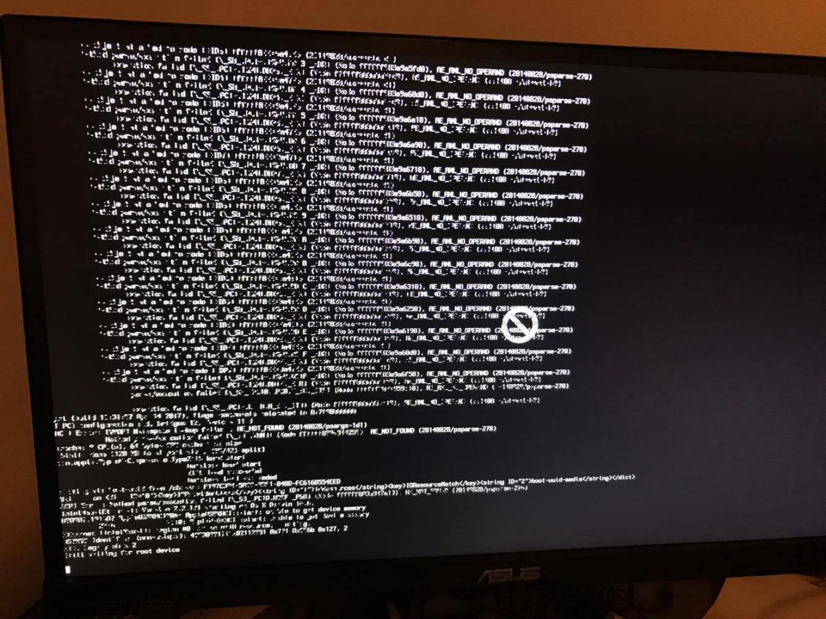

Pimof Posted May 22, 2017 Author Share Posted May 22, 2017 I did. I obtain this error. 1 Link to comment https://www.insanelymac.com/forum/topic/323805-problems-with-z170x-ud3-i7-6700k-updating-from-1012-to-10125/page/3/#findComment-2429304 Share on other sites More sharing options...
MaLd0n Posted May 22, 2017 Share Posted May 22, 2017 IOAPIC 24-119 - Disabled? Link to comment https://www.insanelymac.com/forum/topic/323805-problems-with-z170x-ud3-i7-6700k-updating-from-1012-to-10125/page/3/#findComment-2429310 Share on other sites More sharing options...
Pimof Posted May 22, 2017 Author Share Posted May 22, 2017 IOAPIC 24-119 - Disabled? where is it? Link to comment https://www.insanelymac.com/forum/topic/323805-problems-with-z170x-ud3-i7-6700k-updating-from-1012-to-10125/page/3/#findComment-2429318 Share on other sites More sharing options...
Cyberdevs Posted May 22, 2017 Share Posted May 22, 2017 reboot the computer go to BIOS settings under "Chipset" IOAPIC 24-119 Entries" set it to disabled save the changes and reboot. Link to comment https://www.insanelymac.com/forum/topic/323805-problems-with-z170x-ud3-i7-6700k-updating-from-1012-to-10125/page/3/#findComment-2429321 Share on other sites More sharing options...
Pimof Posted May 22, 2017 Author Share Posted May 22, 2017 I did, I was at university. It seems that it's not able to boot now both el capitanĀ and sierra. The same error on the screen. Link to comment https://www.insanelymac.com/forum/topic/323805-problems-with-z170x-ud3-i7-6700k-updating-from-1012-to-10125/page/3/#findComment-2429486 Share on other sites More sharing options...
Cyberdevs Posted May 22, 2017 Share Posted May 22, 2017 Use this folder instead Update: If you want to use El Capitan as well all you have to do is to copy the kexts inside /EFI/Clover/kexts/10.12 to /EFI/Clover/kexts/10.11 IntelHD530 10.12.5 Working.zip 1 Link to comment https://www.insanelymac.com/forum/topic/323805-problems-with-z170x-ud3-i7-6700k-updating-from-1012-to-10125/page/3/#findComment-2429489 Share on other sites More sharing options...
