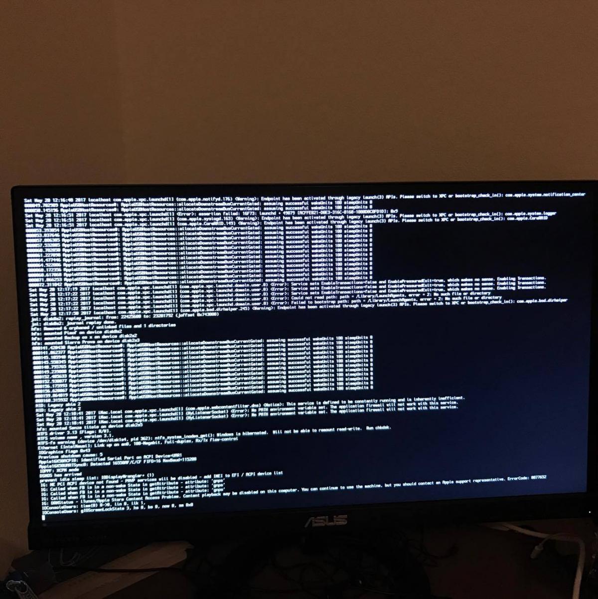

Pimof Posted May 20, 2017 Author Share Posted May 20, 2017 Update the bios, now let's see booting from the pen drive directly from the bios... So here we are... What do you think about it? maybe should I change some bios settings? 1 Link to comment https://www.insanelymac.com/forum/topic/323805-problems-with-z170x-ud3-i7-6700k-updating-from-1012-to-10125/page/2/#findComment-2428382 Share on other sites More sharing options...
Cyberdevs Posted May 20, 2017 Share Posted May 20, 2017 Have you updated the BIOS to F22? If you didn't do so. if you did, plug in the flash drive and go to BIOS and on each page in BIOS press f12 that will save a snapshot of the BIOS page inside the EFI partition of the flash drive, mount the EFI partition in macOS and compress the pictures you saved and post them here to see what's wrong. 1 Link to comment https://www.insanelymac.com/forum/topic/323805-problems-with-z170x-ud3-i7-6700k-updating-from-1012-to-10125/page/2/#findComment-2428409 Share on other sites More sharing options...

Cyberdevs Posted May 21, 2017 Share Posted May 21, 2017 You need to make the following changes to get macOS working on your pc: In Peripherals, Trusted computing, Security Device Support = Disable In Peripherals, Super IO Configuration, Serial IO = Disable In Peripherals, USB Configuration, XHCI Hand-off = Enabled in Chipset, VT-d = Disabled In Chipset, Internal Graphics = Enabled In Chipset, IOAPIC 24-119 Entries = Disable In Chipset, DVMT Pre-Allocated = set it to maximum value available inside the In Chipset, DVMT Total Gfx Mem = set it to maximum value available inside the 1 Link to comment https://www.insanelymac.com/forum/topic/323805-problems-with-z170x-ud3-i7-6700k-updating-from-1012-to-10125/page/2/#findComment-2428617 Share on other sites More sharing options...
Pimof Posted May 21, 2017 Author Share Posted May 21, 2017 Now it 'is able to boot only in windows, no el capitan and no pendrive. What a mess. Windows is in a different ssd. If I select the ssd of el capitan It show me clover and if I choose el capitan, logo apple and then reboot.... If I try to install from pendrive just rebooT or black screen after i try to boot from the pendrive... 1 Link to comment https://www.insanelymac.com/forum/topic/323805-problems-with-z170x-ud3-i7-6700k-updating-from-1012-to-10125/page/2/#findComment-2428751 Share on other sites More sharing options...
Cyberdevs Posted May 21, 2017 Share Posted May 21, 2017 when you see the gigabyte logo press f12 for boot menu. With the pen drive connected of course Edit: In BIOS under BIOS section set: Windows8/10 to Other OS CSM Support= Disabled 1 Link to comment https://www.insanelymac.com/forum/topic/323805-problems-with-z170x-ud3-i7-6700k-updating-from-1012-to-10125/page/2/#findComment-2428755 Share on other sites More sharing options...
