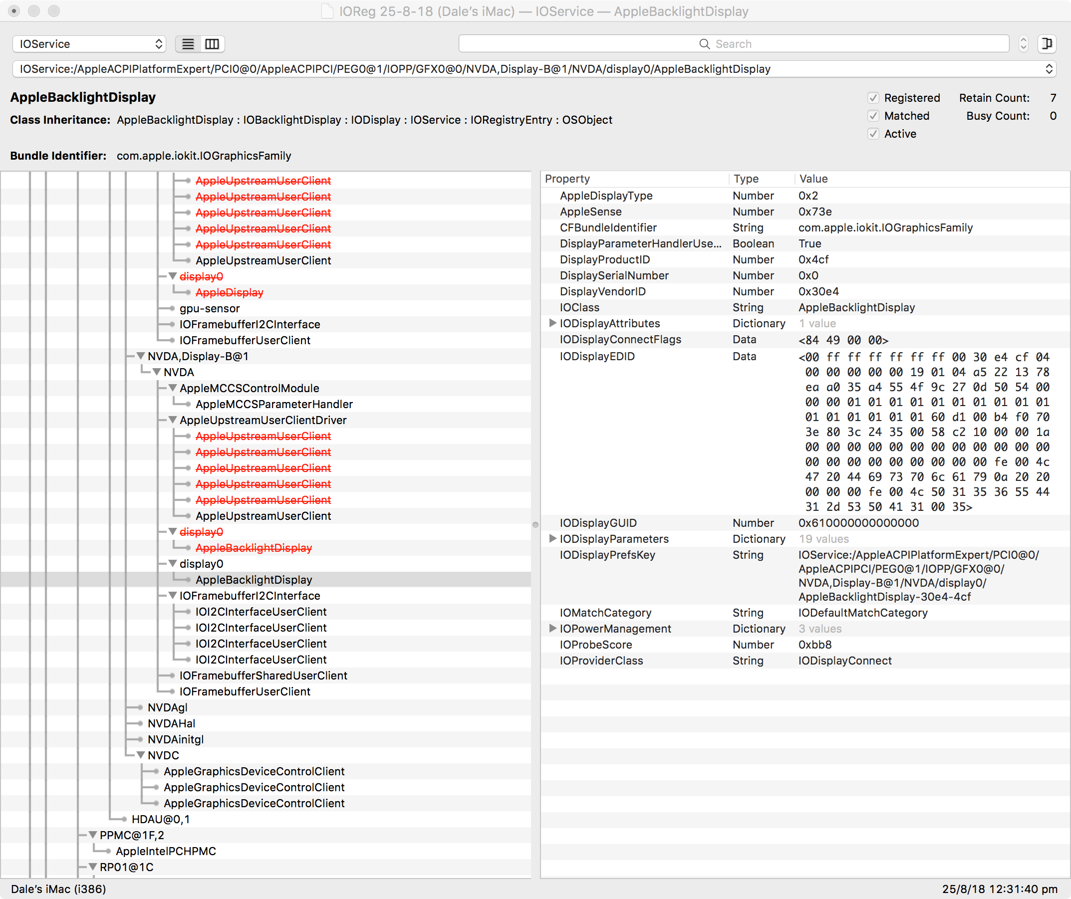

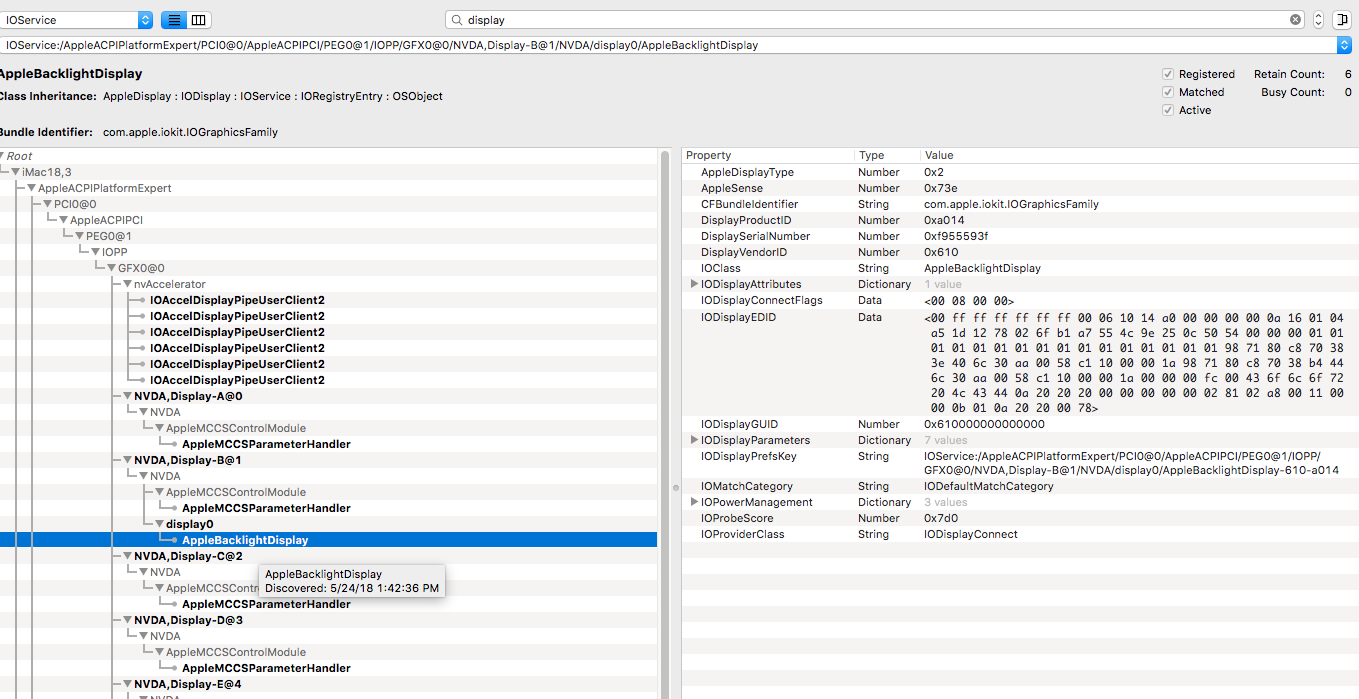

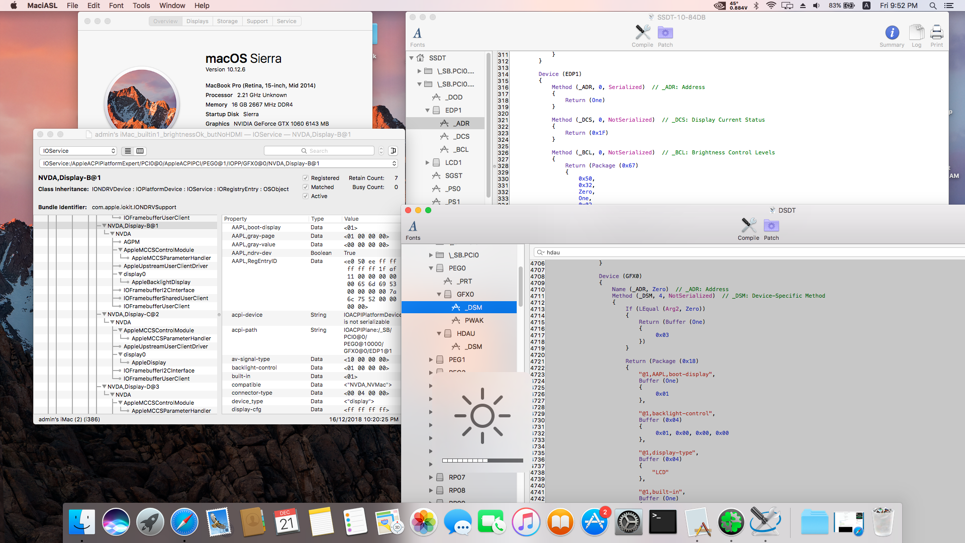

I have High Sierra 10.13.4 with Alienware 15R3 7700HQ with GTX1070 and HD630.  Screen is 15" FHD G-SYNC.  Same Hardware as Xela.
Trying to solve the Backlight issue.  I'm using EDID Fix to convince the display that it's internal, and that's it's AppleBacklightDisplay.  But I cannot get backlight slider to show up and cannot adjust brightness.  See attached troubleshooting files and displaymergenub kext.
(this site has issues uploading kexts so I took a screenshot of kexts/other to show which I'm loading.)
A15R3 iMac.zip
patchmatic extract.zip
Terminal Output.txt
CLOVER.zip
Oh, one thing to note, my laptop IS loading AppleBacklight kexts (see Terminal output).  I think this is due to spoofing the display with EDID fixer.
Edit: Note that I've already done the steps to create the Applebacklight Injector.  However, I confess I don't know exactly know how to do the steps below, which are finding the _dsm methods and inserting the additional acpi code.  I think it means to recompile the dsdt,, however, I'm using Clover to hotpatch _DSM to XDSM, so I guess I'd NOT use that patch and rather rename directly in the dsdt? and in any ssdts that have PEG0?  (I have 2 ssdts that refer to PEG0).
Also, I'm using clover to rename IGPU to GFX0, and rename PEGP to GFX0, do these patches stay?

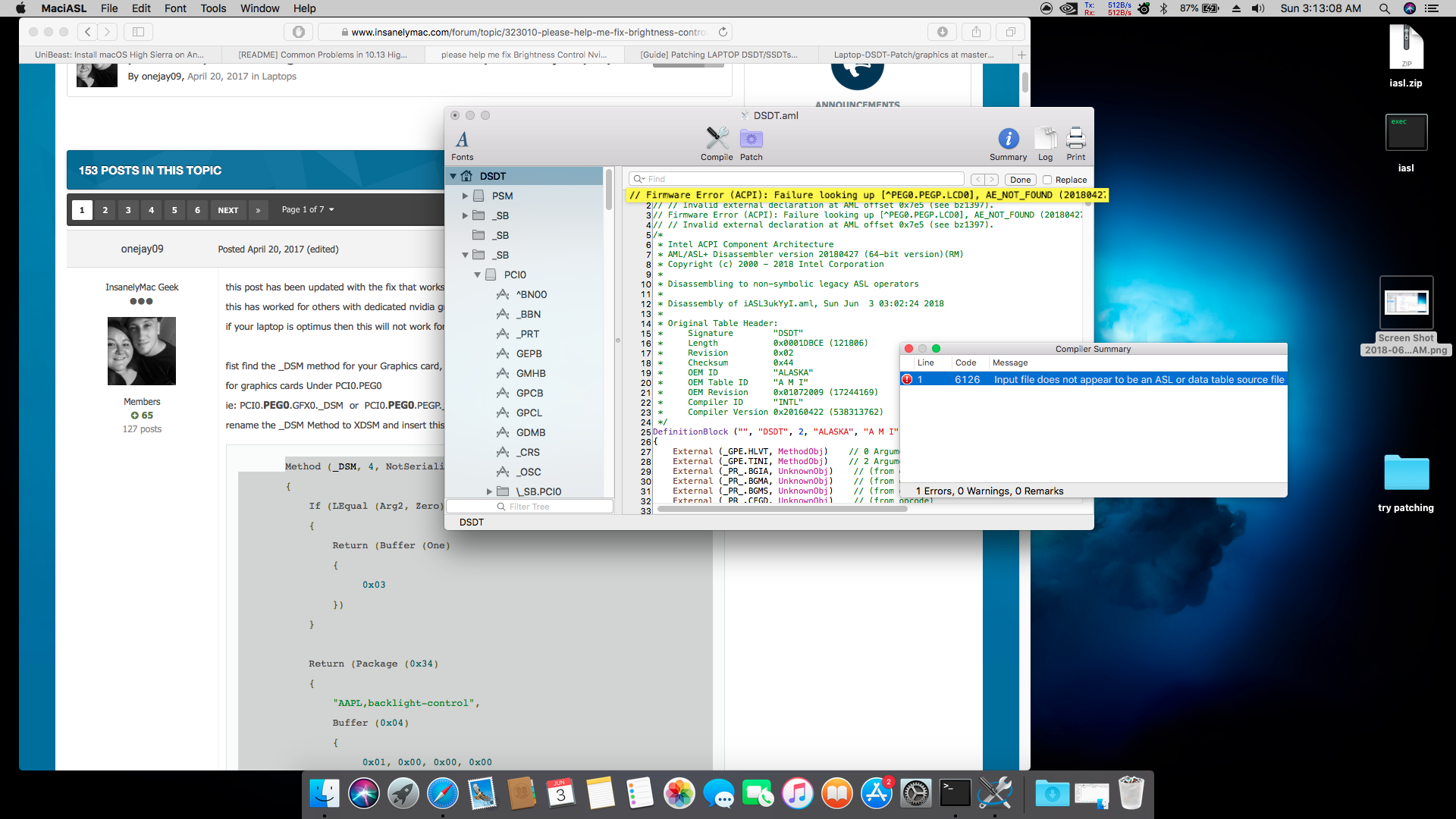

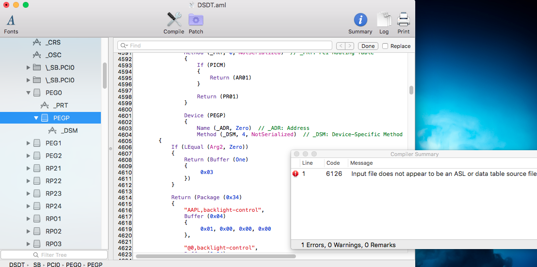

On 6/2/2018 at 11:23 PM, mtuan293 said:
Am I doing it right? I clicked save and it threw this error. I also attached my DSDT.aml file below. Any help would be greatly appreciated :lol:128255191_ScreenShot2018-06-03at3_11_28AM.thumb.png.99de7eb7ddf298758b44067d58a609e4.png
2062677332_ScreenShot2018-06-03at3_13_08AM.thumb.png.36b8a36a0ab812dad3ccc8df8ca890c5.png
DSDT.aml.zip
I'm not a pro at DSDT editing.  But I think you need to search for a guide on patching laptop DSDT, and search specifically for the part about disassembling ACPI files with refs.  If you find it you'll know what I mean.  This will help you get clean files to work with and help eliminate errors in compiling.

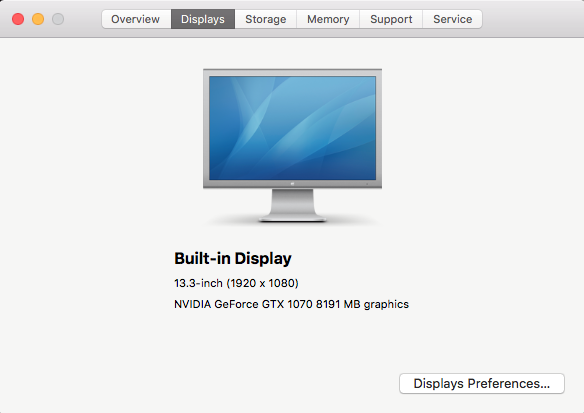

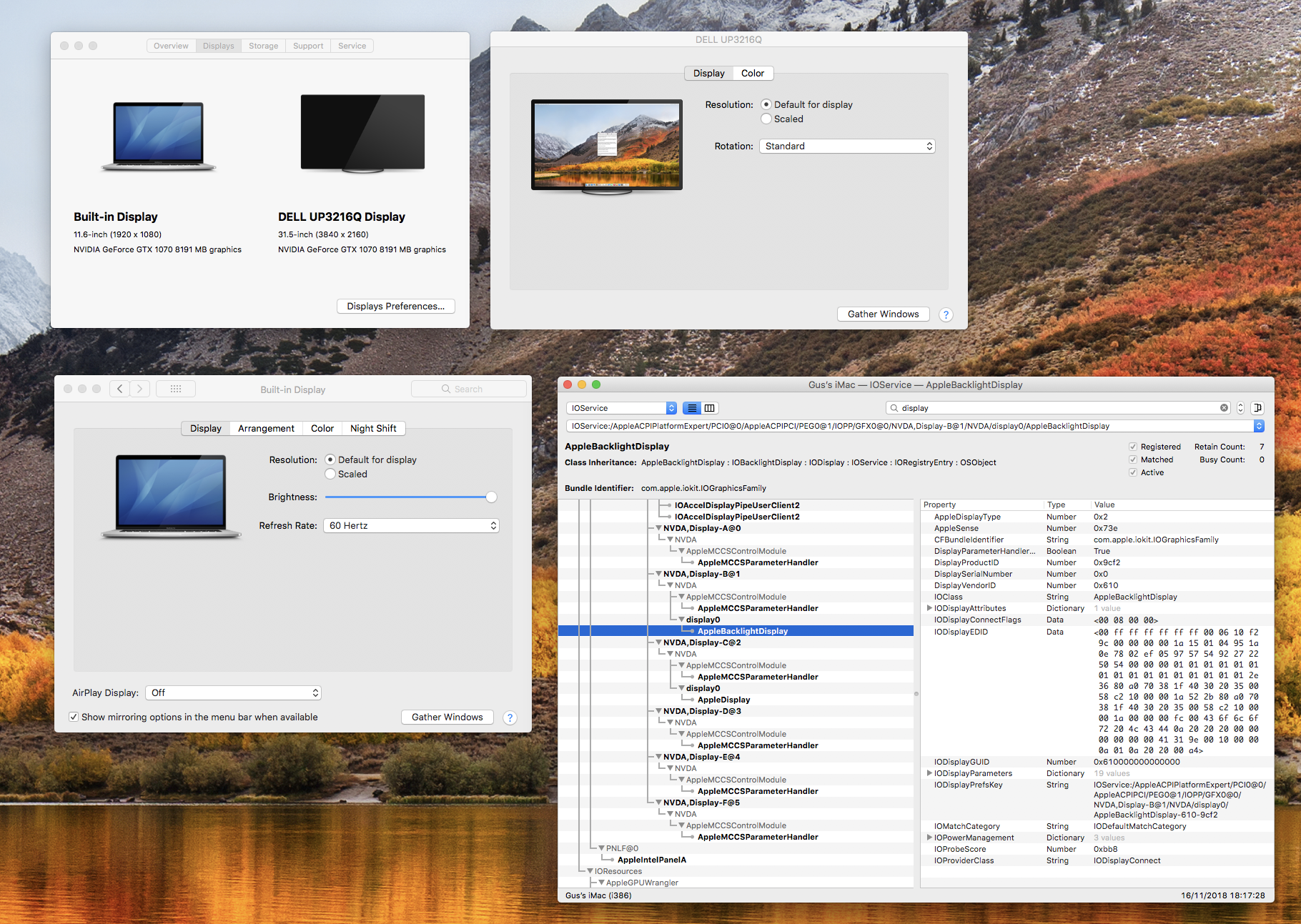

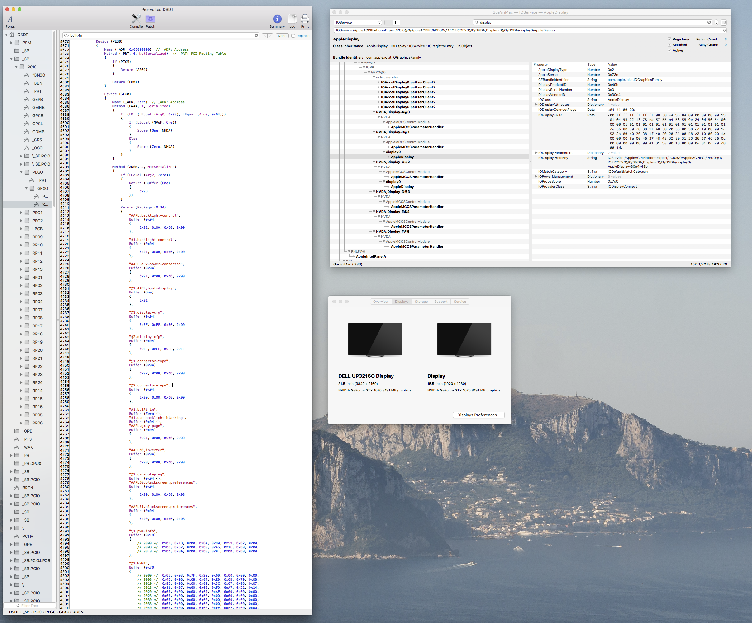

Hi,
I am doing this patch on High Serria OS X 10.13.5. So far the farthest I got was
- getting the display recognized as Internal
- brightness slider show up but no effect (brightness by Berg Design was unresponsive)
- FN brightness key translucent feedback works but no effect
My default LCD display at NVDA,Display-B@1, so I did those necessary change ( I hope ). What I've done:
- Brightness and PNLF patch applied in DSDT.aml
- AppleBacklightInjector.kext into /L/E with patched display id
Specs:
Dell Alienware 15 r3, i7-7700HQ/Intel Kaby Lake rev. 05, BIOS 1.0.9, Intel® HD Graphics 630/
NVIDIA GeForce GTX 1070 (1920x1080) G-SYNC Panel 16GB RAM.
OS: High Serria 10.13.5, with Clover UEFI v4444 and Nvidia Web Driver: 387.10.10.10.35.106.
CLOVER and IOREG attach.
Archive.zip
Thanks!
Edited by xela

EDIT: Update, Followed the instructions as my Display was on B1. Have Lilu, AppleALC and whateberGreen installed to L/E.
Now have Brightness slider, however it does nothing. If I boot with either Inject EDID on clover I boot into black screen with mouse cursor and from all account can login blind, however still no desktop. if I remove the InjectEDID and repeat with injectNvidia (always am injecting webdrivers regardless) I can boot with screen yet still no control over brightness, however the system now sees my Video Memory as 256MB as opposed to the 8GB it was seeing prior the the patching.
Any ideas? I can easily attach further required files if anyone has the time to help
Cheers,

Hi Guys,
Attached is the problem reporting files from my Metabox (Clevo Rebrand).
I had a bit more of a play and research over the weekend, and It looks like the majority of the settings are already there and could be supported, I'm just too new to this to link all the devices together with the correct syntax.
I also still am having issues keeping the brightness slider and seeing my laptop in built as an in built display. In fact I have seen it again since my previous post.
Please find attached files for trouble shooting and advice. Would love to get this up and running, but I feel like I have gone stagnant.
Cheers,

Hi mates,
Another trying to get brightness bar and control keys.
That PNLF patch doesn't work for me. MaciASL doesn't do nothing when I copy it .
I'm using right now Applebacklightinjector in L/E.
_DSM renamed to XSDM.
The patch from Rehabman repository called "Birgthness fix (Haswell/Broadwell)" but nothing works.
How could I get it???
Problems files attached.

Hi, i'm trying to apply this fix to the Acer Predator Helios 500, with mild success so far. Most things are working excepting the internal LCD brightness control. This laptop features a discrete GPU (Nvidia Geforce GTX 1070) with factory disabled Intel GPU (and no way to enable it, even with modded bios, I tried). What I've got so far:
- Configured Bios as suggested on other posts: disable vt-d, disabled thunderbolt ports (thanks my modded bios),
- Successfully installed High Sierra (10.13.6) + Nvidia Web Drivers to get full QE/CI on NVMe Samsung 970 EVo 256GB SSD, (without any driver needed for the SSD)
- CPU Intel 8750h is recognized as Unknown Type: tried to fix this by installing High Sierra Update 2, but it refuses to install even with SMBios configured to MacBookPro 15,1. Must be something related to the Intel GPU being disabled, from what I understand the patch checks the graphics ig-platform-id or something related for compatibility (booted with -no_compat_check has no effect). At least, CPU runs cool so power management seems okay,
- Patched DSDT + SSDT (SSDT-8.aml in my case) to include PNLF and modify _DSM method (renaming existing to XDSM): had to adjust the display number within the (my internal LCD runs on display #2),
- Patched AppleBacklight kext and replaced within /System/Library/Extensions, kextcache rebuild and rebooted.
Getting black screen on internal LCD, but usable on external Display Port on Acer 32 B326HUL. I'm decompiling and recompiling AML ACPI files using iasl, MacIasl and patchmatic provided by Rehabman. When configuring display through the external monitor, brightness adjustment is available on LCD but has no effect. Screen remains dark (but backlight is on).
IOReg recognizes the internal LCD as AppleBacklightDisplay successfully once backlight kext patched and ACPI patched using Clover ACPI/patched (with AutoMerge=true). The internal LCD is "17.3 inch 16:9, 1920 x 1080 pixel 141 PPI, AUO_B173HAN03, IPS, 144 Hz G-Sync, glossy: no" according to notebook check. I'm not willing to upgrade to Mojave yet (this could fix CPU recognition) because Nvidia Web drivers aren't available yet.
If someone has an idea what I can do. I thought about the brightness steps which could be wrong, but not sure how to modify those hex values properly (have seen the original brightness control steps within the same SSDT on _SB.PCI0.PEG0.PEGP.LCD0)

Hello all,
Great progress on this, thanks so much for the hard work.
For some reason I am not able to set my built-in display to show up as one. Hence, it's blocking my progress in achieving the backlight control.
I am running a GeForce 1070, IGPU disabled. My built-in display shows up as B@1, external monitor as C@2. Both work perfectly fine with full HW acceleration, but I'm not able to control the brightness (duh).
I've patched the DSDT with @1,built-in, tried changing the connector-type. It still shows up as an external display with <84 41 00 00> connector flag.
Could anyone please point me to the right direction? Many thanks in advance.
Hi, shouldn't the method be named "_DSM" instead of "XDSM"? As your display is not recognized as AppleBacklightDisplay, I suspect you have not patched the right ACPI file. Find the _DSM method of your GPU then rename it to XDSM. Then put the _DSM method provided in first post.
On 4/20/2017 at 4:10 PM, onejay09 said:
rename the _DSM Method to XDSM and insert this Below
@foskvs @vanadium
I thought that meant I should patch my DSDT with a _DSM to XDSM patch?
(Thanks for the replies, by the way)
Hard to say without seeing your ACPI tables. Anyway, Device Specific Method MUST be named _DSM. Otherwise, it doesn't inject those properties. That's why you display is not detected as Built-in.
Okay, progress!
However, the brightness slider, as expected, does not work. Currently using shades to just darken the display. Thank you so much for the help!

This is for the default display at B@1. below is my practical experience.
Sierra 10.12.6, Brightness control is working
1132130916_ScreenShot2018-12-21at9_52_58PM.thumb.png.13217f6125c0767f960c08905f6757e3.png
what did I do:
  • fix XOSI
  • add device PNLF
  • rename GFX0 to _GFX both DSDT and SSDTs
  • rename PEGP to GFX0 both DSDT and SSDTs
  • add device (HDAU) under PEG0
  • return (one) under device (EDP1)
Brightness control shortcut key
            Method (_Q10, 0, NotSerialized)  // _Qxx: EC Query
                If (LEqual (GPUM, 0x05))
                    Notify (PS2K, 0x0205)
                    Notify (PS2K, 0x0285)
                If (LEqual (GPUM, 0x03))
                    Notify (^^^_GFX.DD1F, 0x87)
                ElseIf (CondRefOf (\_SB.PCI0.PEG0.GFX0.EDP1))
                    Notify (^^^PEG0.GFX0.EDP1, 0x87)
            Method (_Q11, 0, NotSerialized)  // _Qxx: EC Query
                    Notify (PS2K, 0x0206)
                    Notify (PS2K, 0x0286)
                    Notify (^^^_GFX.DD1F, 0x86)
                    Notify (^^^PEG0.GFX0.EDP1, 0x86)
_DSM of Device (GFX0)
                    Method (_DSM, 4, NotSerialized)  // _DSM: Device-Specific Method
                        If (LEqual (Arg2, Zero))
                            Return (Buffer (One)
                                 0x03
                        Return (Package (0x18)
                            "@1,AAPL,boot-display",
                            Buffer (One)
                                 0x01
                            "@1,backlight-control",
                            Buffer (0x04)
                                 0x01, 0x00, 0x00, 0x00
                            "@1,display-type",
                            Buffer (0x04)
                                "LCD"
                            "@1,built-in",
                            Buffer (One)
                                 0x01
                            "@0,connector-type",
                            Buffer (0x04)
                                 0x00, 0x08, 0x00, 0x00
                            "@1,connector-type",
                            Buffer (0x04)
                                 0x00, 0x04, 0x00, 0x00
                            "@2,connector-type",
                            Buffer (0x04)
                            "@3,connector-type",
                            Buffer (0x04)
                            "@4,connector-type",
                            Buffer (0x04)
                            "@5,connector-type",
                            Buffer (0x04)
                            "@1,pwm-info",
                            Buffer (0x14)
                                /* 0000 */  0x01, 0x14, 0x00, 0x64, 0xA8, 0x61, 0x00, 0x00,
                                /* 0008 */  0x1E, 0x02, 0x00, 0x00, 0x2C, 0x00, 0x00, 0x00,
                                /* 0010 */  0x00, 0x04, 0x00, 0x00
                            "hda-gfx",
                            Buffer (0x0A)
                                "onboard-1"
admin’s iMac_builtin1_brightnessOk_butNoHDMI.ioreg
DSDT.aml
SSDT-10-84DB.aml
SSDT-XOSI.aml
