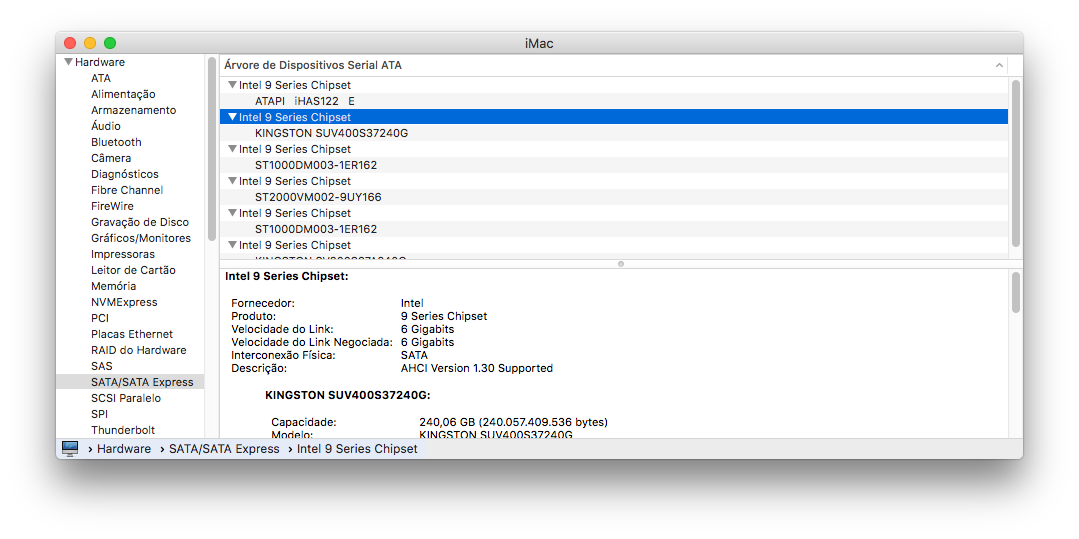

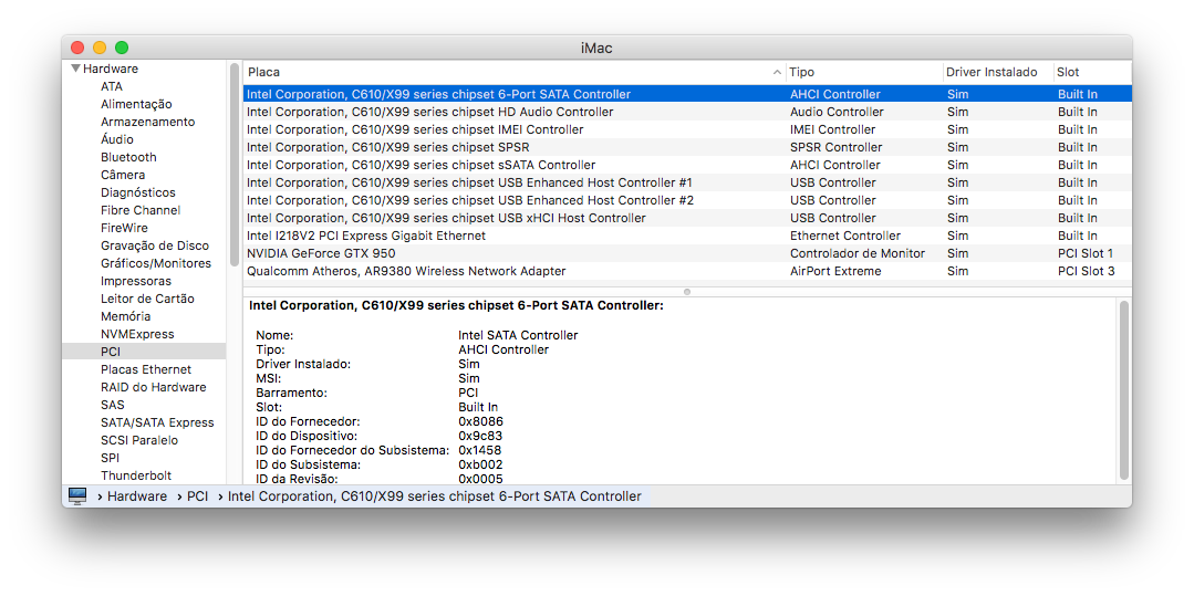

MaLd0n Posted April 14, 2017 Share Posted April 14, 2017 Check AppleAHCIPort.kext about Sata, the kext dont have "pci8086,8d02" U need inject pci8086,9c83 or pci8086,8c83(Serie 9) or Injector AHCIInjector.kext.zip 1 Link to comment https://www.insanelymac.com/forum/topic/322811-ssdtgen-custom-generated-ssdts-x99z170z97h97-systems/#findComment-2404403 Share on other sites More sharing options...
