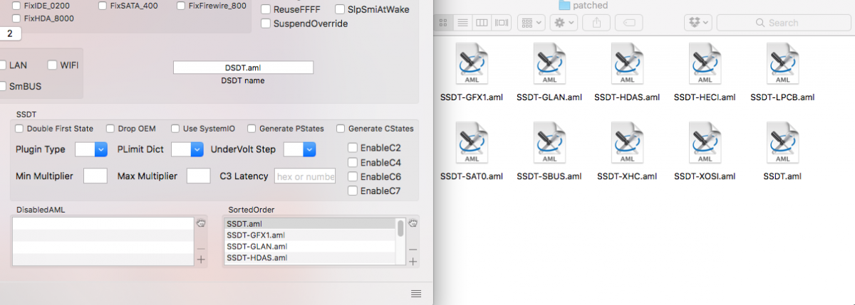

mfc88 Posted April 19, 2017 Author Share Posted April 19, 2017 Just waiting for my USB of centOS to finish creating. See above for updated details. Screen Shot 2017-04-19 at 4.38.11 pm.png Remove DSDT.aml from "DSDT name". And add _DSM to XDSM in Acpi->DSDT patch. Comment: Rename _DSM to XDSM Find: 5F44534D Replace: 5844534D Link to comment https://www.insanelymac.com/forum/topic/322811-ssdtgen-custom-generated-ssdts-x99z170z97h97-systems/page/3/#findComment-2407112 Share on other sites More sharing options...

mfc88 Posted April 19, 2017 Author Share Posted April 19, 2017 Ok all done. Shane's iMac.zip GPU injection is still wrong and SBUS still missing. Did you add _DSM patch and remove "DSDT.aml" from DSDT name? Link to comment https://www.insanelymac.com/forum/topic/322811-ssdtgen-custom-generated-ssdts-x99z170z97h97-systems/page/3/#findComment-2407124 Share on other sites More sharing options...
SavageAUS Posted April 19, 2017 Share Posted April 19, 2017 Yes i did both of those. config.plist.zip Link to comment https://www.insanelymac.com/forum/topic/322811-ssdtgen-custom-generated-ssdts-x99z170z97h97-systems/page/3/#findComment-2407125 Share on other sites More sharing options...
