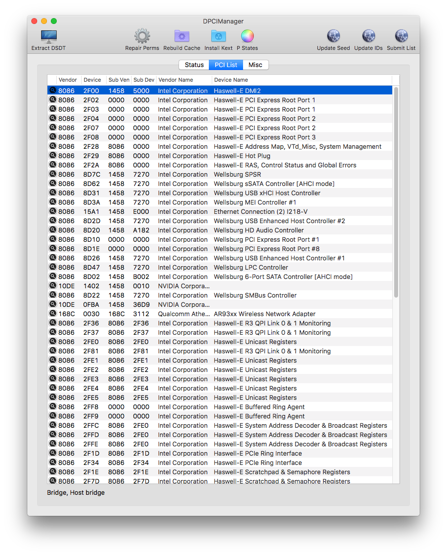

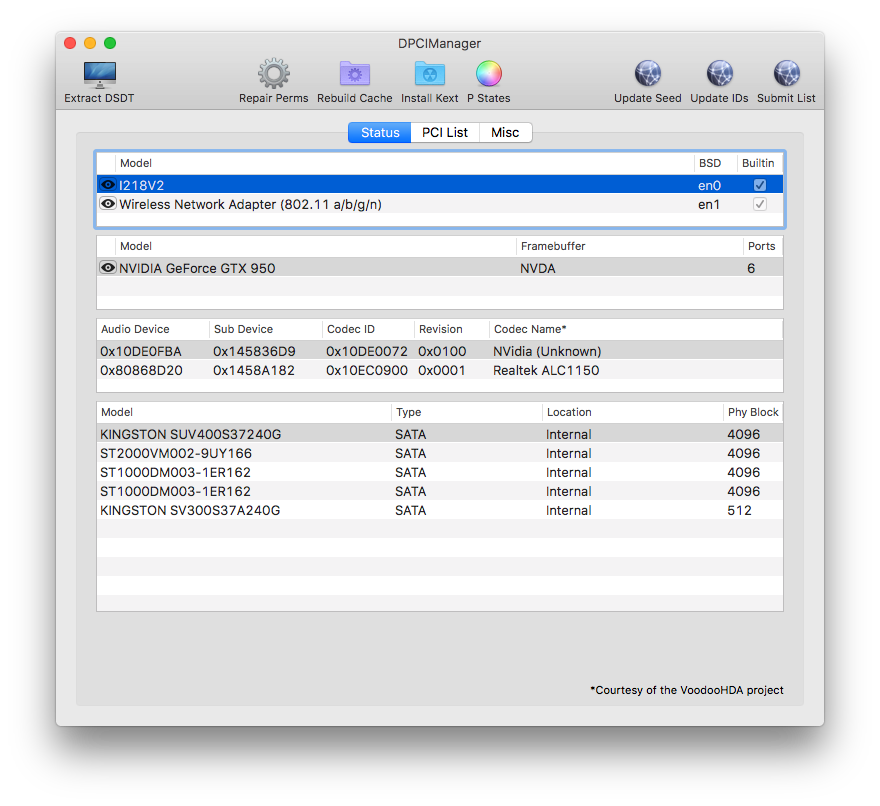

CharlieTUO Posted March 26, 2017 Author Share Posted March 26, 2017 What am I going to be looking for? Quote Link to comment https://www.insanelymac.com/forum/topic/322022-a-few-questions-about-my-dell-optiplex-780-hackintosh/#findComment-2392040 Share on other sites More sharing options...
MaLd0n Posted March 26, 2017 Share Posted March 26, 2017 post screenshot tab Status and tab PCI List Quote Link to comment https://www.insanelymac.com/forum/topic/322022-a-few-questions-about-my-dell-optiplex-780-hackintosh/#findComment-2392043 Share on other sites More sharing options...
CharlieTUO Posted March 26, 2017 Author Share Posted March 26, 2017 Here they are: http://imgur.com/gallery/kL6QI Quote Link to comment https://www.insanelymac.com/forum/topic/322022-a-few-questions-about-my-dell-optiplex-780-hackintosh/#findComment-2392077 Share on other sites More sharing options...
MaLd0n Posted March 26, 2017 Share Posted March 26, 2017 Audio AD1984A i dont see wifi, check it send me files run it, generate files in desktop RunMe.app.zip Quote Link to comment https://www.insanelymac.com/forum/topic/322022-a-few-questions-about-my-dell-optiplex-780-hackintosh/#findComment-2392088 Share on other sites More sharing options...
