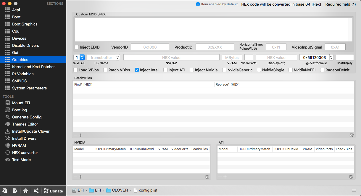

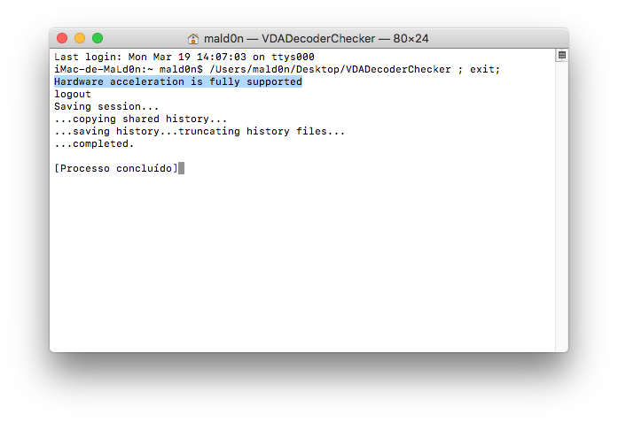

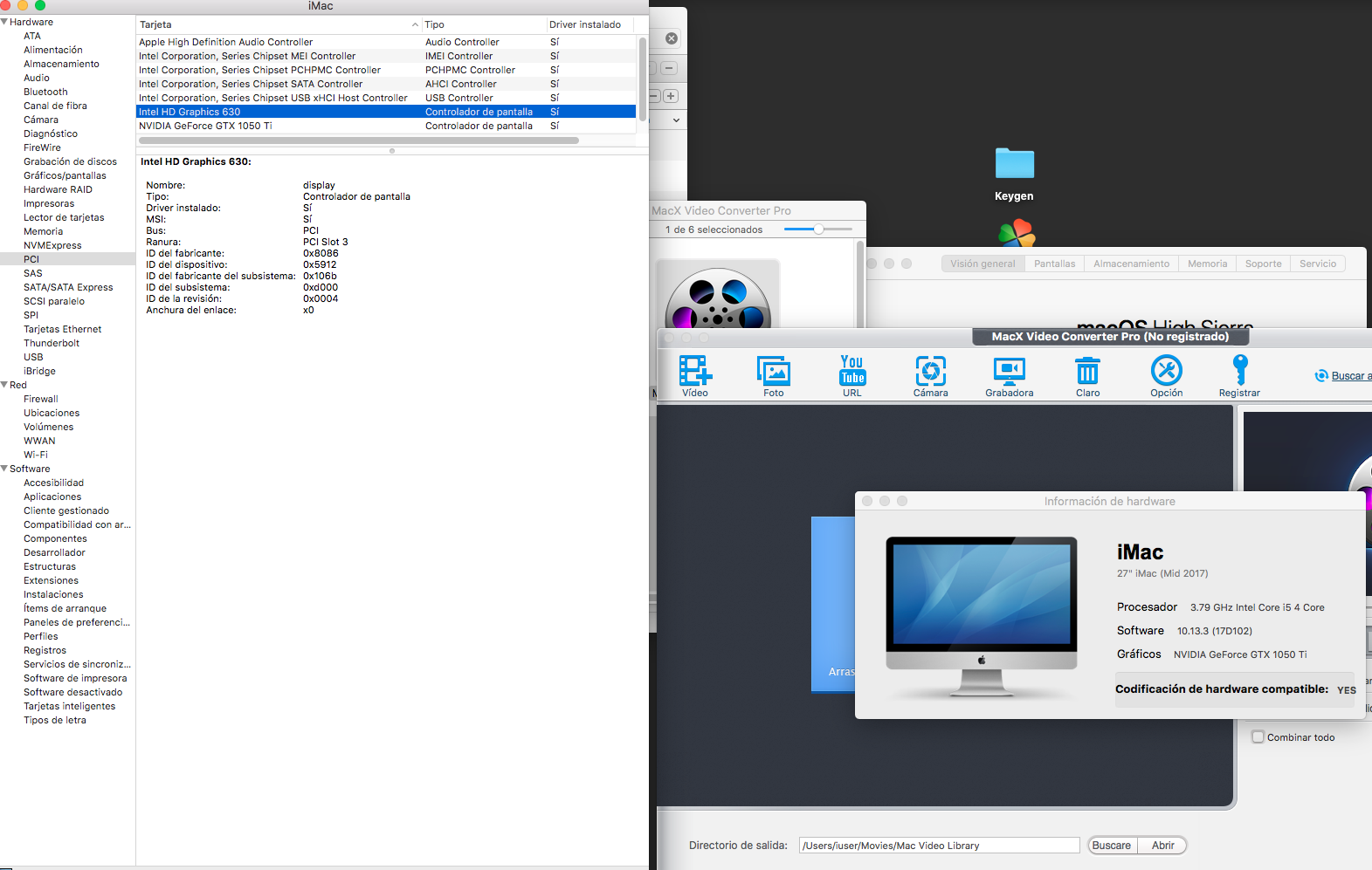

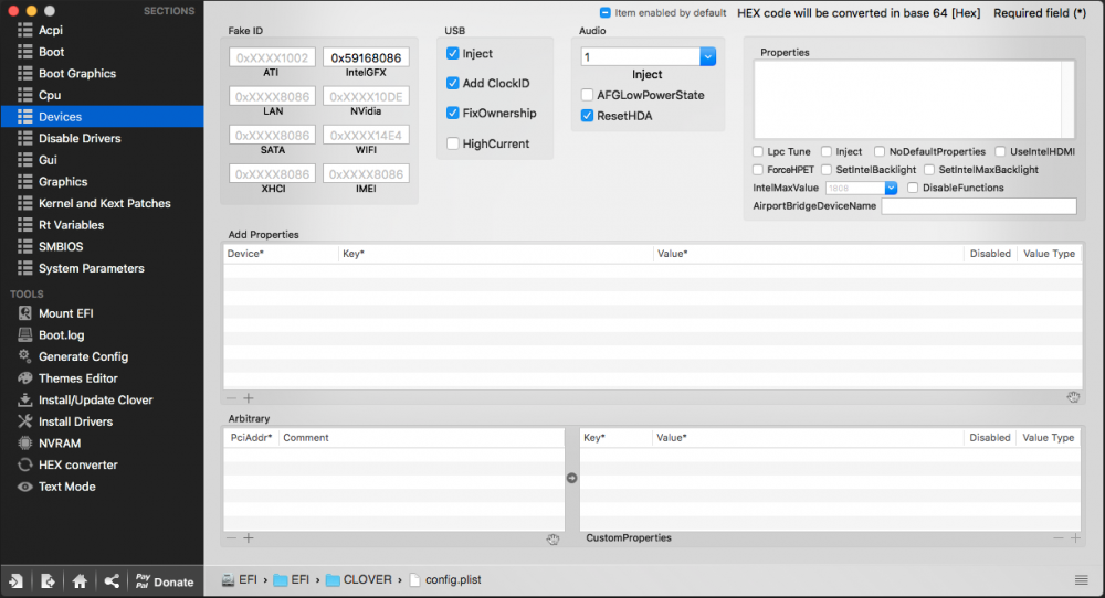

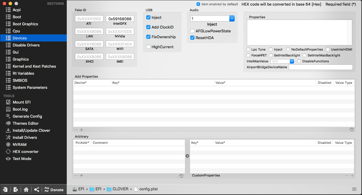

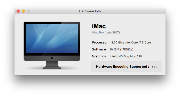

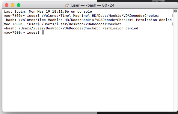

multiymedia Posted March 19, 2018 Share Posted March 19, 2018 4 minutes ago, MaLd0n said: Looks good final cut, in my case, e.g., Coffeelake config -IntelGFX 0x59128086 -InjectIntel -ig-platform-id 0x59120003 -IntelGraphics enable no bios -DVMT to 128 -IntelGraphicsFixup.kext -Shiki.kext i cant run vdadecoderchecker permission denied say terminal. 7 minutes ago, MaLd0n said: Looks good final cut, in my case, e.g., Coffeelake config -IntelGFX 0x59128086 -InjectIntel -ig-platform-id 0x59120003 -IntelGraphics enable no bios -DVMT to 128 -IntelGraphicsFixup.kext -Shiki.kext what can you say with this "IntelGraphics enable no bios" in the bios put enable IntelGraphics? i make this a few days but then finalcut makes bad renders, generate a file green in middle of frame. Link to comment https://www.insanelymac.com/forum/topic/322004-guide-sierra-high-sierra-on-gigabyte-ga%C2%A0h110m-s2-dsdt/page/4/#findComment-2604244 Share on other sites More sharing options...
MaLd0n Posted March 19, 2018 Author Share Posted March 19, 2018 ye, u need a hardware acceleration, all work together 1 Link to comment https://www.insanelymac.com/forum/topic/322004-guide-sierra-high-sierra-on-gigabyte-ga%C2%A0h110m-s2-dsdt/page/4/#findComment-2604253 Share on other sites More sharing options...
multiymedia Posted March 19, 2018 Share Posted March 19, 2018 11 minutes ago, MaLd0n said: ye, u need a hardware acceleration, all work together yes but don't show the same like you, i send a screenchot the performance of finalcut is poor, when is rendering the system goes down. is necesary shiki=12 in boot args? thank for your help- Link to comment https://www.insanelymac.com/forum/topic/322004-guide-sierra-high-sierra-on-gigabyte-ga%C2%A0h110m-s2-dsdt/page/4/#findComment-2604259 Share on other sites More sharing options...
MaLd0n Posted March 19, 2018 Author Share Posted March 19, 2018 with last shiki work without for ur GPU use IntelGFX 0x59168086 1 Link to comment https://www.insanelymac.com/forum/topic/322004-guide-sierra-high-sierra-on-gigabyte-ga%C2%A0h110m-s2-dsdt/page/4/#findComment-2604263 Share on other sites More sharing options...
multiymedia Posted March 19, 2018 Share Posted March 19, 2018 20 minutes ago, MaLd0n said: with last shiki work without for ur GPU use IntelGFX 0x59168086 ok i delete shiki=12 an put the correct 0x59168086 seem is better but performance of system is not good. the monitor is attached to gtx 1050 and many lags in video for example if finalcut is open safari cant see videos fine, many lags... im forgotten... I'm going to review the guides but how am I with your configuration should it work fine? Link to comment https://www.insanelymac.com/forum/topic/322004-guide-sierra-high-sierra-on-gigabyte-ga%C2%A0h110m-s2-dsdt/page/4/#findComment-2604274 Share on other sites More sharing options...
MaLd0n Posted March 19, 2018 Author Share Posted March 19, 2018 1 minute ago, multiymedia said: ok i delete shiki=12 an put the correct 0x59168086 seem is better but performance of system is not good. the monitor is attached to gtx 1050 and many lags in video for example if finalcut is open safari cant see videos fine, many lags... im forgotten... I'm going to review the guides but how am I with your configuration should it work fine? is a other problem, web driver run it and let the script work nvidia-update.command.zip 1 Link to comment https://www.insanelymac.com/forum/topic/322004-guide-sierra-high-sierra-on-gigabyte-ga%C2%A0h110m-s2-dsdt/page/4/#findComment-2604275 Share on other sites More sharing options...
multiymedia Posted March 19, 2018 Share Posted March 19, 2018 (edited) 2 minutes ago, MaLd0n said: is a other problem, web driver run it and let the script work nvidia-update.command.zip run it and say 378.10.10.10.25.106 is already installed. Edited March 19, 2018 by multiymedia incomplete Link to comment https://www.insanelymac.com/forum/topic/322004-guide-sierra-high-sierra-on-gigabyte-ga%C2%A0h110m-s2-dsdt/page/4/#findComment-2604278 Share on other sites More sharing options...
multiymedia Posted March 19, 2018 Share Posted March 19, 2018 can i try boot with only the intel gfx? what changes have to do? may be make one mobo like this with only intel gfx for a friend graphic designer. Link to comment https://www.insanelymac.com/forum/topic/322004-guide-sierra-high-sierra-on-gigabyte-ga%C2%A0h110m-s2-dsdt/page/4/#findComment-2604290 Share on other sites More sharing options...
MaLd0n Posted March 19, 2018 Author Share Posted March 19, 2018 the intel HD work only for Hardware Acceleration, to avoid problem in FCPX use ur DGPU + configs above + script nvidia 1 Link to comment https://www.insanelymac.com/forum/topic/322004-guide-sierra-high-sierra-on-gigabyte-ga%C2%A0h110m-s2-dsdt/page/4/#findComment-2604296 Share on other sites More sharing options...
multiymedia Posted March 19, 2018 Share Posted March 19, 2018 5 minutes ago, MaLd0n said: the intel HD work only for Hardware Acceleration, to avoid problem in FCPX use ur DGPU + configs above + script nvidia i'm doing this but the system dont work fine and now final cut restart the computer. i read to somebody saying about ig-platform-id in my case must be 0x59120003 or 0x59120000? that appear in the menu of clover. We will get it¡¡¡ Link to comment https://www.insanelymac.com/forum/topic/322004-guide-sierra-high-sierra-on-gigabyte-ga%C2%A0h110m-s2-dsdt/page/4/#findComment-2604299 Share on other sites More sharing options...

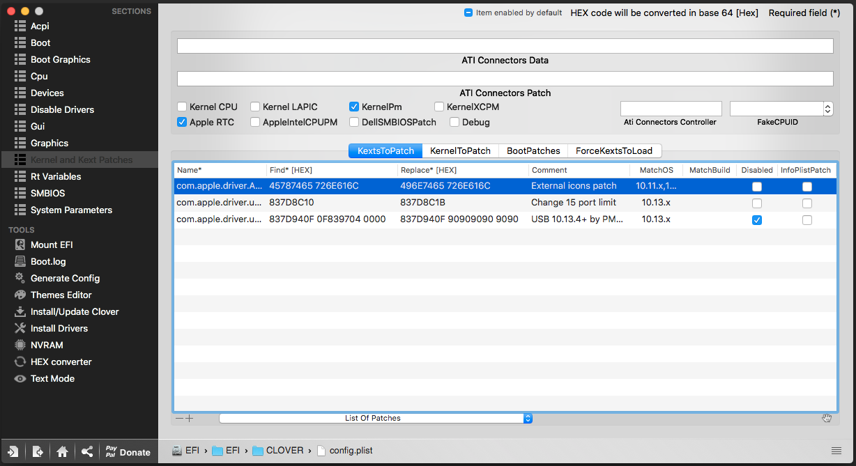

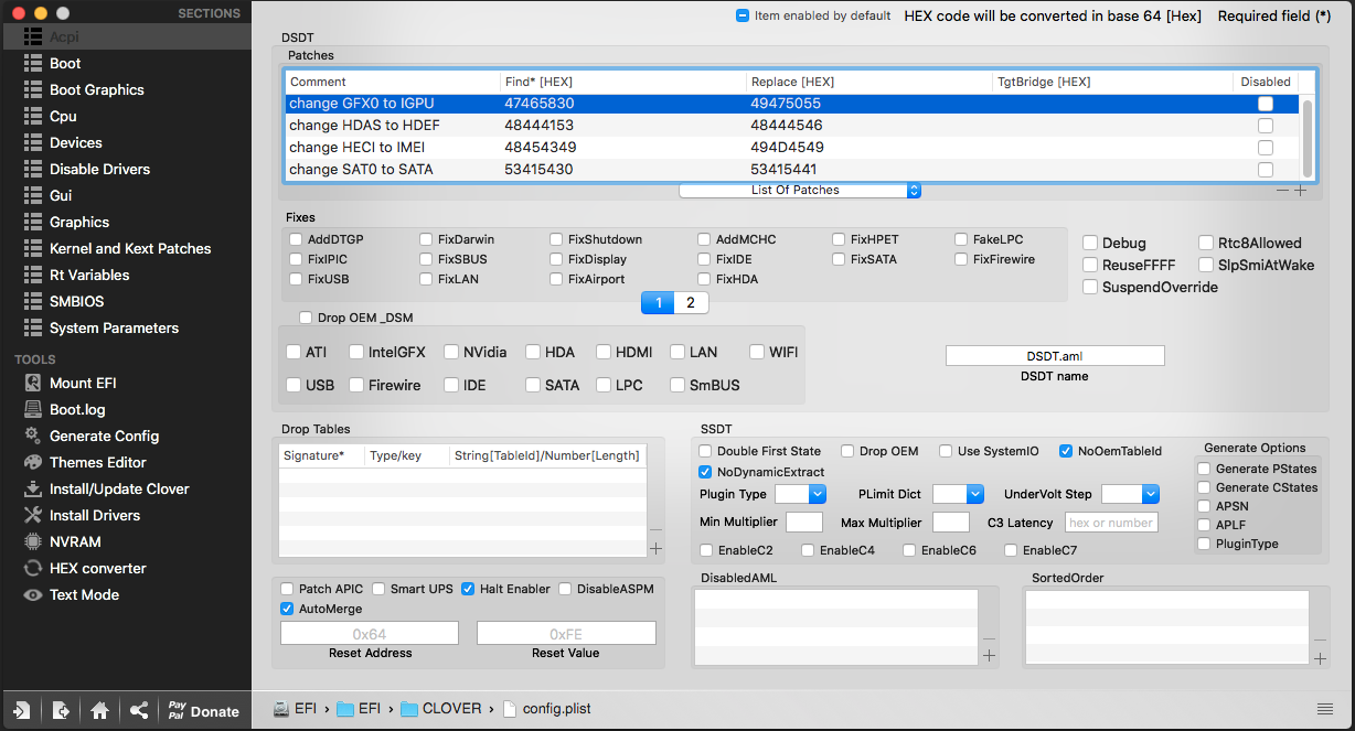

multiymedia Posted March 20, 2018 Share Posted March 20, 2018 19 hours ago, multiymedia said: i'm doing this but the system dont work fine and now final cut restart the computer. i read to somebody saying about ig-platform-id in my case must be 0x59120003 or 0x59120000? that appear in the menu of clover. We will get it¡¡¡ ok the system is stable but performance of finalcut no. is necesary the DSDT PATCHING PEGP -> GFX0 Patch? i have not this entry. when you make me your runmeapp. there is only nvidia card and intel was disable in bios, ¿is posible need to make another run your app? or simply makin you say in post : Looks good final cut, in my case, e.g., Coffeelake config -IntelGFX 0x59128086 -InjectIntel -ig-platform-id 0x59120003 -IntelGraphics enable no bios -DVMT to 128 -IntelGraphicsFixup.kext -Shiki.kext and remember i have h110m-s2h with i5 7600 and you are talkin about cofffelake?? sorry for my clumsiness Link to comment https://www.insanelymac.com/forum/topic/322004-guide-sierra-high-sierra-on-gigabyte-ga%C2%A0h110m-s2-dsdt/page/4/#findComment-2604521 Share on other sites More sharing options...

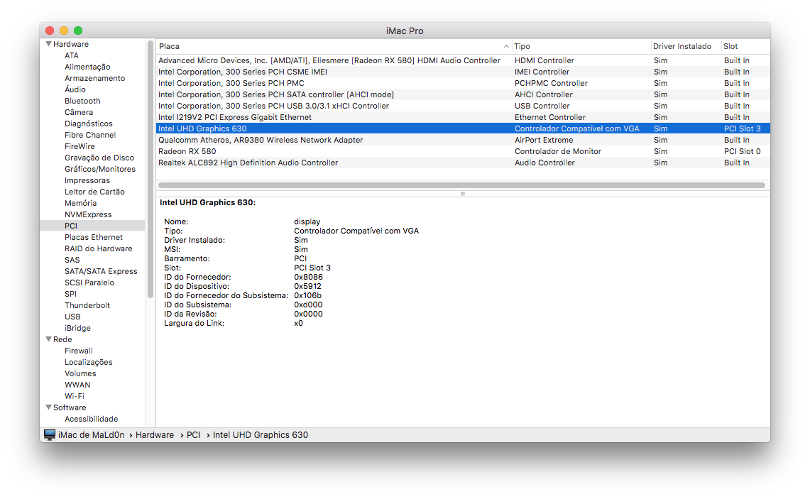

MaLd0n Posted March 20, 2018 Author Share Posted March 20, 2018 for coffeelake we need use kabylake things, same for IGPU in both line dont need pegp to gfx0 2 Link to comment https://www.insanelymac.com/forum/topic/322004-guide-sierra-high-sierra-on-gigabyte-ga%C2%A0h110m-s2-dsdt/page/4/#findComment-2604530 Share on other sites More sharing options...

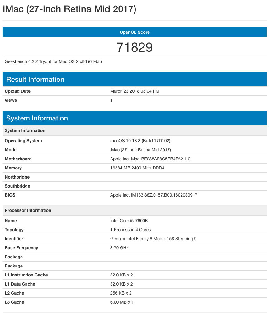

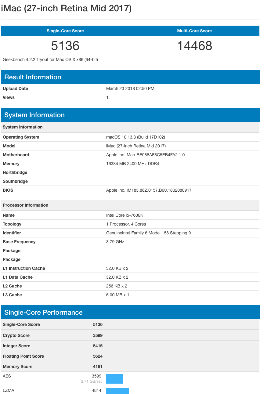

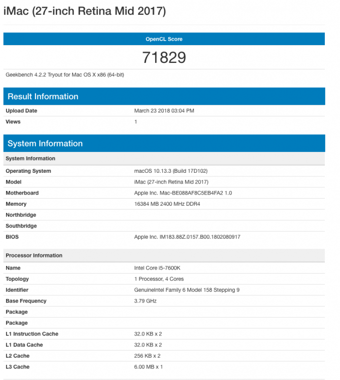

multiymedia Posted March 22, 2018 Share Posted March 22, 2018 On 20/3/2018 at 4:21 PM, MaLd0n said: for coffeelake we need use kabylake things, same for IGPU in both line dont need pegp to gfx0 everything is going pretty well, it does not give me as good performance as in sierra but it is quite fine. cinebench reports 103-106 in gpu. with sierra I see 114-120. The only thing I notice that sometimes happens is that the cursor does not appear when mounting the desktop, if I click and drag or if I do command-tab then it appears. thnks so much. Link to comment https://www.insanelymac.com/forum/topic/322004-guide-sierra-high-sierra-on-gigabyte-ga%C2%A0h110m-s2-dsdt/page/4/#findComment-2605113 Share on other sites More sharing options...
multiymedia Posted March 23, 2018 Share Posted March 23, 2018 On 20/3/2018 at 4:21 PM, MaLd0n said: for coffeelake we need use kabylake things, same for IGPU in both line dont need pegp to gfx0 everything is going pretty well, it does not give me as good performance as in sierra but it is quite fine. cinebench reports 103-106 in gpu. with sierra I see 114-120. The only thing I notice that sometimes happens is that the cursor does not appear when mounting the desktop, if I click and drag or if I do command-tab then it appears. thnks so much. after testing all the principal issue is finalcut. whe is open the system goes slow and laggy.... i'm reding many things about this but i cant find the solution. Link to comment https://www.insanelymac.com/forum/topic/322004-guide-sierra-high-sierra-on-gigabyte-ga%C2%A0h110m-s2-dsdt/page/4/#findComment-2605226 Share on other sites More sharing options...
